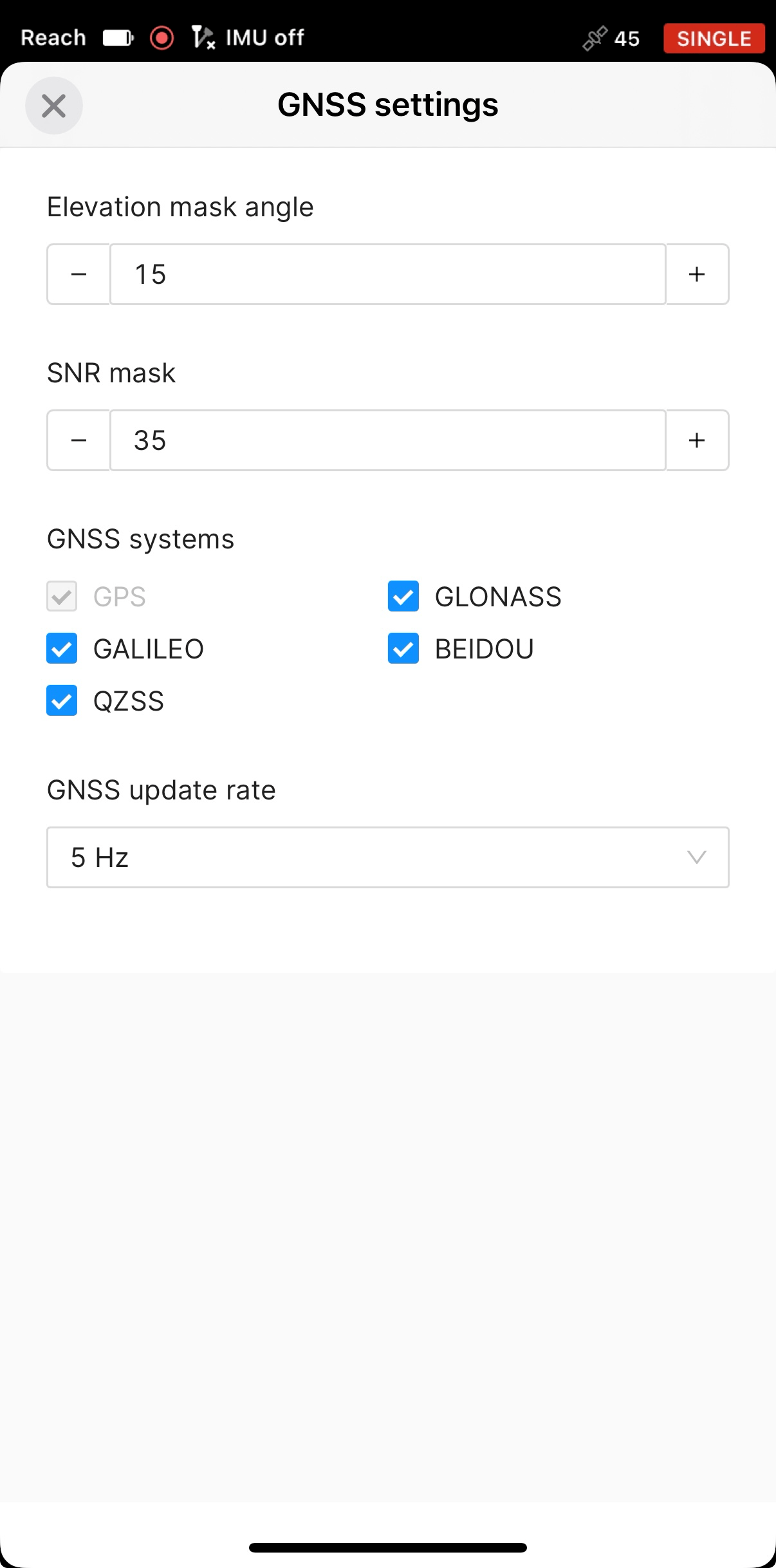

  1. Open the Emlid Flow app and connect to Reach RS4 / RS4 Pro.
  2. Go to Settings and tap GNSS settings.
  3. Keep the default constellation selection and update rate, as shown in the screenshot below.

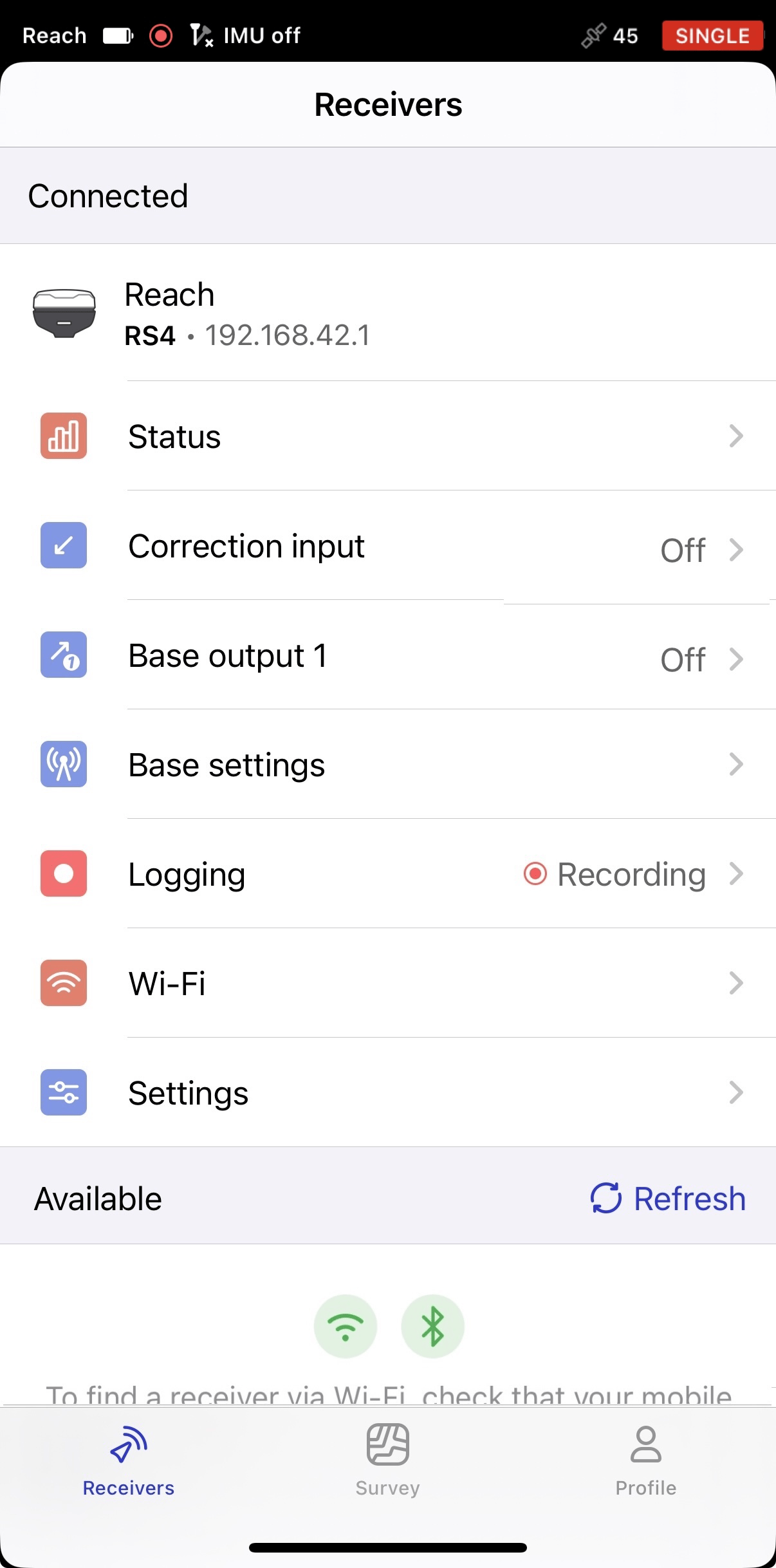

  4. Go back to the Receivers screen and tap Base settings.

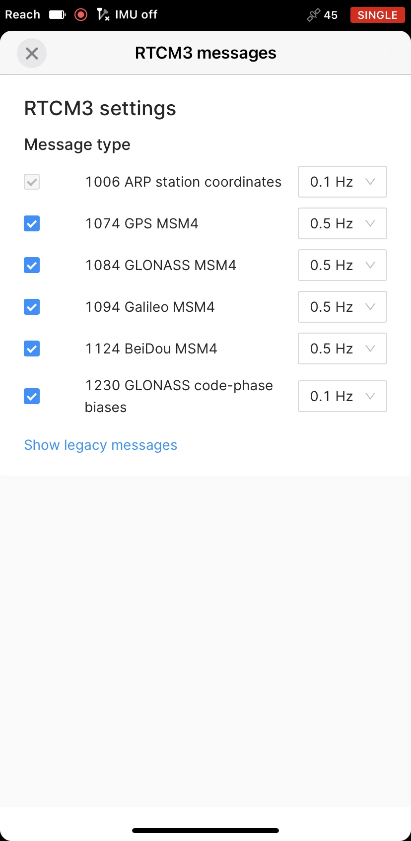

  5. Tap RTCM3 messages. By default, all RTCM3 messages are enabled.
    However, in some regions, local regulations may limit the available radio bandwidth, preventing Emlid Flow from using the default message set. In this case, we recommend applying one of the following configurations depending on your region:
    RegionRecommended constellations
    EuropeGPS + Galileo
    Northern EuropeGPS + Galileo + GLONASS
    AsiaGPS + BeiDou
    North AmericaGPS + Galileo or BeiDou + GLONASS
    South AmericaGPS + Galileo or BeiDou
    AfricaGPS + Galileo or BeiDou
    Australia/OceaniaGPS + BeiDou + Galileo
    GPS is used as the baseline constellation. Galileo, BeiDou, and GLONASS all provide global coverage, but may offer regional advantages due to their orbital configuration. Galileo is typically preferred in Europe, BeiDou in Asia and Oceania, and GLONASS at higher northern latitudes. When bandwidth is limited, we recommend enabling GPS and the constellation most relevant to your region.

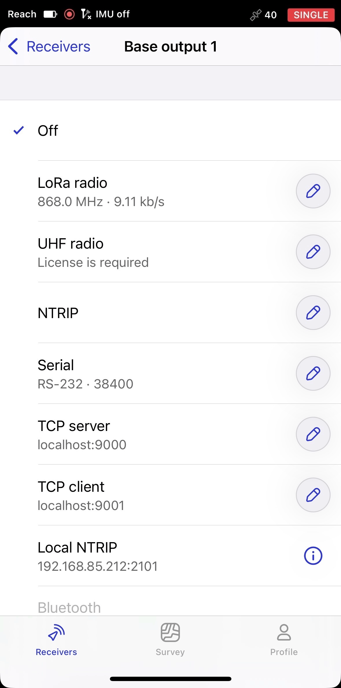

  6. Go back to the Receivers screen and tap Base output 1.

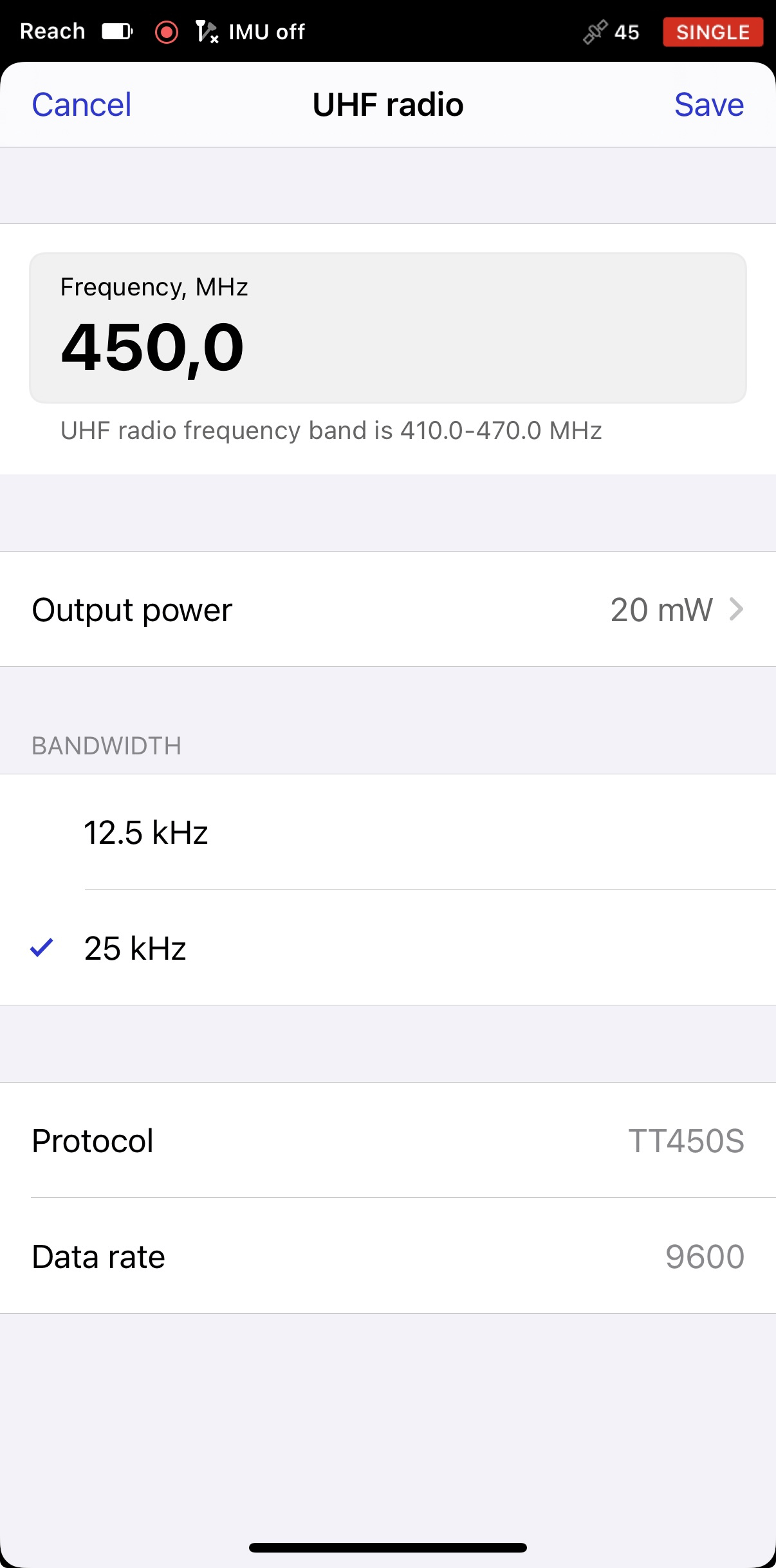

  7. Select UHF radio and tap the Edit button to set up the output.
  1. note

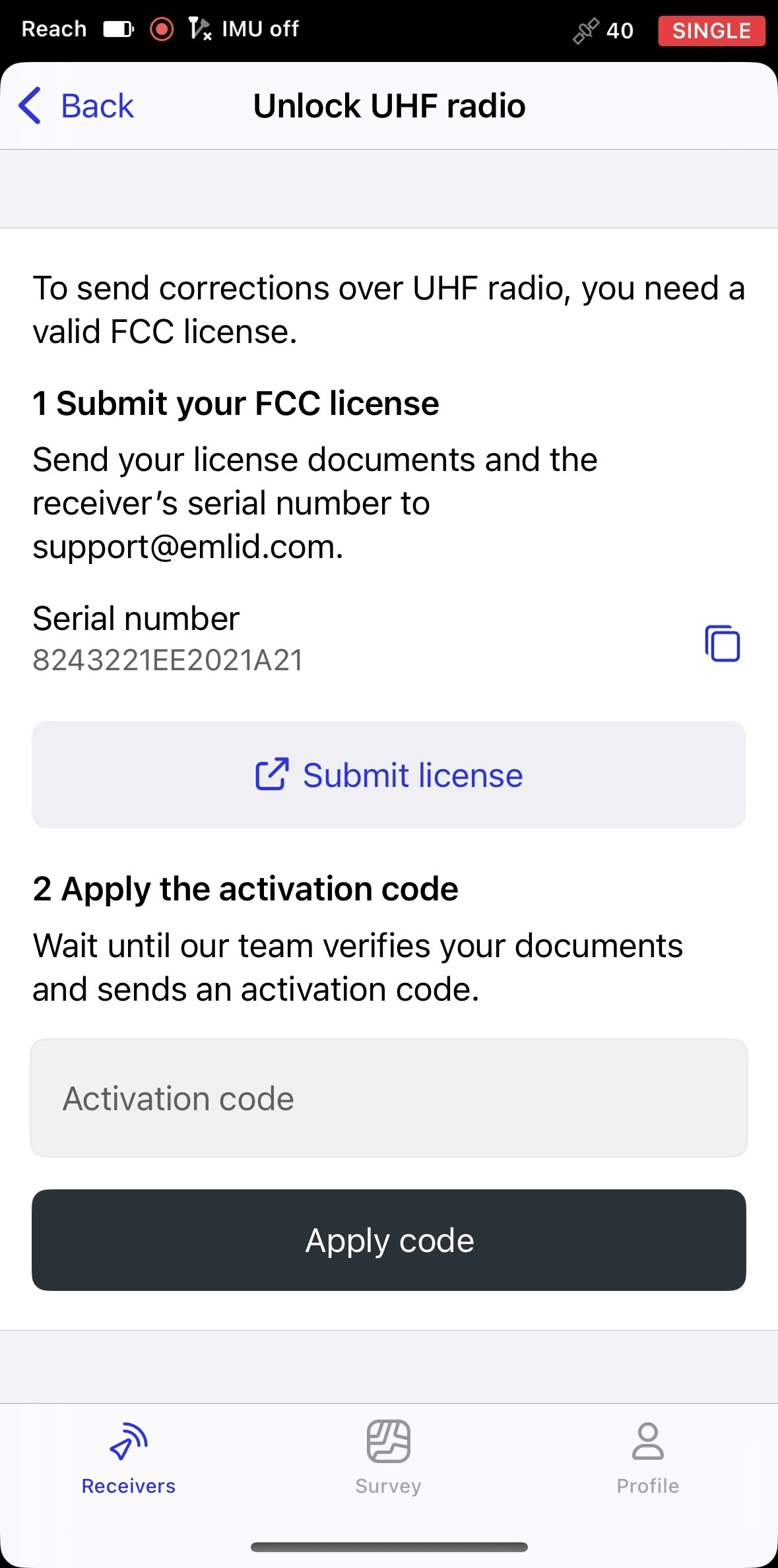

    This step applies to the US only. In the United States, UHF transmission requires a valid FCC license issued by the Federal Communications Commission (FCC), the US government agency responsible for regulating radio communications. For this reason, the UHF output interface remains blocked until a valid license is submitted to our Support team for verification. For more information on obtaining a license, consult the FCC’s official licensing process.
    To request activation from our Support team, do as follows:
    1.  Select UHF radio.
    2.  Tap Submit license. This will open the form, where you can submit your FCC license, the receiver’s serial number, and your email address, required for the UHF output activation.
    3.  Once your submission is verified, usually within one working day, you will receive an activation code at the email address you provided in the form. The code is issued specifically for the receiver identified by the submitted serial number. Enter this code in Emlid Flow, and tap Apply code.
    After you enter the activation code, the UHF channel will operate only on the frequencies and output power allowed by your license. The UHF screen will display your license details, call sign, and expiration date. When your license expires, the system will automatically block the UHF channel, and you will have to submit a new license to restore access.
    If you take the receiver to another country, you need to provide a local license if the country requires one. If no license is needed, you can unlock the UHF channel for use without additional documentation.
    To remove the license, reflash the receiver. Resetting settings or updating the firmware will not remove it, because the license is stored on the receiver, not in the app. Consequently, if you connect a receiver without a license to Emlid Flow, the app will prompt you to enter one.
  2. Configure the output according to your requirements, then tap Save.

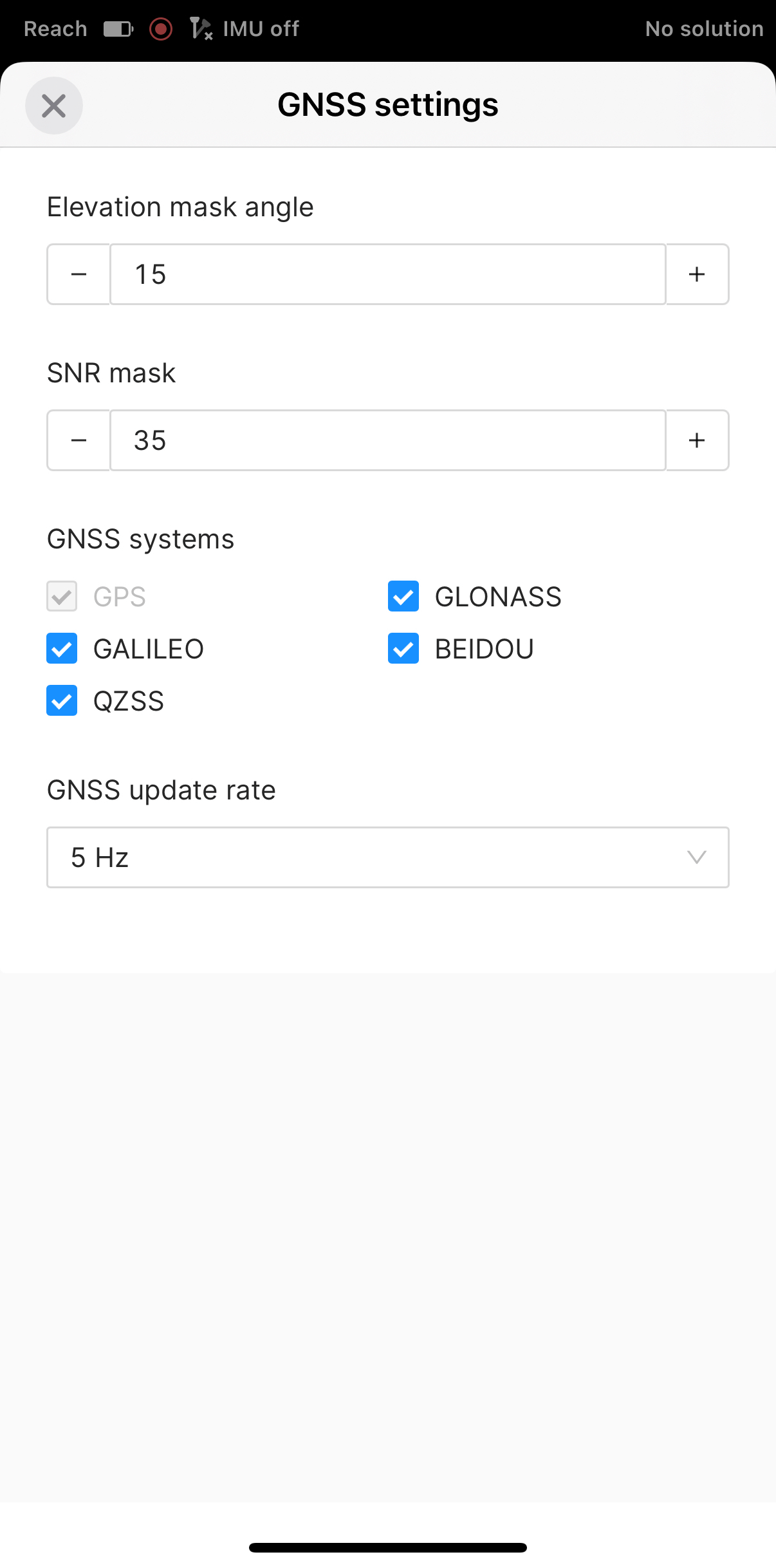

  3. Select the same GNSS systems as on the base and set a 5 Hz GNSS update rate. Apply changes.

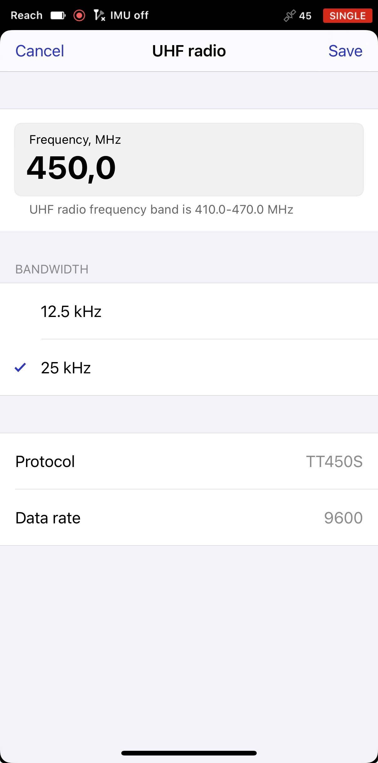

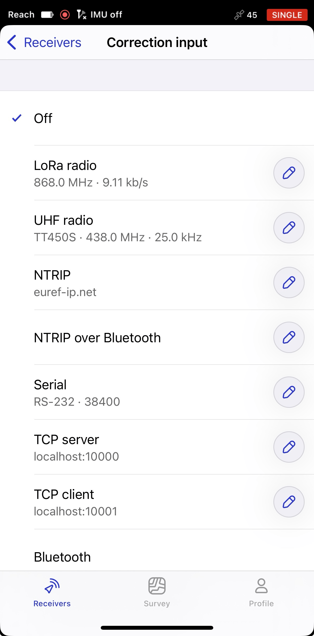

  4. To configure your rover to receive the corrections, return to the Receivers screen and tap Correction input.
  5. In the UHF cell, tap the Edit button. Set the same frequency and bandwidth as for the base. The data rate will automatically change depending on the chosen bandwidth: for 25kHz, it is 9600 bit/s, for 12.5—4800 bit/s. Tap Save.
To make sure that the corrections are passing from the base to the rover, you can attach UHF antennas and place both receivers by the window for a few minutes to get a clear view of the sky. Then open Emlid Flow, connect to the rover and go to the Status screen. Scroll down to the Corrections section and make sure that your rover is receiving corrections.

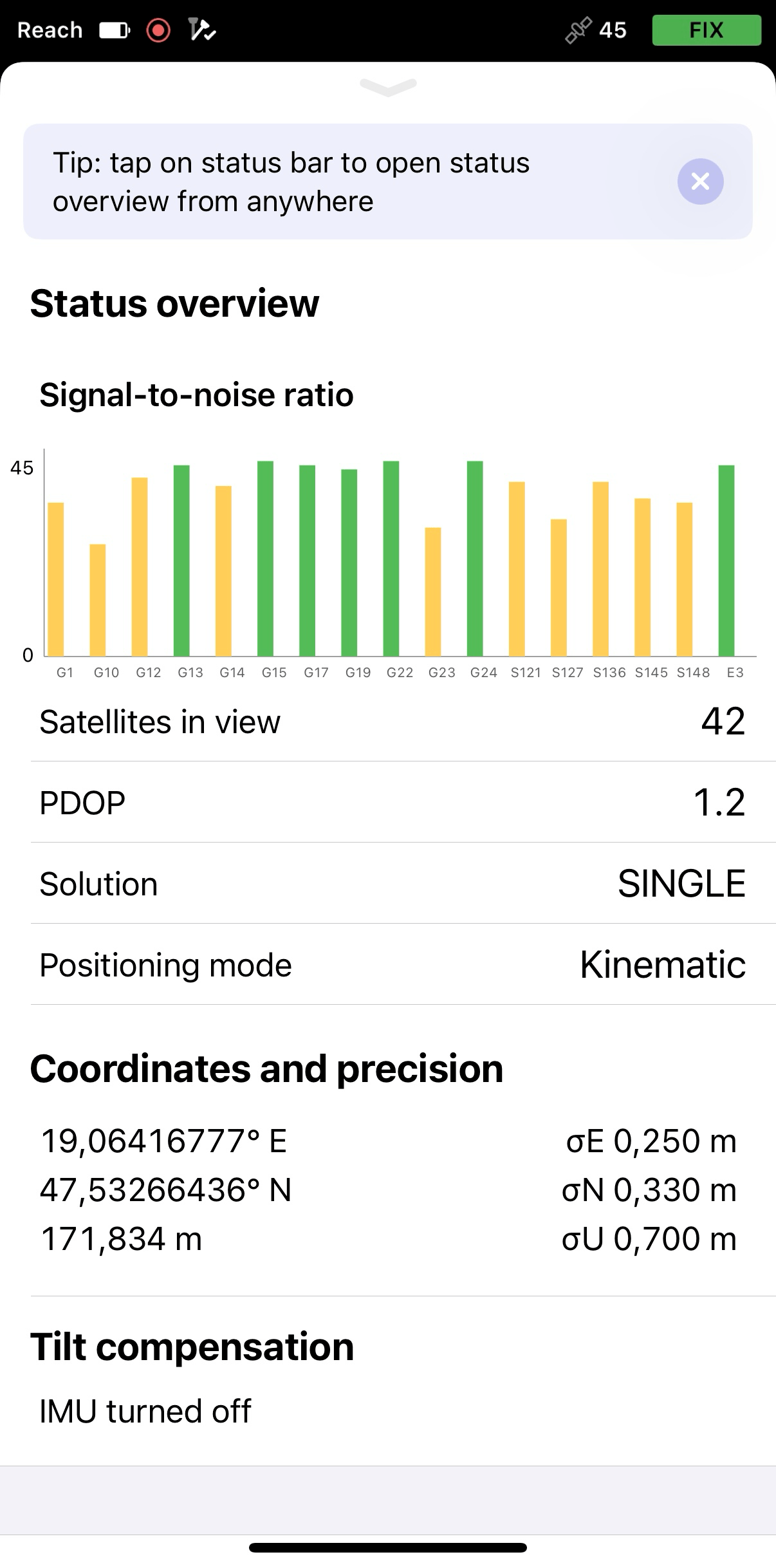

When you have completed your RTK setup over UHF radio, you can see the current solution status in the top right corner of the Emlid Flow app:
  • SINGLE means that the rover has found a solution relying on its own receiver and base corrections are not applied. Precision in standalone mode is usually at the several-meter level.
  • FLOAT means that the rover receives the base station's observation data and position but cannot resolve ambiguities needed to calculate its position with centimeter-level accuracy. In this case, the positioning accuracy can vary from a few centimeters to about 1 meter.
  • FIX means that the rover using corrections from the base resolved the ambiguities in its positional calculation and achieved the solution with the centimeter-level precision.
After a short period of time, the rover gets a fixed solution. In good environments, it will take a few seconds to get a fixed solution. In tough conditions, it may take a little longer. Once the rover gets FIX, you are all set for surveying.
You can also find the current solution status as well as your position in real time on the Status screen.
