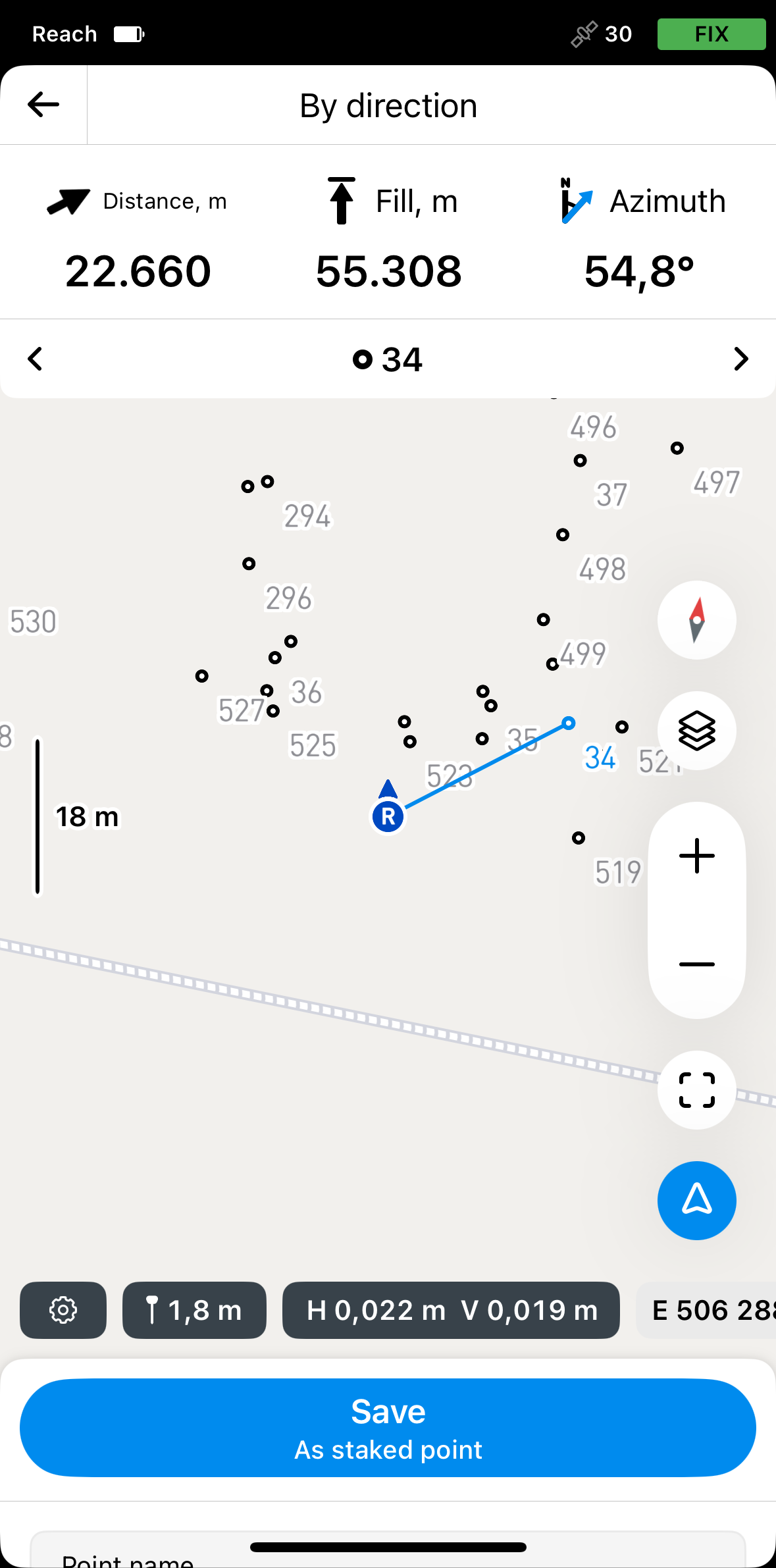

The Stakeout tool has two modes that you can choose between as you navigate to the point you want to stake out:
By direction​
In this mode, the rover is always centered on the map, and the map rotates so that the heading is always forward. The stakeout plate shows distance and features azimuth, which shows the direction from the rover to the projected point on a line. This is the default mode and it is indicated by the arrow on the Mode button in the lower right corner of the screen.

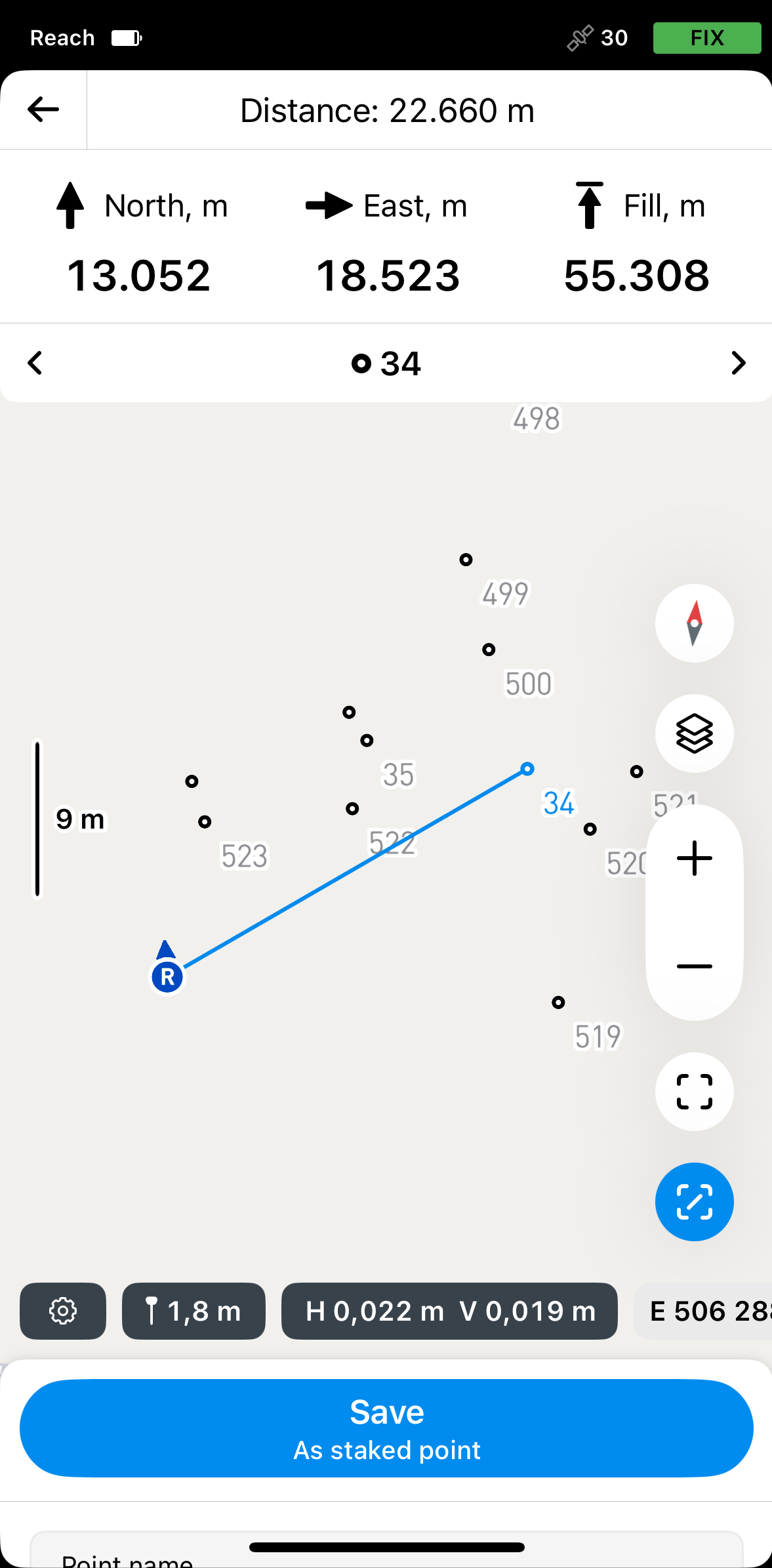

By distance​
In this mode, the rover is not centered on the map and the stakeout plate shows direction by separating it into North/South and East/West directions and corresponding distances from the rover to the target point on the line. This mode is indicated by the line in the square on the Mode button in the lower right corner of the screen.
Activating mode​
To activate the required mode, do the following:
  1. Tap the Mode button in the lower right corner of the screen. It will turn blue.
  2. To switch to the required mode, tap the activated Mode button.
    Moving or zooming the map will deactivate the distance fit. When moving the rover, the map will not move automatically.

The workflow is shown using the By direction mode.
To stake out a point using Emlid Flow, follow the steps below:
  1. Open the Emlid Flow app and connect to your Reach.

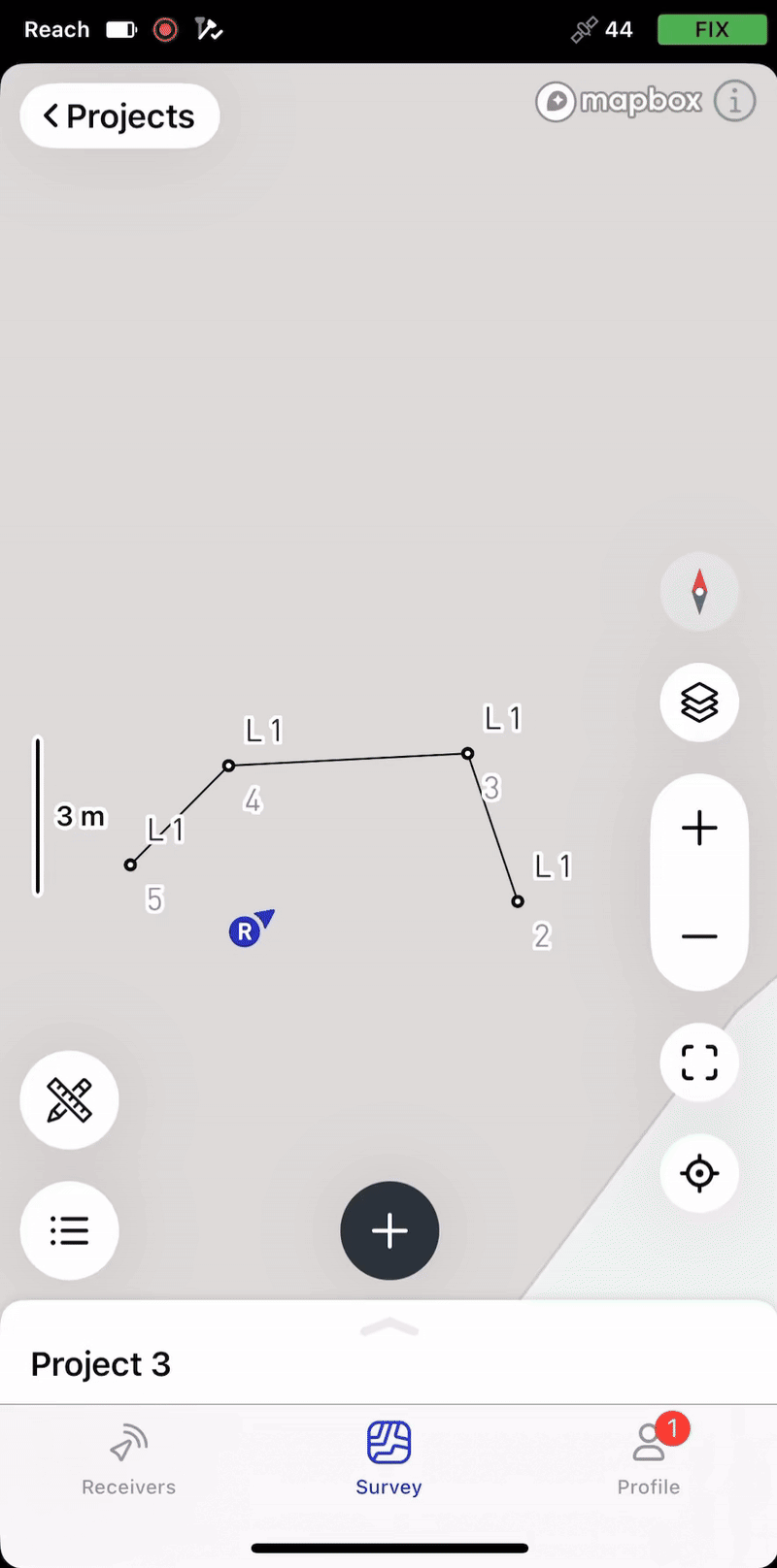

  2. Go to the Survey tab and open or import a project.
    To learn how to import a project, check the Create or import project guide.
  3. Tap the List button to choose the point you want to stake out. You can also select the point directly on the map.
    The selected point will be highlighted in blue on the map.
  4. Tap the Stake out button.
  5. Move your Reach in the direction of the point. When you get closer, the map zooms in automatically.
    The direction arrows on the stakeout plate can help you navigate to the point.
  6. Move your Reach so that the bull’s-eye turns green, showing that your Reach is less than 2.5 cm (0.08 ft) away from the point you are staking out.

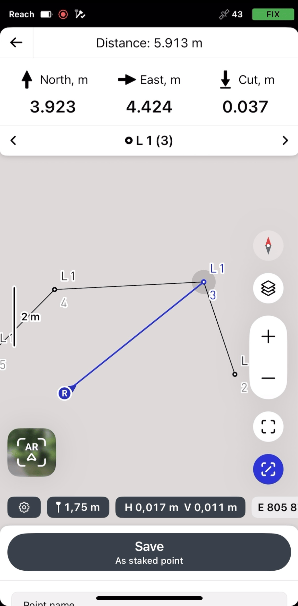

To stake out a point using the AR stakeout feature, follow the steps below:
If you receive corrections via NTRIP over BLE, make sure your mobile device has an active internet connection via mobile data or Wi-Fi. When using mobile data, check your mobile device settings to confirm that Emlid Flow is allowed to access it.
  1. Choose the point you want to stake out on the map or from the list of objects, and tap Stake out. The selected point will be highlighted in blue on the map.
  2. Tap the AR Stakeout button.

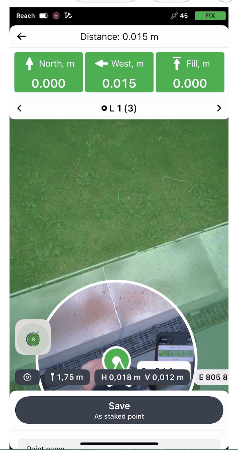

  1. Watching the offset plate and the screen, move towards the point. As you move closer, the interface switches to the bull’s-eye mode, centering the target for precise placement.
  1. Move your Reach so that the bull’s-eye turns green, showing that your Reach is less than 2.5 cm (0.08 ft) away from the point you are staking out.
  1. Physically mark the point’s position on the ground.
