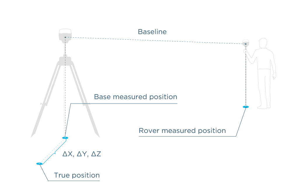

Real-Time Kinematic (RTK) is a technique that enhances the accuracy of GNSS positioning by using two receivers—a stationary base with known coordinates and a moving rover. The rover measures its position relative to the base. This means that even though measured with the centimeter precision, the coordinates of the rover are only as accurate as the base placement. Any shift in the absolute base position will also be present in the rover measurements.
For some applications, it is sufficient when the position of an object is only accurate relative to the base station, but for surveying and mapping, it is critical to know the true position with high absolute accuracy. To achieve this, the error in the base station position should be avoided or reduced by placing it over a known point or carefully determining its coordinates.

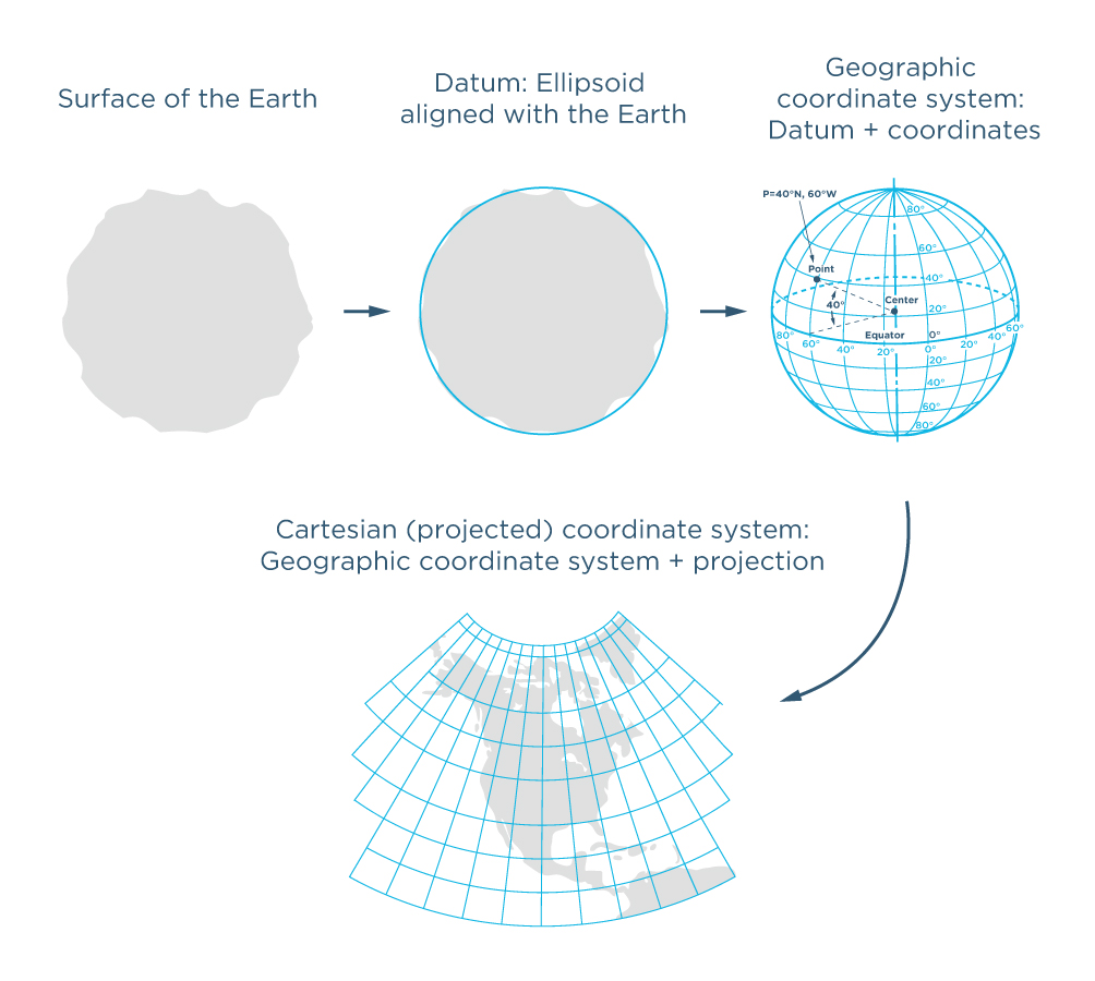

In surveying, the position of an object in space is defined by a coordinate system. There are many coordinate systems designed for different applications and countries. The foundation of every coordinate system is a datum.
A datum contains the information about the mathematical model of the Earth (ellipsoid) and how it is aligned with the Earth’s surface, providing the reference frame for the measurements. A coordinate system is then used to describe the positions relative to the datum with latitude and longitude. For a flattened Cartesian representation of the coordinates, a cartographic projection is applied.

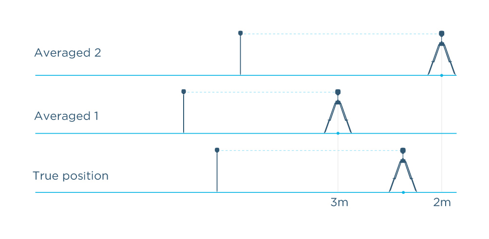

For example, when you don’t know the base position, you can average it in SINGLE. Averaging is done in standalone mode without using any corrections, and the position is determined with the accuracy of several meters. Each time you average the base position from the same point, the measured coordinates may differ by several meters from the previous results and from the true position. Thus, the actual (absolute) accuracy of the rover measurements will be at meter level. See Figure 1 below.
This type of setup is suitable when you need to measure the objects relatively to each other. For example, this method can be used to measure areas and distances, or to keep an autonomous tractor on the right track. To reuse the setup and get the same coordinates for the same points, you'll need to place the base over the same point (using a mark on the ground is a good idea) and enter the same previously determined base coordinates manually or pick them from the saved ones in Emlid Flow. Otherwise, you may end up with a different base position that won’t fit your project and lead to coordinates mismatch.

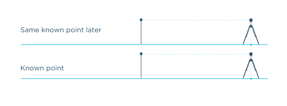

When the positions collected in RTK are accurate both relative to the base and to the selected coordinate system, it is called absolute positioning. To achieve this, the coordinates of the base must be known and set manually. Entering the known position of the base “pins” your RTK setup to the right place on the ground. This way, the positions measured with the rover will be precise and accurate in the selected coordinate system to the centimeter level. See Figure 2 below.
We recommend setting up the base using the manual coordinates entry method if you want to get precise and repeatable results in a selected coordinate system. Working with a known base position is necessary when you plan to use the collected measurements with the other data, for example, submit the surveyed parcel boundaries to the land registry. There are several ways to get known coordinates to set up the base:
