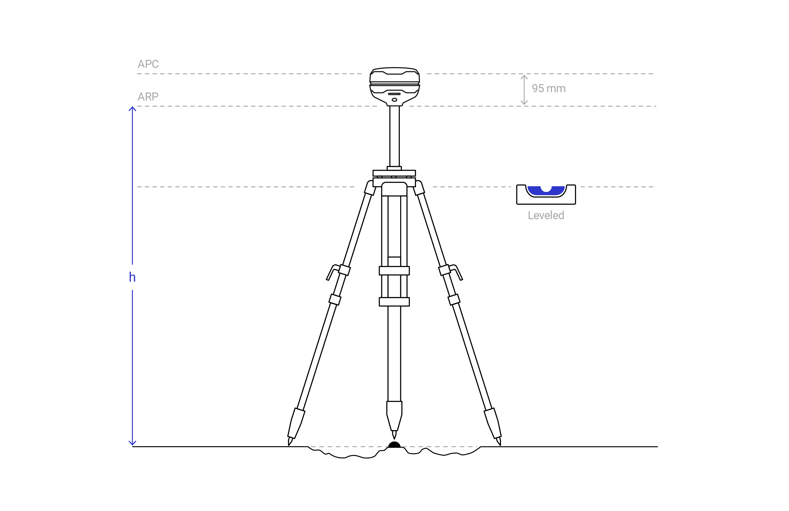

When placing your Reach in the field, make sure your Reach device is placed precisely above the marked point on the tripod and leveled. When you are setting up base coordinates manually, you need to measure the antenna height offset. Follow the steps below:

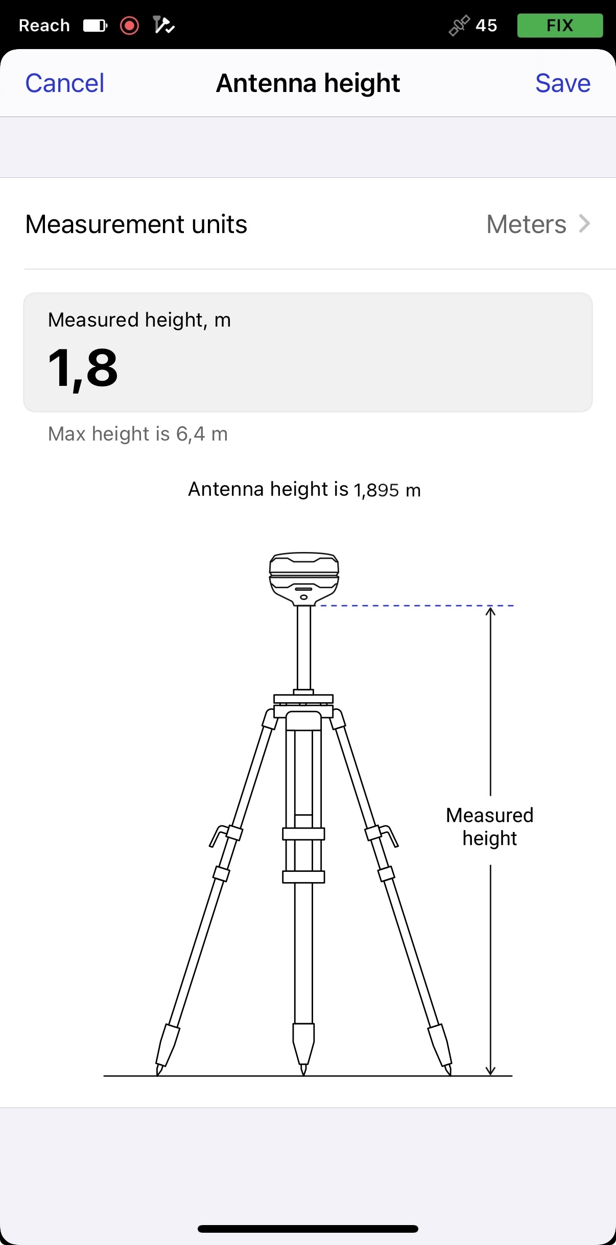

  1. Measure the distance from the mark to the bottom of your Reach (h in Figure 1).
  2. Specify the measured distance in Emlid Flow. It will automatically calculate the antenna height.
    For Reach RS4 / RS4 Pro, the antenna height is the distance from the mark on the ground to the center point on the Reach’s bottom (h in Figure 1), antenna reference point (ARP), plus the height of the receiver to the antenna phase center (APC), antenna height offset. Emlid Flow automatically adds the antenna height offset, which is 95 mm.
When you have placed Reach over the mark and measured the antenna height, you are ready to set up the base position in the Emlid Flow app.

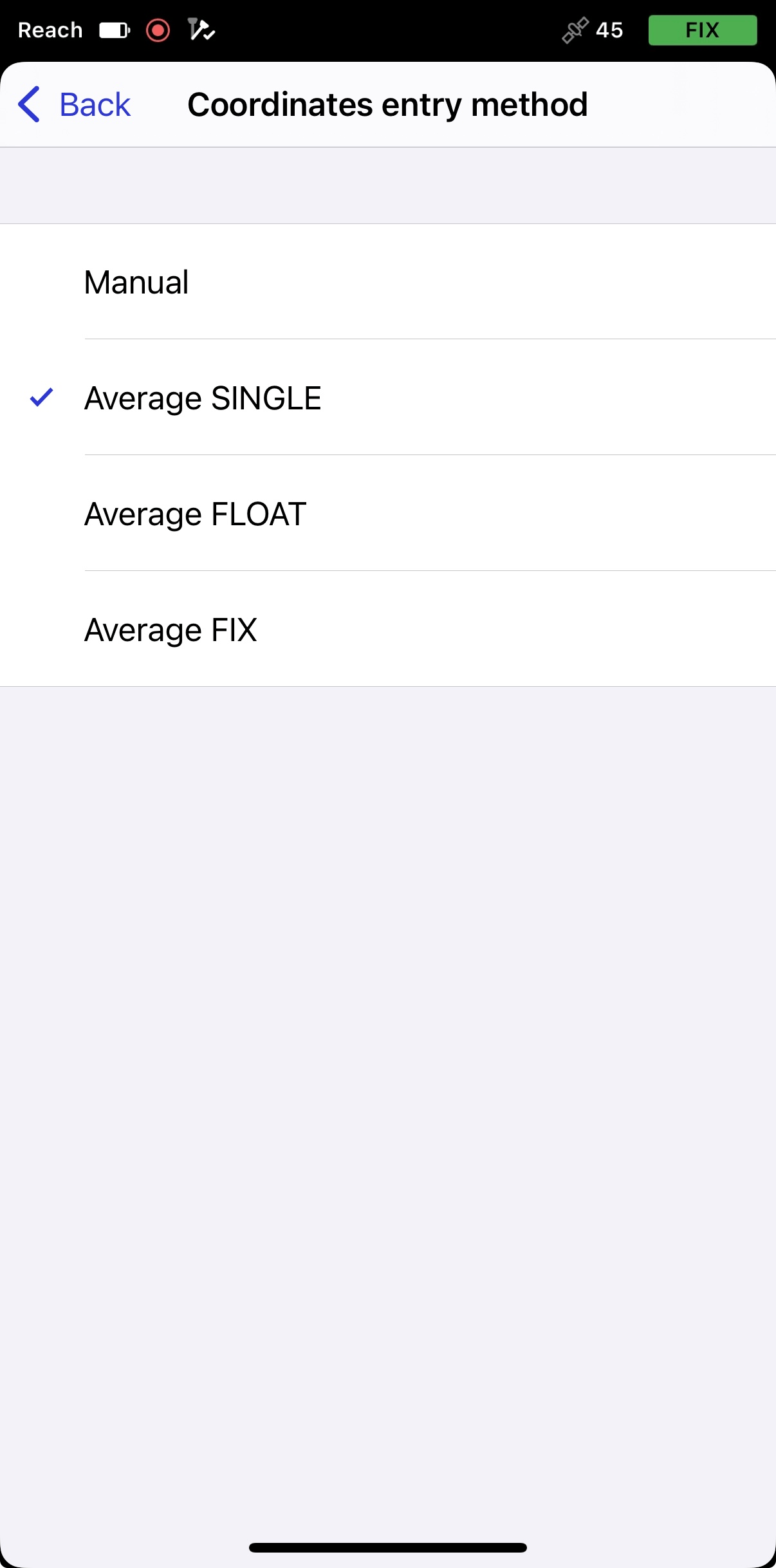

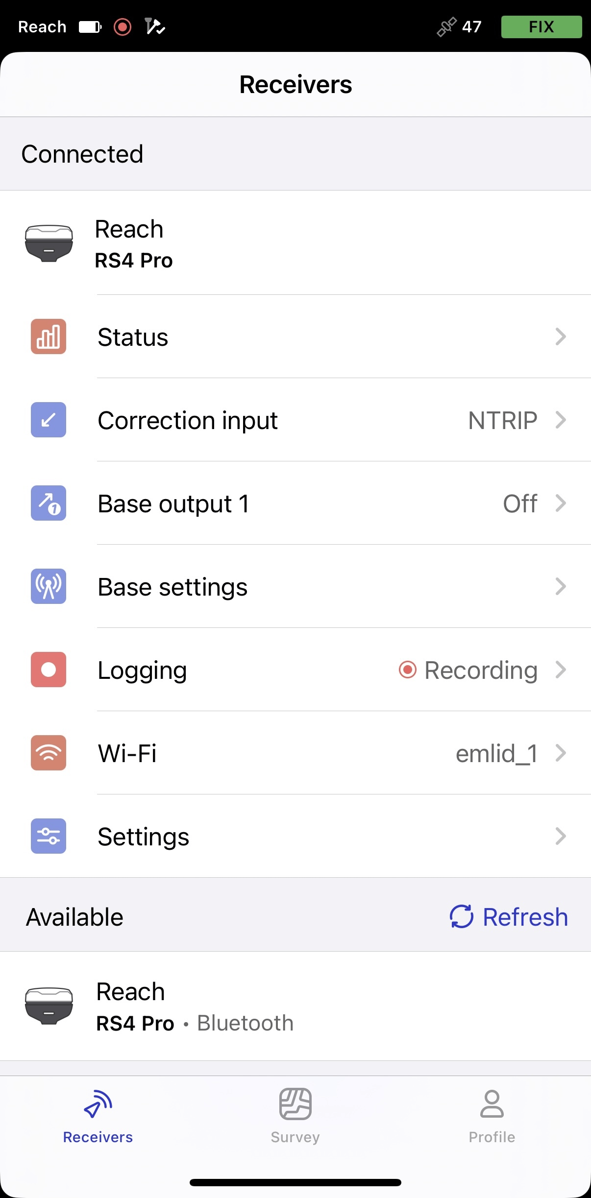

  1. Go to Base settings and tap Configure.
  2. Tap Coordinates entry method and choose Average SINGLE from the menu.
  3. Tap Antenna height to set the antenna height and save it.
  4. Set the averaging time, tap Save.
