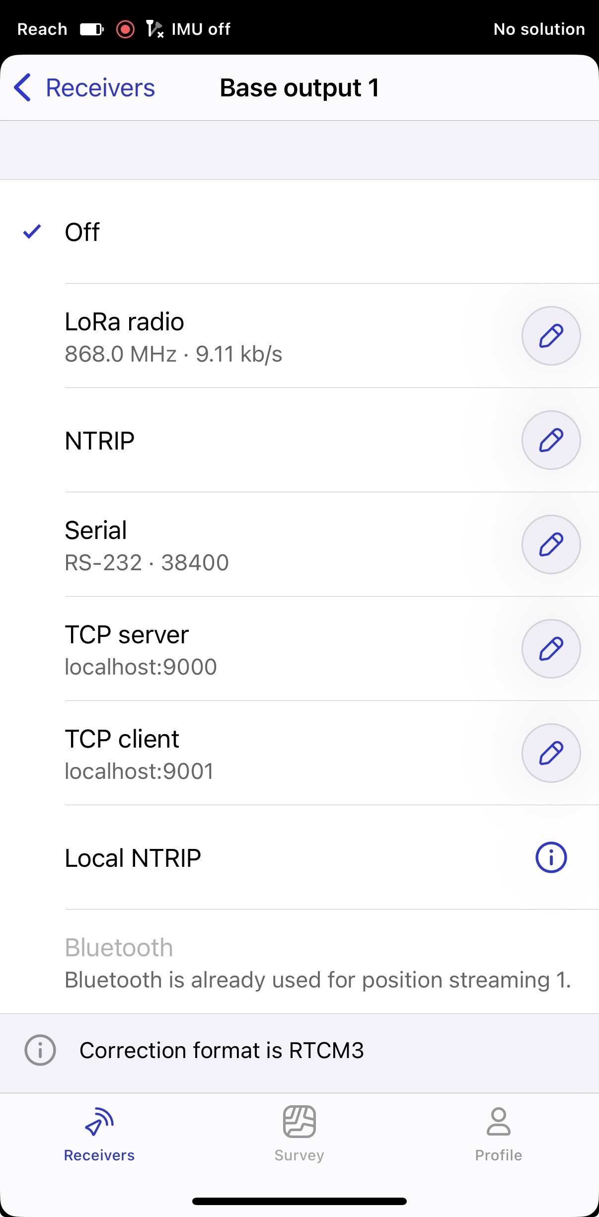

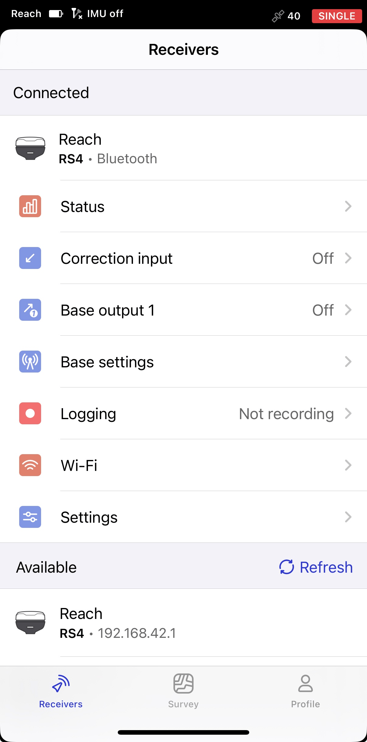

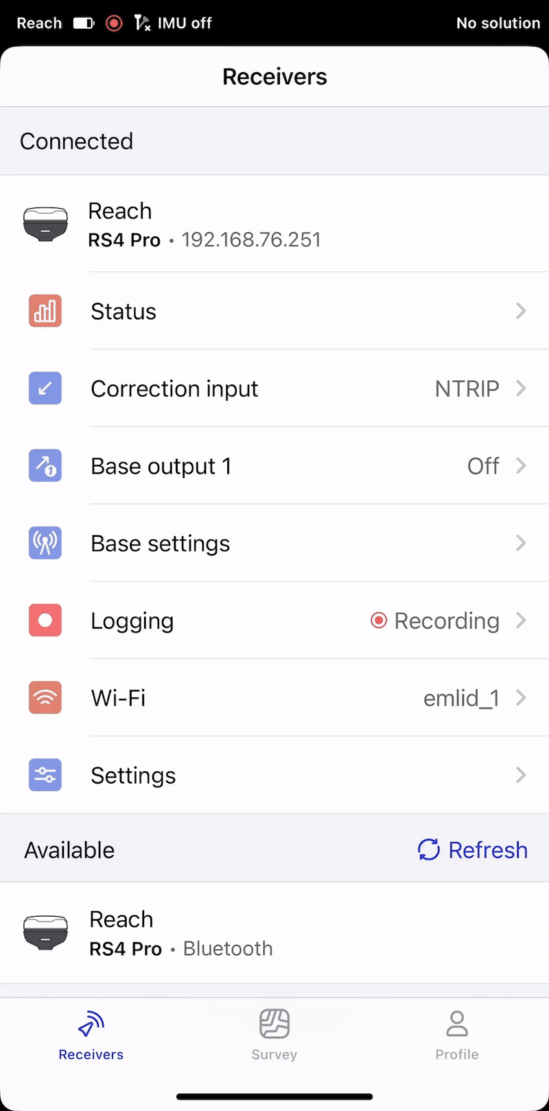

- Connect to the base unit in Emlid Flow.
- Tap Base output 1 and select the output channel.

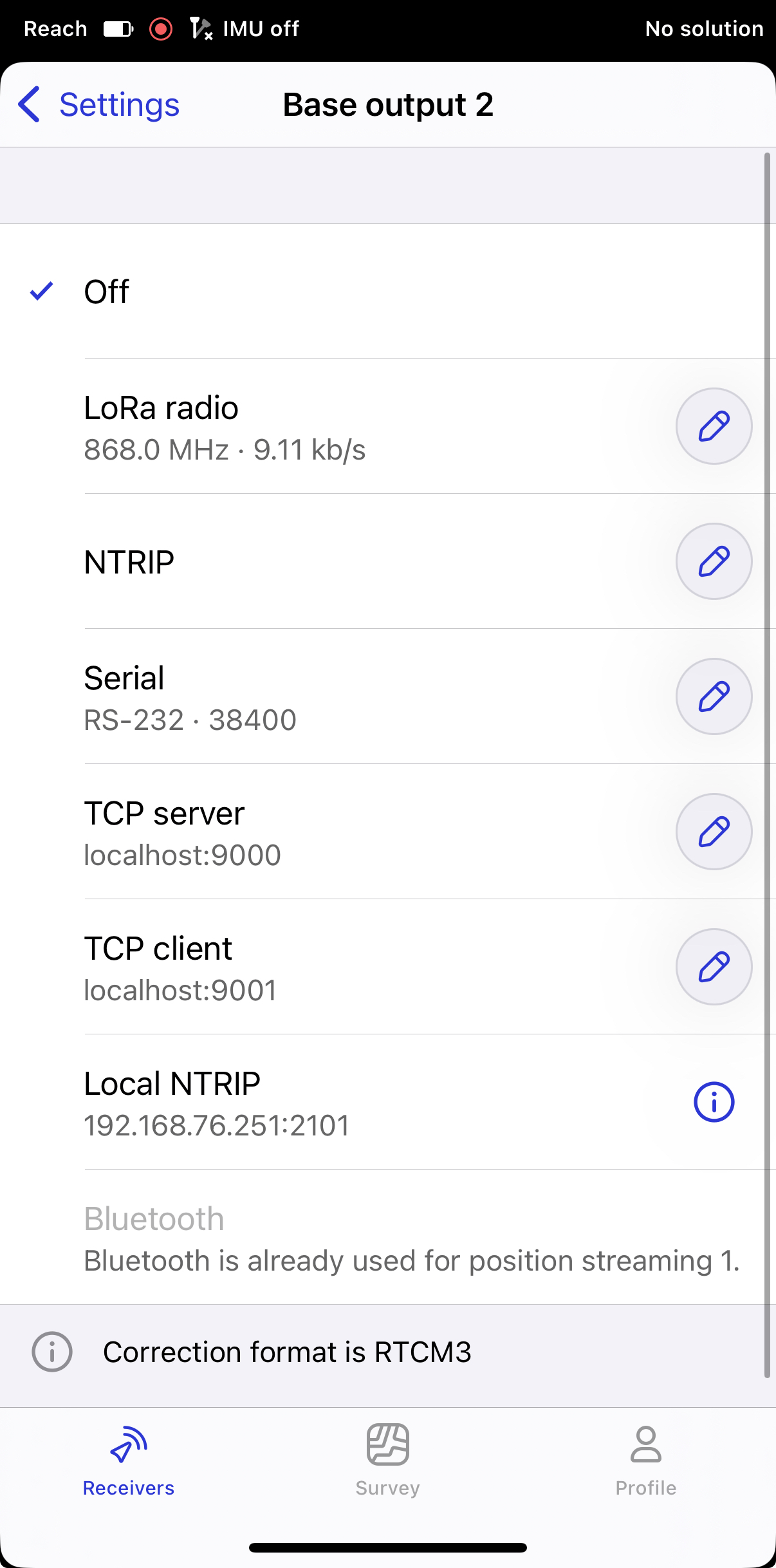

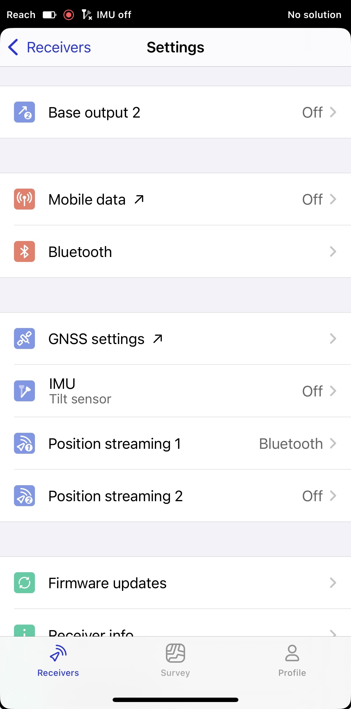

- To set up one more output, go back to Settings and select Base output 2.
To receive corrections on your rover, configure the same output channel as the base and ensure an unobstructed sky view for optimal satellite signal reception.
