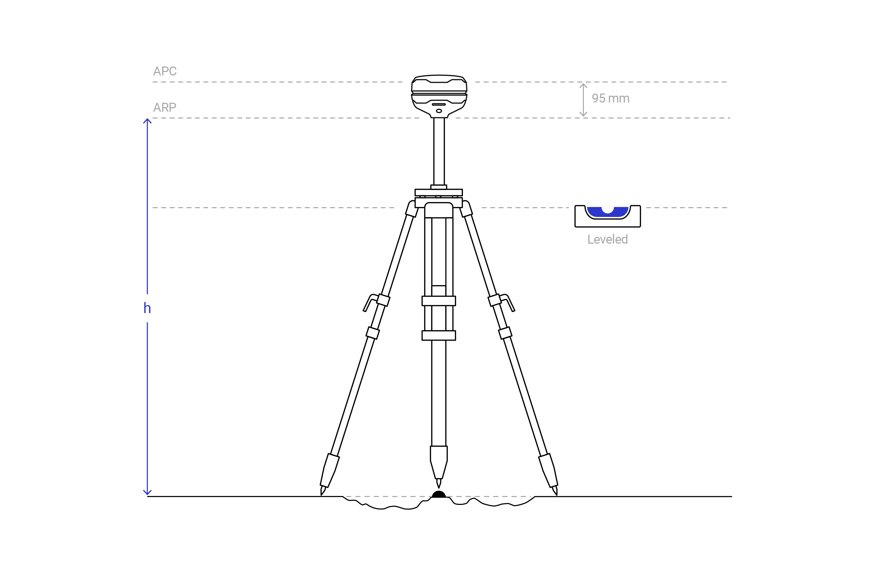

Measuring antenna height offset​
When placing your Reach in the field, make sure your Reach device is placed precisely above the marked point on the tripod and leveled. When you are setting up base coordinates manually, you need to measure the antenna height offset. Follow the steps below:
  1. Measure the distance from the mark to the bottom of your Reach (h in Figure 1).
  2. Specify the measured distance in Emlid Flow. It will automatically calculate the antenna height.
    For Reach RS4 / RS4 Pro, the antenna height is the distance from the mark on the ground to the center point on the Reach’s bottom, antenna reference point (ARP), plus the height of the receiver to the antenna phase center (APC), antenna height offset. Emlid Flow automatically adds the antenna height offset, which is 95 mm.
When you have placed Reach over the mark and measured the antenna height, you are ready to set up the base position in the Emlid Flow app.

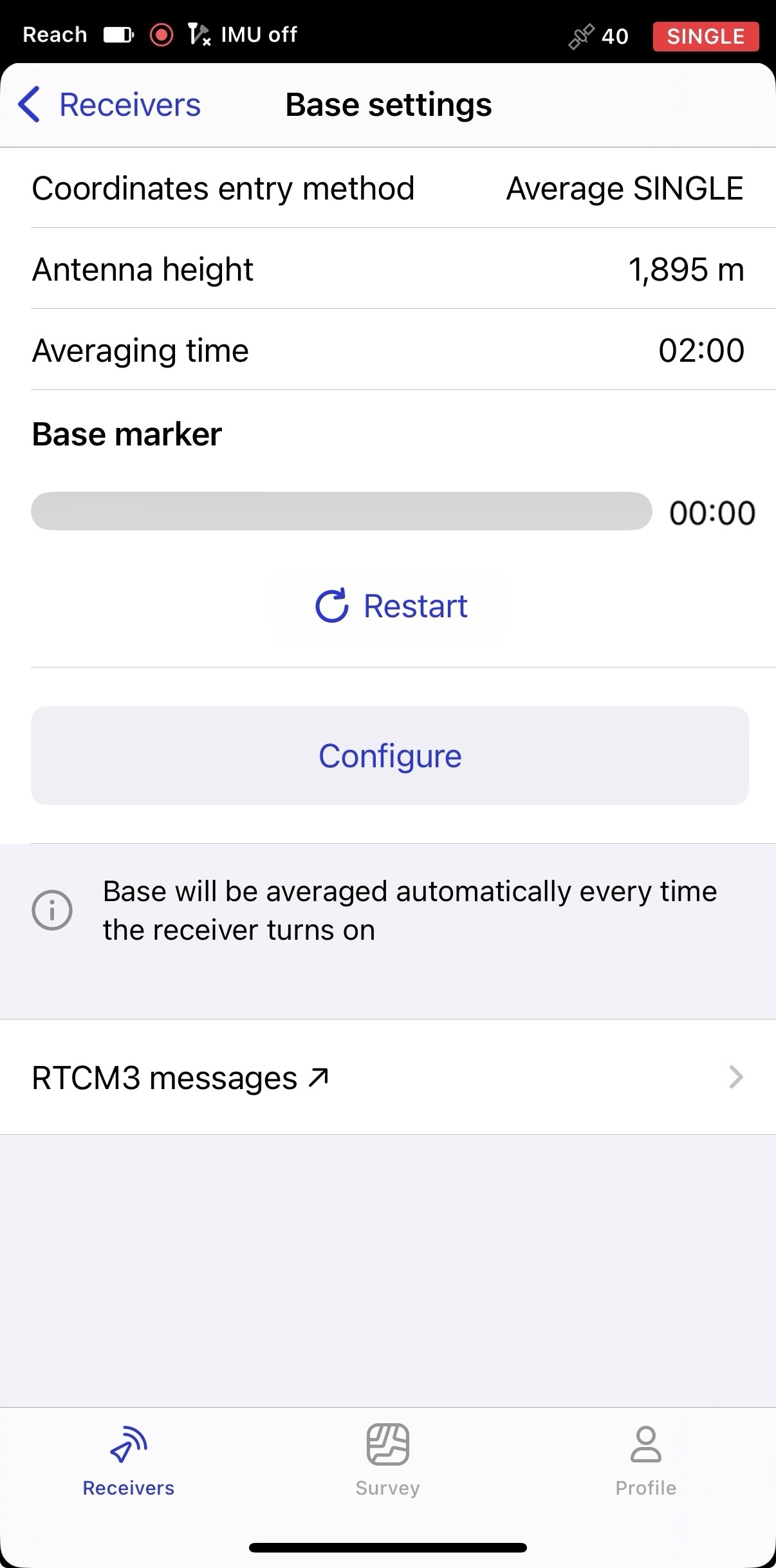

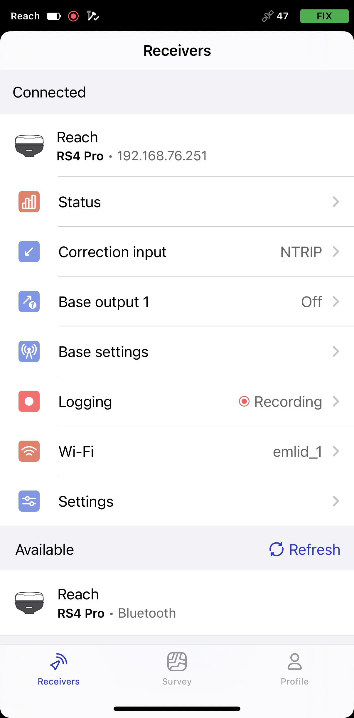

  1. Open the Emlid Flow app and connect to your Reach.
  2. Go to Base settings of your Reach and tap Configure.

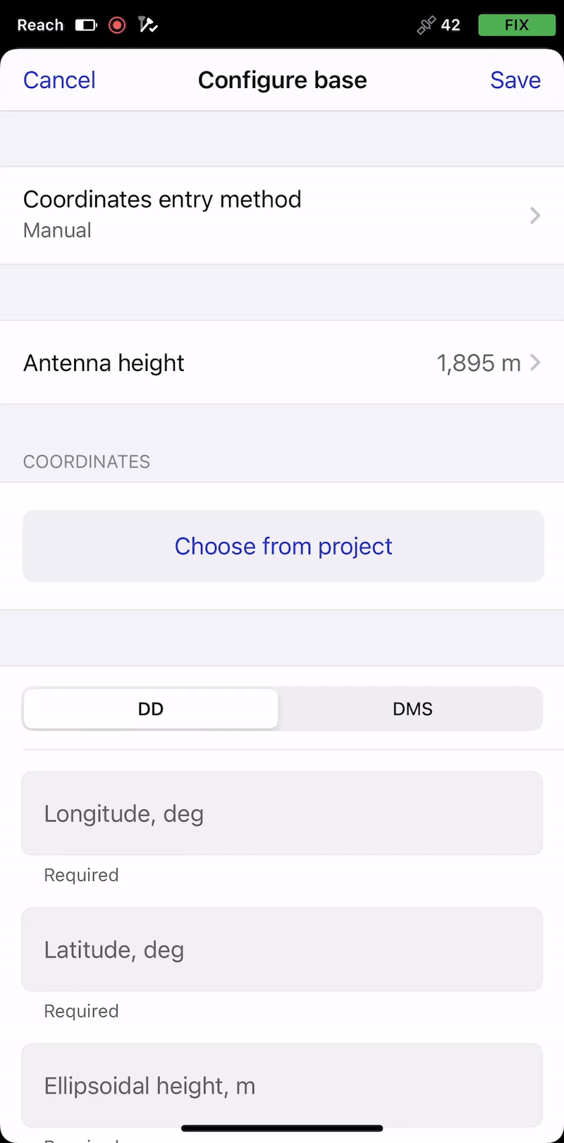

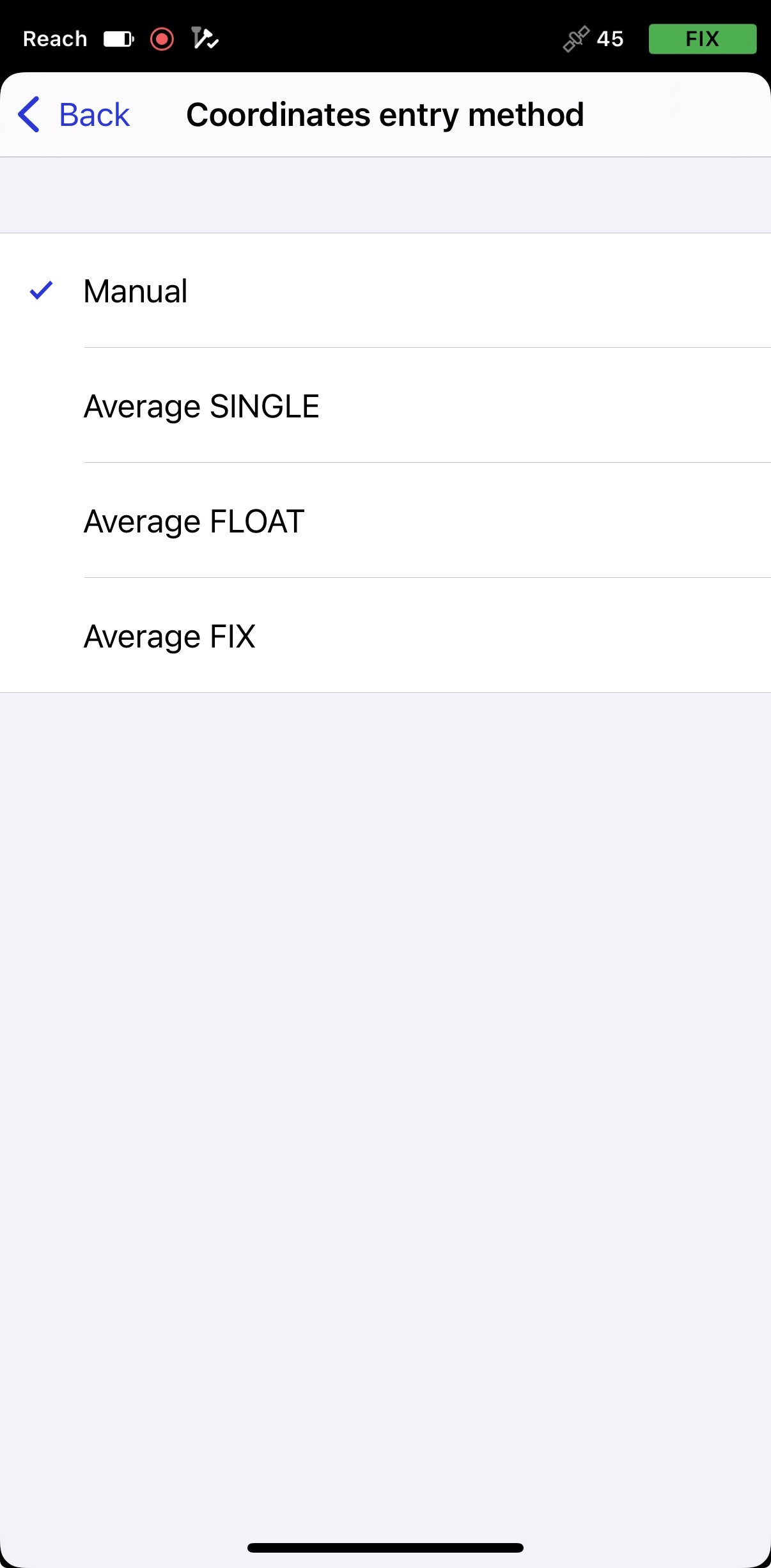

  3. Tap Coordinates entry method and select Manual from the menu.

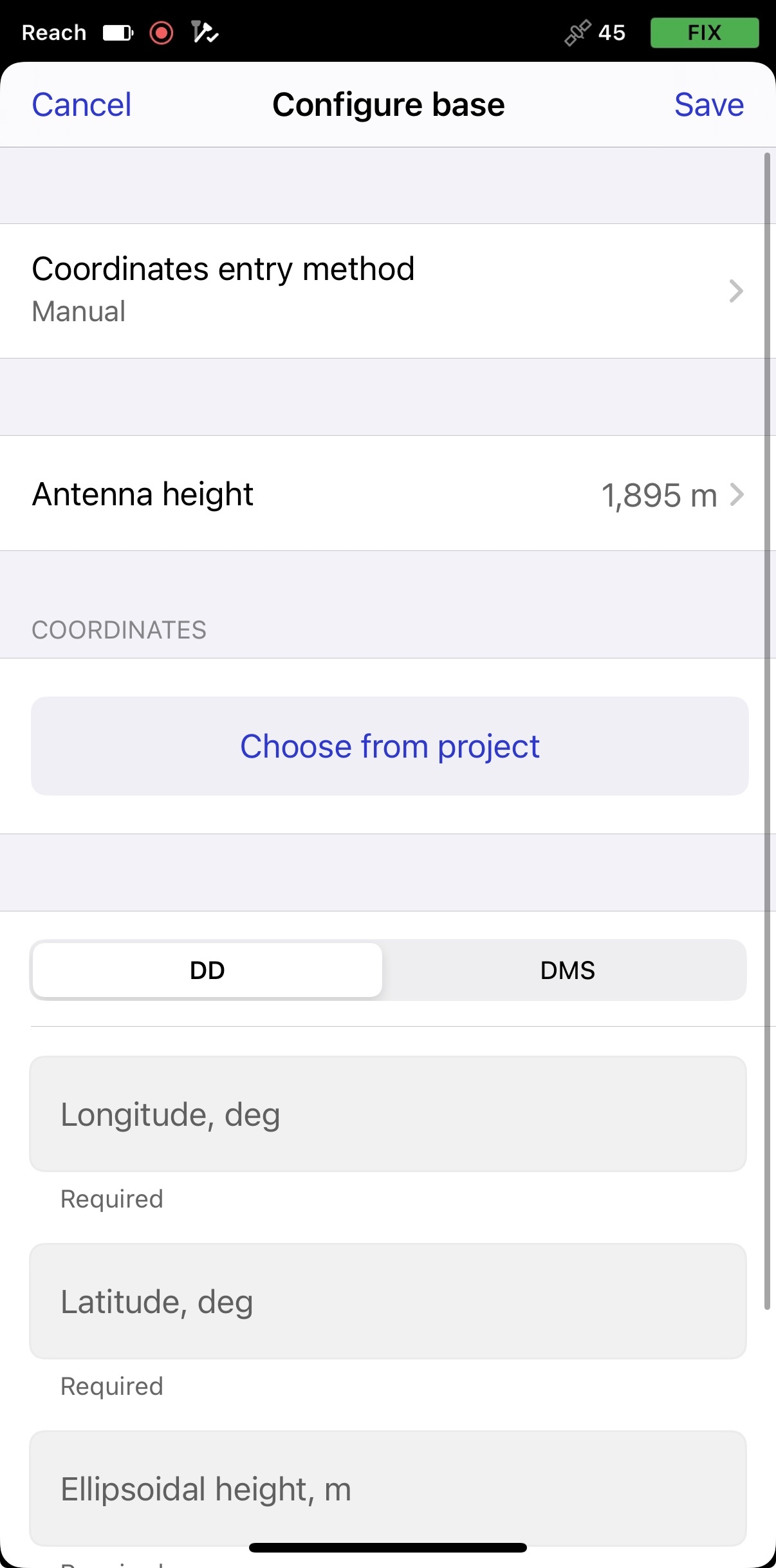

  4. Tap Antenna height to set the antenna height and save it.
  5. Enter the geographic coordinates of your point in DD or DMS format, or import a point from your Emlid project by tapping Choose from project.
    If your known point has local coordinates, add it to your Emlid project and use the point picker option to set it as a base’s coordinates. Emlid Flow will convert these coordinates into geographic ones.
    To correct the coordinates of a manually created or imported point in Emlid Flow, choose the point on the map or in the objects list, tap the three-dot menu, and select Duplicate and edit. Edit the coordinates and tap Save.
  6. Once you’ve set the coordinates of the point, tap Save in the upper right corner.
