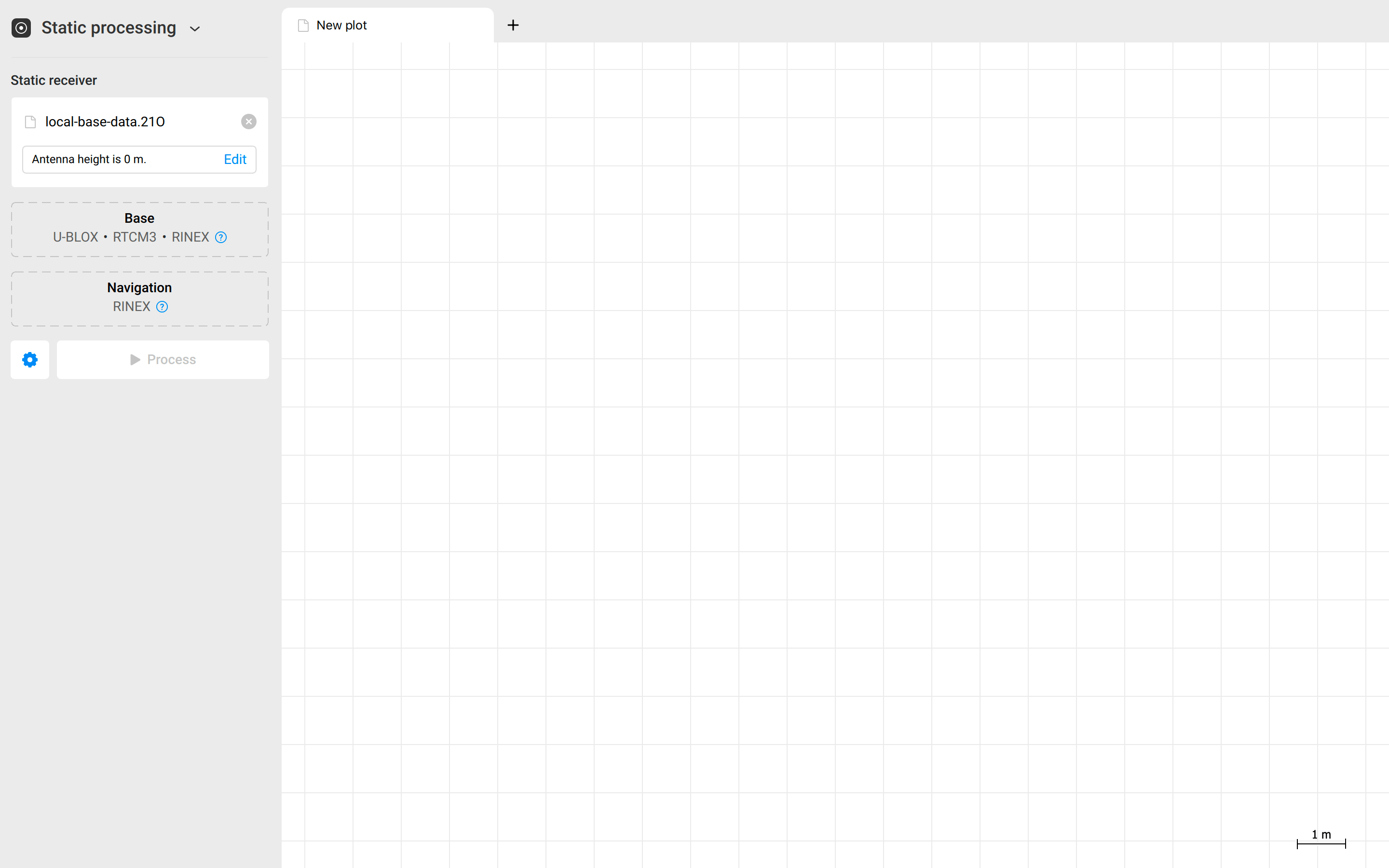

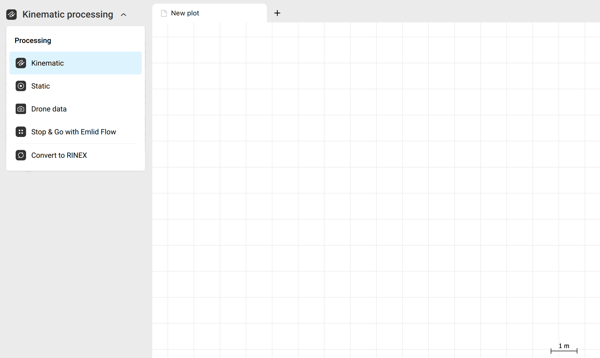

  1. Select the workflow from the drop-down list in the upper-left corner.
  1. Add the RINEX observation file from the local base to the Static receiver field.

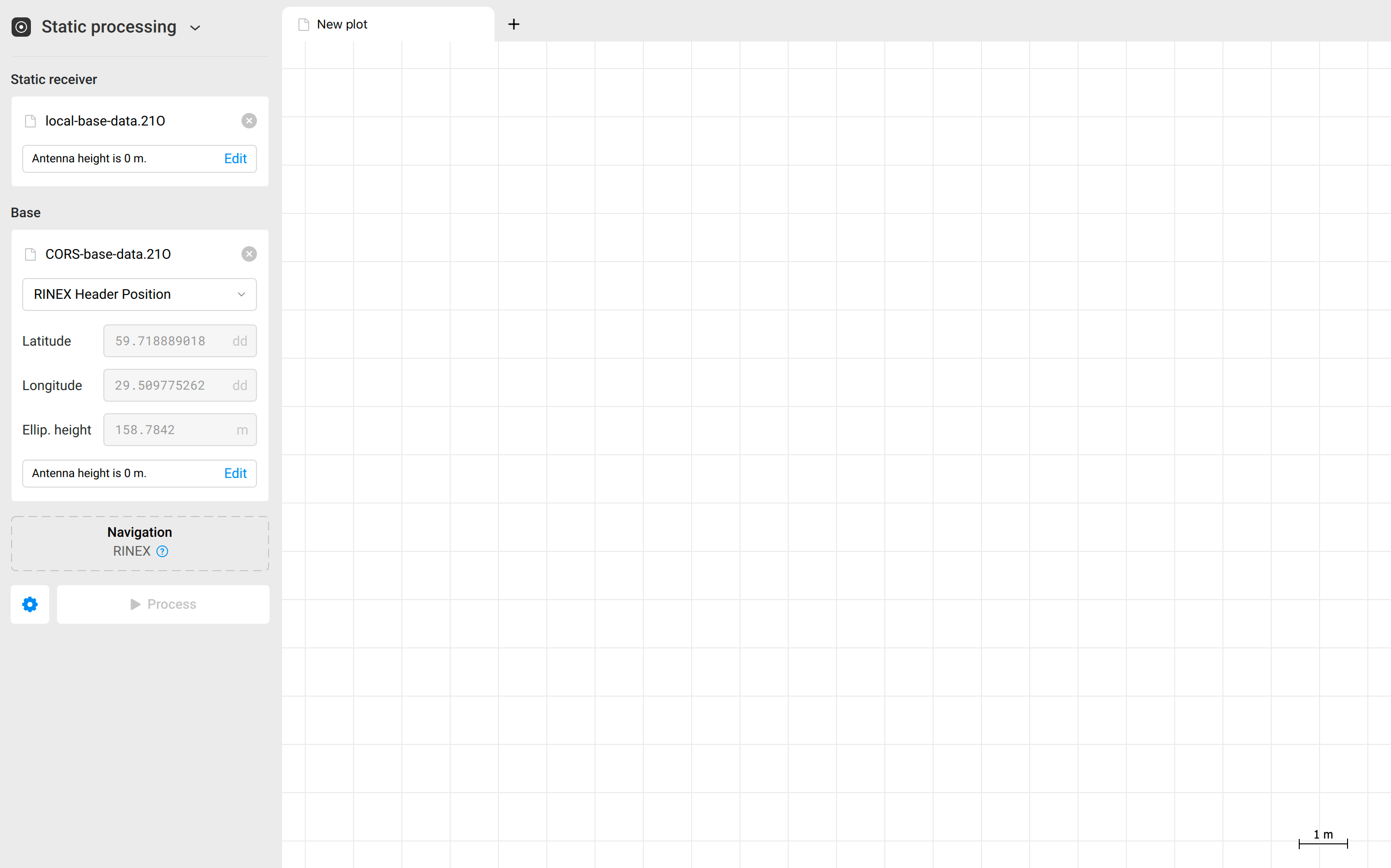

  2. Set the antenna height by clicking Edit.
    If you use antenna height for your static receiver, you need to fill in the same antenna height in the base field when continuing post-processing your survey data using the Kinematic processing, Drone Data PPK, Stop & Go with Emlid Flow workflows. This will ensure data consistency.

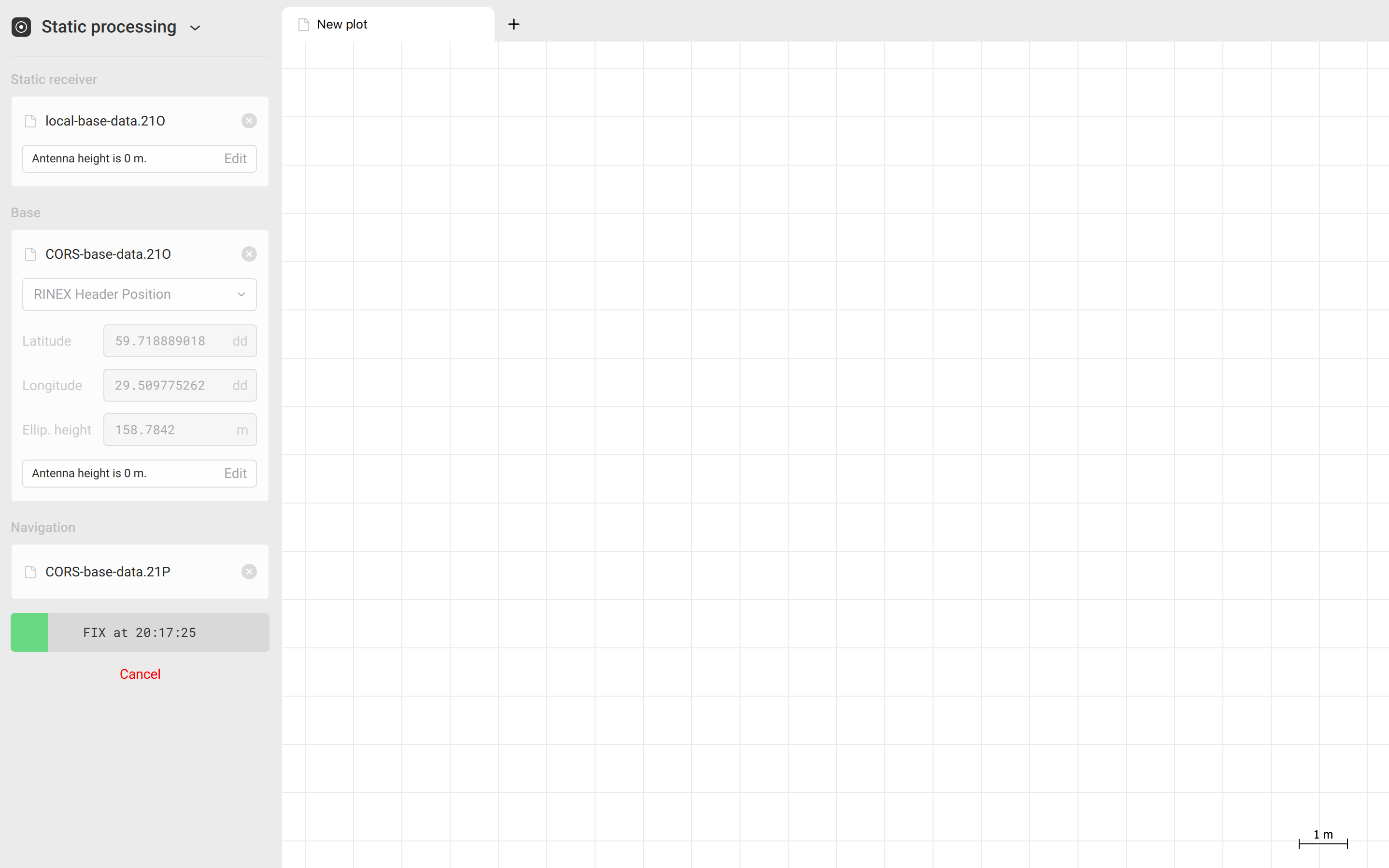

  3. Add the RINEX observation file from the CORS to the Base field. You will see the CORS coordinates.
    By default, the RINEX Header Position is used.
  4. Add the RINEX navigation file from the local base or from the CORS.
  5. Click Process. You will see the progress bar in the bottom left corner.

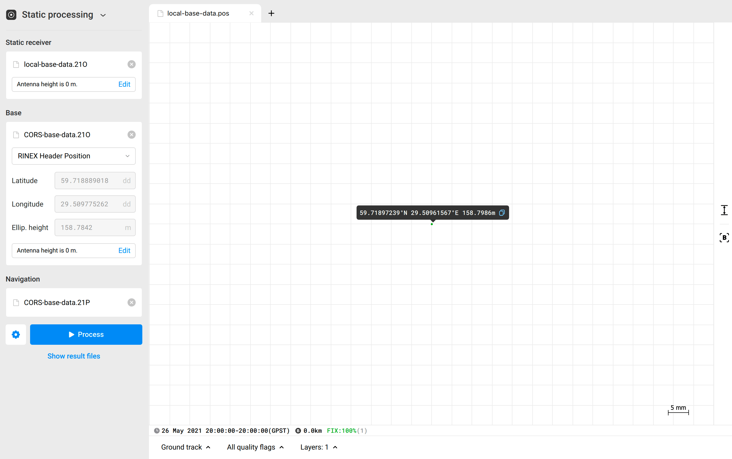

  6. Once the processing is finished, Emlid Studio will show you the processed point on the plot.
    To check the local point's coordinates, just click on it on the plot.
    You can also find the coordinates of your local base in the generated .pos file. Click the Show result files button to move to the resulting folder.
    If you want to continue post-processing using the obtained .pos file, you can simply drag and drop the obtained position of your local base from the plot to the base’s field in the required workflow.
