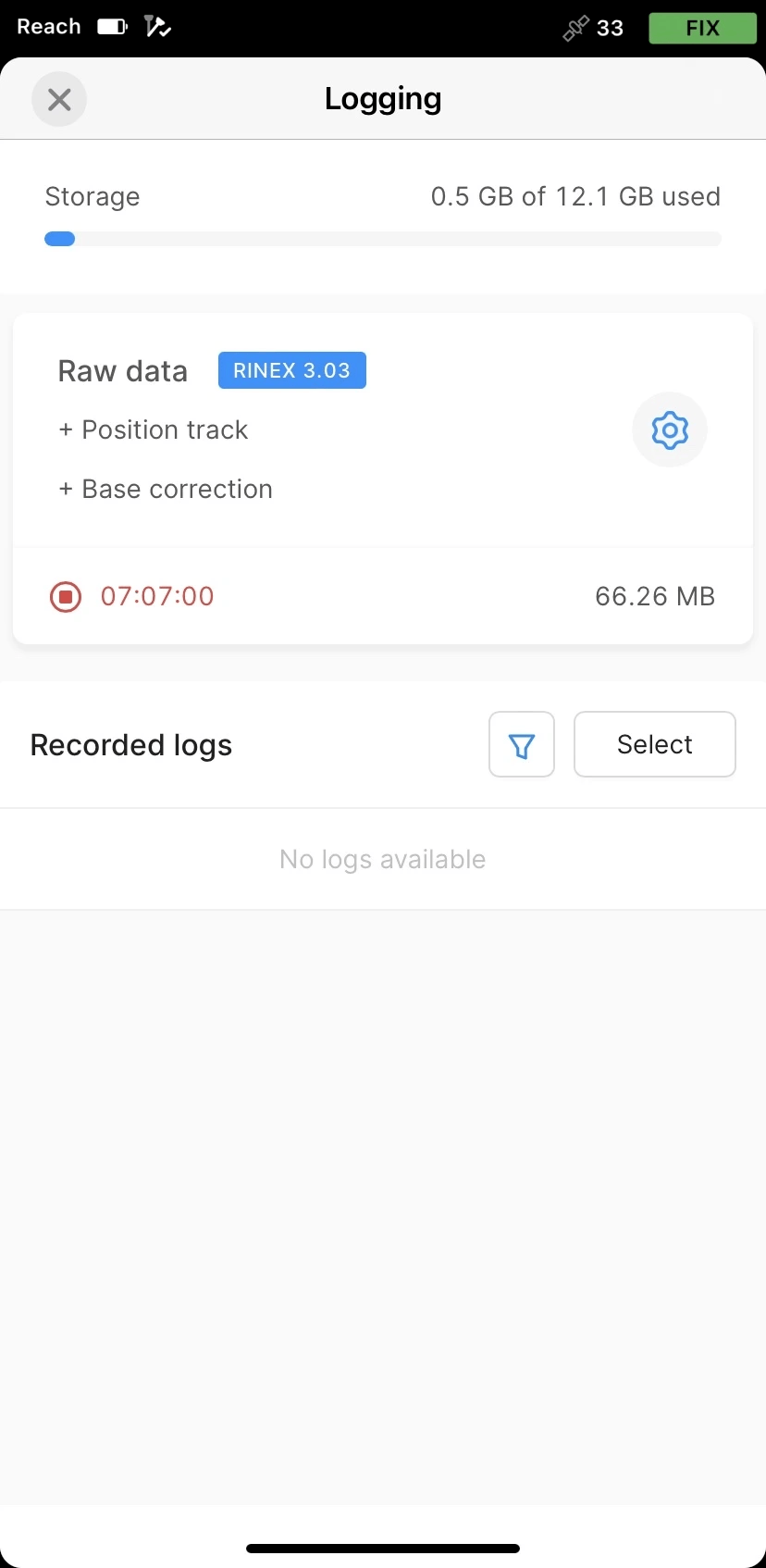

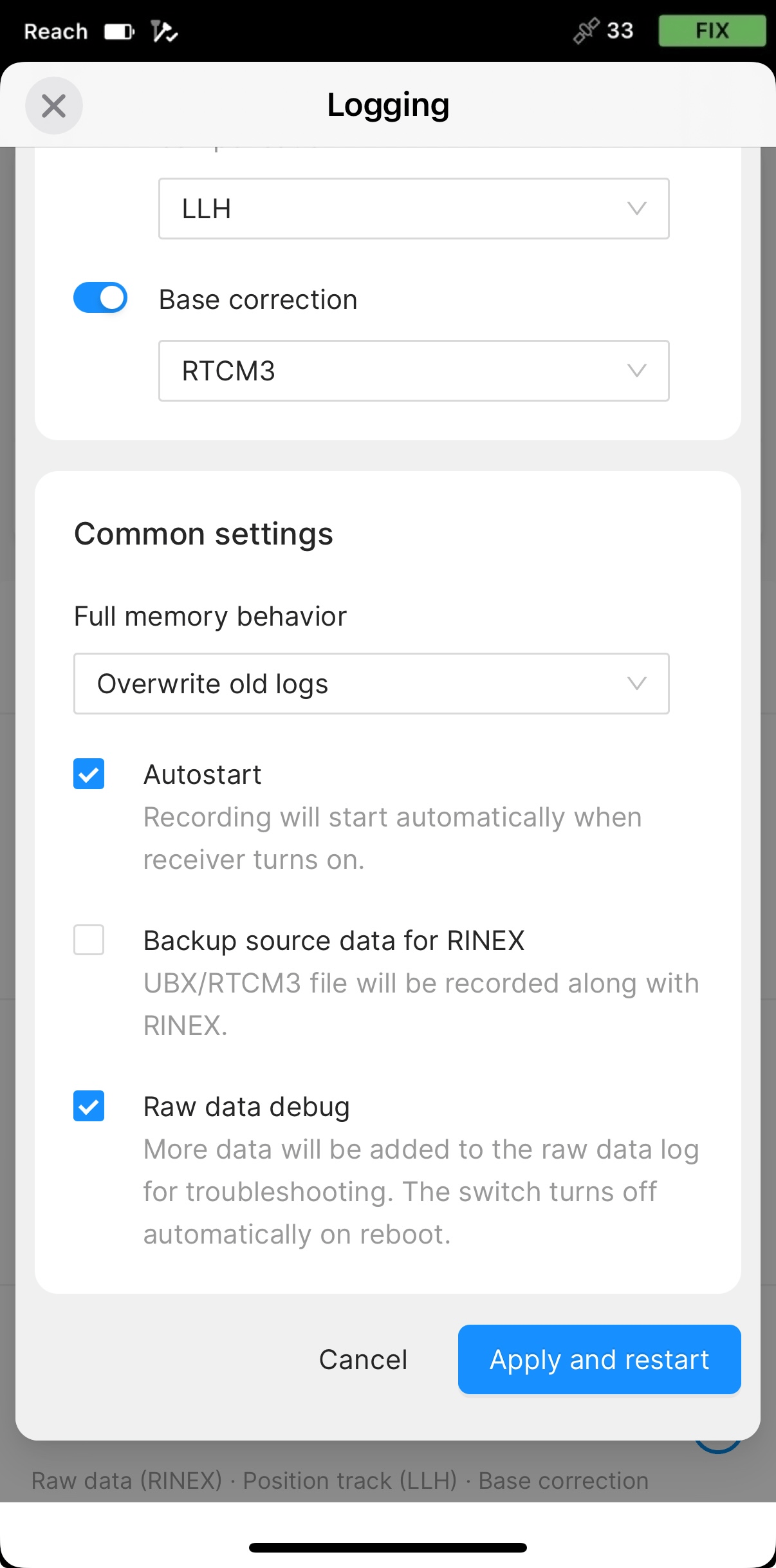

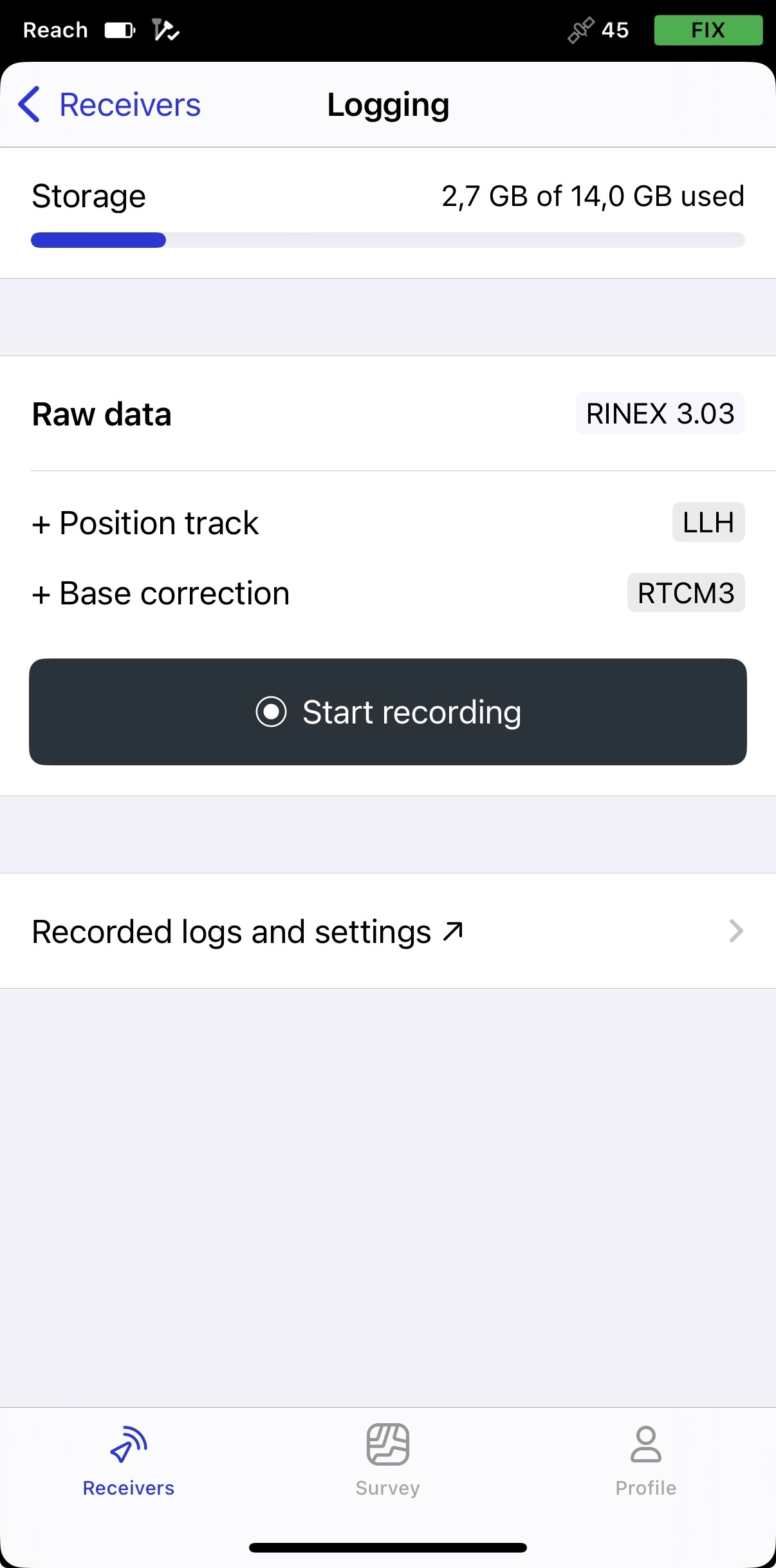

To record logs for AUSPOS, perform the following steps:
  2. Go to the Logging screen.
  3. Tap the Recorded logs and settings button.
  4. To configure logging, tap the blue gear button.

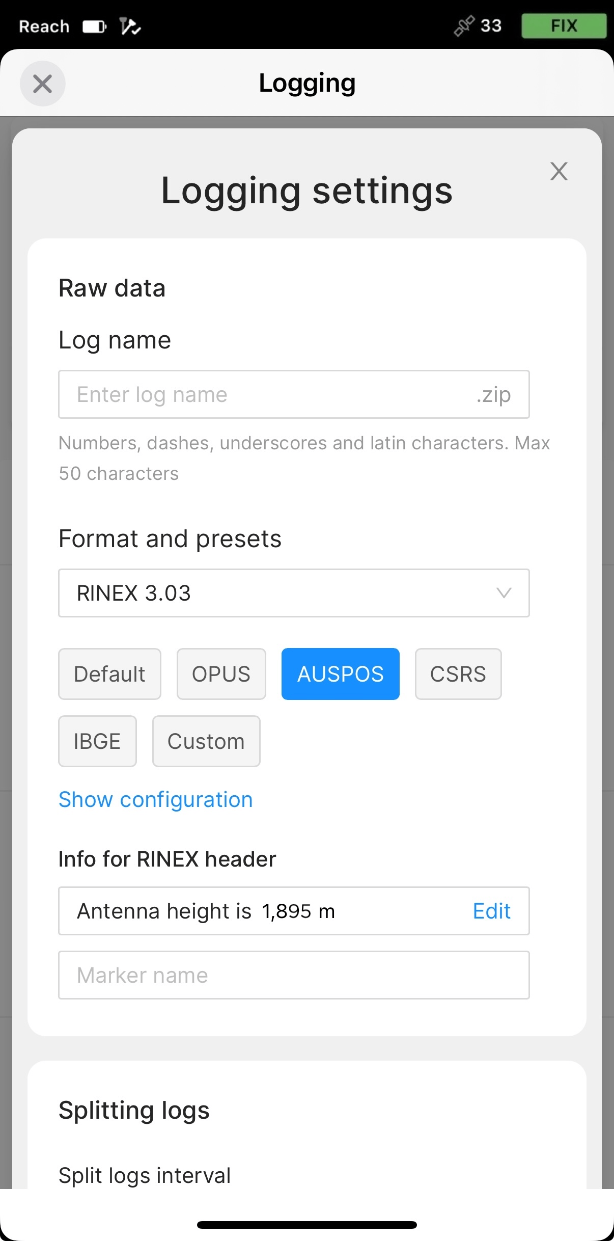

  5. Enter the log name.
  6. Select the AUSPOS preset.
  7. Choose the required RINEX format in the Raw data section.
  8. Enter the measured height to the bottom of the receiver in the corresponding field.
  9. Fill in the point's name in the Marker name field.
  10. Tap Apply and start.

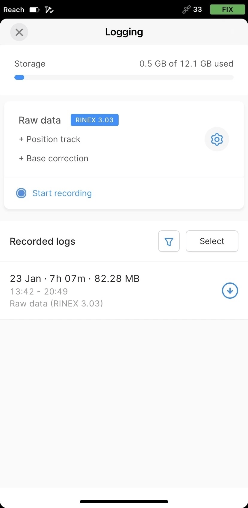

  11. Enable log recording by tapping the Start recording button.
    AUSPOS requires recording the data for at least 4 hours to get the best accuracy.
  12. To finish recording logs, tap the End recording button.
Downloading logs​
  1. Go to the Logs section at the bottom of the Logging screen.

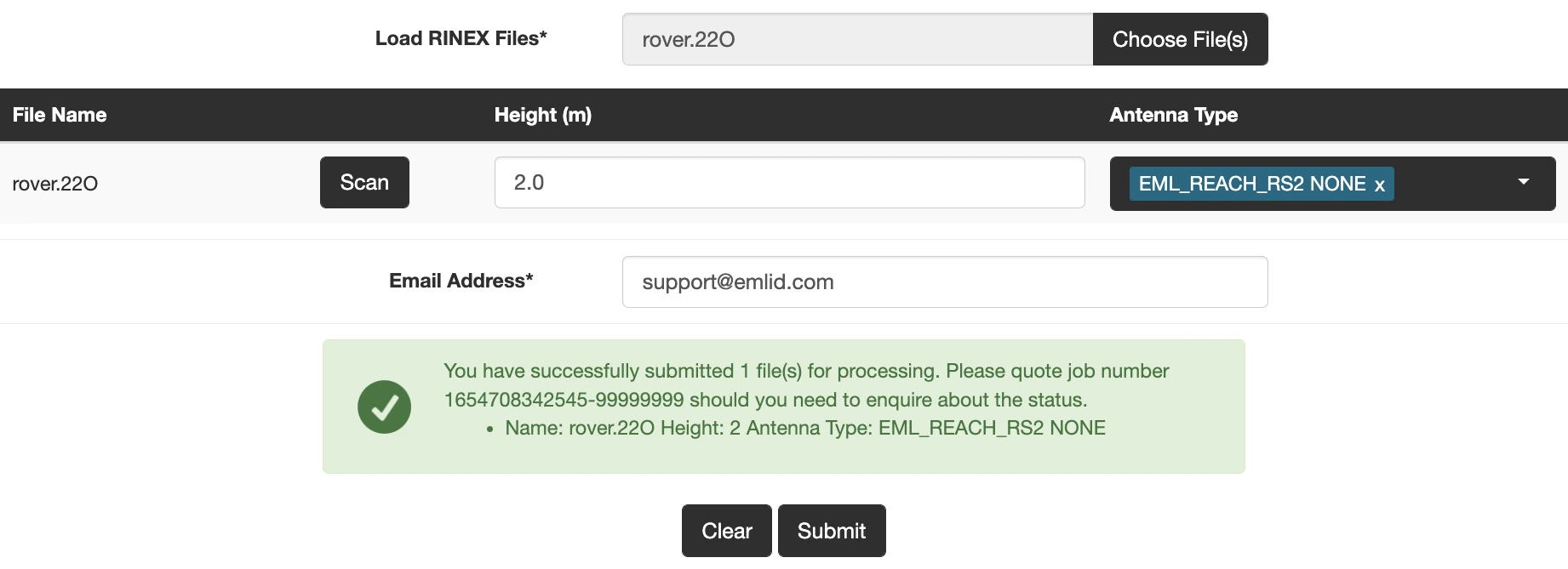

  1. Go to the AUSPOS submission page.
  2. In the Load RINEX Files field, click the Choose File(s) button and browse for the observation file (.**O). You can upload up to 20 files at once.
    The observation file name should not contain any special characters, symbols, or spaces. Otherwise, the file will be rejected.
  3. Enter the pole height in the Height (m) field.
  4. Choose EML_REACH_RS4 NONE in the Antenna Type field.
  5. In the Email Address field, enter your email address to get the results.
  6. Click Submit.
AUSPOS will assign the job number to your submission and send the file with the solution to your email address.

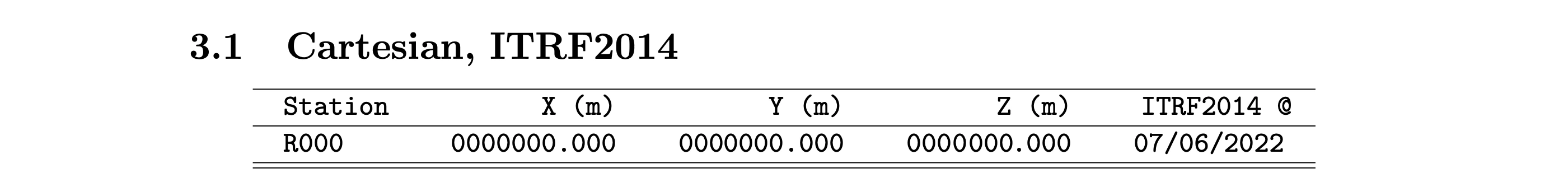

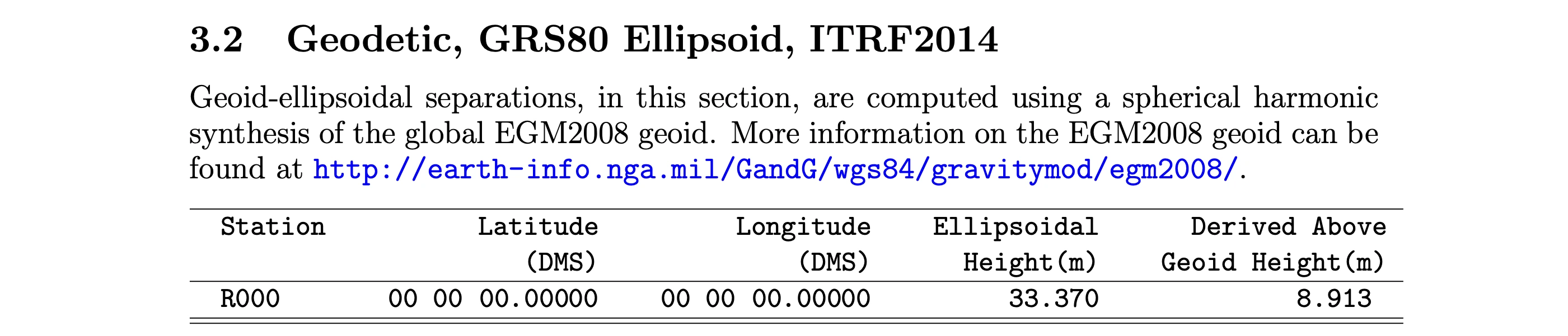

Assessing AUSPOS results​

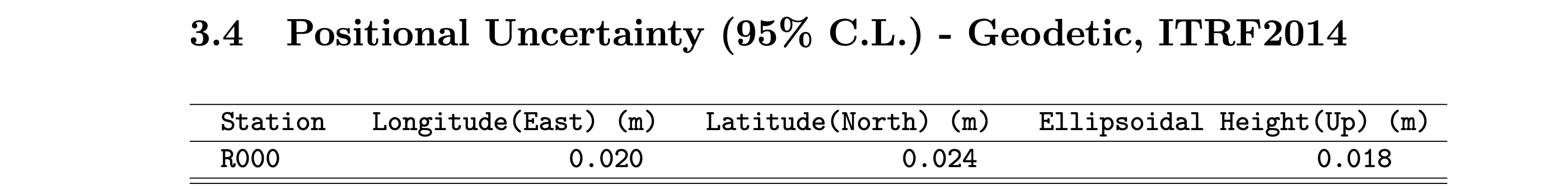

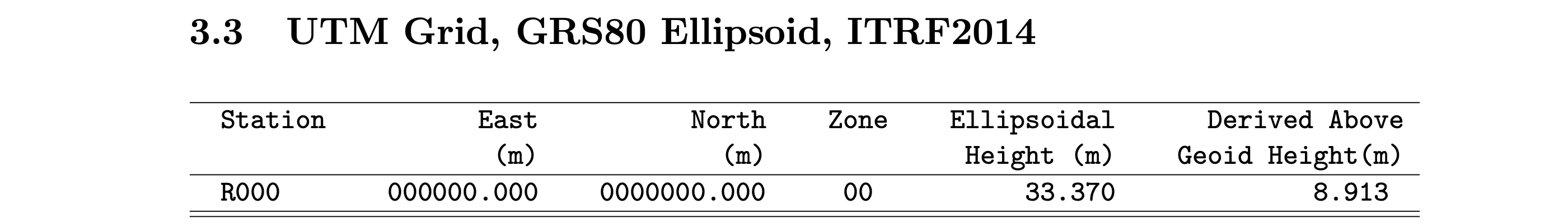

In the solution report, you will get the following information:
  • Computed coordinates in 3 different formats:
    • Cartesian (XYZ)
    • Geodetic (LLH)
    • UTM Grid
  • Positional uncertainty showing the estimated accuracy of the computed coordinates
Additionally, you can check the ambiguity resolution for every reference station used in the computation.
After you get the solution report, it might be useful to check how accurate the results are. The most accurate AUSPOS solutions have no warning messages in the report.

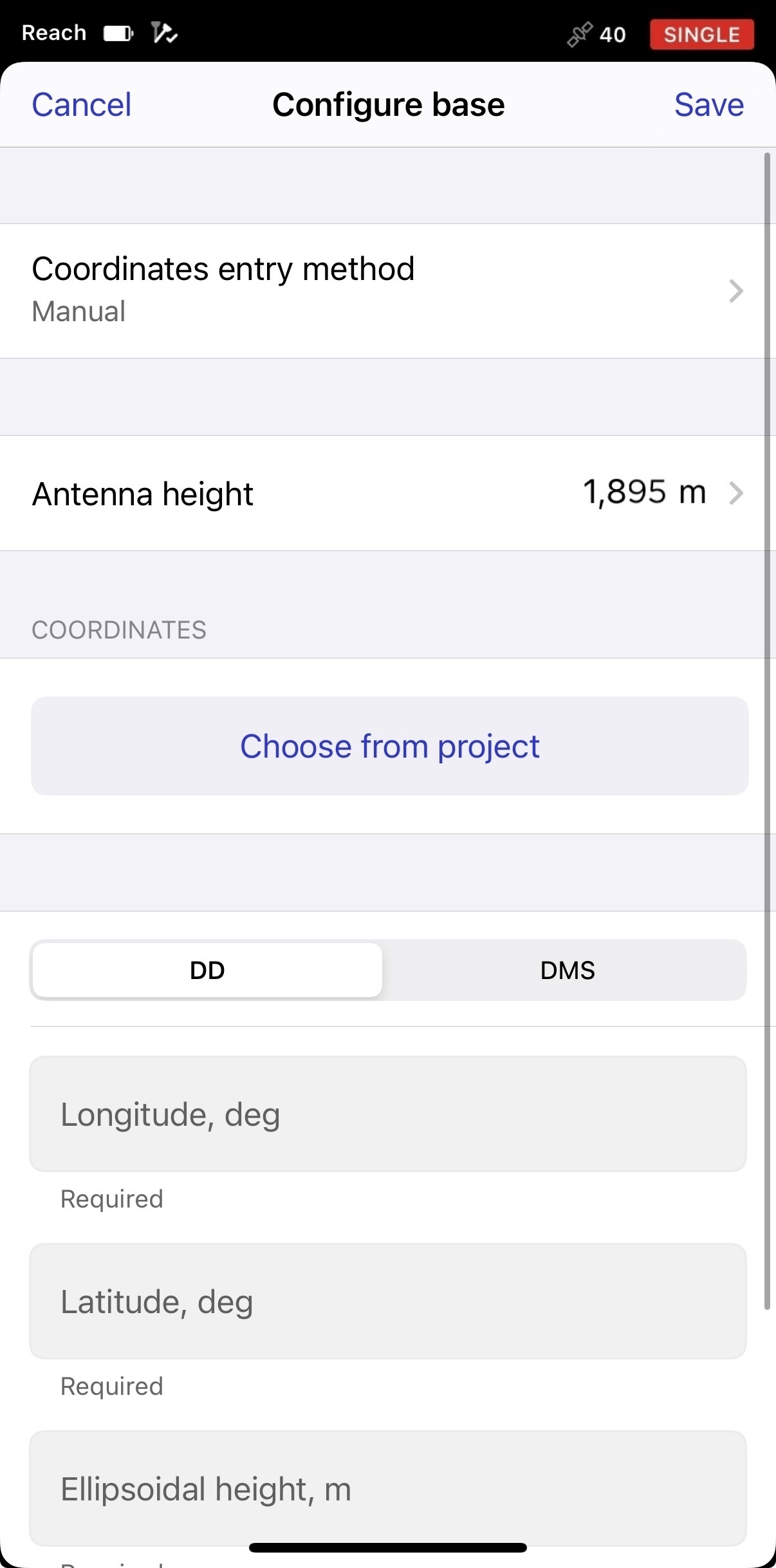

Setting up obtained base coordinates in Emlid Flow​
If you want to use the obtained coordinates as a base position, you can enter the base coordinates in Emlid Flow.
  1. Open Emlid Flow and connect to the Reach you want to use as a base.
  2. On the Receivers screen, tap Base settings.
  3. Tap the Configure button.
  4. Set the Coordinates entry method to Manual.
  5. Specify the antenna height and enter the coordinates.
  1. Tap Save.
After setting up the base position, you can continue working in RTK or PPK.
