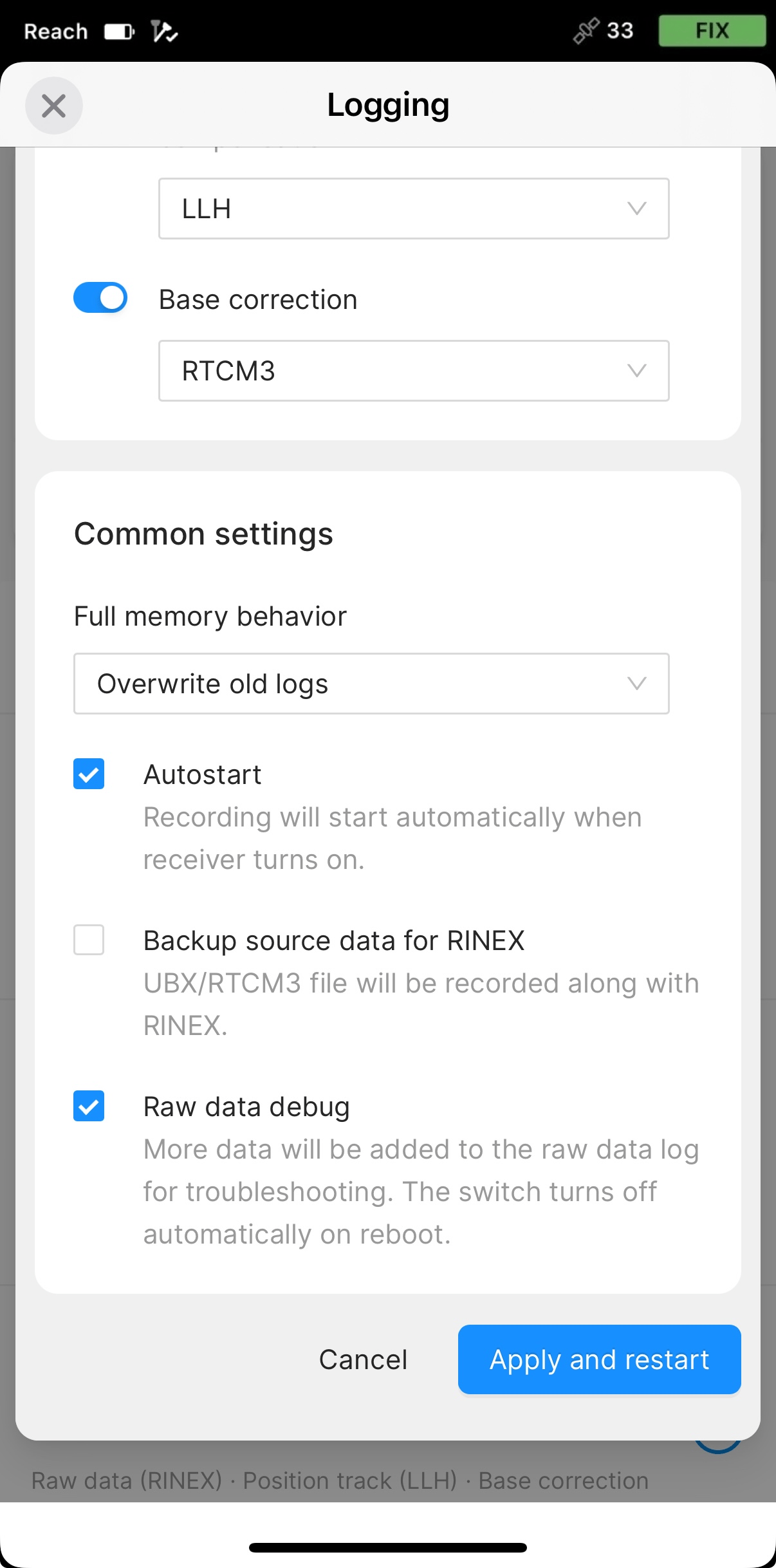

To record logs for OPUS, follow the steps below:

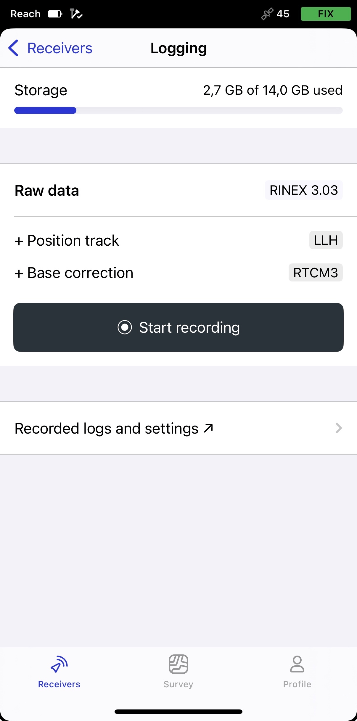

  2. Go to the Logging screen.
  3. Tap the Recorded logs and settings button.

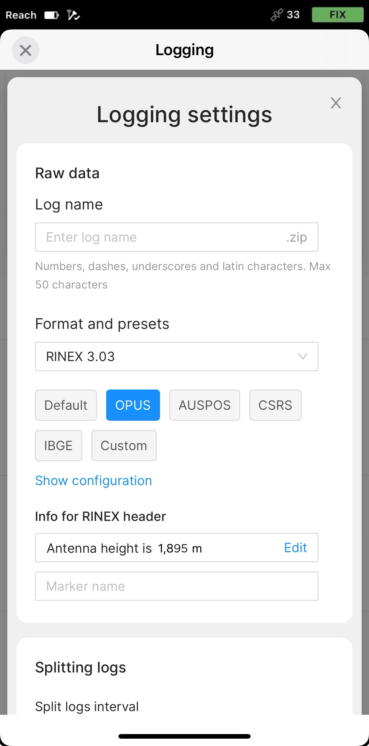

  4. To configure logging, tap the blue gear button.
  5. Enter the log name.
  6. Select the OPUS preset.
  7. Choose the required RINEX format in the Raw data section.
  8. Enter the measured height to the bottom of the receiver in the corresponding field.
  9. Fill in the point's name in the Marker name field.
  10. Tap Apply.

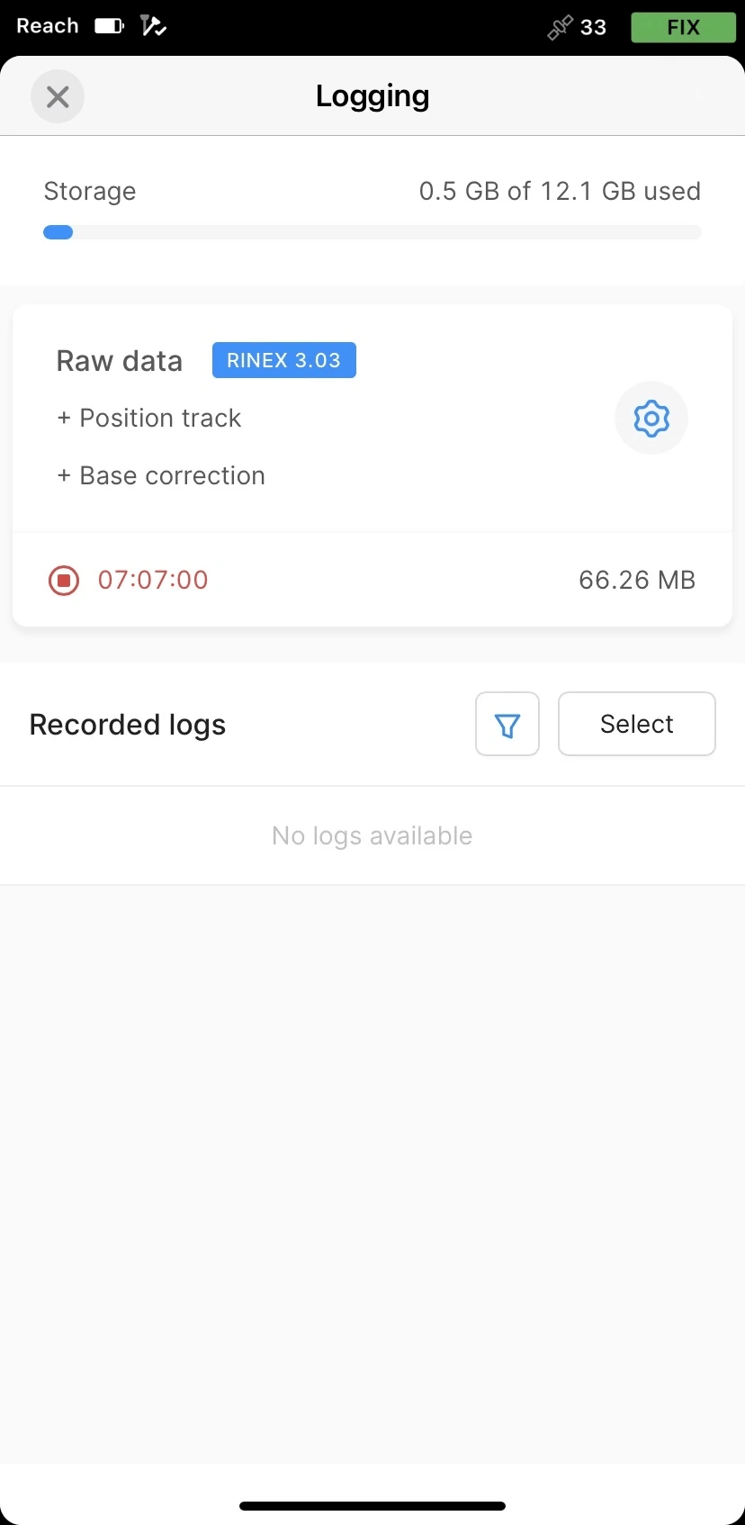

  11. Enable log recording by tapping the Start recording button. The red recording icon will appear in the status bar.
    NOAA’s OPUS requires recording the data for at least 4 hours to get the best accuracy.

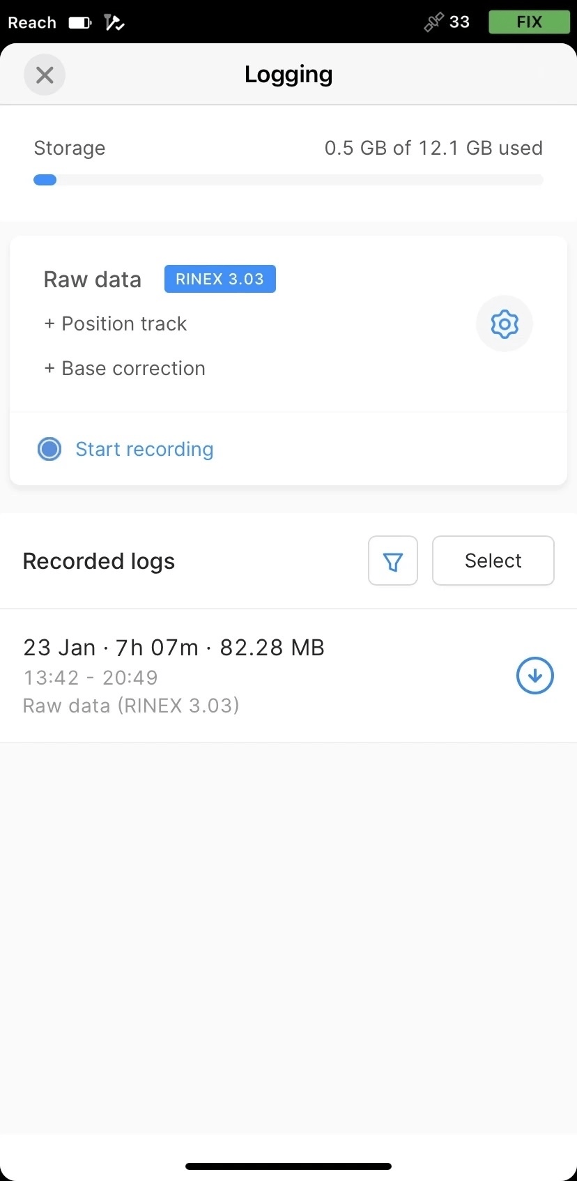

  12. To finish recording logs, tap the End recording button.
Downloading logs​

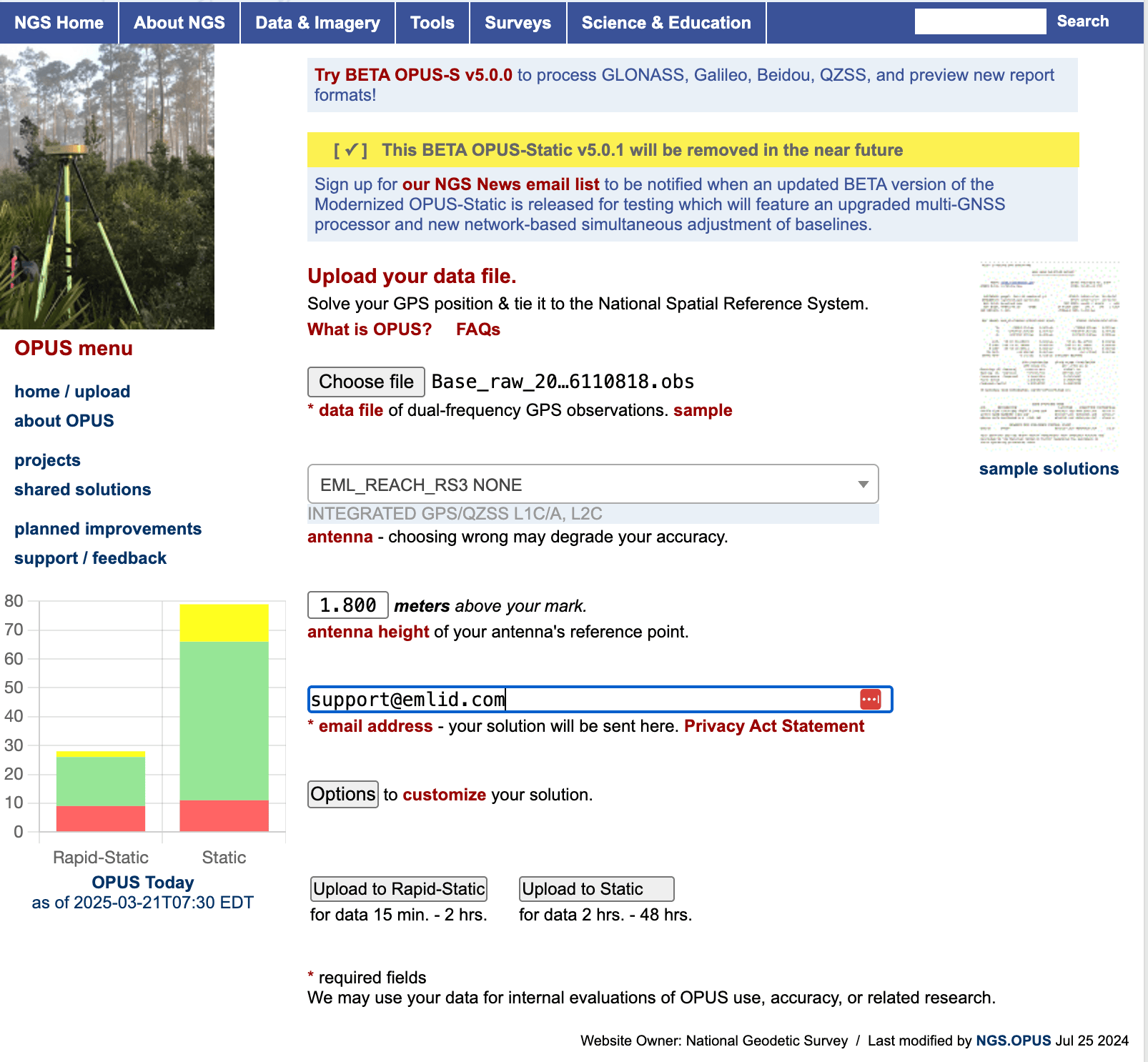

  1. Go to the NOAA's OPUS site submission page.
  2. Click on the Choose file button and browse for the observation file (.**O).
  3. Choose EML_REACH_RS4 NONE in the Antenna field.
  4. Type a pole height in the Antenna Height field.
  5. In the email address field, enter your email address to get the results.
  6. Click on the Upload to Static button.
OPUS will send the file with the solution to your email address.

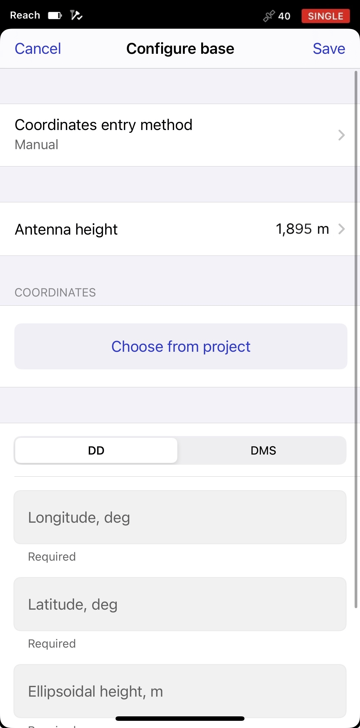

If you want to use the obtained coordinates as a base position, you can enter the base coordinates in Emlid Flow.
  1. Open Emlid Flow and connect to the Reach you want to use as a base.
  2. On the Receivers screen, tap Base settings.
  3. Tap the Configure button.
  4. Set the Coordinates entry method to Manual.
  5. Specify the antenna height and enter the coordinates.
  1. Tap Save.
