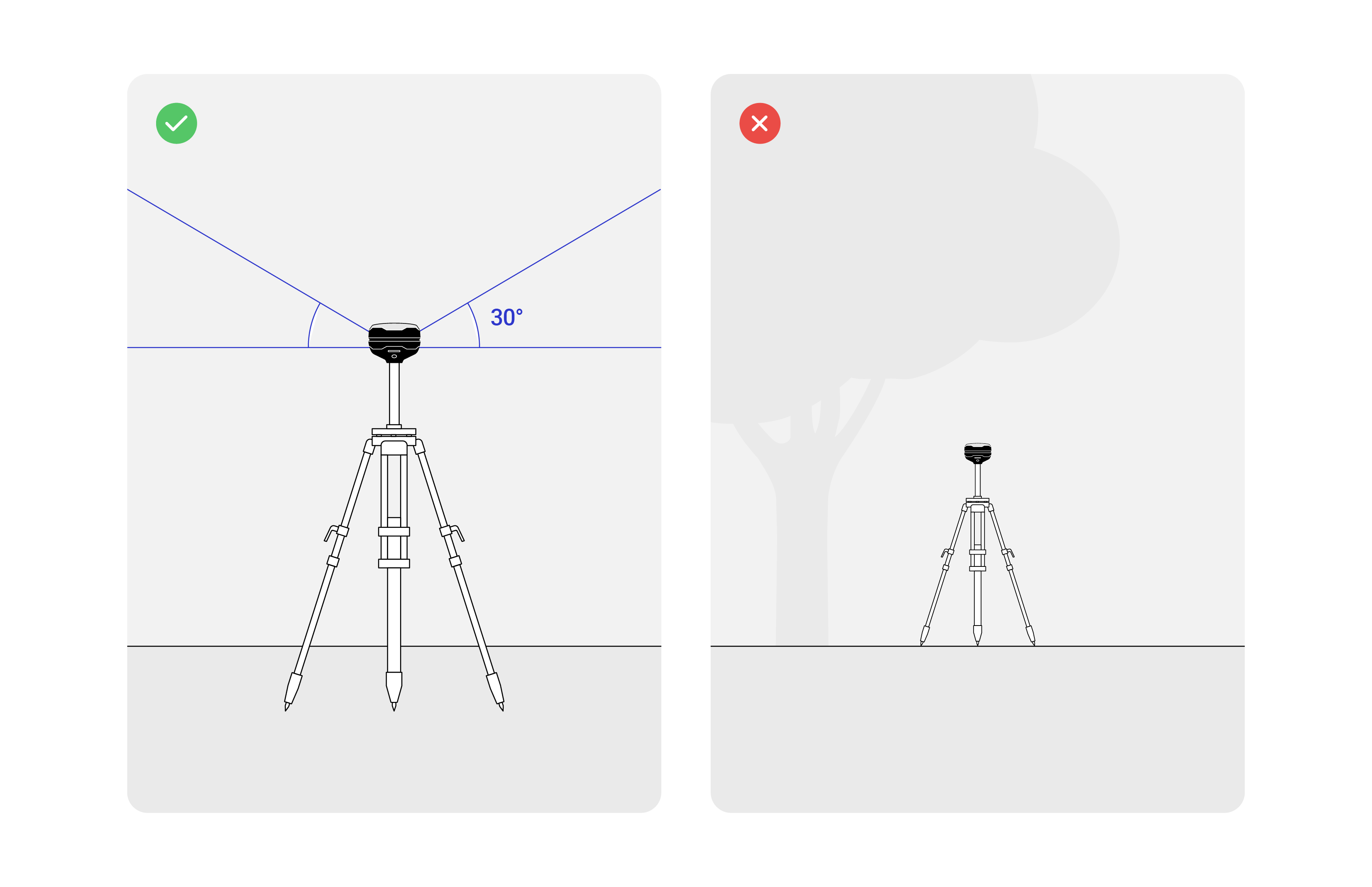

You can place your smartphone near the window in your house and it will obtain GNSS coordinates after some time, but for RTK such an environment won't be sufficient. For RTK to work there are special requirements for placing the base.
Clear sky view without any obstacles​
Reach needs to have a clear sky view 30 degrees above the horizon. There should be no obstacles that could block the view like buildings, trees, cars, humans, laptops, etc.
Take a look at the 2 pictures below. The left picture demonstrates desirable conditions for Reach location. The right one is an example of bad surrounding conditions such as the reduced view of the sky, possible obstructions or vegetation nearby.
Examples of good environments for Reach placement:
  • field
  • top of the hill
  • rooftop
Examples of bad environments for Reach placement:
  • indoors
  • urban area
  • forestry area
