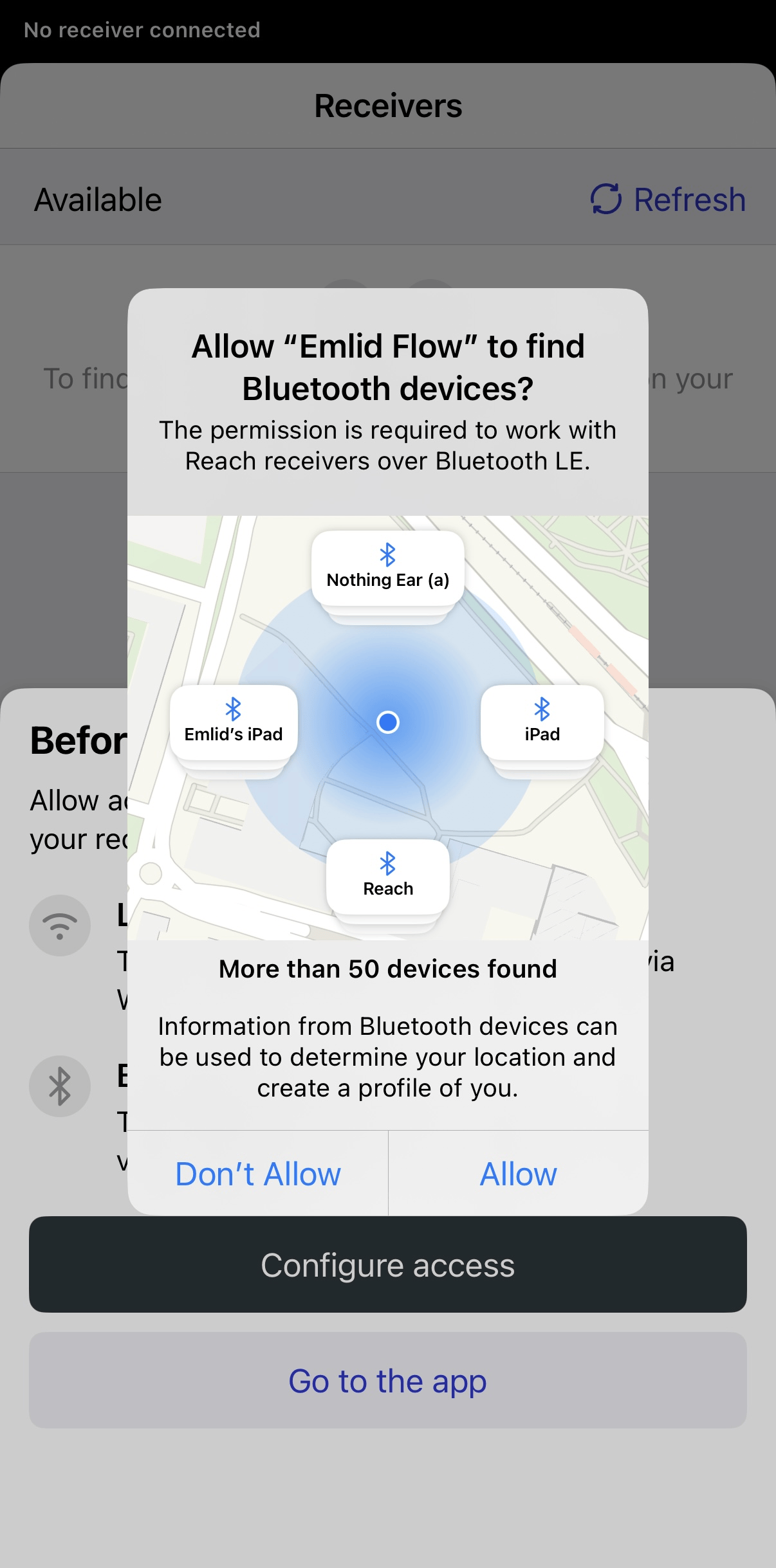

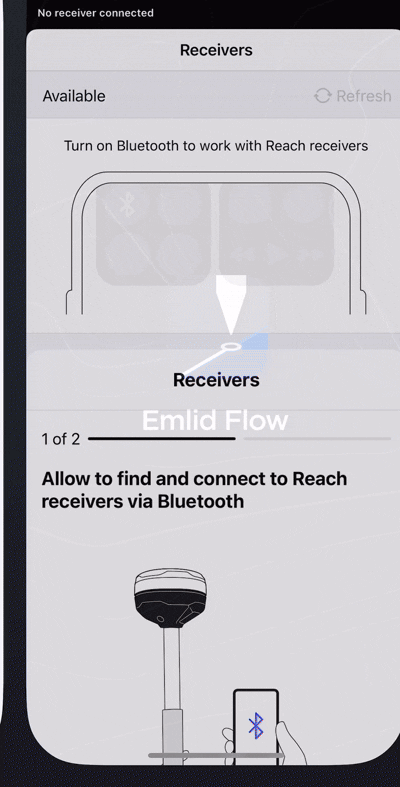

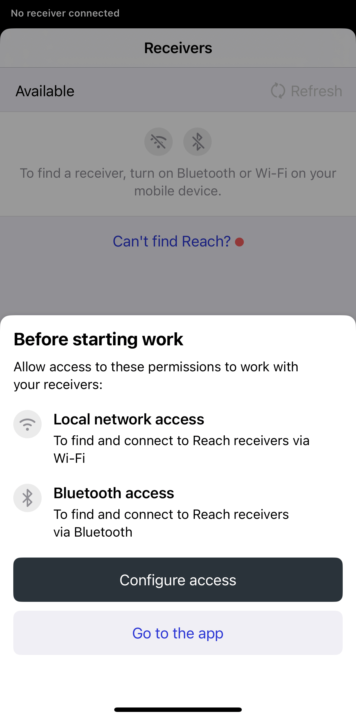

Open the Emlid Flow app. When prompted, do the following depending on the platform:

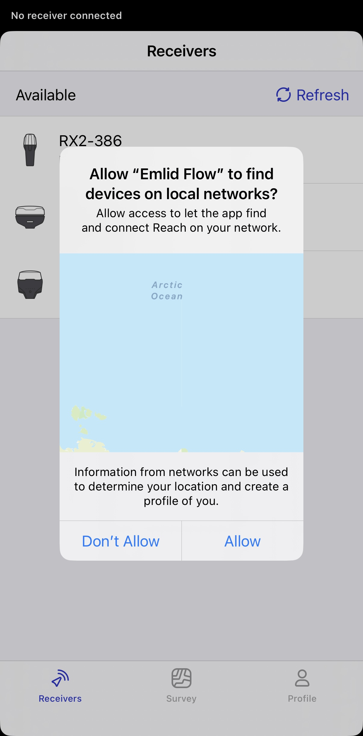

On iOS, allow Bluetooth access so the app can find and connect to Reach receivers. Then, allow local network access so it can discover and connect to Reach receivers over Wi-Fi.
On Android, allow Bluetooth access so the app can find and connect to Reach receivers. Then, allow notifications to help maintain the connection and receive corrections from the receiver.
noteThe required permissions may vary between Android versions. Devices running Android 12 and earlier typically require fewer permissions than Android 13 and later.

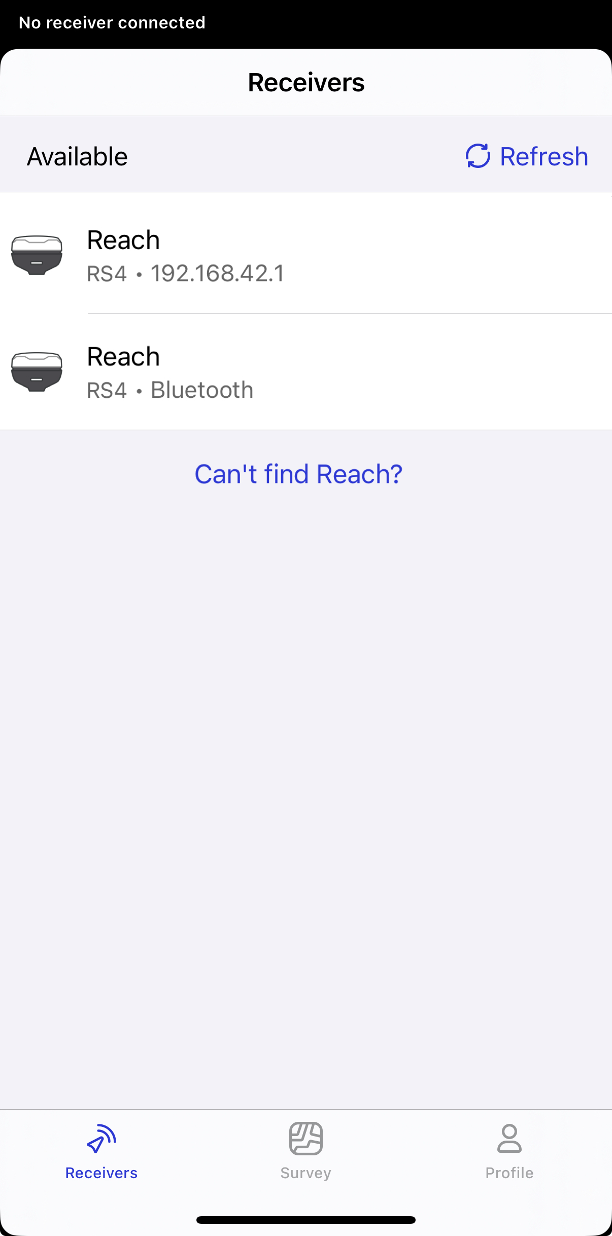

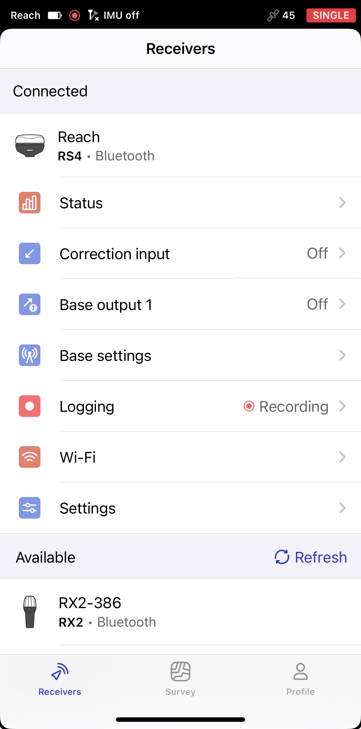

These permissions are required for full receiver functionality. After you grant them, the receiver will appear in the list and the app will connect to it automatically. If multiple Reach receivers are available, tap the receiver you want to connect to and wait for the connection to complete.
Once connected, check for firmware updates. If an update is available, a red dot will show next to the Settings section. Update the receiver firmware.

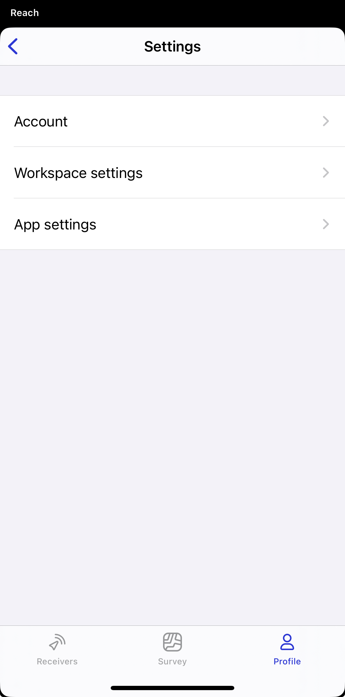

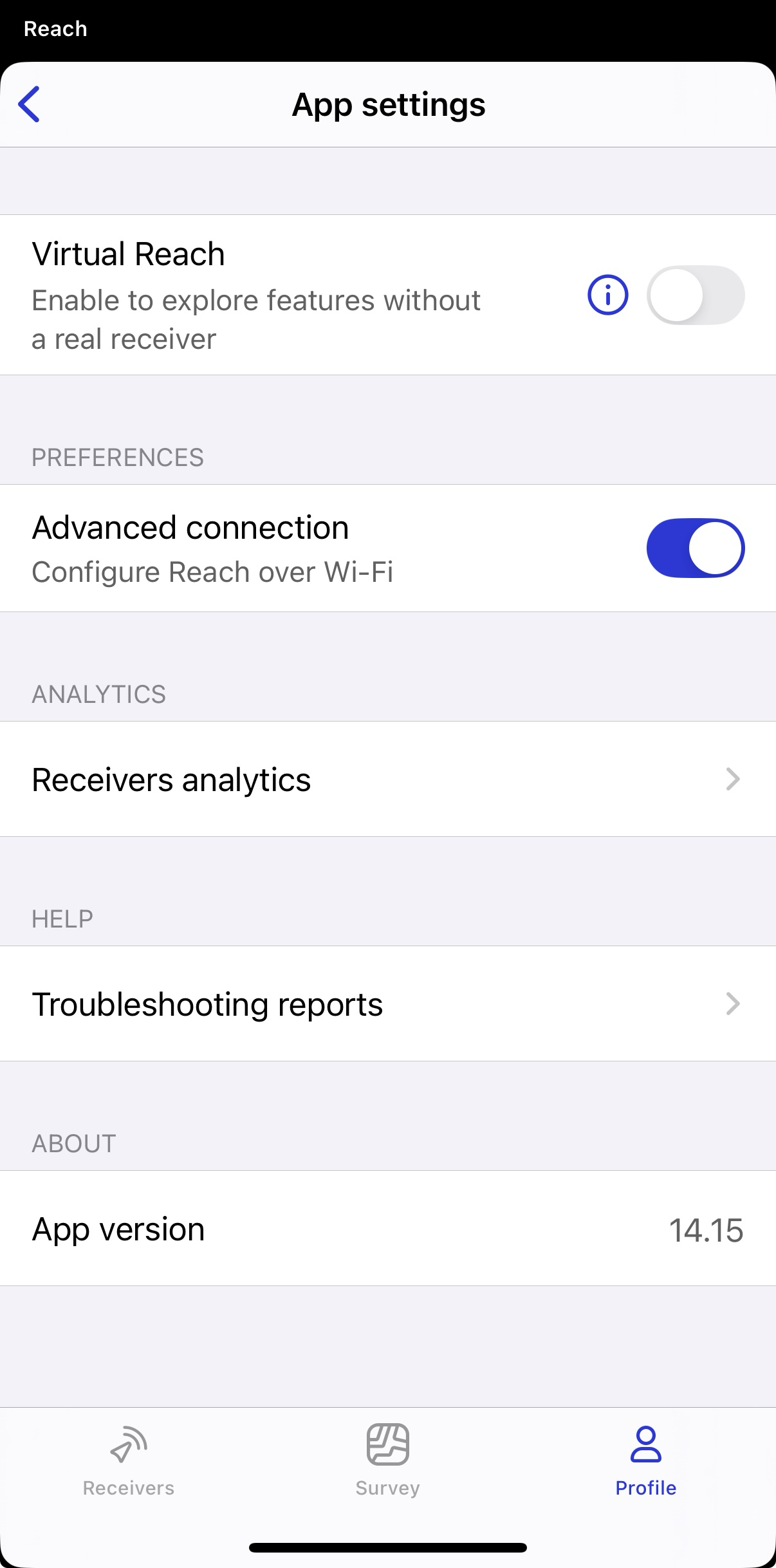

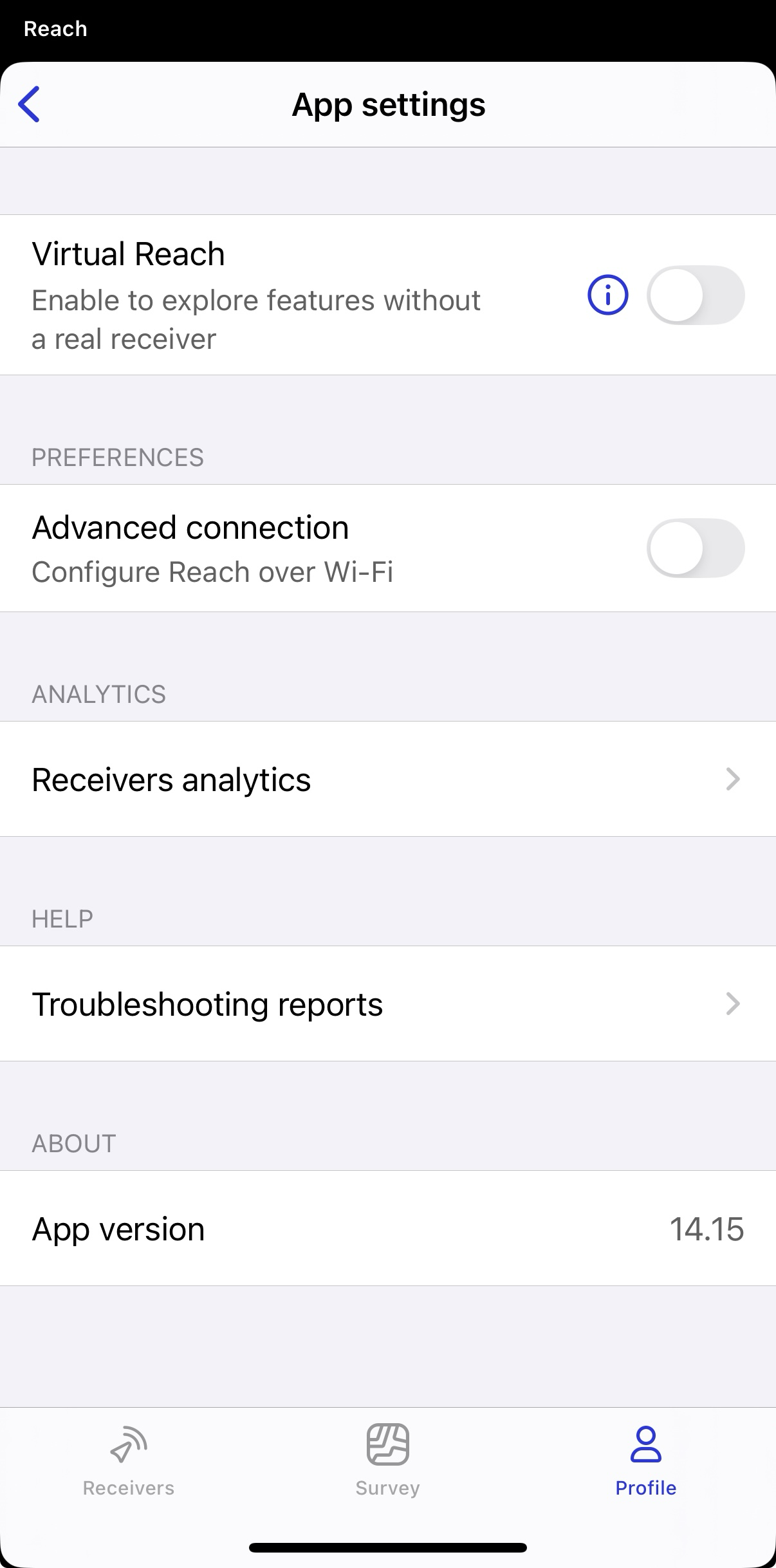

When connected via Bluetooth in Emlid Flow, go to the Profile tab and tap App settings.
In the Preferences section, enable advanced connection to configure Reach over Wi-Fi.

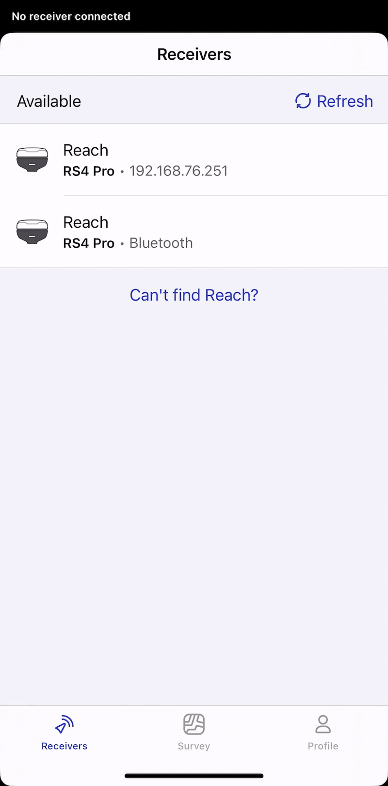

In Emlid Flow, return to the Receivers list and select the Wi-Fi connection option identified by the receiver’s IP address.
noteThe available connection options depend on whether Bluetooth and Wi-Fi are enabled on your mobile device.
