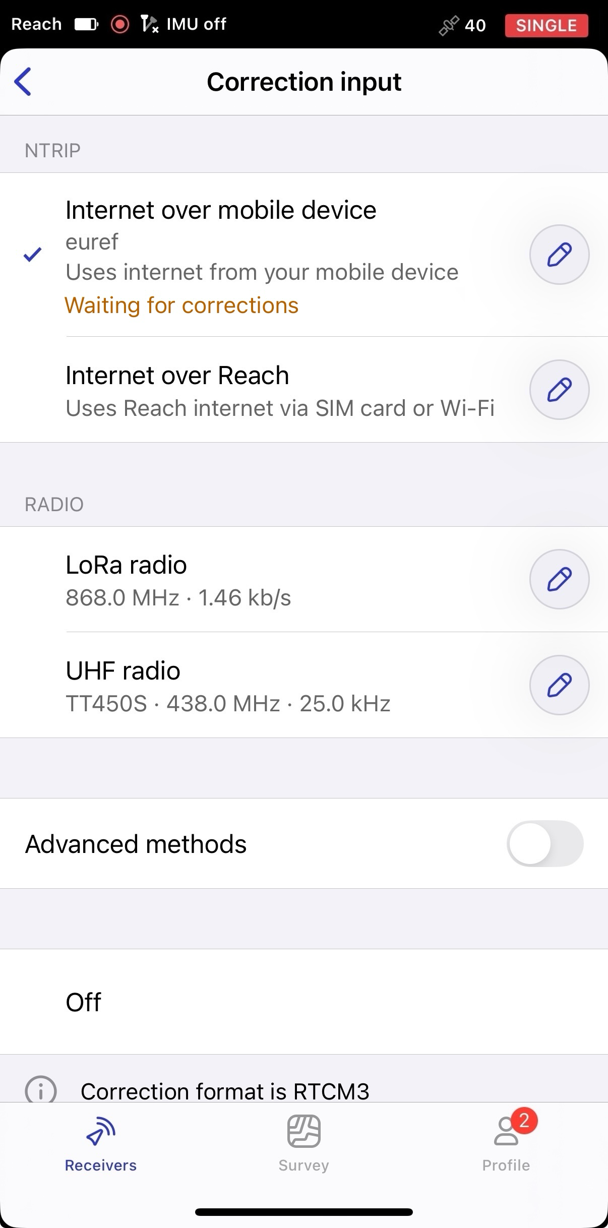

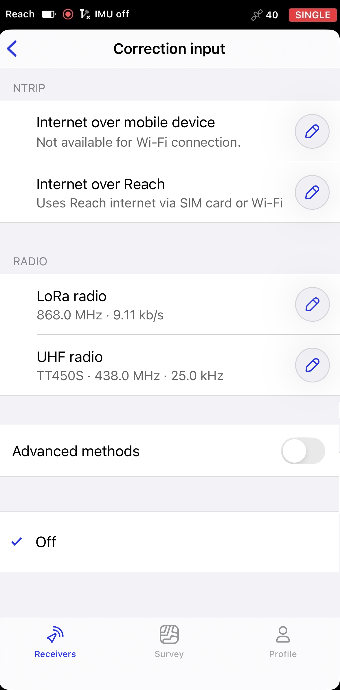

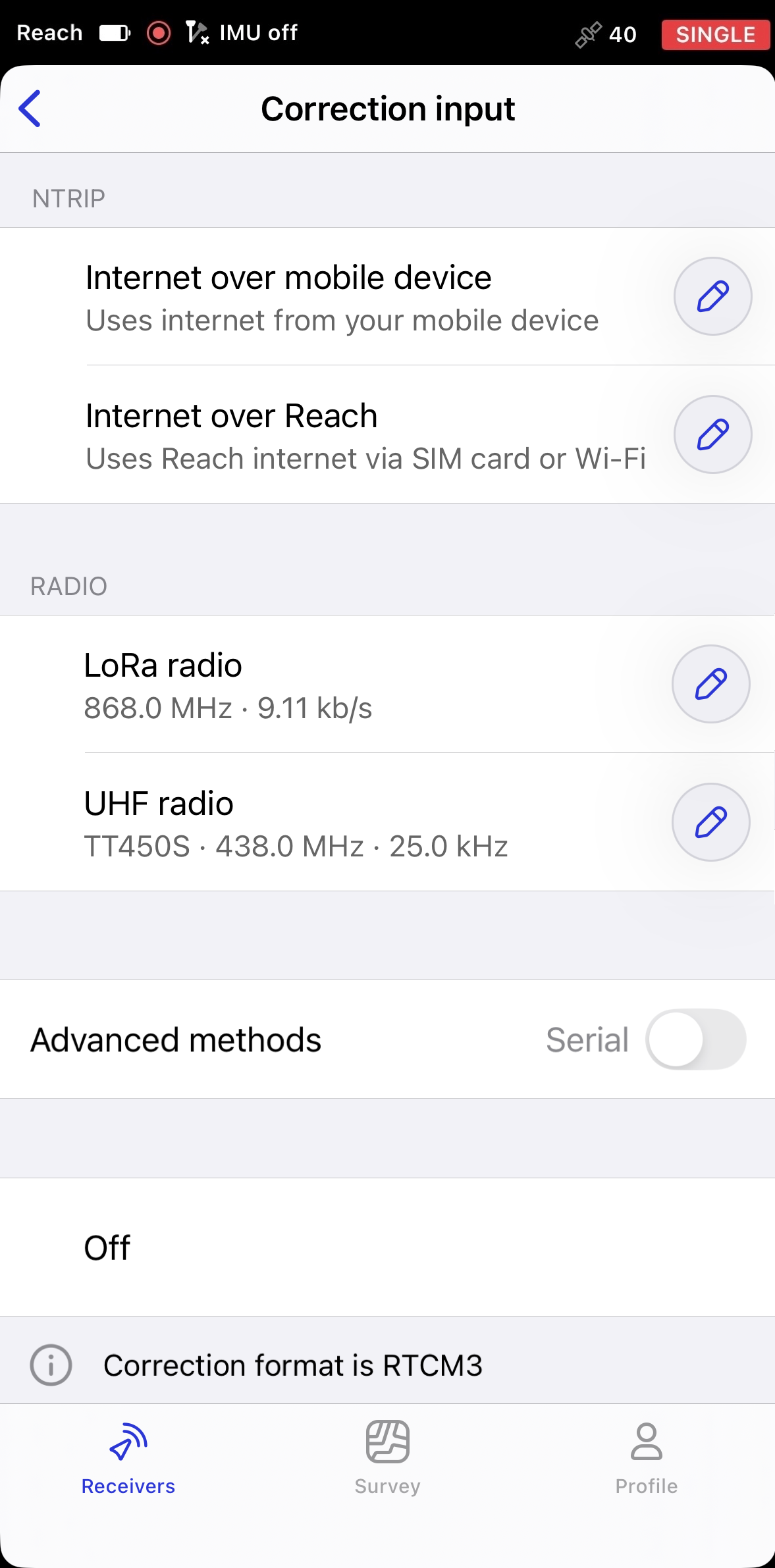

Go to the Correction input screen.
In the NTRIP section, select how the receiver will receive corrections from an NTRIP provider. The available options depend on how your mobile device is connected to the receiver.
- Bluetooth connection
- Hotspot connection
If you connected to the receiver via Bluetooth, you have two options:
Pick NTRIP via mobile device to use your phone's or tablet's internet connection. This is a recommended method which requires no setup.
Pick NTRIP via Reach to use the receiver’s internet connection via a SIM card or Wi-Fi network. In this case, you can provide internet access using one of the following methods:
- Connecting Reach to internet via built-in modem
- Connecting Reach to internet via Wi-Fi
- Connecting Reach to internet via mobile hotspot
tipYou can also choose Emlid Corrections, Emlid's built-in VRS RTK corrections service for compatible Reach receivers. It includes one year of free service for both existing and newly purchased compatible devices. For coverage area and setup instructions, see the Emlid Corrections documentation.
When using NTRIP, Dynamic status messages provide setup guidance and display the current correction input status, so you can quickly determine whether any action is required.
If you connected to the receiver via its hotspot, you need to connect the receiver to the internet via an external Wi-Fi network or a SIM card using one of the following methods:
Tap Add profile and enter the credentials and connection details provided by your NTRIP service provider:
Address: The URL or IP address of the NTRIP caster.
Port: The port used to connect to the caster. The default value is usually 2101 unless your provider specifies a different port.
Username: The username used to authenticate with the NTRIP service. In some cases, it may be your name or email address.
Password: The password associated with the username.
Mount Point: The name of the correction stream provided by the NTRIP service.
tipTo find out which mount point suits you better, check the website of your NTRIP provider. In general, shorter distances to the reference station improve RTK performance.
ANDROID KEYBOARD TECH TIPOn some Android devices, default keyboards do not provide a minus sign. To access it, we recommend downloading Gboard, a virtual keyboard app, from the Google Play Store.
noteIf you use a VRS service, you need to enable Send receiver's position to the provider.
Tap Save. If everything is configured correctly, the Waiting for corrections notification will appear first. Once the receiver has a clear sky view and satellite visibility, corrections should start within a few seconds.
You can add a required number of NTRIP profiles and choose between them right on the Correction input screen later.
