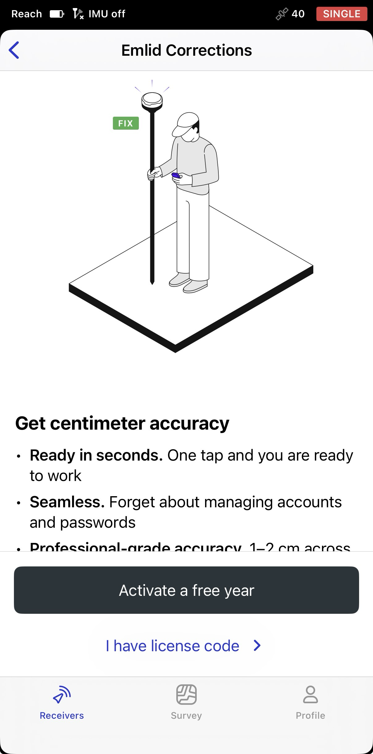

  1. Open Emlid Flow and connect to your Reach receiver via BLE.
  2. On the screen that opens after connecting, tap Activate now to start using Emlid Corrections.

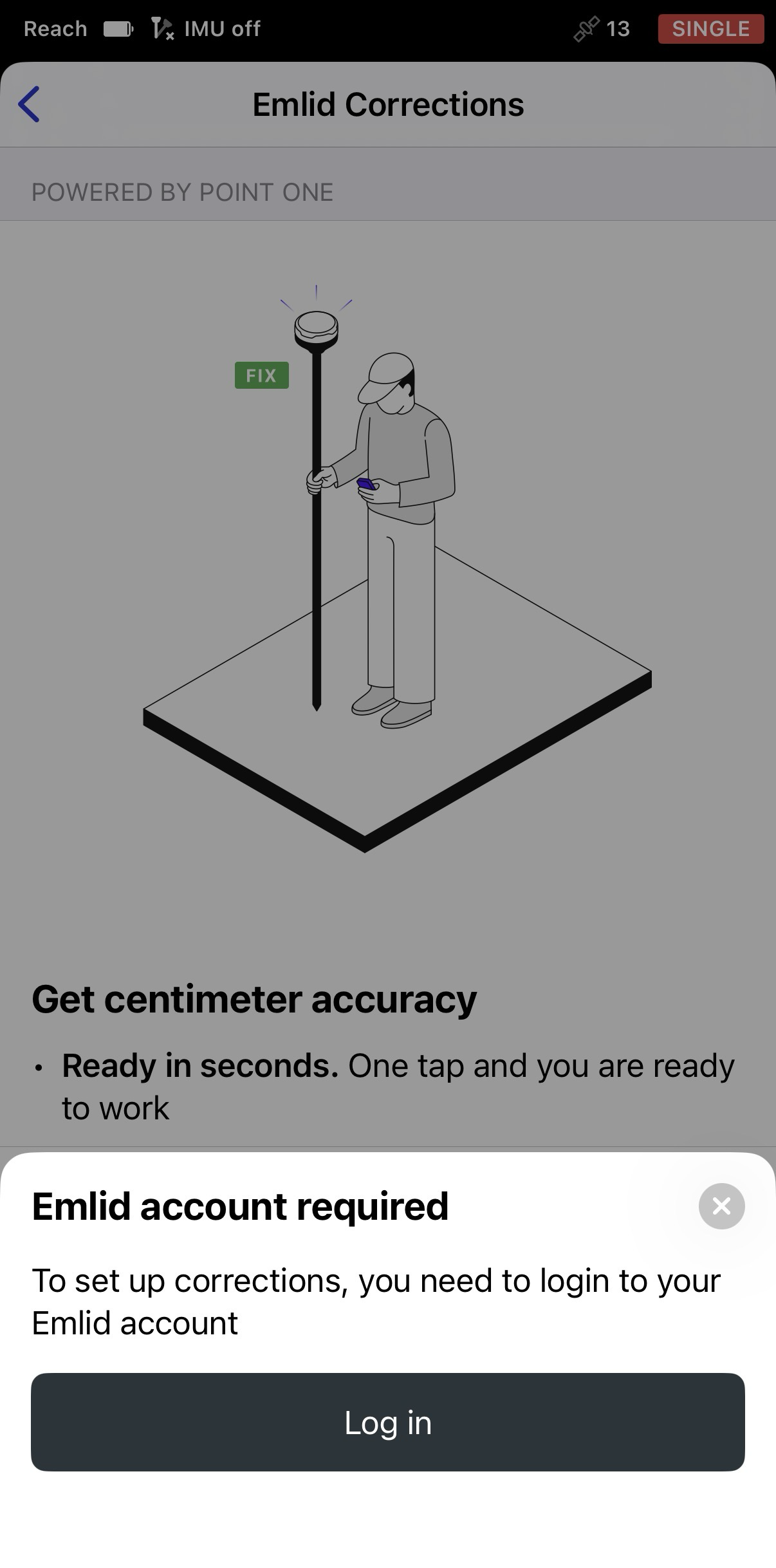

  3. If you haven’t signed in to your Emlid account, sign in now.

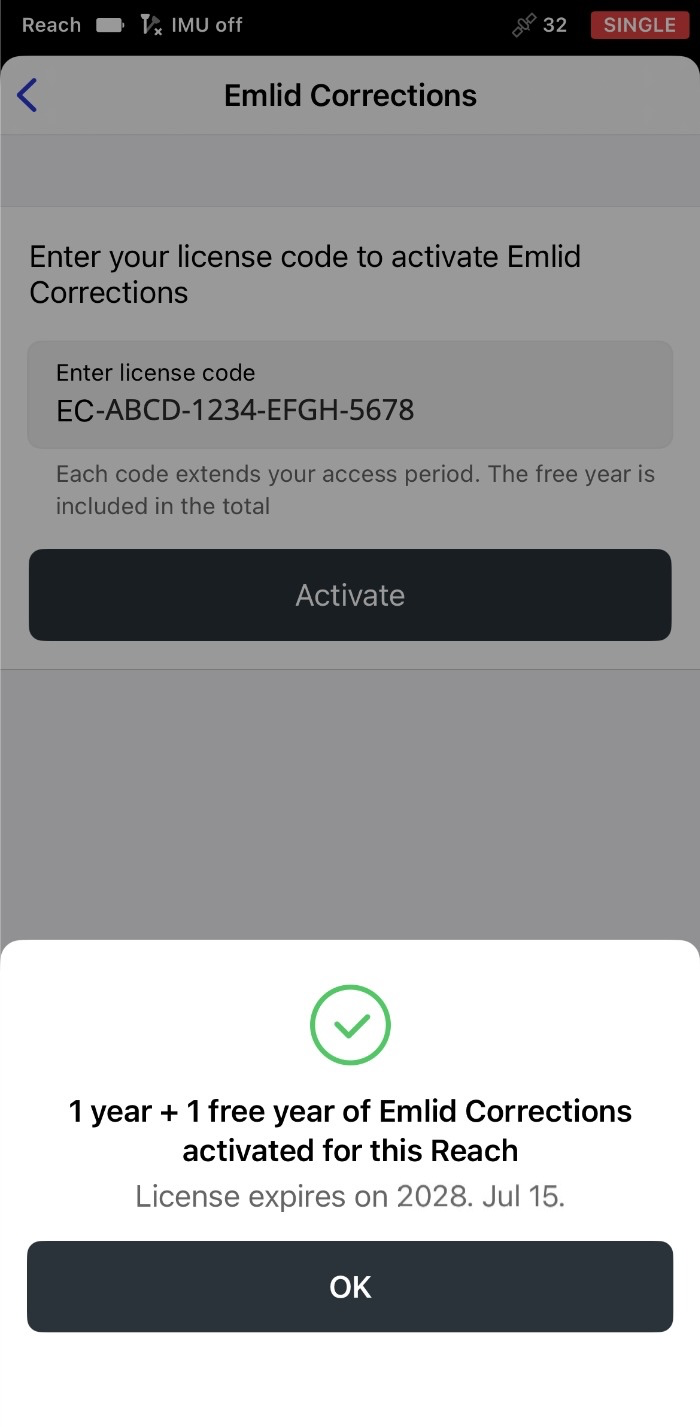

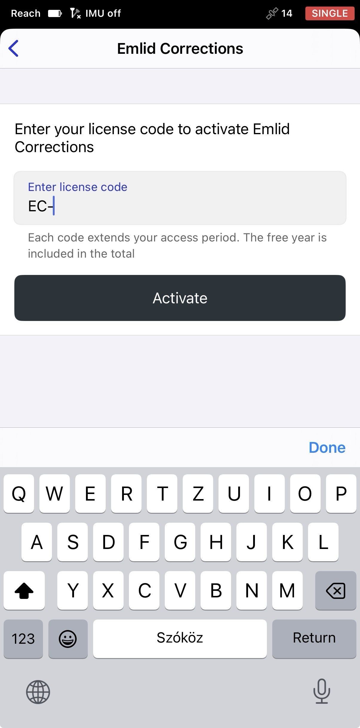

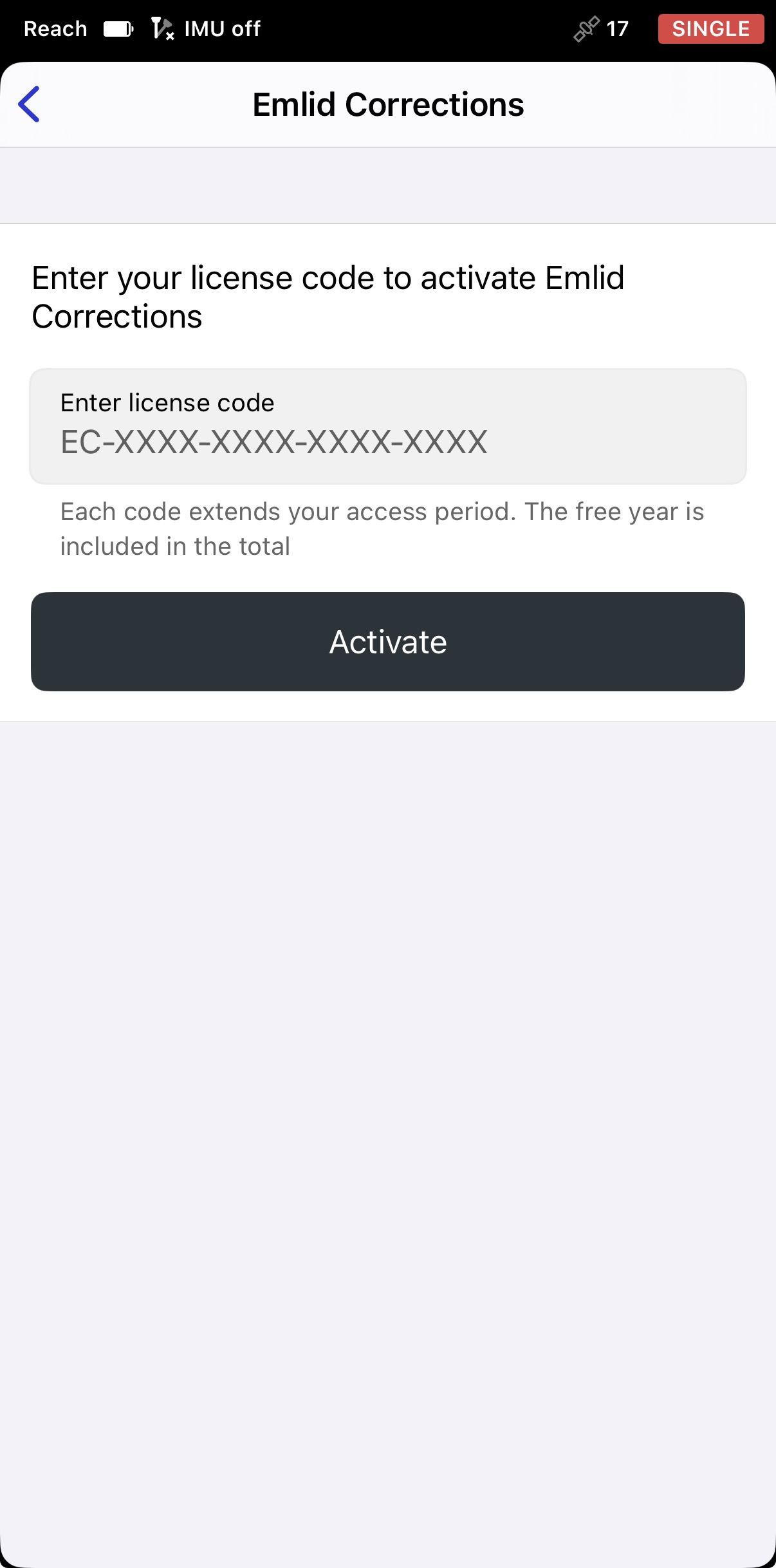

  4. After that, tap I have a license code.
  5. Tap Enter license code.
  6. Enter the license code and then tap Activate.
    Once activation is complete, you'll see the subscription expiration date. The included free one-year subscription is automatically combined with the subscription from your license code.
  7. Tap OK. The Emlid Corrections screen will now show you the information on your license details.

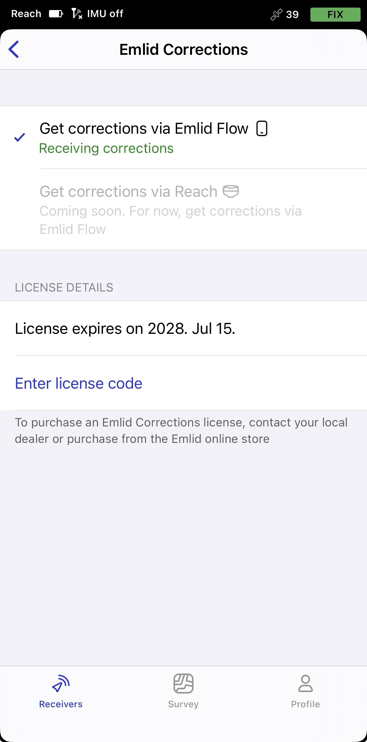

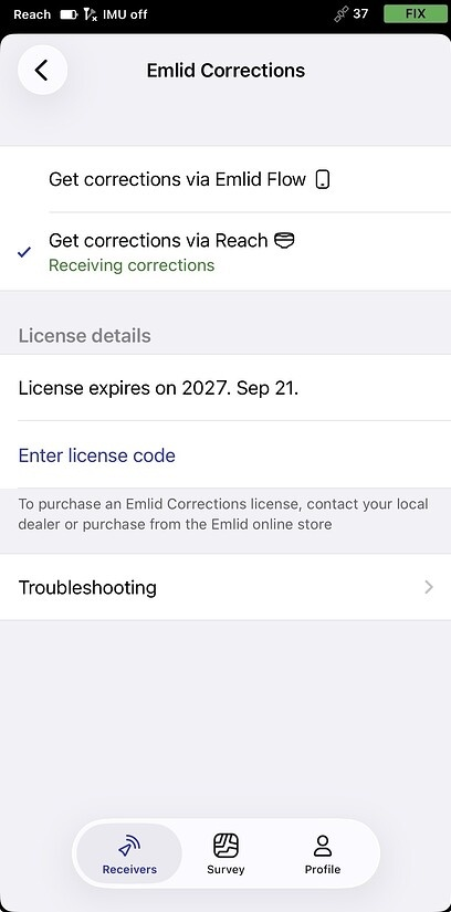

    The available correction delivery methods depend on how you connect to the receiver:
    • When connected via Bluetooth, corrections can be delivered either through Emlid Flow or directly through Reach. Select Get corrections via Reach to receive corrections using Reach’s own internet connection and let the receiver work independently of your mobile device.
    • When connected via Wi-Fi, corrections can be delivered only through Reach using the receiver’s own internet connection.
Your license is now activated. Before starting your survey, follow the recommendations in the Provide Reach RS4 / RS4 Pro with clear sky view section below to receive corrections and achieve a FIX solution.

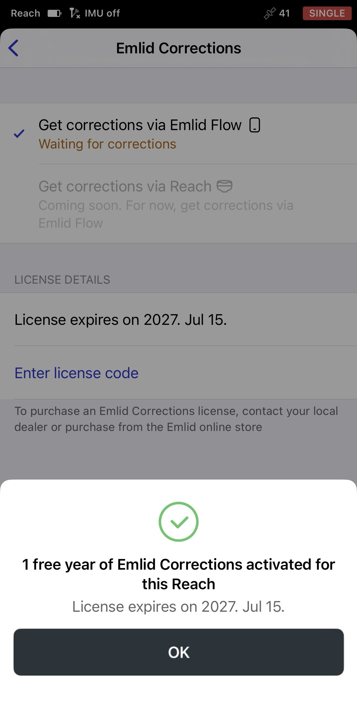

Every compatible Reach receiver includes a free one-year subscription to Emlid Corrections. Activate it in Emlid Flow to start using the service:
  1. Open Emlid Flow and connect to your Reach receiver via Bluetooth (BLE).
  2. On the screen that opens after connecting, tap Activate now to start using Emlid Corrections. If you didn’t log in to your Emlid account, do it now.
  4. After that, tap Activate a free year to start using Emlid Corrections.
  5. Tap Activate a free year. The free one-year subscription is tied to the receiver on which it is activated and cannot be transferred to another Reach receiver. Once activation is complete, you'll see the subscription expiration date.
  6. Tap OK, and you’ll see the Emlid Corrections screen.

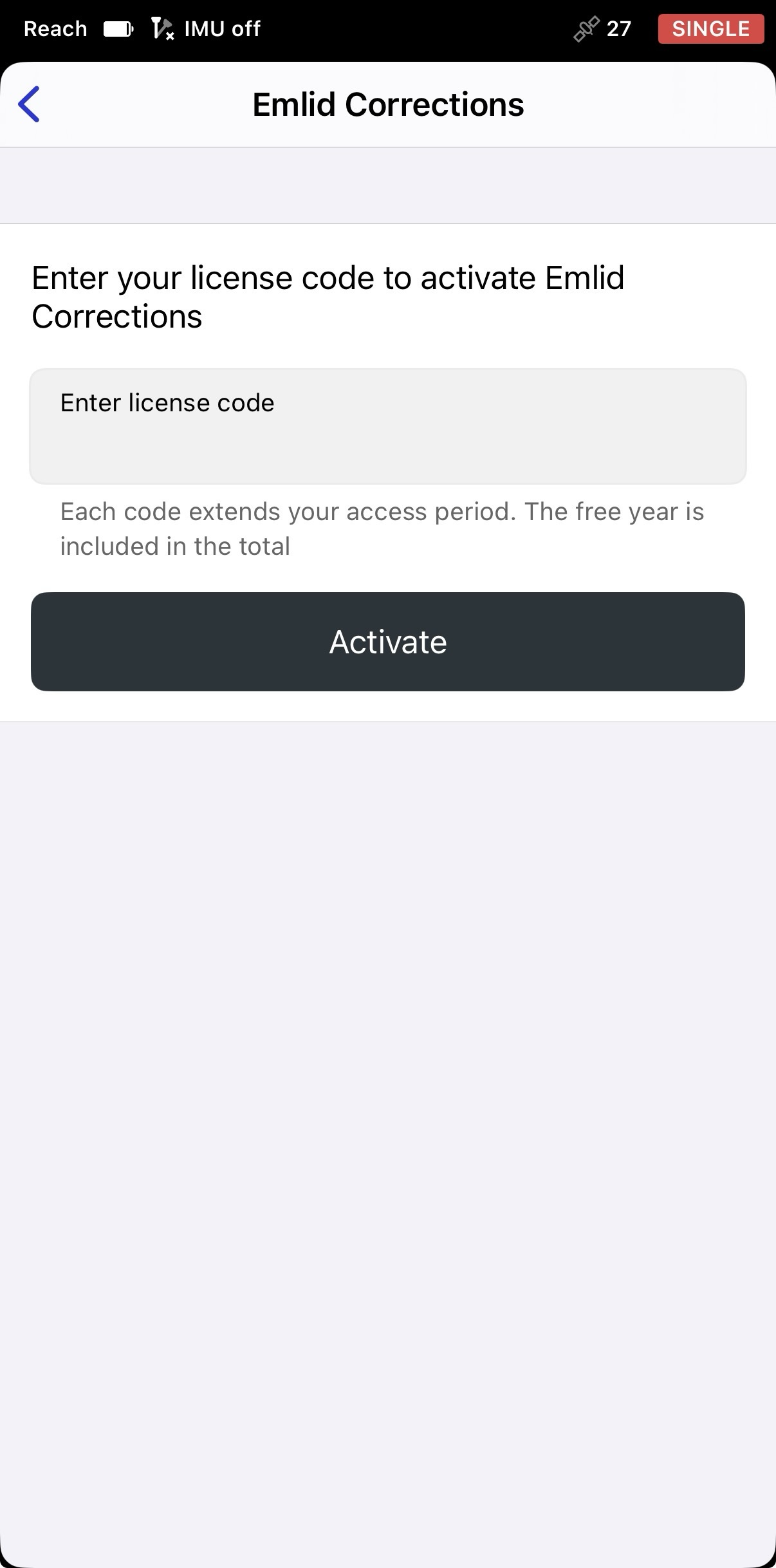

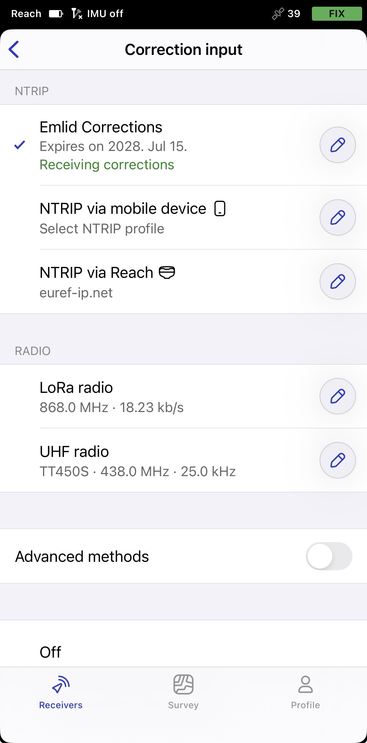

If you purchase an Emlid Corrections license code from the Emlid Store or your local dealer after activating the free period, enter the code in Emlid Flow as follows:
  1. In Settings, tap Correction input, and then Emlid corrections.
  2. Near the Emlid corrections cell, tap the pencil icon.
  3. On the opened screen, tap Enter license code section.
  4. Enter the obtained code. The purchased subscription will be added to the remaining free period, and the updated expiration date is displayed.
The license code is now applied, and the purchased license period is added to your existing Emlid Corrections period.

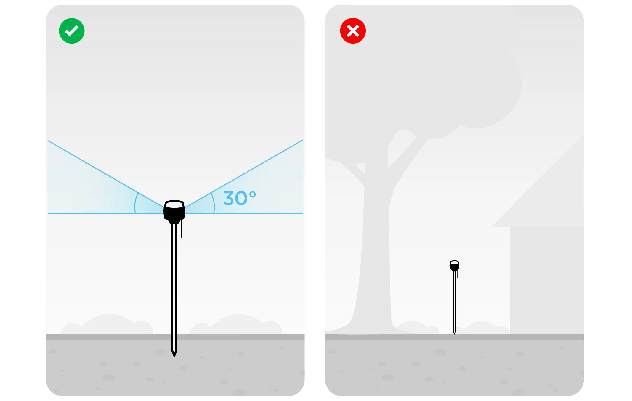

Before surveying, make sure your Reach has a clear sky view of at least 30 degrees above the horizon. There should be no obstacles that could block the view like buildings, trees, cars, people, laptops, etc.
Learn more about Reach setup in the Placement guide.
Once the receiver has a clear sky view and satellite visibility, corrections will start within a few seconds.
