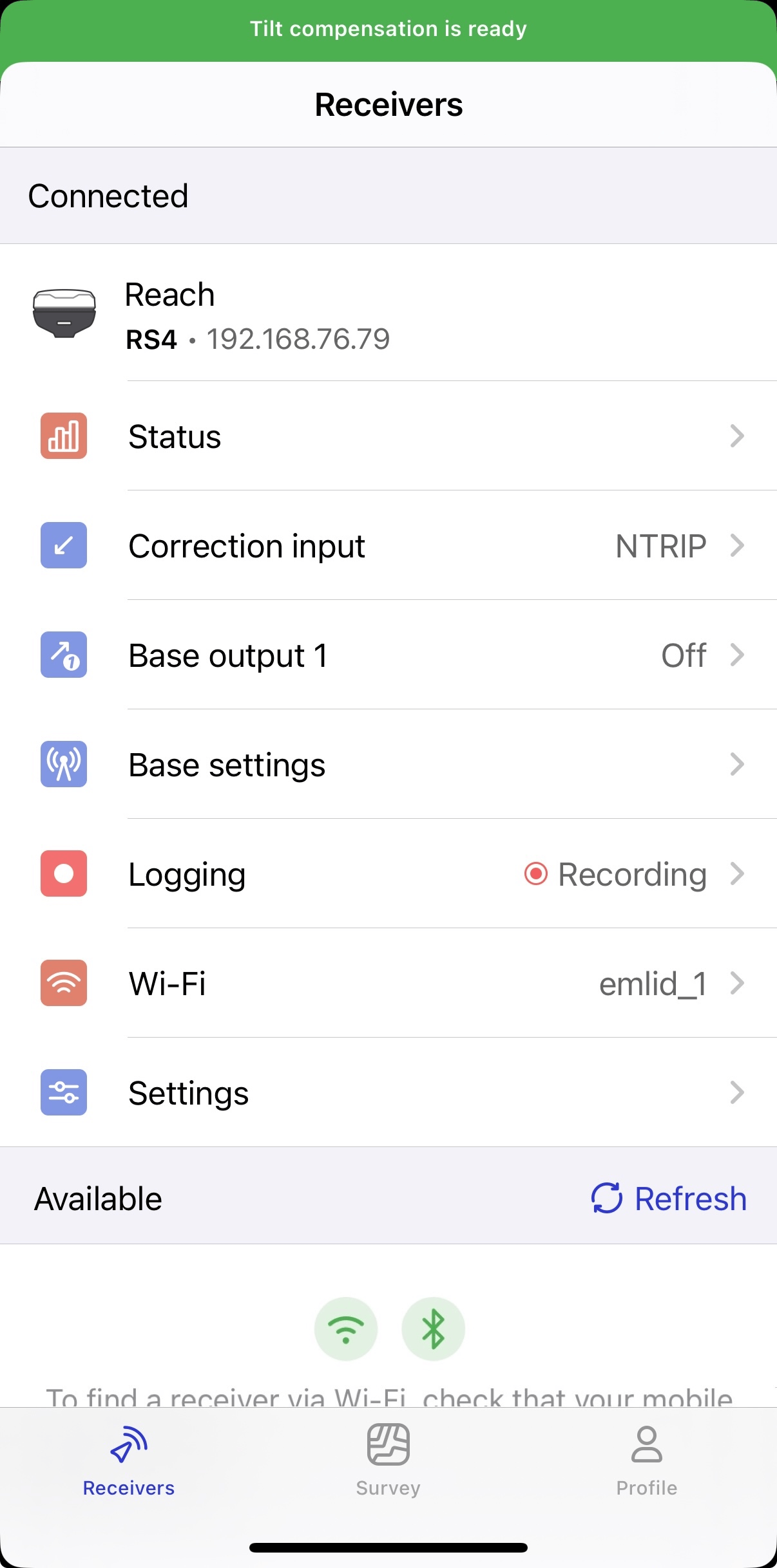

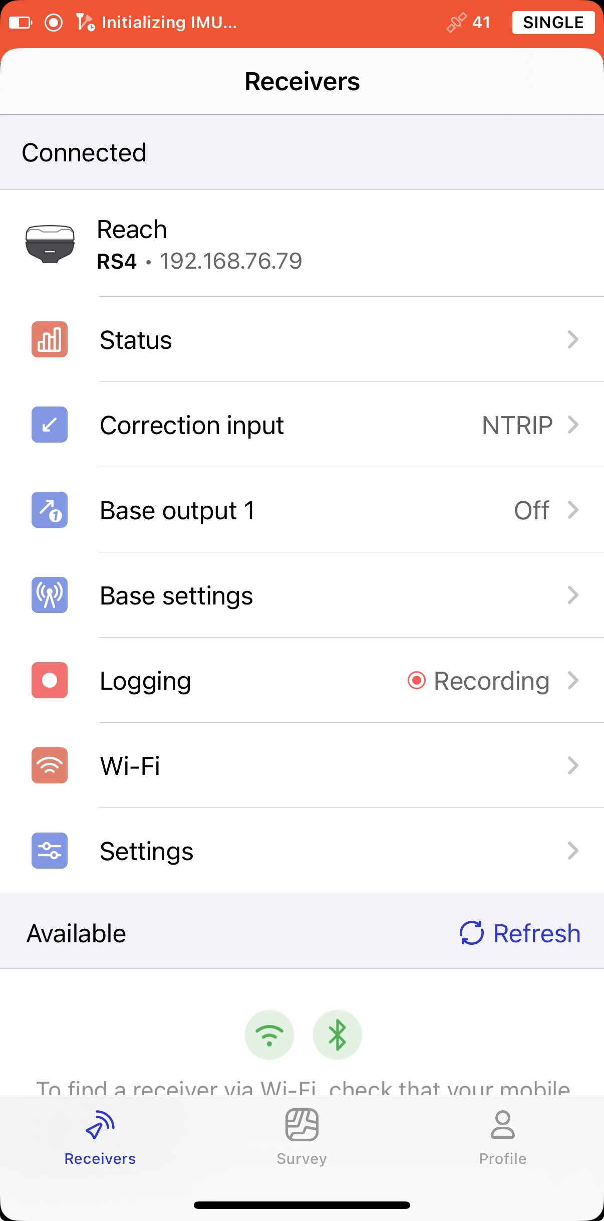

  4. Once you've got FIX, watch the tilt compensation status in the Status bar. Once initialization is complete, move the receiver in a figure-eight pattern until you hear a notification sound and see a message indicating that tilt compensation is ready.
You are now ready to proceed with GNSS data measurement.

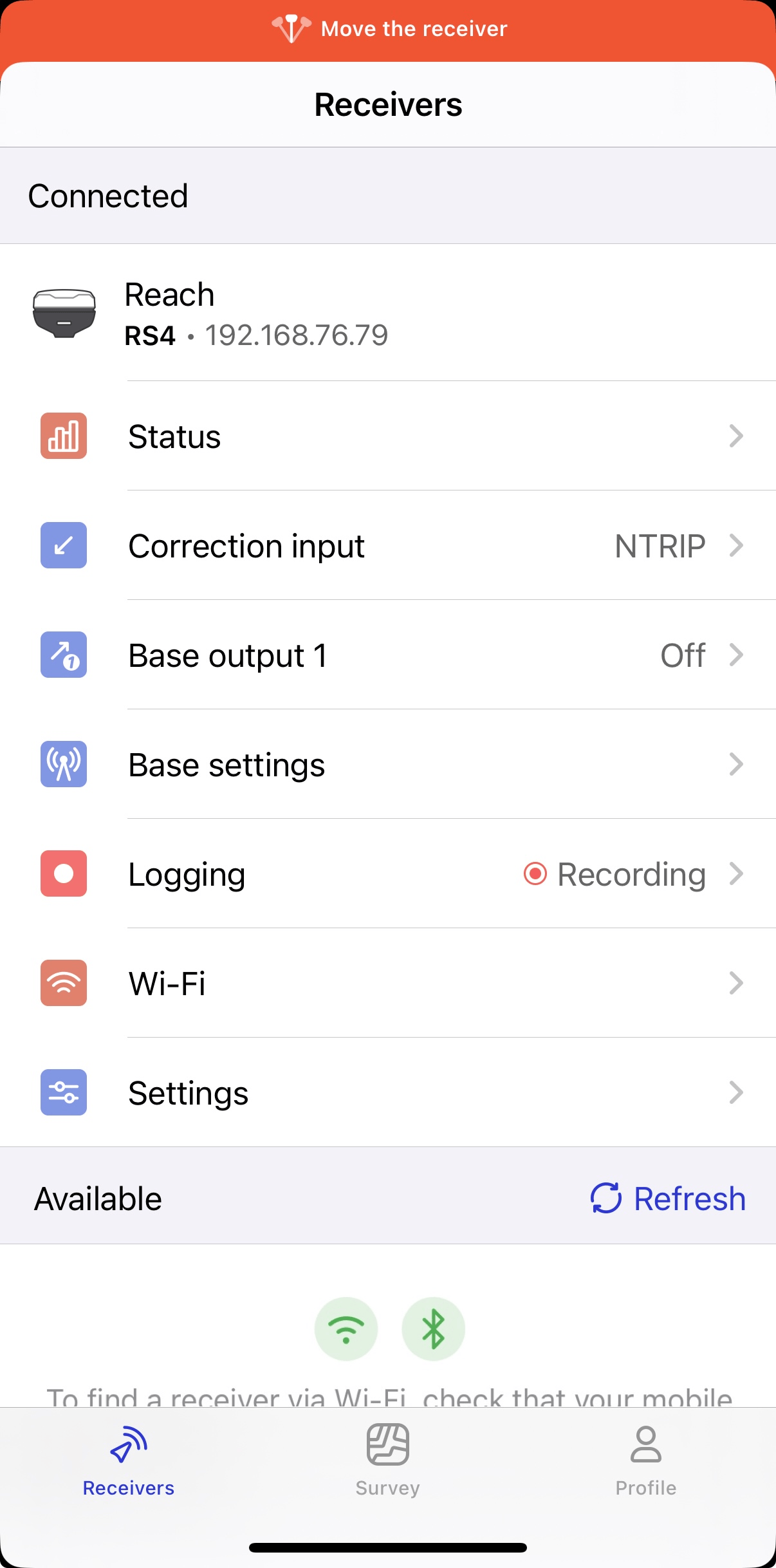

Tilt compensation may be temporarily lost, for example, after a brief loss of RTK FIX or if the receiver remains stationary for some time. If tilt compensation is lost, the app displays orange indicators and shows Move the receiver. Follow the hint and move the receiver in a figure-eight pattern to restore tilt compensation. Until then, data collection and stakeout are unavailable.

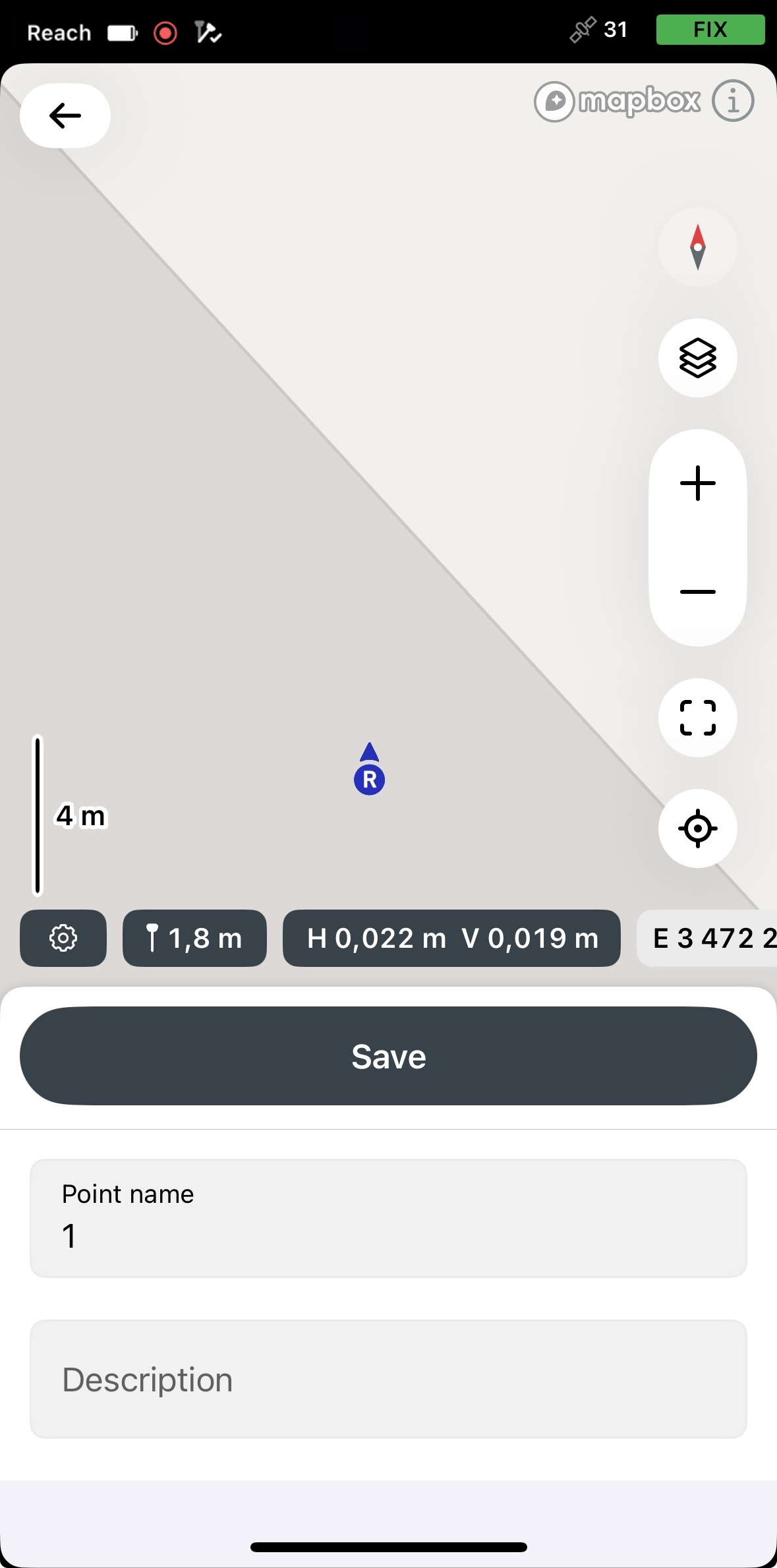

  3. Collect the point.

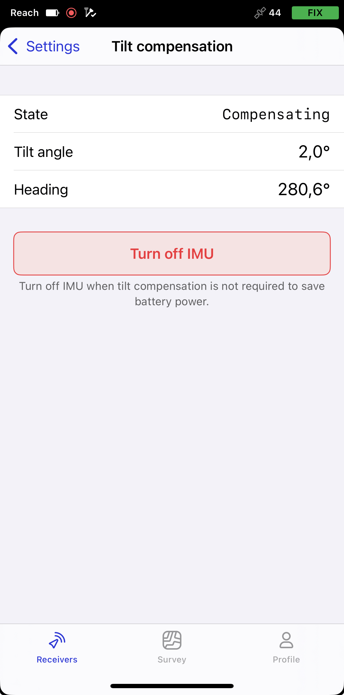

    Tap Status bar, to learn more about tilt compensation. The Status overview has a section with the information about the tilt angle and heading.
Once you collect the point with tilt compensation, it will have the information about the heading and angle of the tilt compensation. You can continue collecting points.

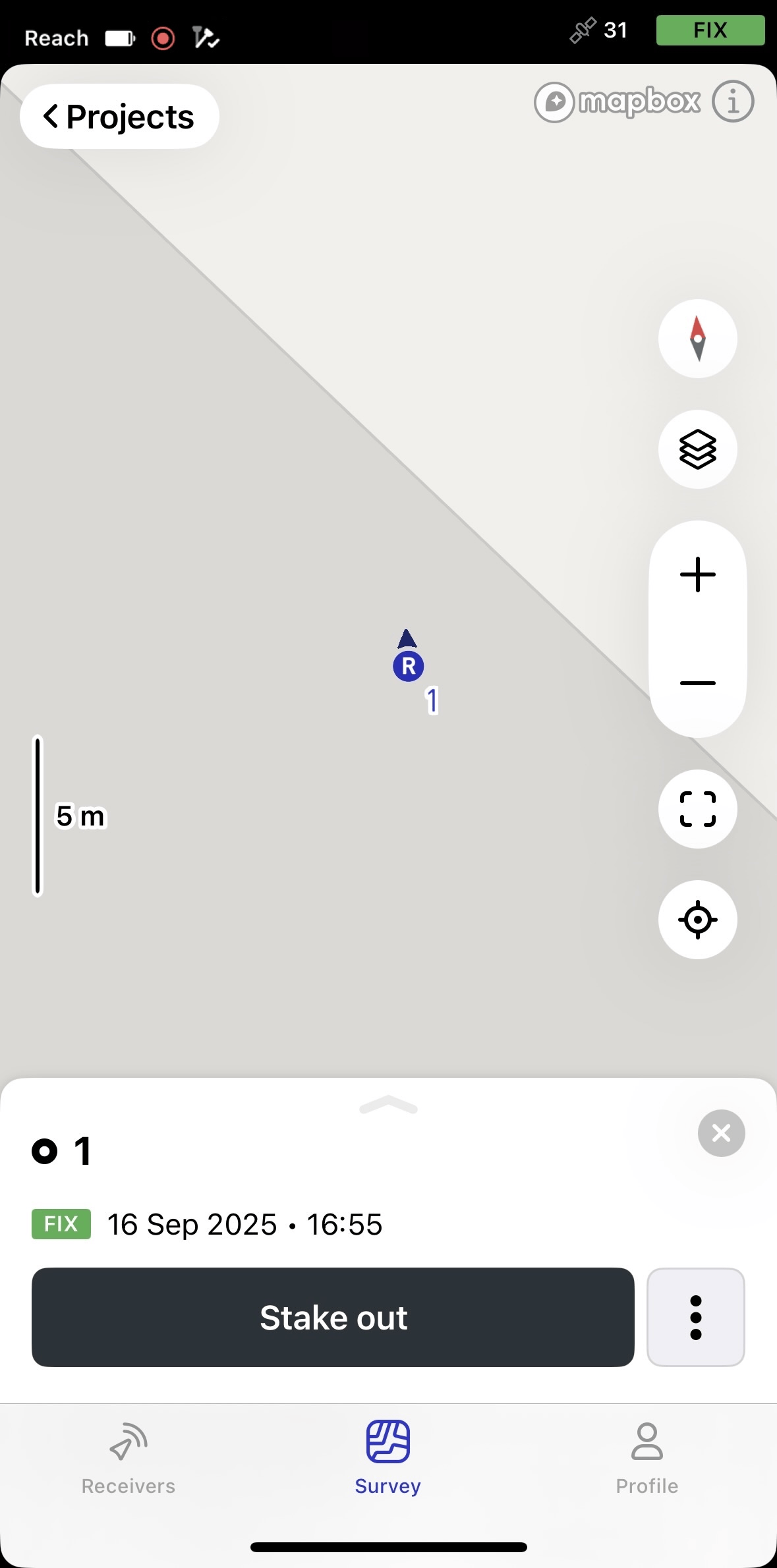

Stake out data with tilt compensation
To stake out data with tilt compensation, do the following:
  1. Open the Emlid Flow app and connect to your Reach.
  2. Go to the Survey tab and open or import a project.
  3. Tap the List button to choose the point you want to stake out. You can also select the point directly on the map.
    The selected point will be highlighted in blue on the map.
  4. Tap the Stake out button.
  5. Move your Reach in the direction of the point. When you get closer, the map zooms in automatically.
    Turn the LED panel of the receiver towards you while surveying. This way you will see the correct direction and navigate easily on the map. This is applied only when IMU is on.
  6. Move your Reach so that the bull’s-eye turns green, showing that your Reach is less than 2.5 cm (0.08 ft) away from the point you are staking out.
  7. Physically mark the point’s position on the ground.
  8. Switch to another point by tapping the arrow buttons in the Stakeout navigation area.
    To finish staking out the point, close the Stakeout option window.

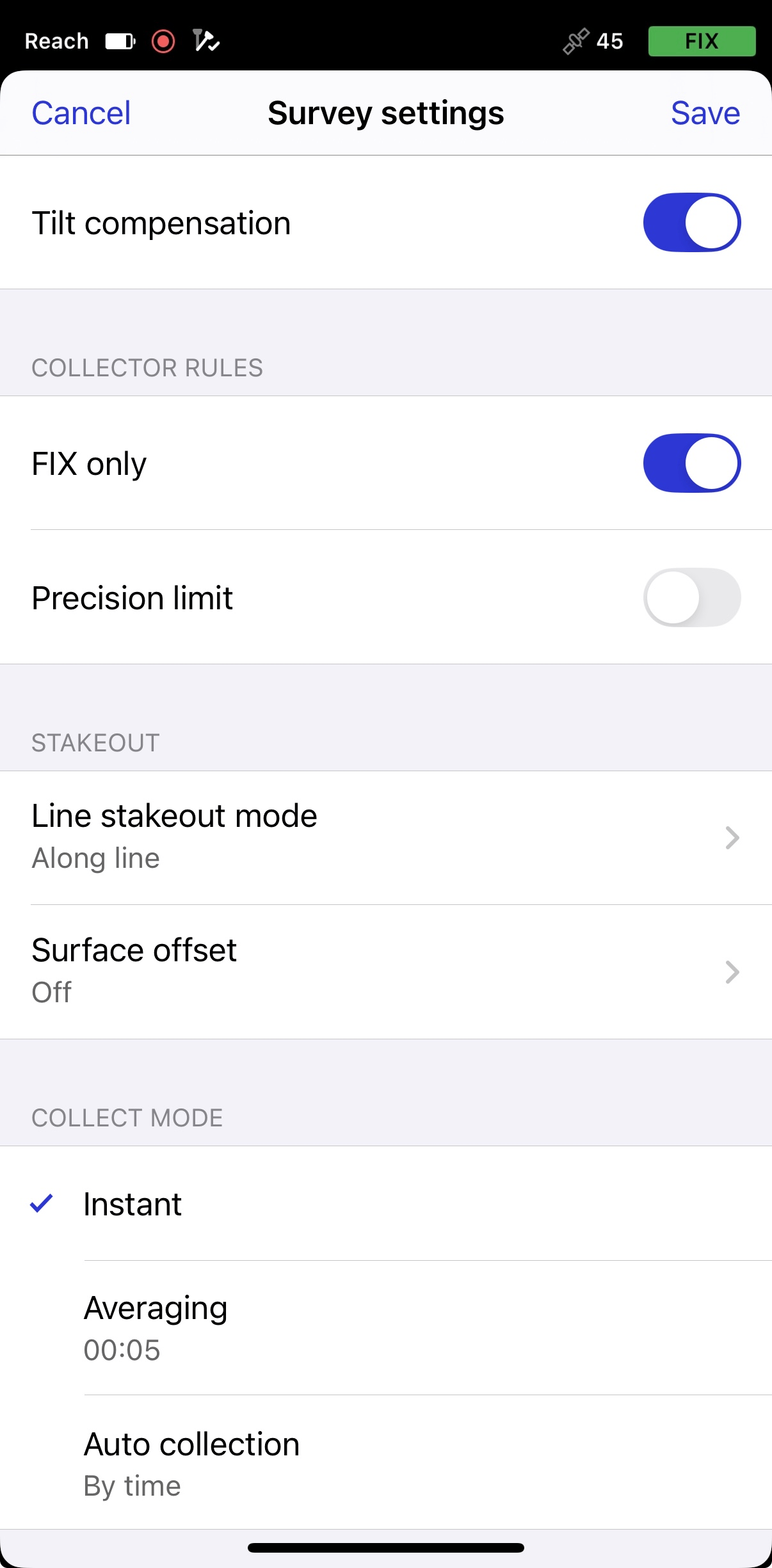

  • You can temporarily turn tilt compensation option off in the Survey settings on the Collector screen. For the Collector tool, this is available only when you use the FIX only option in the Survey settings.
  • If you don't need tilt compensation at all, you can disable the IMU sensors. To do this, go to Settings, tap IMU and turn them off.
