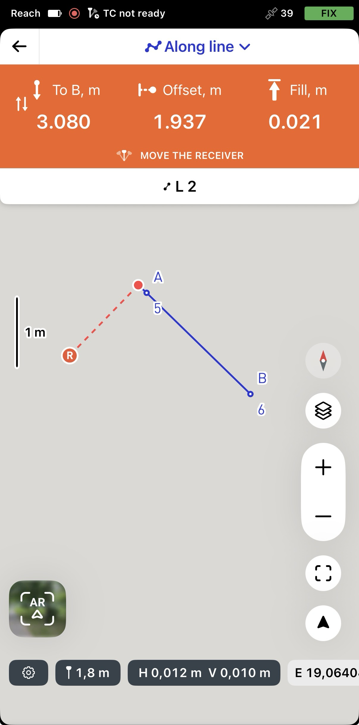

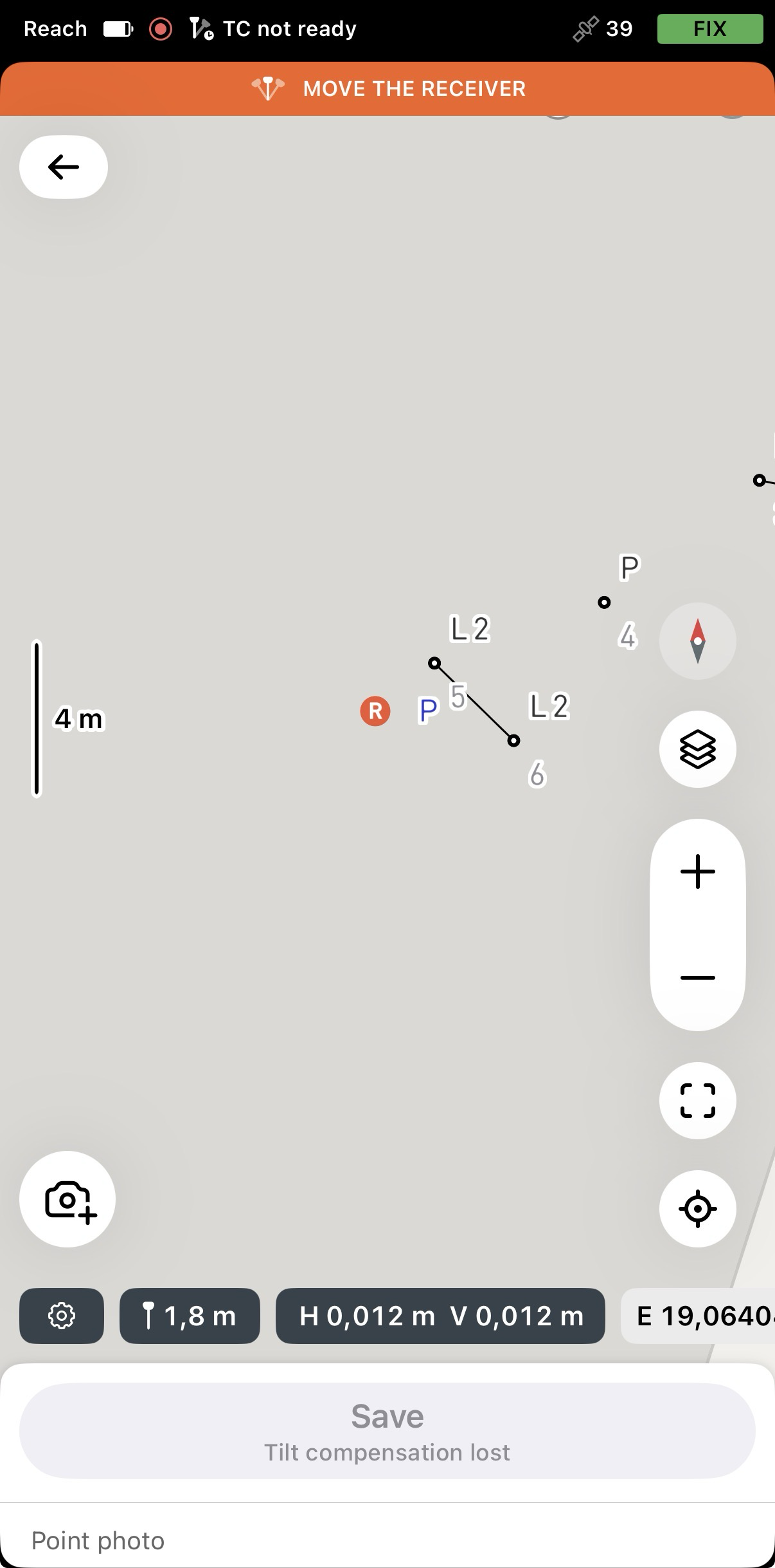

Tilt compensation may be temporarily lost, for example, after a brief loss of RTK FIX or if the receiver remains stationary for some time. If tilt compensation is lost, the app displays orange indicators and shows Move the receiver. Follow the hint and move the receiver in a figure-eight pattern to restore tilt compensation. Until then, data collection and stakeout are unavailable.

To collect data with tilt compensation, do the following:
  1. Go to the Survey tab and open or create a project.
  2. Tap the Plus button to open the Collector menu.
  3. Collect the point.
    Tap Status bar, to learn more about tilt compensation. The Status overview has a section with the information about the tilt angle and heading.
Once you collect the point with tilt compensation, it will have the information about the heading and angle of the tilt compensation. You can continue collecting points.
For points collected using averaging, only the maximum tilt compensation angle is specified.
Stake out data with tilt compensation​
To stake out data with tilt compensation, do the following:
  1. Open the Emlid Flow app and connect to your Reach.
  2. Go to the Survey tab and open or import a project.
  3. Tap the List button to choose the point you want to stake out. You can also select the point directly on the map.
    The selected point will be highlighted in blue on the map.
  4. Tap the Stake out button.
  5. Move your Reach in the direction of the point. When you get closer, the map zooms in automatically.
    Turn the LED panel of the receiver towards you while surveying. This way you will see the correct direction and navigate easily on the map. This is applied only when IMU is on.
  6. Move your Reach so that the bull’s-eye turns green, showing that your Reach is less than 2.5 cm (0.08 ft) away from the point you are staking out.
  7. Physically mark the point’s position on the ground.
  8. Switch to another point by tapping the arrow buttons in the Stakeout navigation area.
    To finish staking out the point, close the Stakeout option window.
