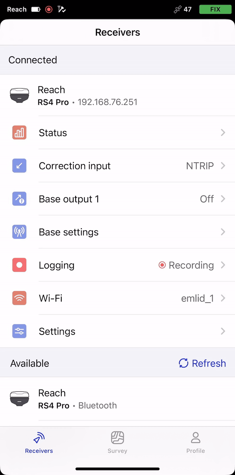

Access Reach using Emlid Flow
You can connect to your Reach in two ways:
- Using the BLE connection option. This is the recommended connection method. It is especially useful when working with corrections from an NTRIP provider. In this setup, the receiver uses your mobile device's internet connection, so you only need to select the NTRIP over BLE option when configuring the receiver's correction input.
- Using the Wi-Fi connection option. In this case, your device and Reach must be in the same Wi-Fi network.
To connect to your Reach, follow the steps below:
- Bluetooth connection
- Hotspot connection
Open Emlid Flow. When prompted, tap Configure access and allow location permissions. This is required for full receiver functionality.
After granting permissions, your receiver will appear in the list. The app will connect to it automatically.
For more information on connecting to your Reach device, refer to the Connecting to Reach guide. A Bluetooth connection is the recommended method.

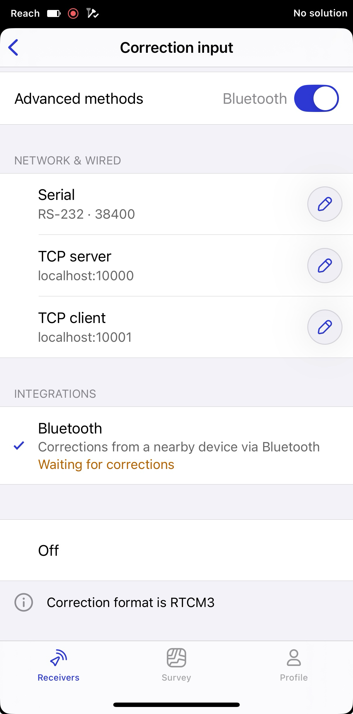

If you choose to use FieldGenius as the correction source, configure Emlid Flow as follows:
In Emlid Flow, go to the Correction input tab.
Tap Advanced methods.
Select Bluetooth.

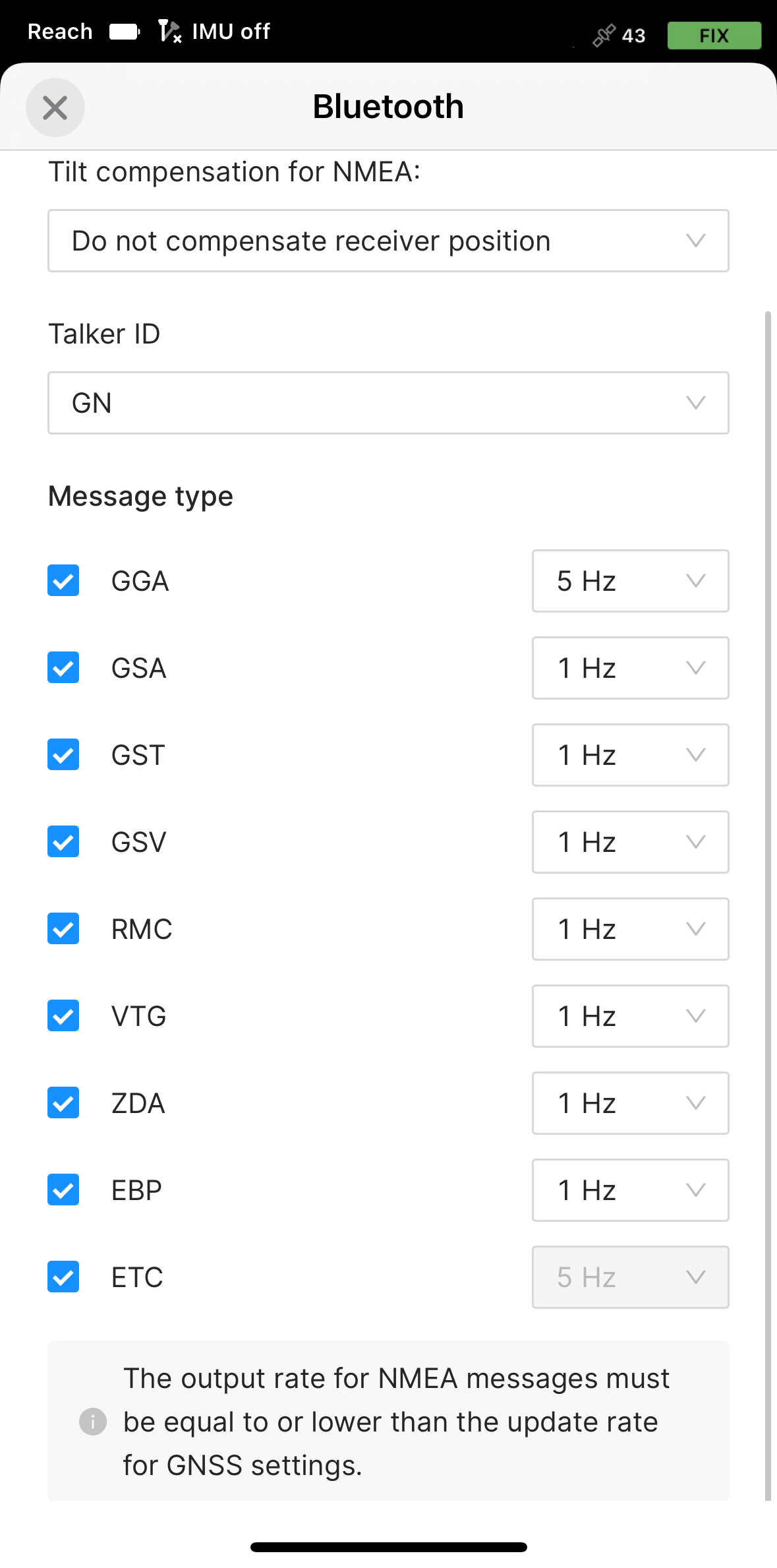

Set up NMEA stream in Emlid Flow
To send position data to external applications, configure position streaming in NMEA format as follows:

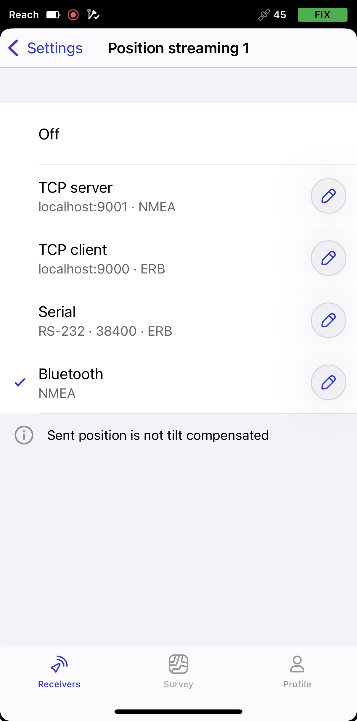

In Emlid Flow, go to Settings.
Tap Position streaming 1 and select Bluetooth.

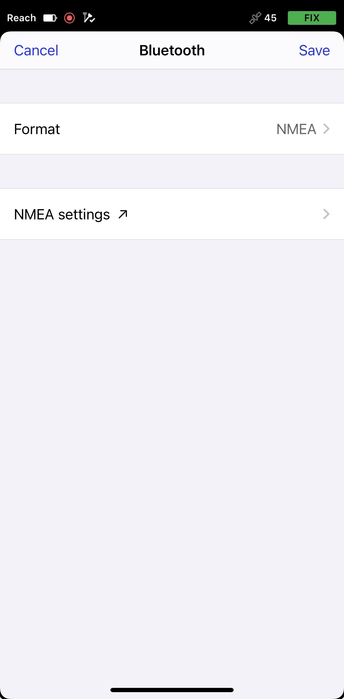

To configure position streaming, tap the Edit button in the Bluetooth cell.
noteWhen connected to your Reach via Bluetooth, Emlid Flow will prompt you to connect to the Reach hotspot to access the streaming configuration settings.
Tap Format and choose NMEA.
FieldGenius supports ETC messages for Reach RS4 / RS4 Pro and applies the necessary compensation automatically. To avoid double compensation, select Do not compensate receiver position in Emlid Flow and ensure that the ETC message is enabled.

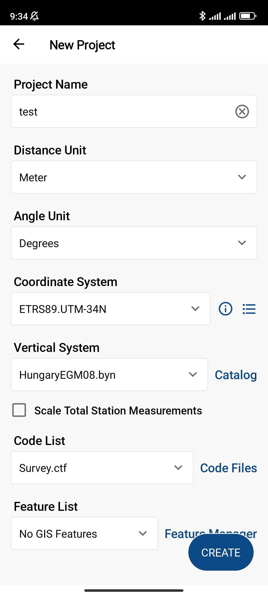

Open the FieldGenius app, create a new project, and fill in all the fields. Tap Create.
noteMake sure that you have configured the proper units and coordinate system at this step.

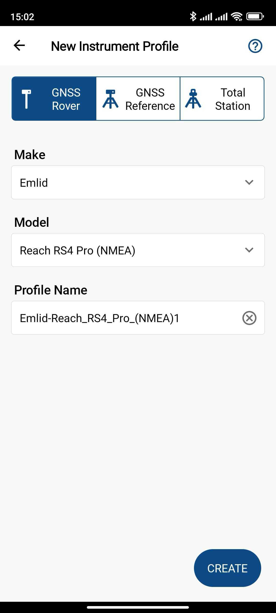

- To create your GNSS rover profile, tap Select Instrument.
On the Instrument Profile screen, tap Add profile.
Fill in the required fields as follows:
- Select Emlid for Make.
- Choose Reach RS4 / RS4 Pro for Model.
- Specify the profile name.
Tap Create.

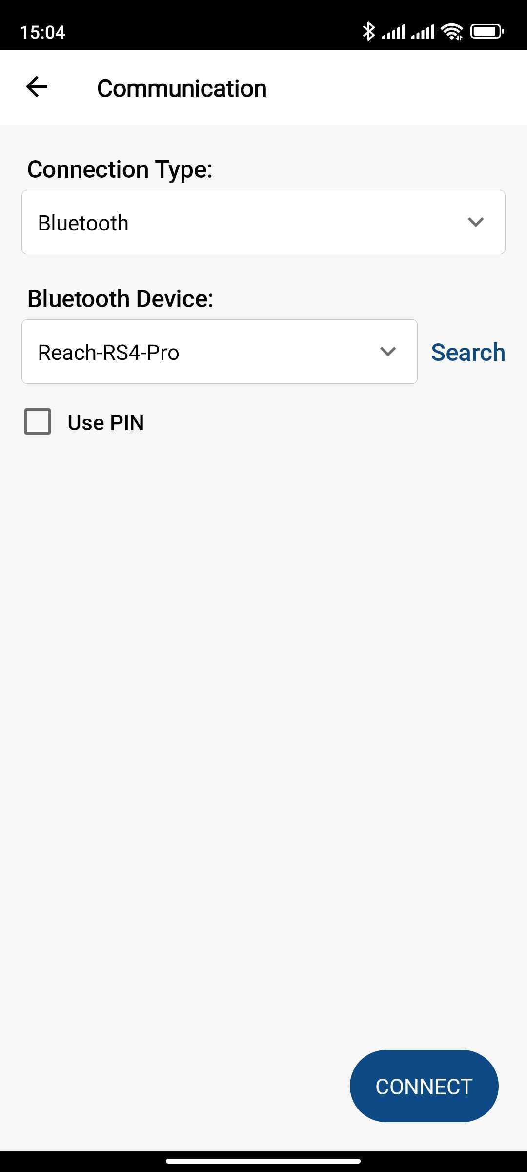

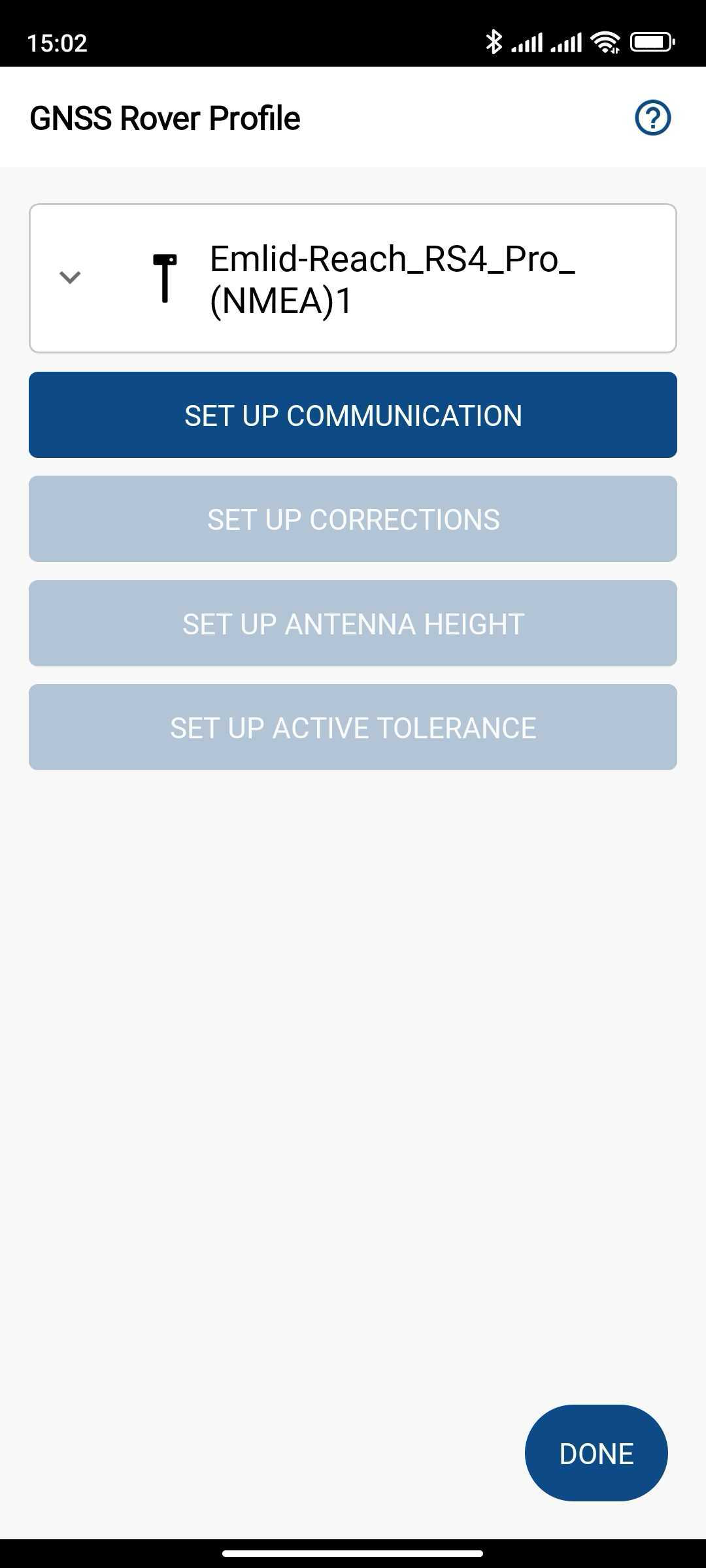

Configure communication between MicroSurvey FieldGenius and Reach RS4 / RS4 Pro
Once you have created the project and configured the instrument connection profile, you can set up communication between FieldGenius and Reach RS4 / RS4 Pro via Bluetooth as follows:

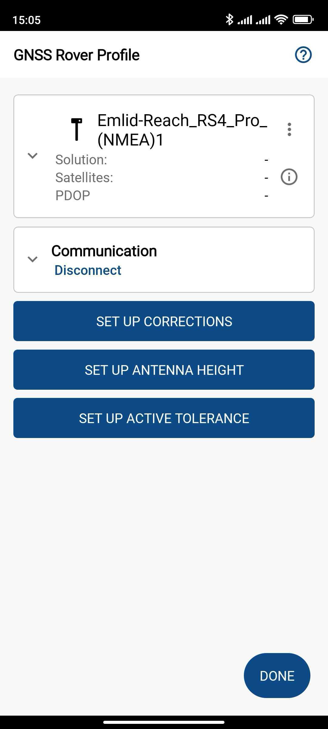

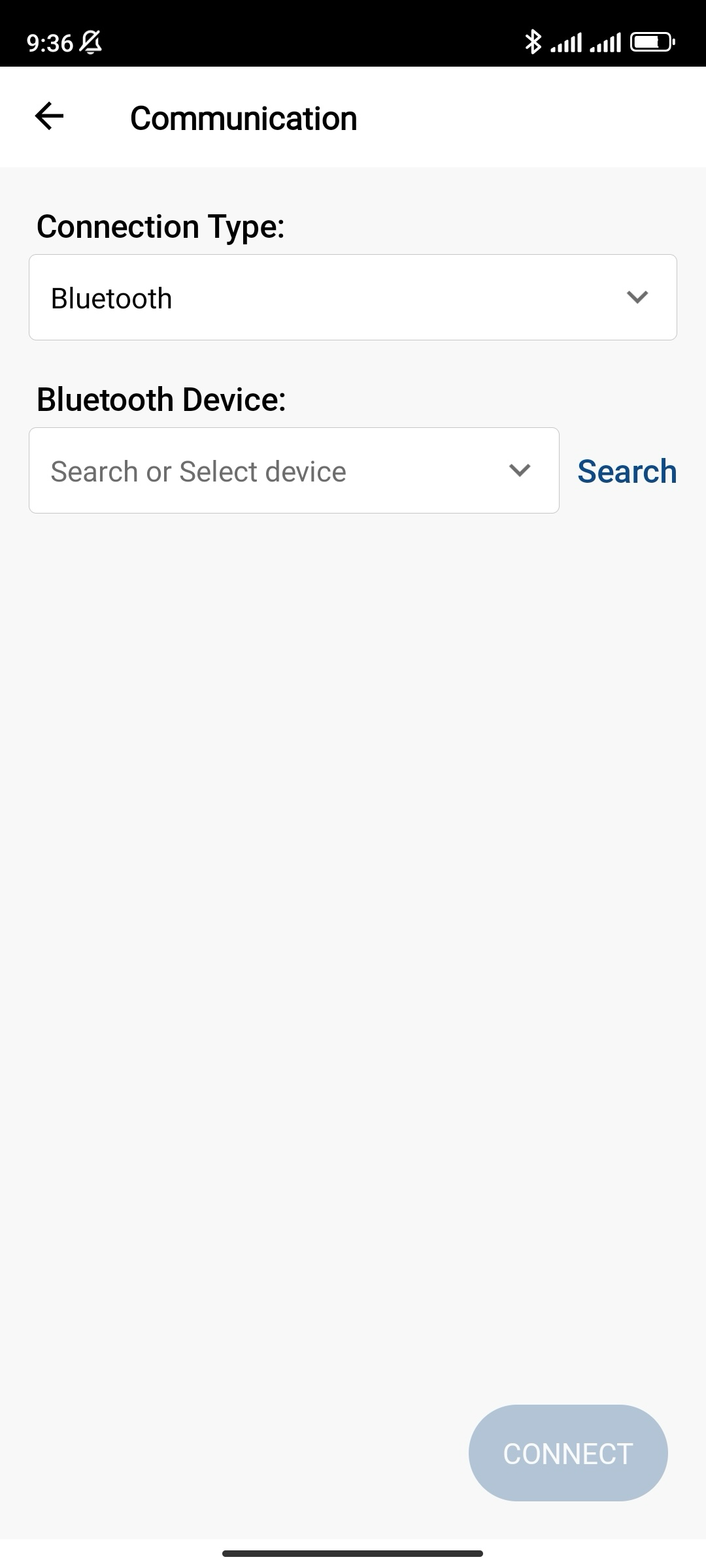

Tap SET UP COMMUNICATION.
Set Connection type to Bluetooth and tap Search to find your Reach RS4 / RS4 Pro.
Choose your Reach RS4 / RS4 Pro and tap Connect.
tipMake sure that you have enabled Bluetooth on your Android device. If the receiver still does not appear on the list of devices, tap Refresh list.
Once you successfully connect to your Reach RS4 / RS4 Pro, you will be able to set up your Reach RS4 / RS4 Proto receive RTK corrections.

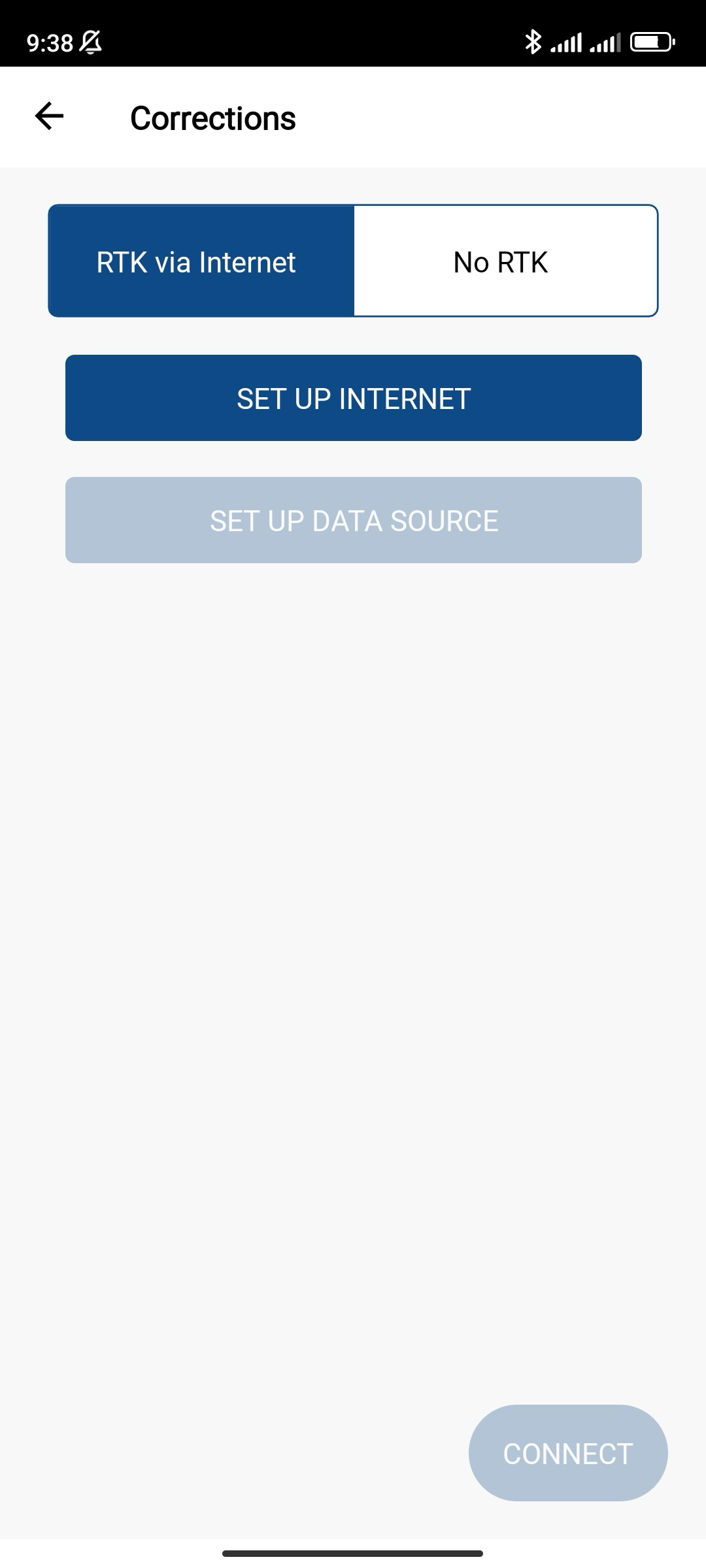

Once you have configured communication between FieldGenius and Reach RS4 / RS4 Pro, you need to set up receiving RTK corrections. Follow the steps below:
Tap SET UP CORRECTIONS.
To obtain corrections from a caster over an internet connection, choose RTK via Internet and tap Set up Internet.
noteMake sure your mobile device is connected to the Internet.

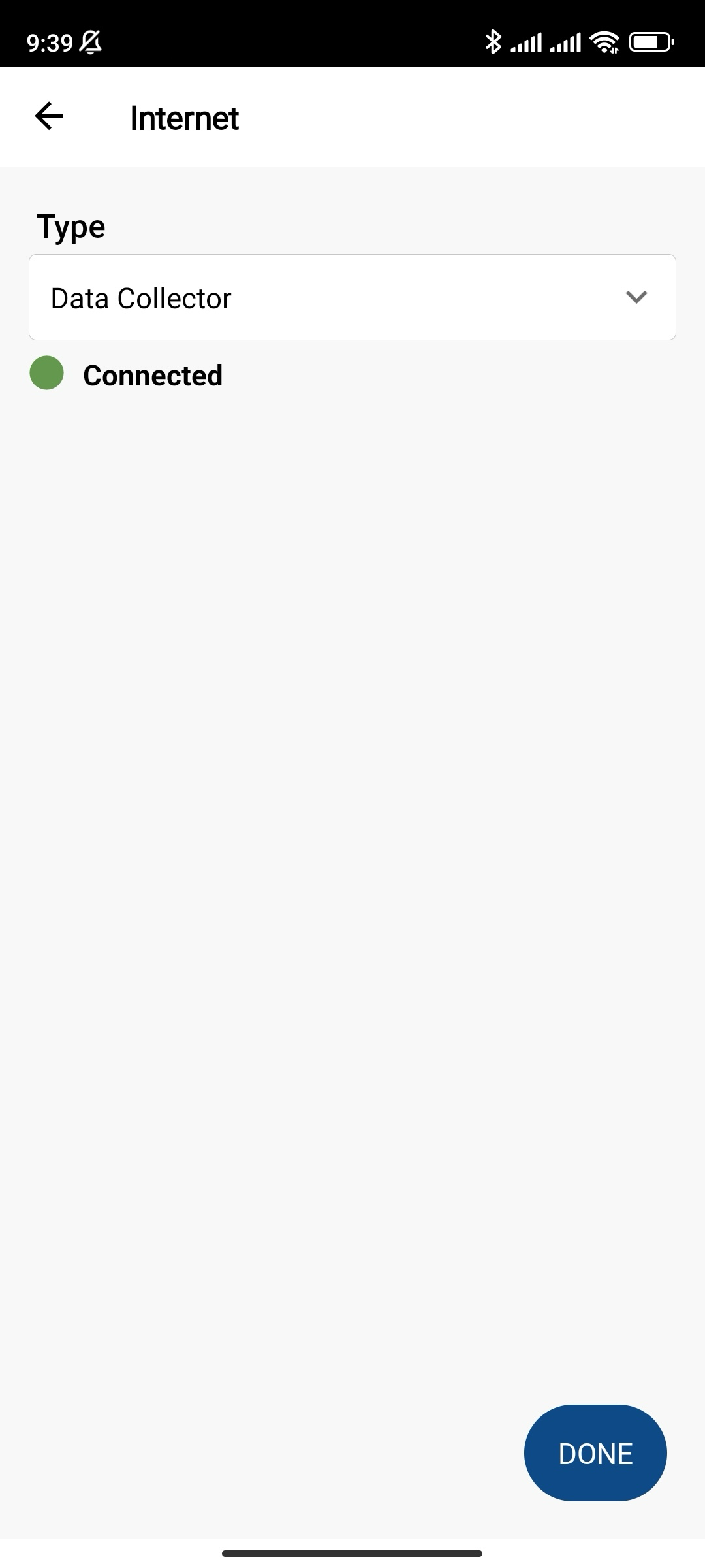

Choose Data collector as a communication type and wait until the Internet status becomes 'Connected'.

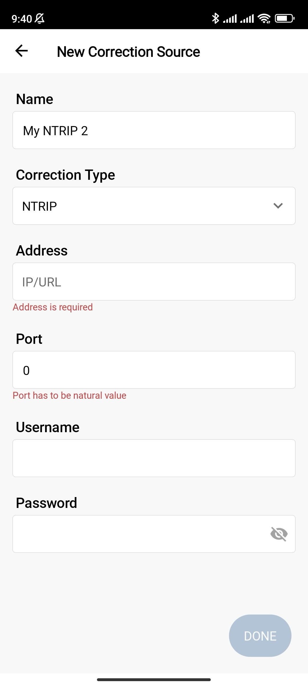

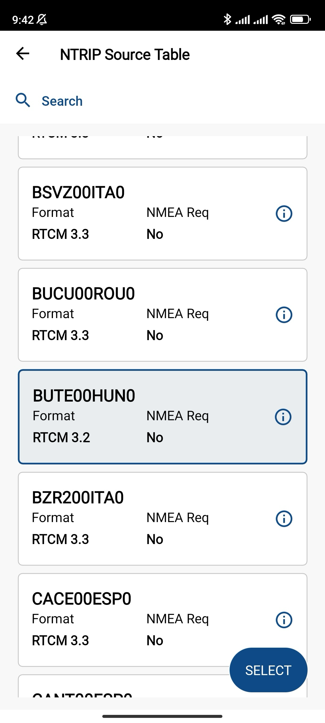

Tap SET UP DATA SOURCE and add a new correction source. Fill in the information from your NTRIP provider and tap Done.
Tap Connect and wait until the port is configured and choose the required mount point. Tap Select.

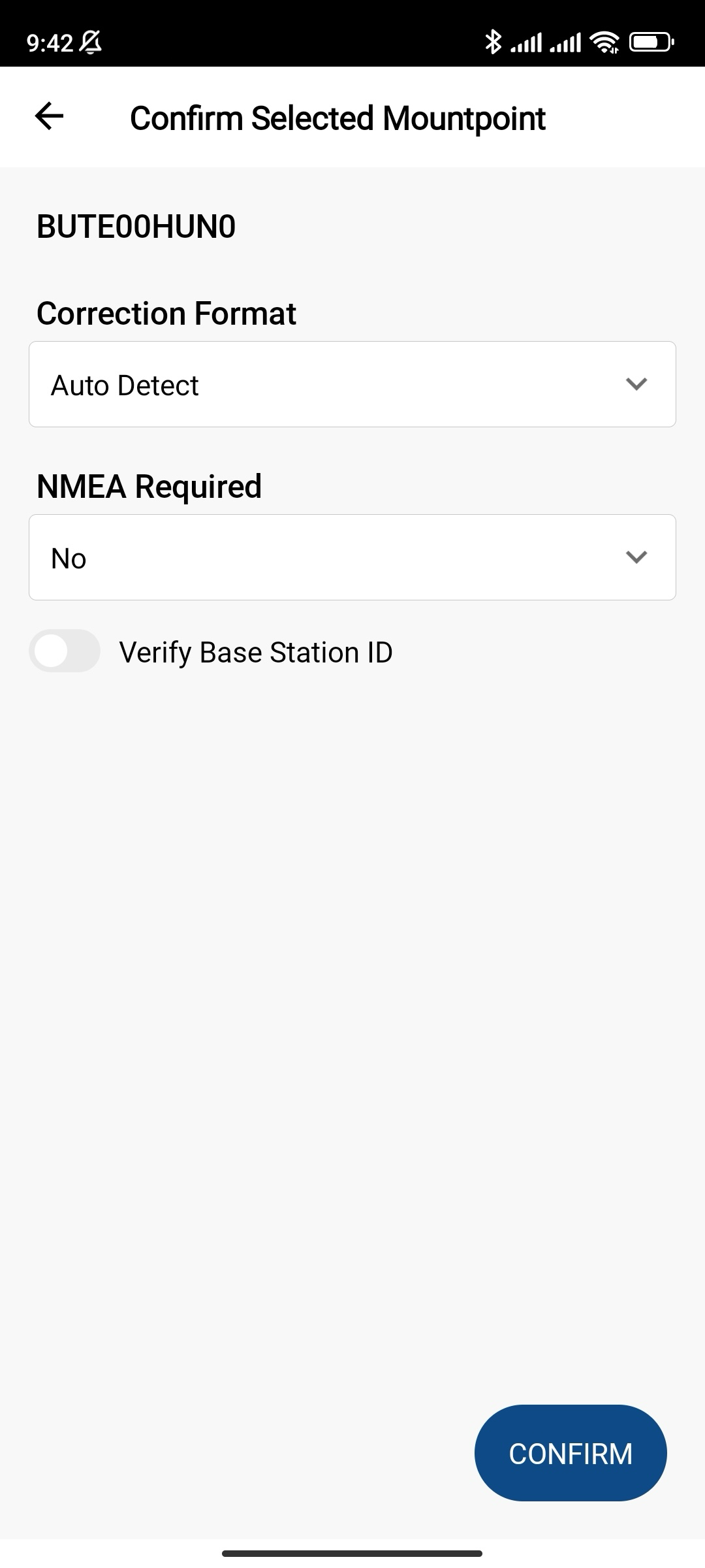

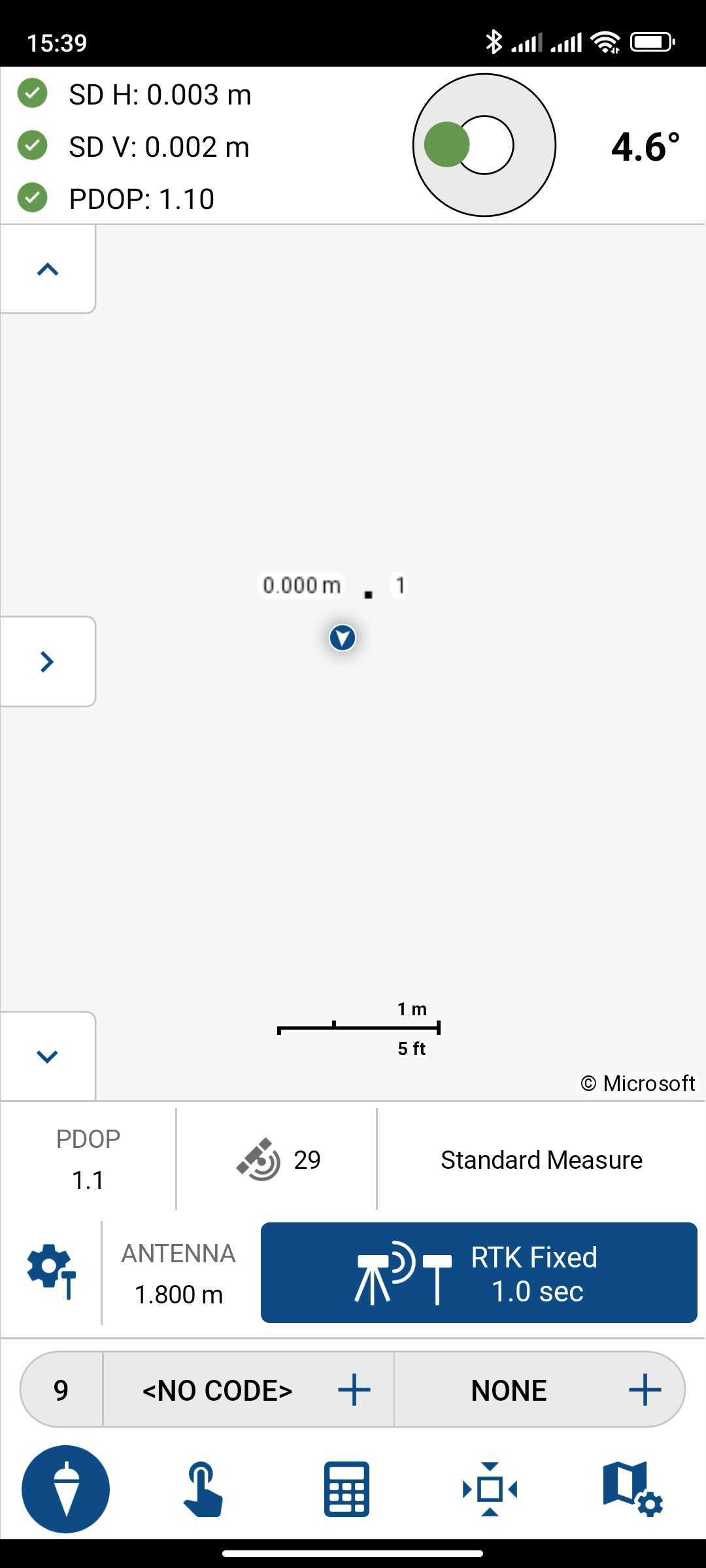

Check the settings in the Correction Format, and NMEA Required fields, and confirm the selected mount point. Wait until the port is configured.

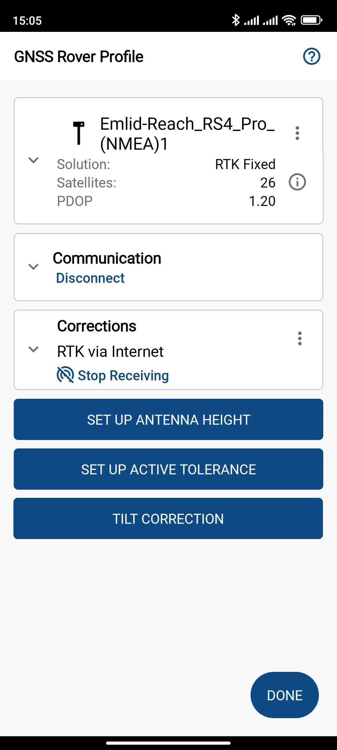

tipMake sure that your Reach RS4 / RS4 Pro is receiving corrections. Check the Corrections field in FieldGenius and check the Status LED on the receiver—it should be solid green.
Set up the antenna height and tap OK.

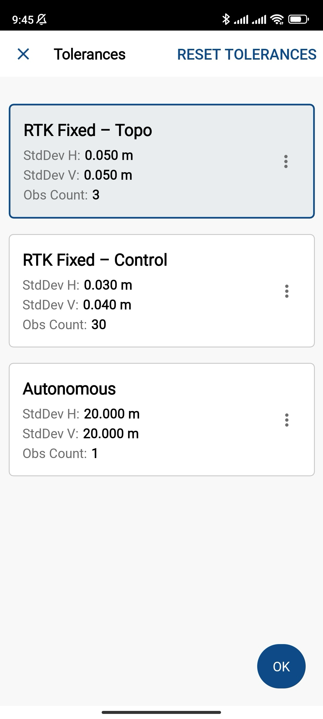

Set up active tolerances and tap OK.
Enable tilt compensation.
Once you've enabled tilt compensation, you're all ready for surveying!
