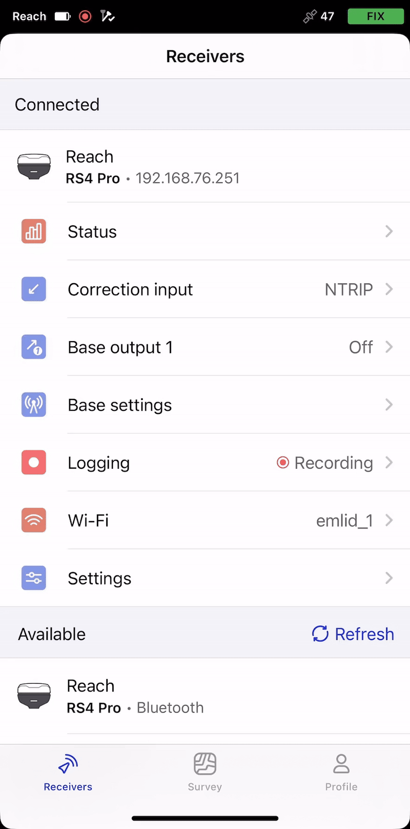

Access Reach using Emlid Flow
You can connect to your Reach in two ways:
- Using the BLE connection option. This is the recommended connection method. It is especially useful when working with corrections from an NTRIP provider. In this setup, the receiver uses your mobile device’s internet connection, so you only need to select the NTRIP over BLE option when configuring the receiver’s correction input.
- Using the Wi-Fi connection option. In this case, your device and Reach must be in the same Wi-Fi network.
To connect to your Reach, follow the steps below:
Enable Bluetooth on your smartphone or tablet.
Open Emlid Flow. When prompted, tap Configure access and allow location permissions. This is required for full receiver functionality.
After granting permissions, your receiver will appear in the list. The app will connect to it automatically.
Go to Wi-Fi settings on your device.
Connect to the Reach hotspot. It appears as reach:XX:XX.
Enter the network password. The default password is emlidreach. If you changed it previously, enter your custom password instead.
noteTo restore the default Wi-Fi password, emlidreach, you need to reflash the receiver. Note that reflashing erases all logs stored on the receiver and restores all settings to their default values.
Open Emlid Flow and connect to your Reach.

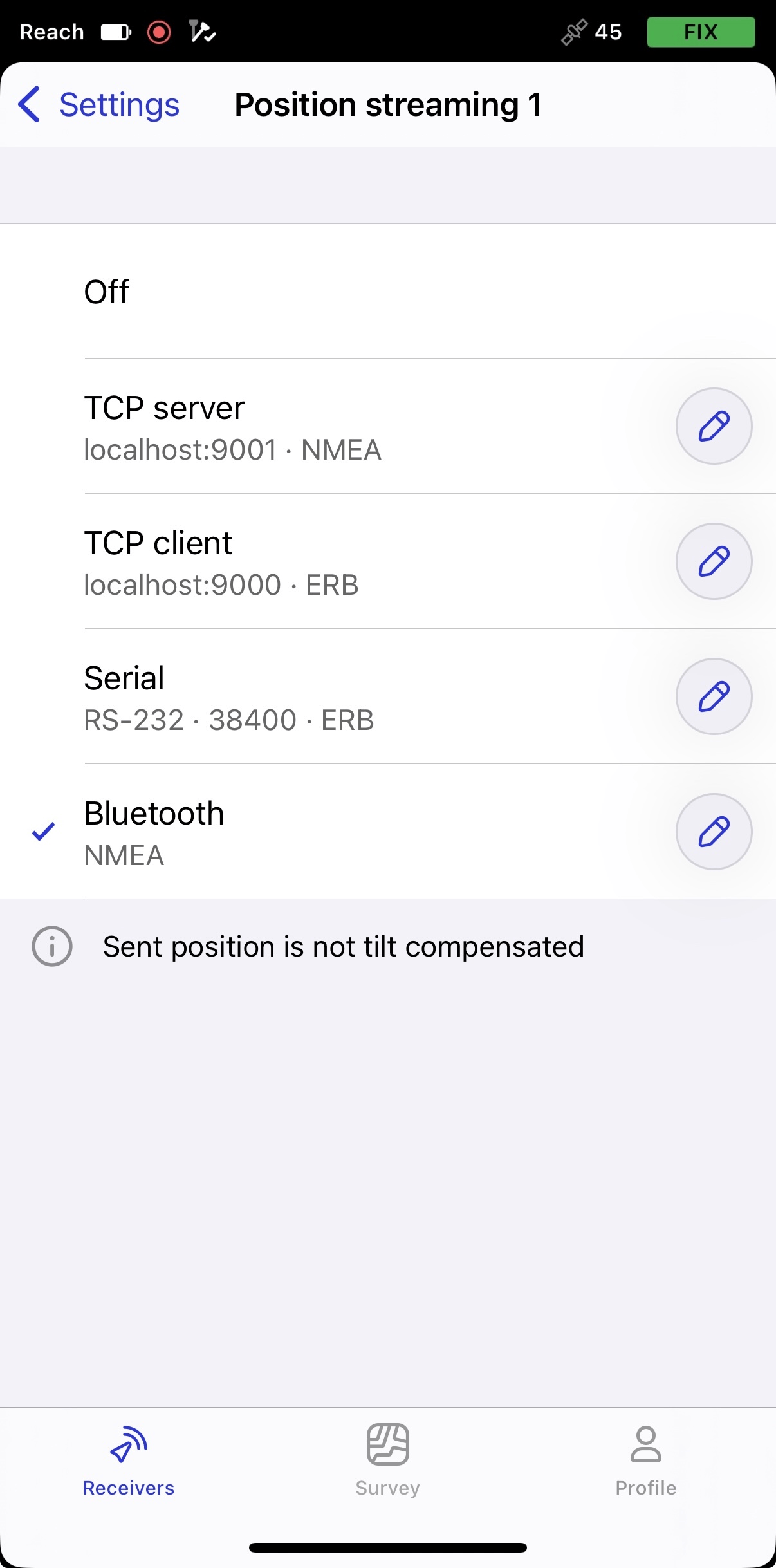

Set up NMEA stream in Emlid Flow

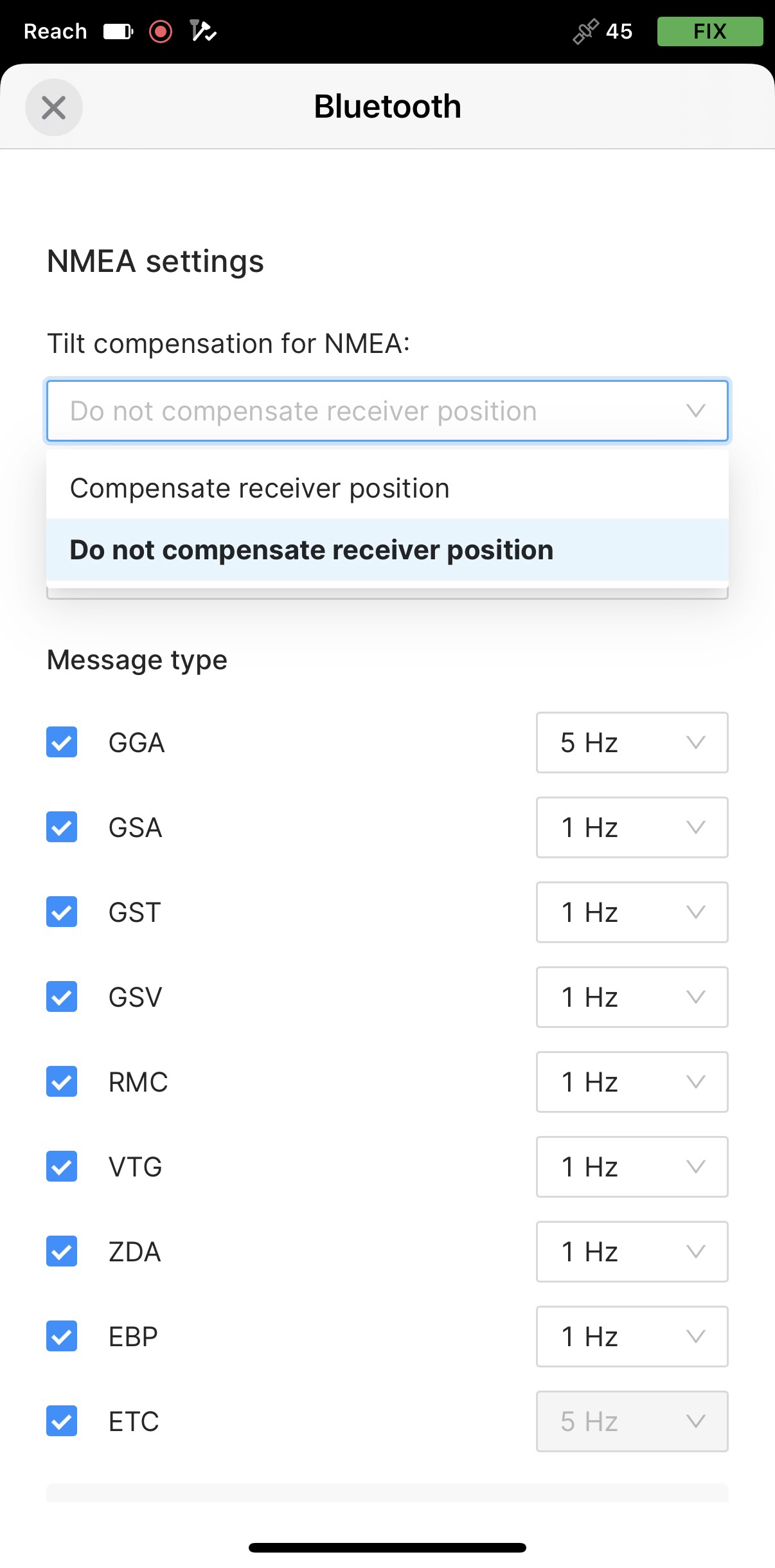

To send position data to external applications, configure position streaming in NMEA format as follows:

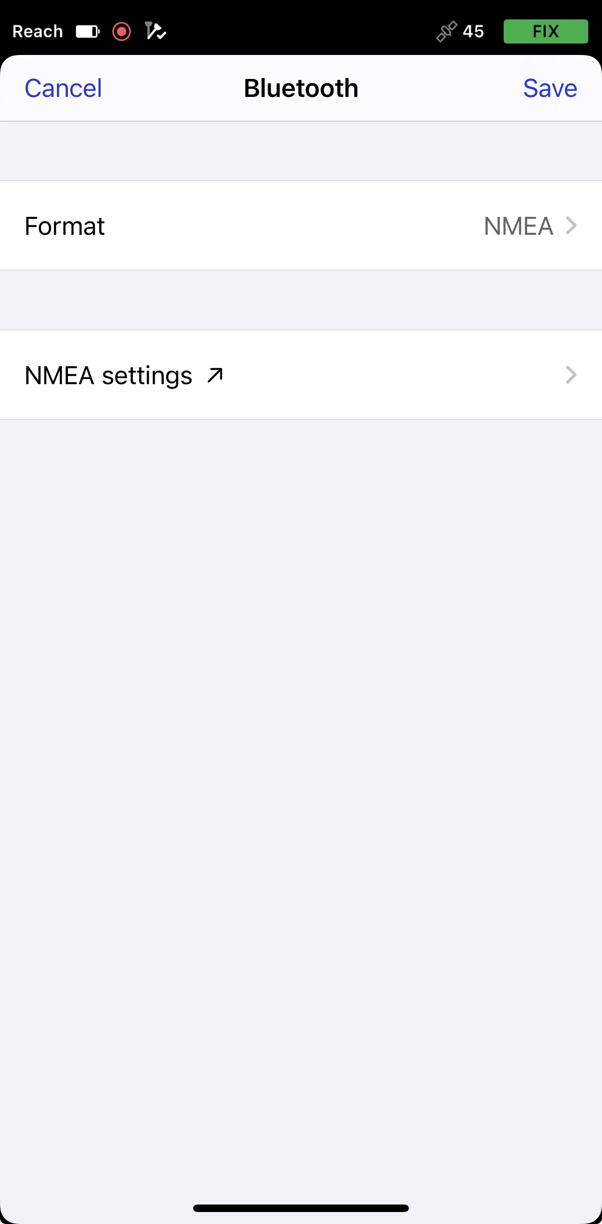

In Emlid Flow, go to Settings.
Tap Position streaming 1 and select Bluetooth.
To configure position streaming, tap the Edit button in the Bluetooth cell.
noteWhen connected to your Reach via Bluetooth, Emlid Flow will prompt you to connect to the Reach hotspot to access the streaming configuration settings.
Tap Format and choose NMEA.
Apply the necessary changes.

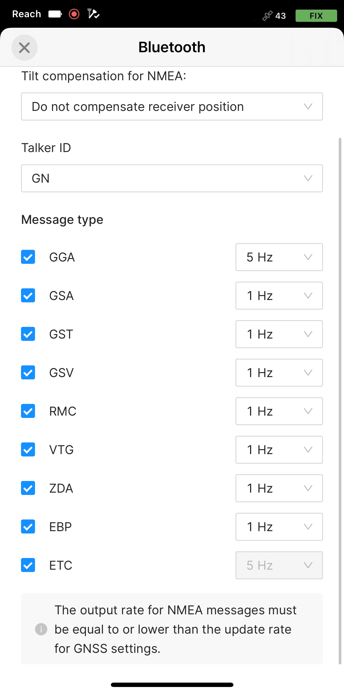

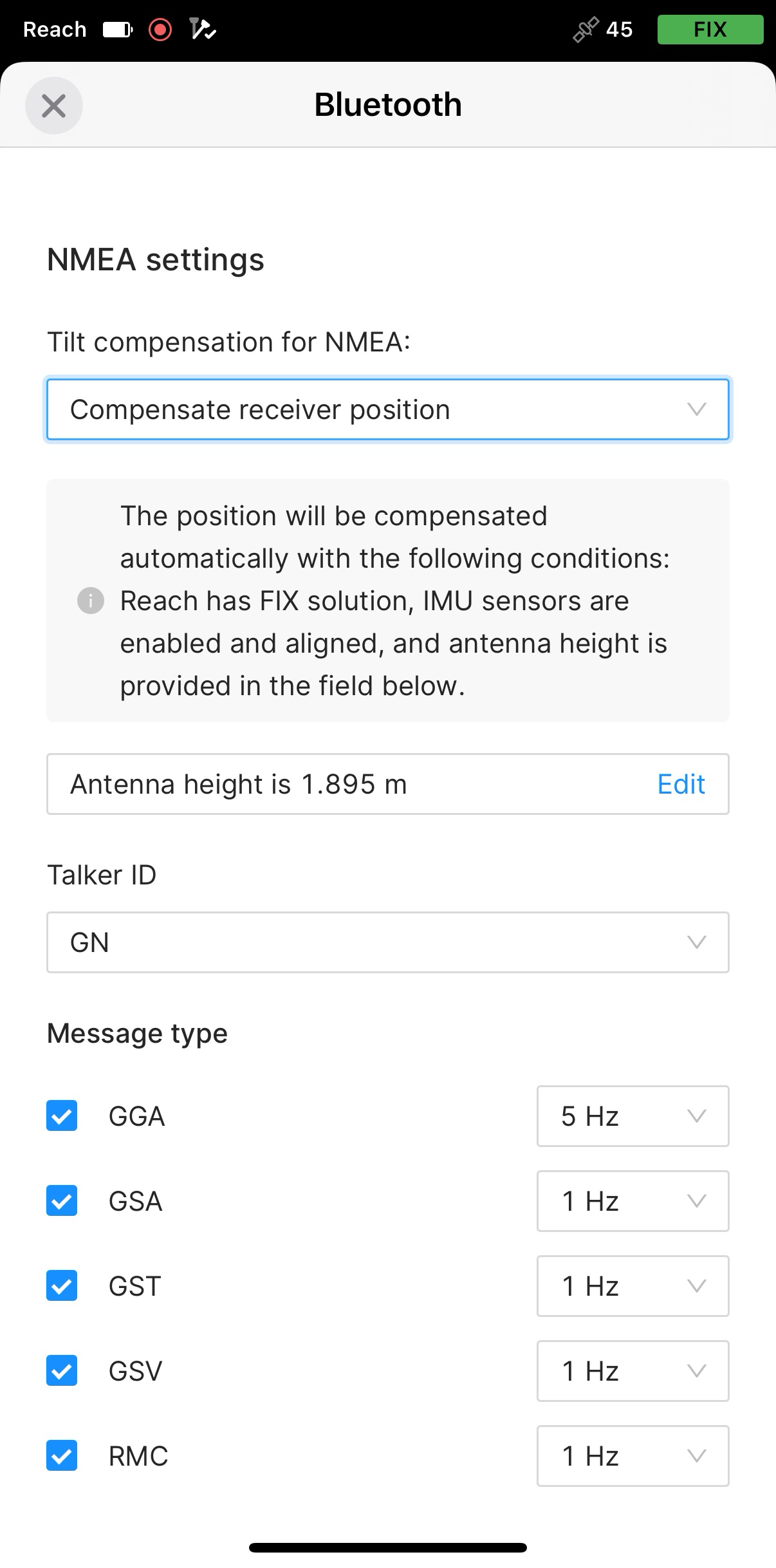

To send compensated NMEA messages, you need to enable it in Emlid Flow.

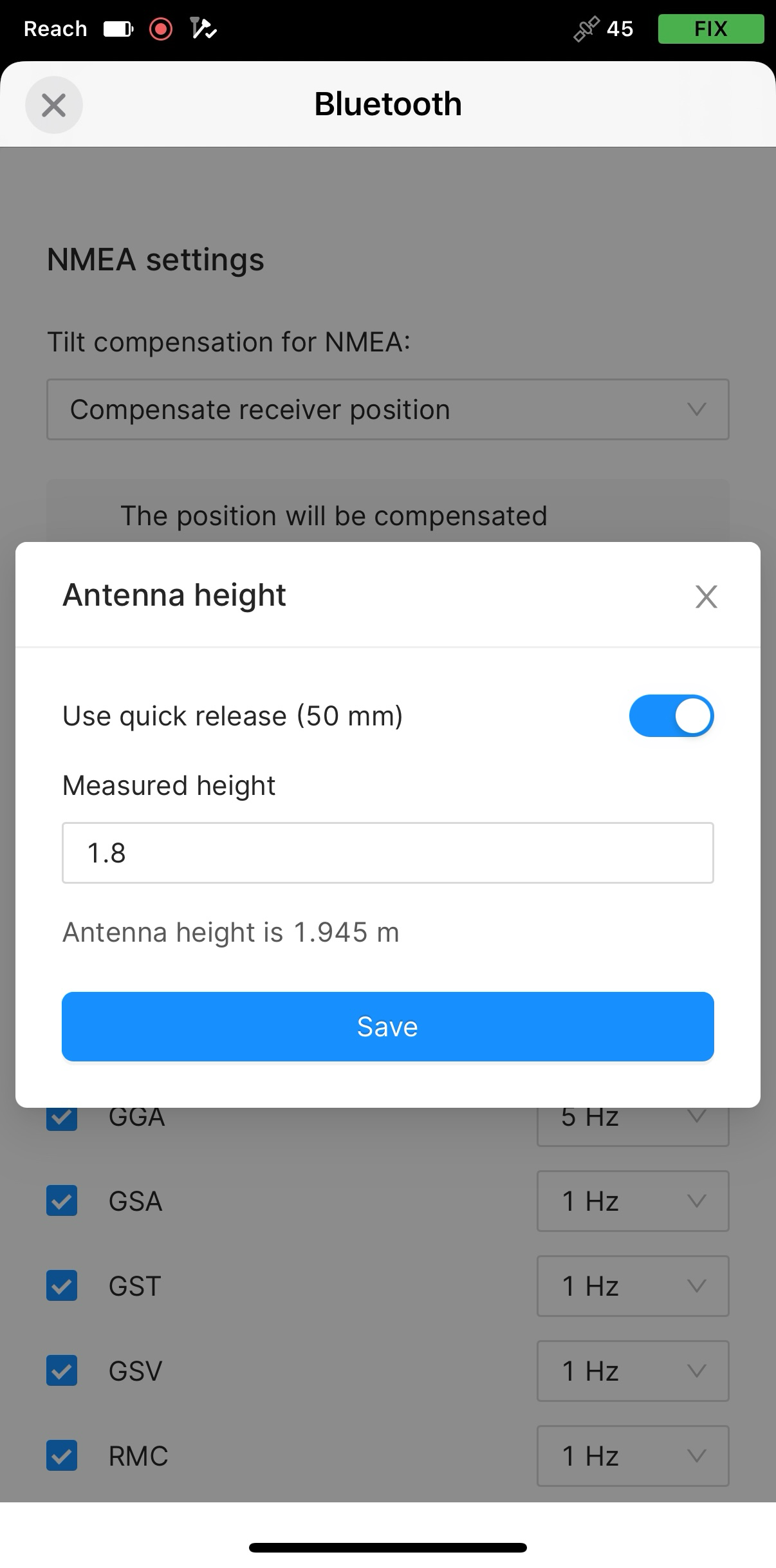

Set the antenna height. You only need to enter the pole height. Emlid Flow automatically applies the antenna phase center offset and adjusts the measurements accordingly.
cautionWhen sending compensated NMEA messages, set the antenna height only in Emlid Flow. Setting it in third-party apps as well may cause discrepancies.
tipIf you use a quick release, turn on the toggle to include its height in the antenna height calculation.

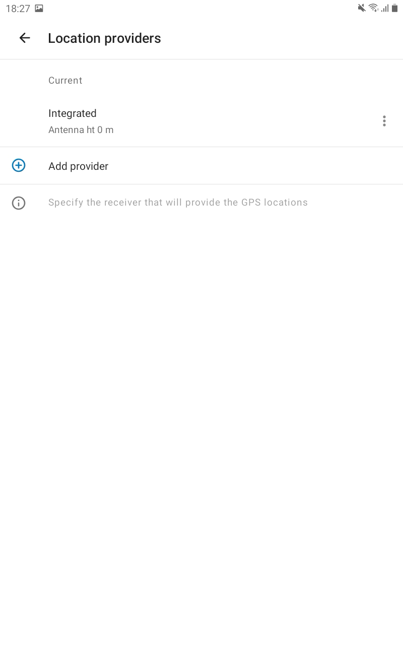

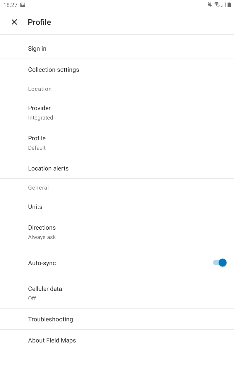

Open the ArcGIS Field Maps app.
Tap the Profile icon in the upper-right corner to open the settings.
Tap Provider in the Location section.
Tap the Plus button to add a provider.

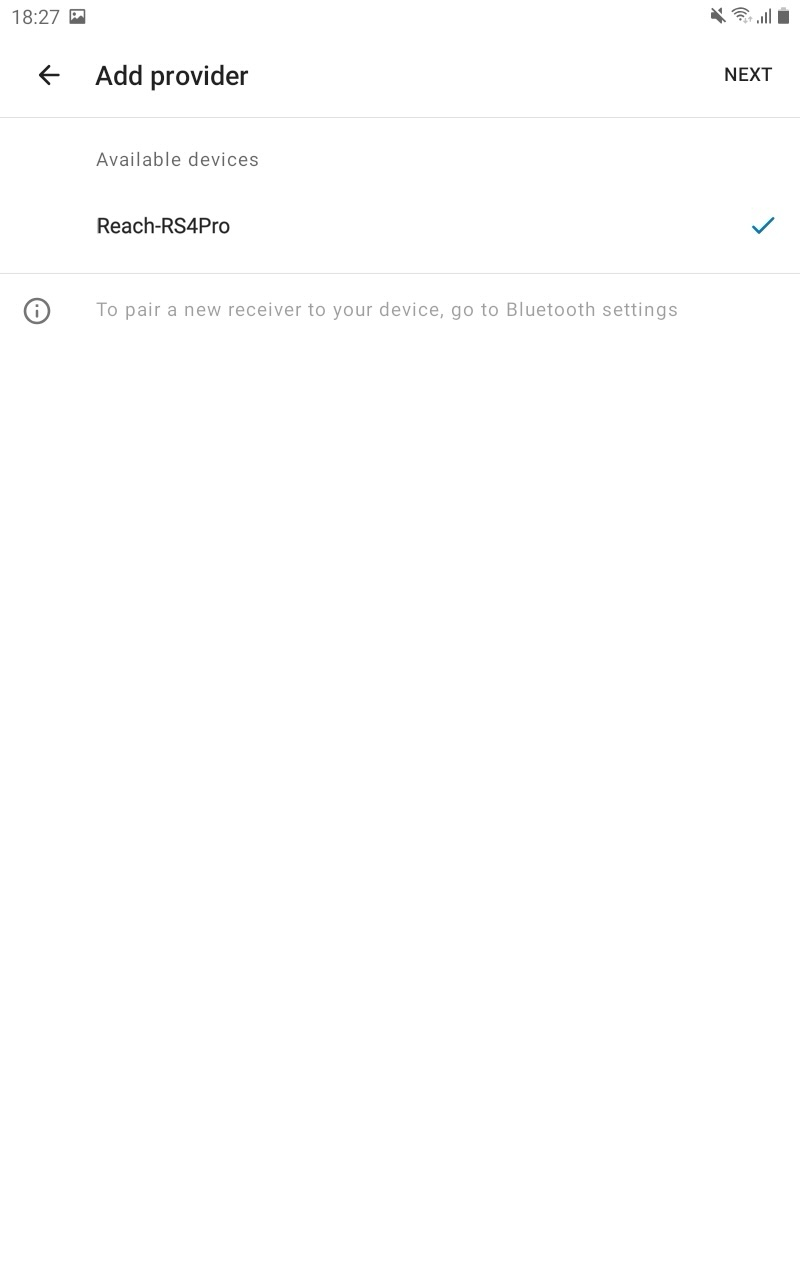

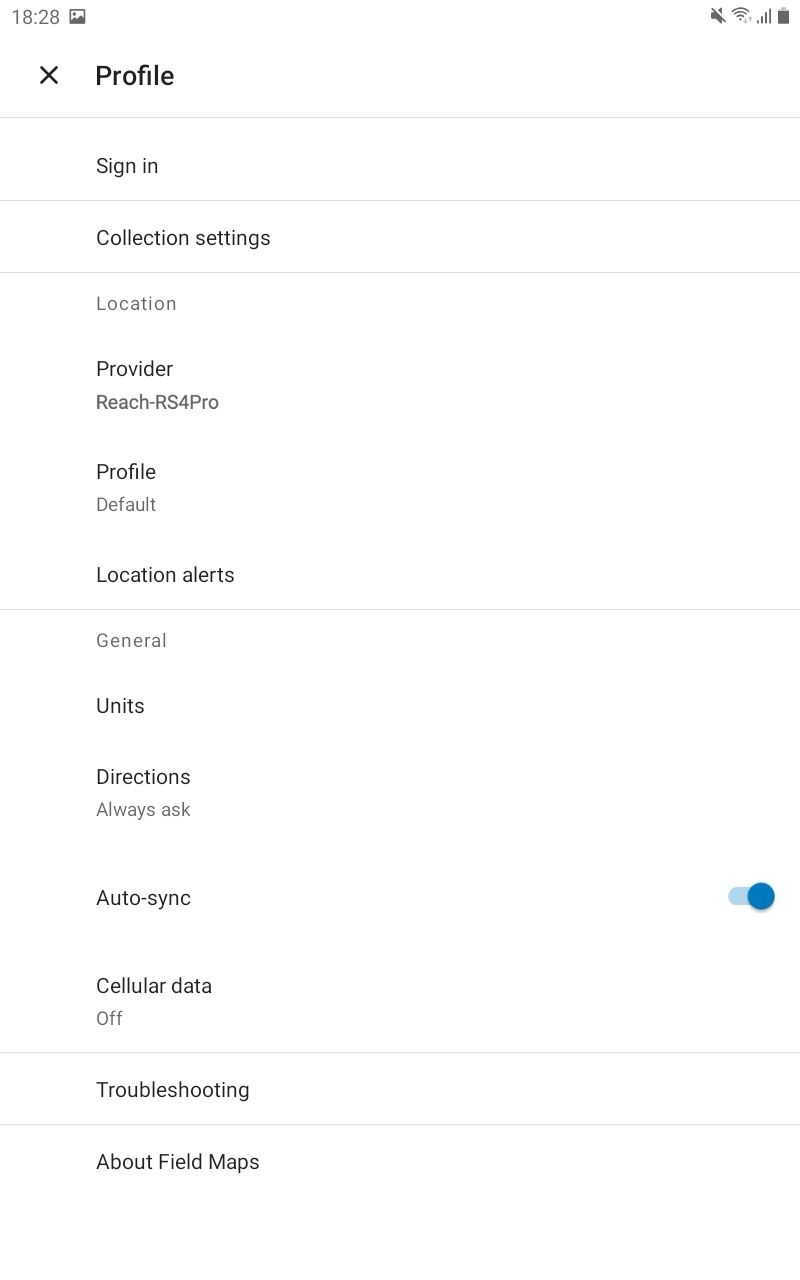

Select your Reach in the list of available devices. Tap NEXT.

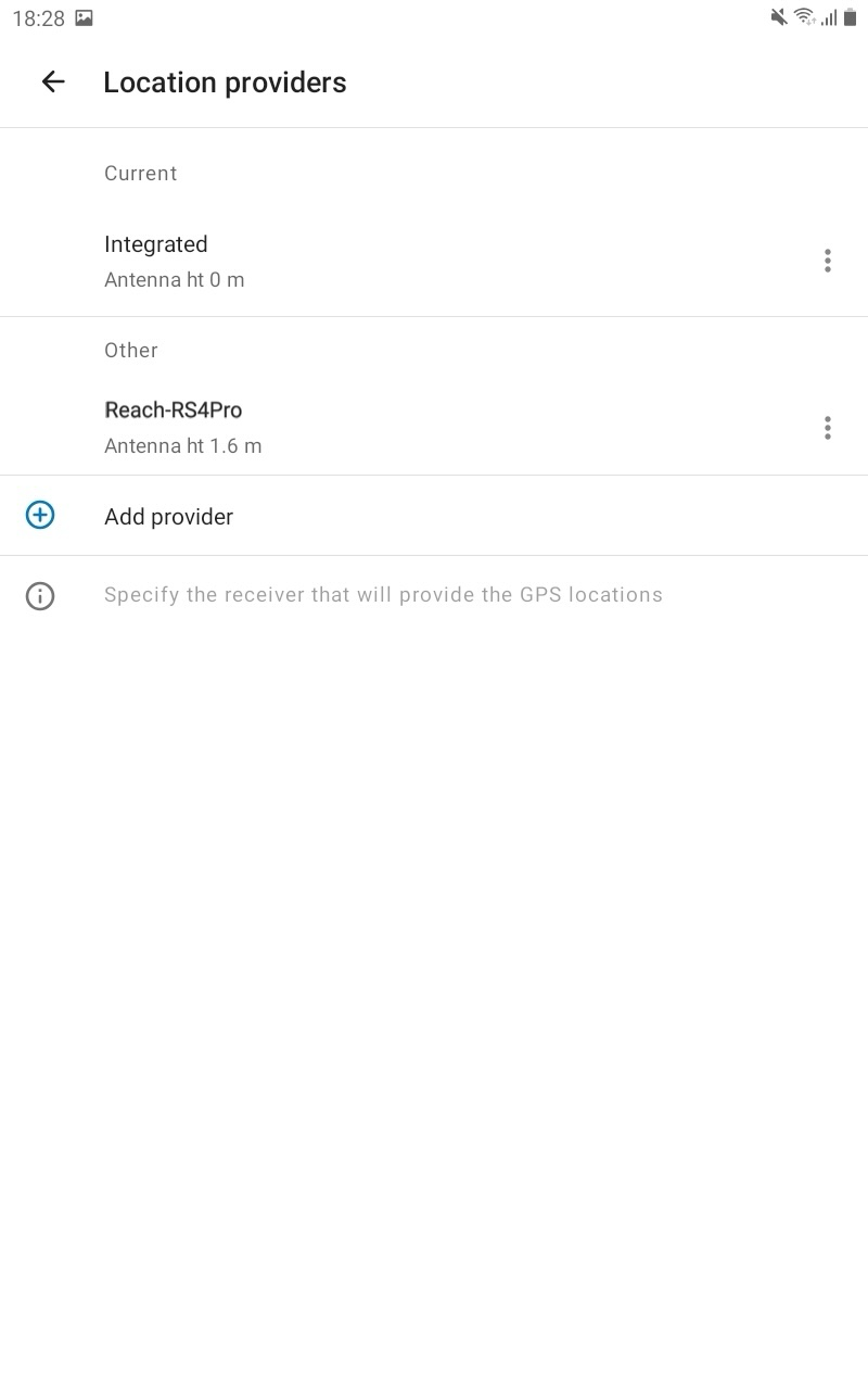

This step is only required when you don’t stream compensated NMEA position. Set the antenna height and tap DONE. Antenna offset is not added automatically in the Field Maps. The value you enter should include the pole height, the antenna offset of 95 mm, and an additional 50 mm if you use a quick-release adapter.

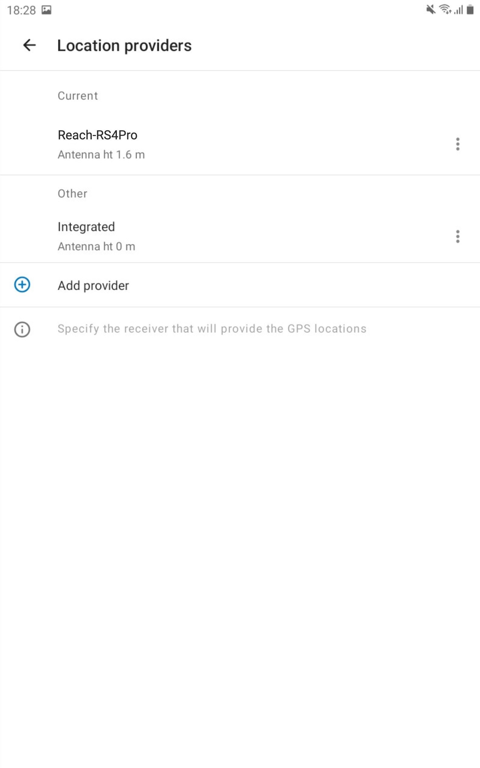

Tap Current. Tap on your Reach in the Other section. This Reach will be set as a current one.
Tap the back arrow to come back to your Profile settings.
You are now ready to proceed with the measurement of the GNSS data!
