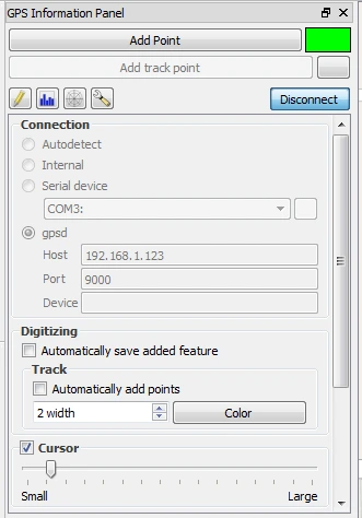

To configure the connection in QGIS, you might need to enable the GPS Information panel first. Go to the View list in the Menu bar and tick this option in the Panels field to accomplish this.
TCP​

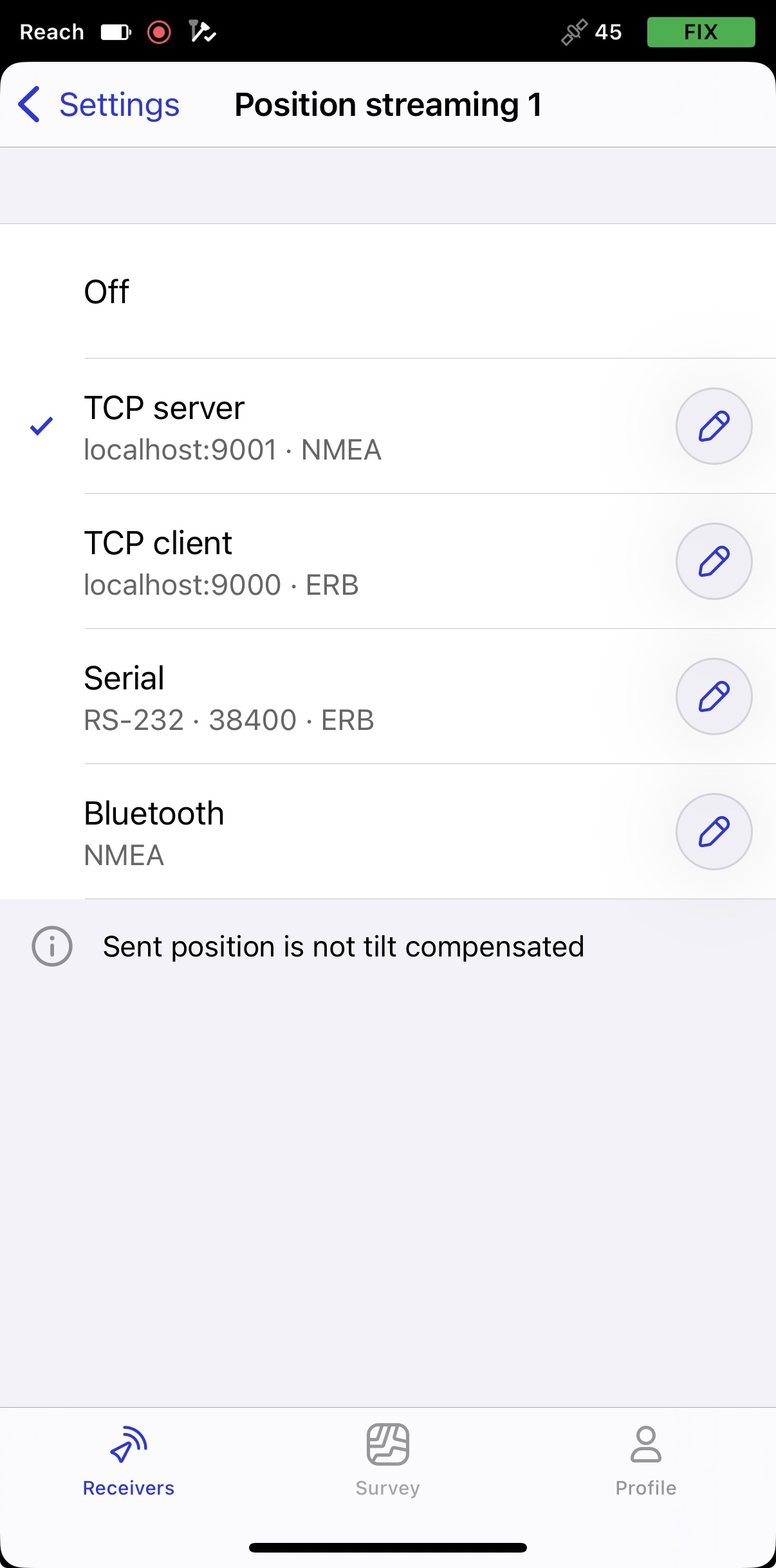

In order to connect over a local network, the computer running QGIS needs to be on the same network as the rover. This can be via the rover's hotspot. This screenshot shows the rover configuration and QGIS configuration. The port number is the same as we will enter in QGIS to find the position string.
In QGIS, the color panel turns green to indicate connection when we enter in the IP address of the rover and the port number.

For this, the settings on your rover should be as on the screenshot below.

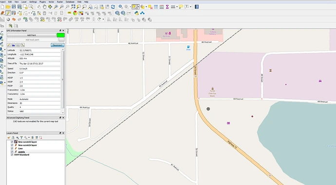

In QGIS, choose to connect by serial device and use the same COM port as is shown in connected devices.
Now that we are connected, we should see the Reach position in QGIS.
QGIS basics​

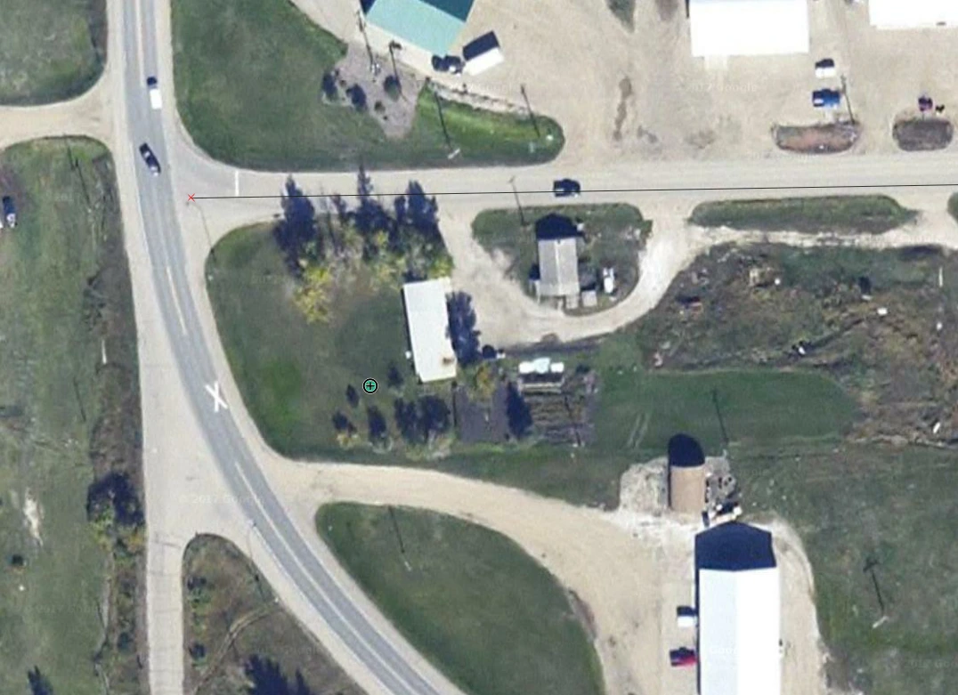

In QGIS, we can choose from a wide range of the background maps, including your own drone imagery.
The GPS panel shows status, but if you want to check for the solution status, it is better to keep an eye on the Emlid Flow app for that. Once we are connected and have our layers and snapping settings ready, we can add points, lines, and polygons, based on our location.

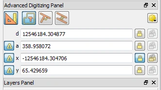

Let's see at the feature of manually entering lines. Often we need to enter a line and then enter distances and directions based on that line, e.g., 30 m at 90 degrees relative to a given line. QGIS has a feature called CAD tools that should work for this. First, enter the line (for example, a property line). Then, draw parallel or perpendicular lines from that one. This is found in the advanced digitizing panel. Here you can select the start point by vertex and then begin drawing from that point at a direction relative to a selected line.
Distances and angles can be preset. Back in the office after the survey, there are options to trim, extend, fillet linework, convert points to arcs, etc. These features could be used while surveying as well. Check out the plug-in QAD.
