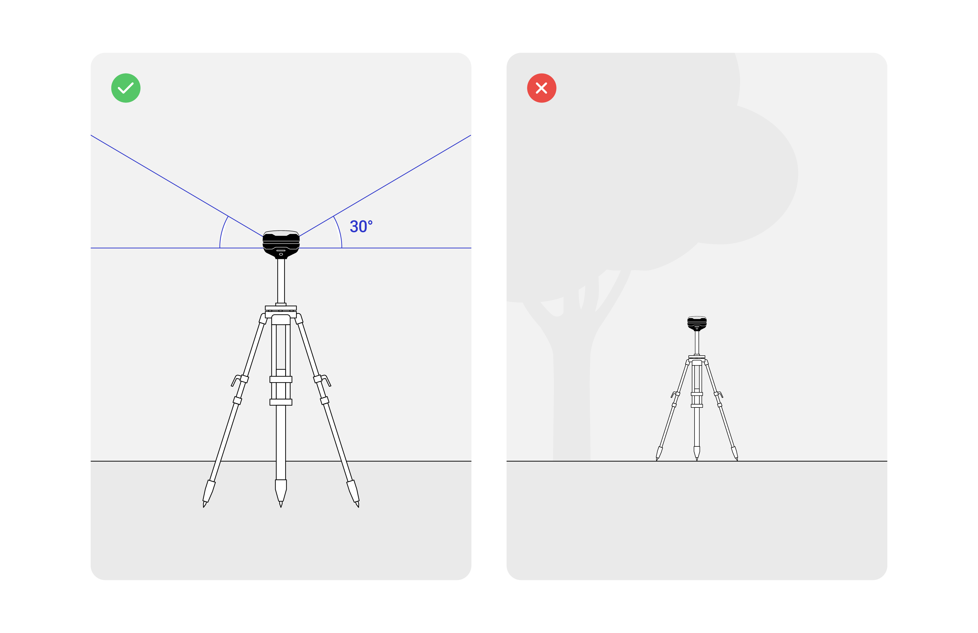

  1. Make sure you choose an appropriate location to place the Reach RS4 / RS4 Pro base station. Take a look at the 2 pictures below. The left picture demonstrates desirable conditions for the base location. The right one is an example of bad surrounding conditions such as the reduced view of the sky, possible obstructions or vegetation nearby.

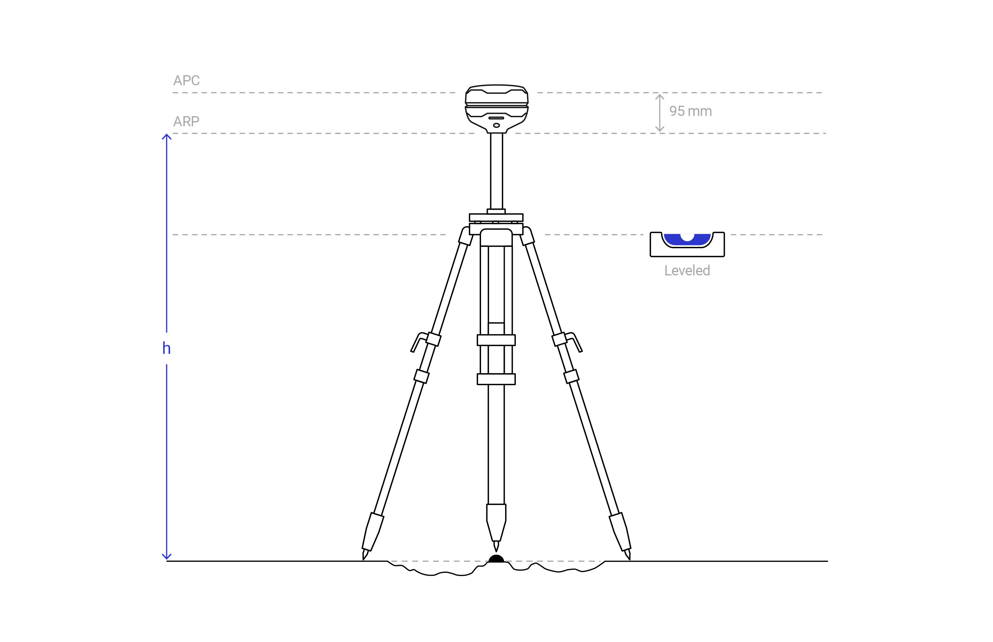

  2. Make sure your Reach RS4 / RS4 Pro is placed precisely above the marked point on the tripod and leveled.
  3. If you are setting up base coordinates manually, measure the antenna height offset.
    The antenna height is measured as the distance between the mark and the antenna reference point (ARP).
    For Reach RS4 / RS4 Pro, consider the antenna height as the distance between the mark and the bottom of Reach RS4 / RS4 Pro (h on the figure below) plus 95 mm.

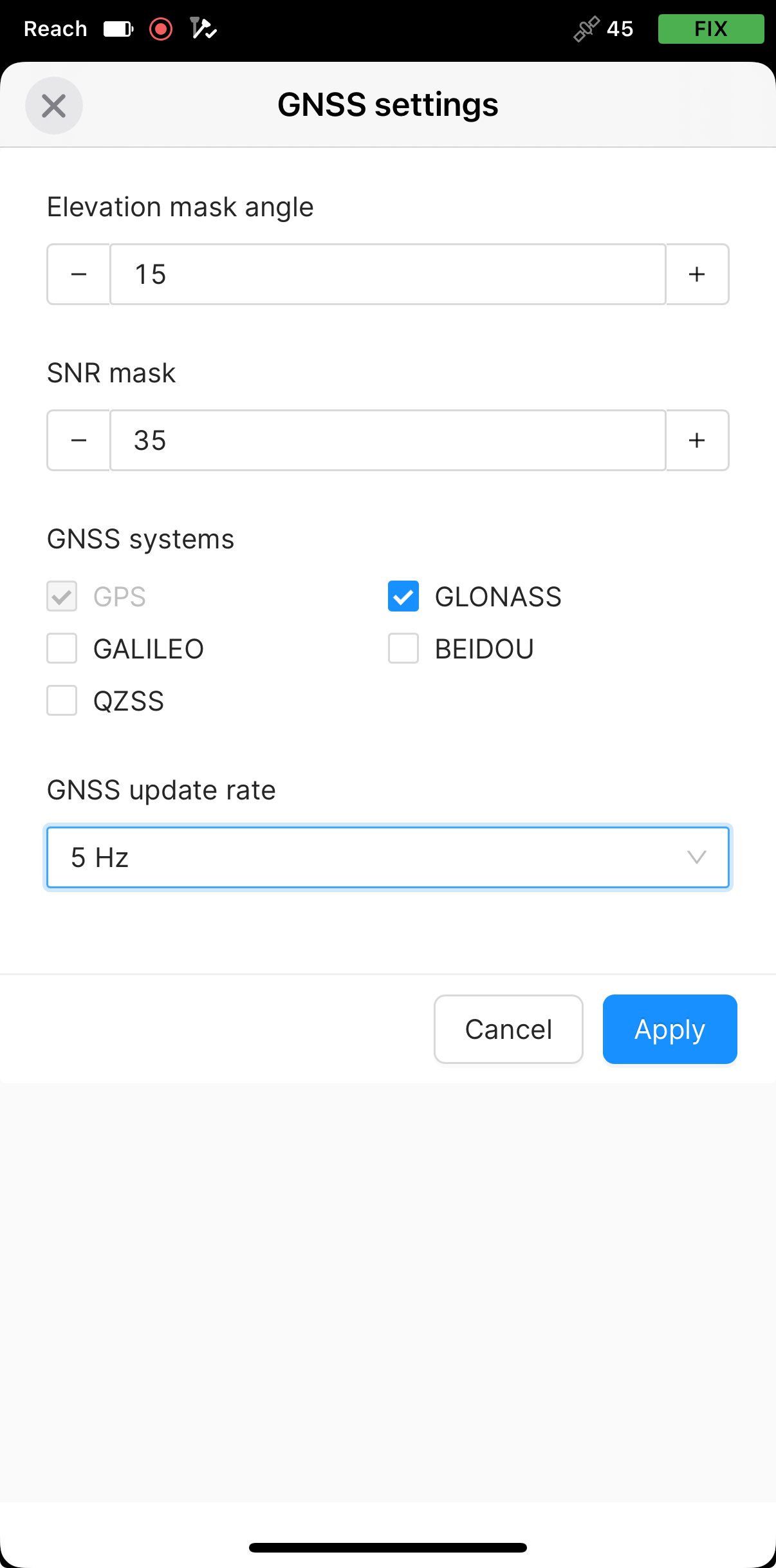

  2. On the Settings screen, tap GNSS settings.
  3. Select GNSS constellations as follows.
    For working with eBee drones, enable GPS and GLONASS at 1 Hz.

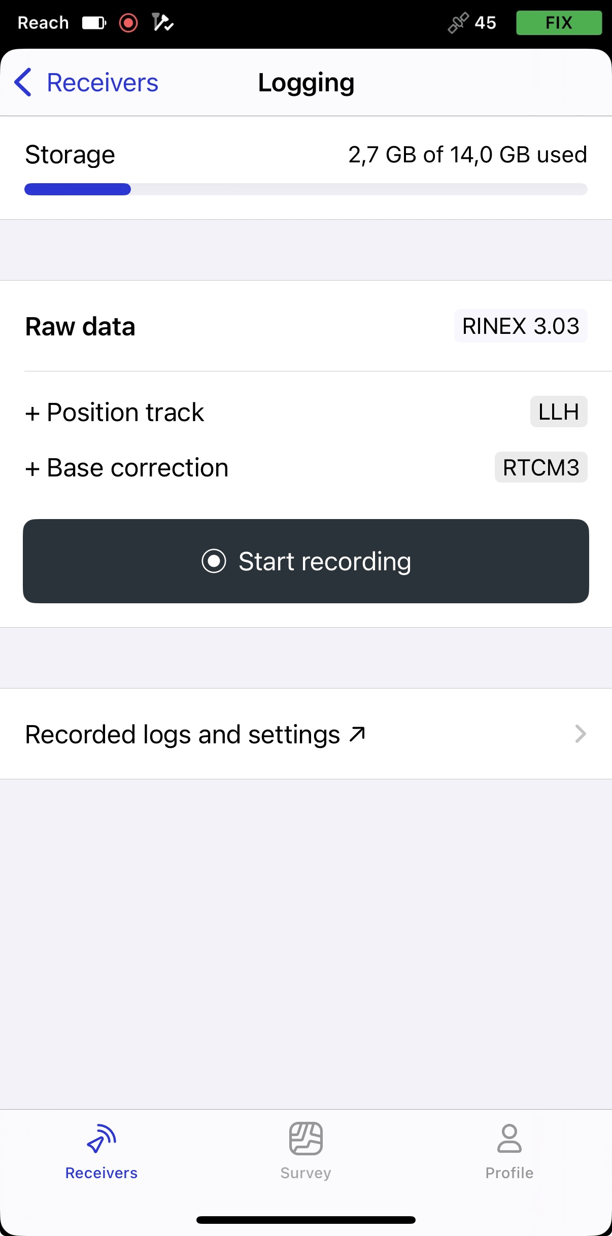

  4. Go back to the Receivers screen and tap Logging.
  5. Tap the Recorded logs and settings button.
  6. To configure logging, tap the blue gear button.
  7. In the Format and presets dropdown menu, choose UBX. Apply changes and close the Logging screen.

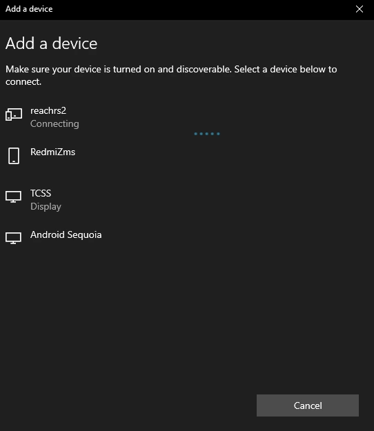

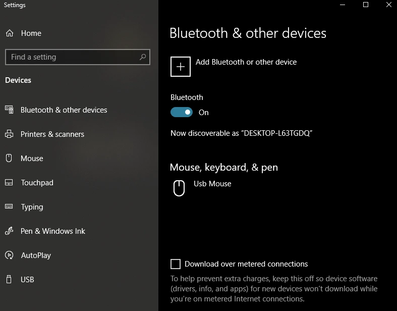

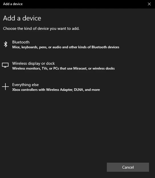

  1. Enable Bluetooth on your PC.
  2. Open Bluetooth settings.
  3. Click on Add Bluetooth or other device.

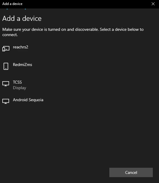

  1. Choose the Bluetooth option in the Add a device window.
  1. Make sure your Reach RS4 / RS4 Pro is discoverable and can be seen in the list of devices.
  1. Once you can see Reach RS4 / RS4 Pro in the list, connect to it.
If the connection is successful, you will get a message "Your device is ready to go!"
Now you can proceed to the next step.

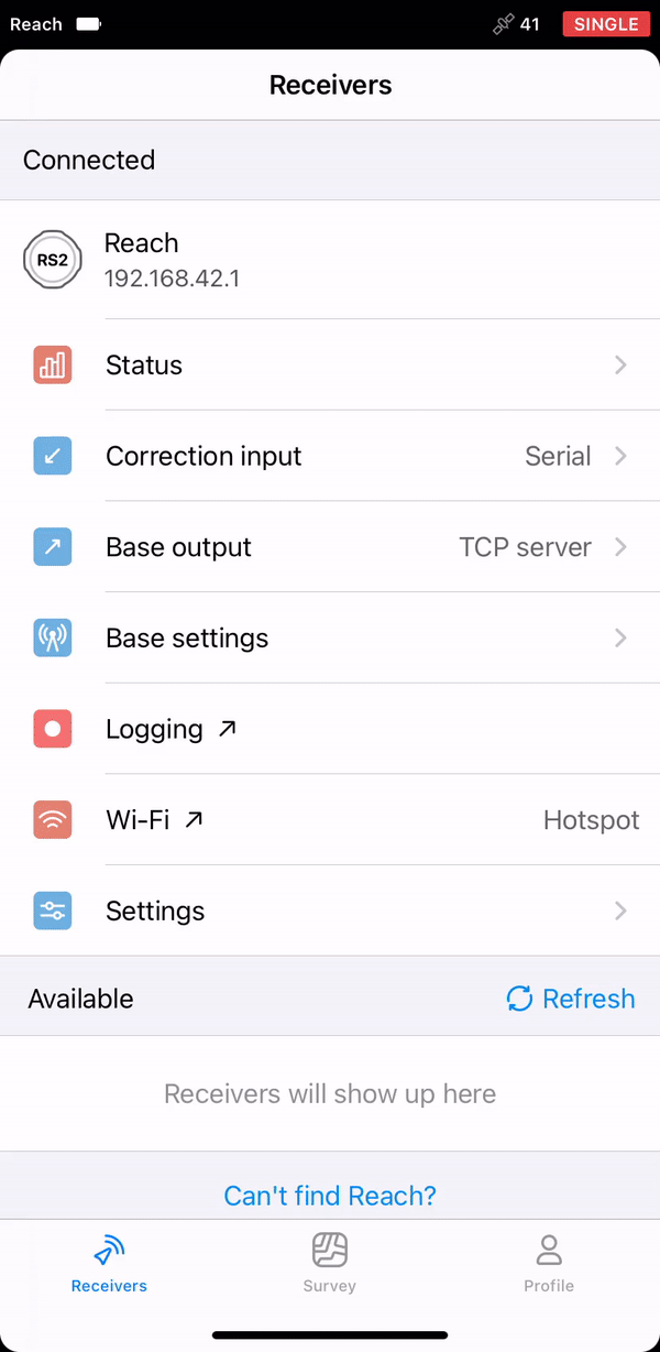

  1. On the Receivers screen in Emlid Flow, tap Base output.
  2. Choose Bluetooth.

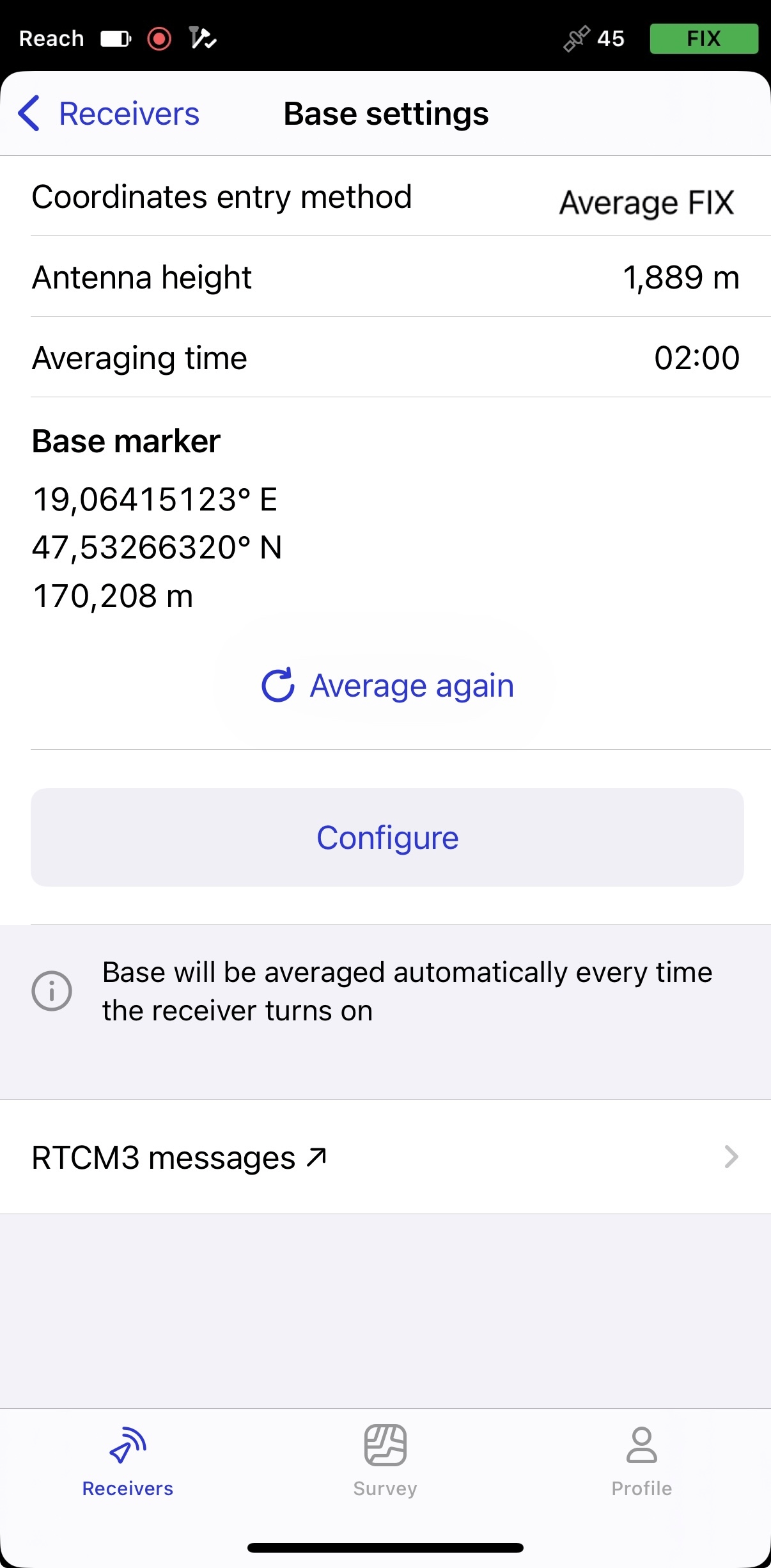

  3. Go back to the Receivers screen and tap Base settings.
  4. Choose Coordinate entry method. In this guide, we use Average Single.
    To learn more, check the Choosing base setup method guide.
  5. Fill-in Antenna height and then specify Averaging time.

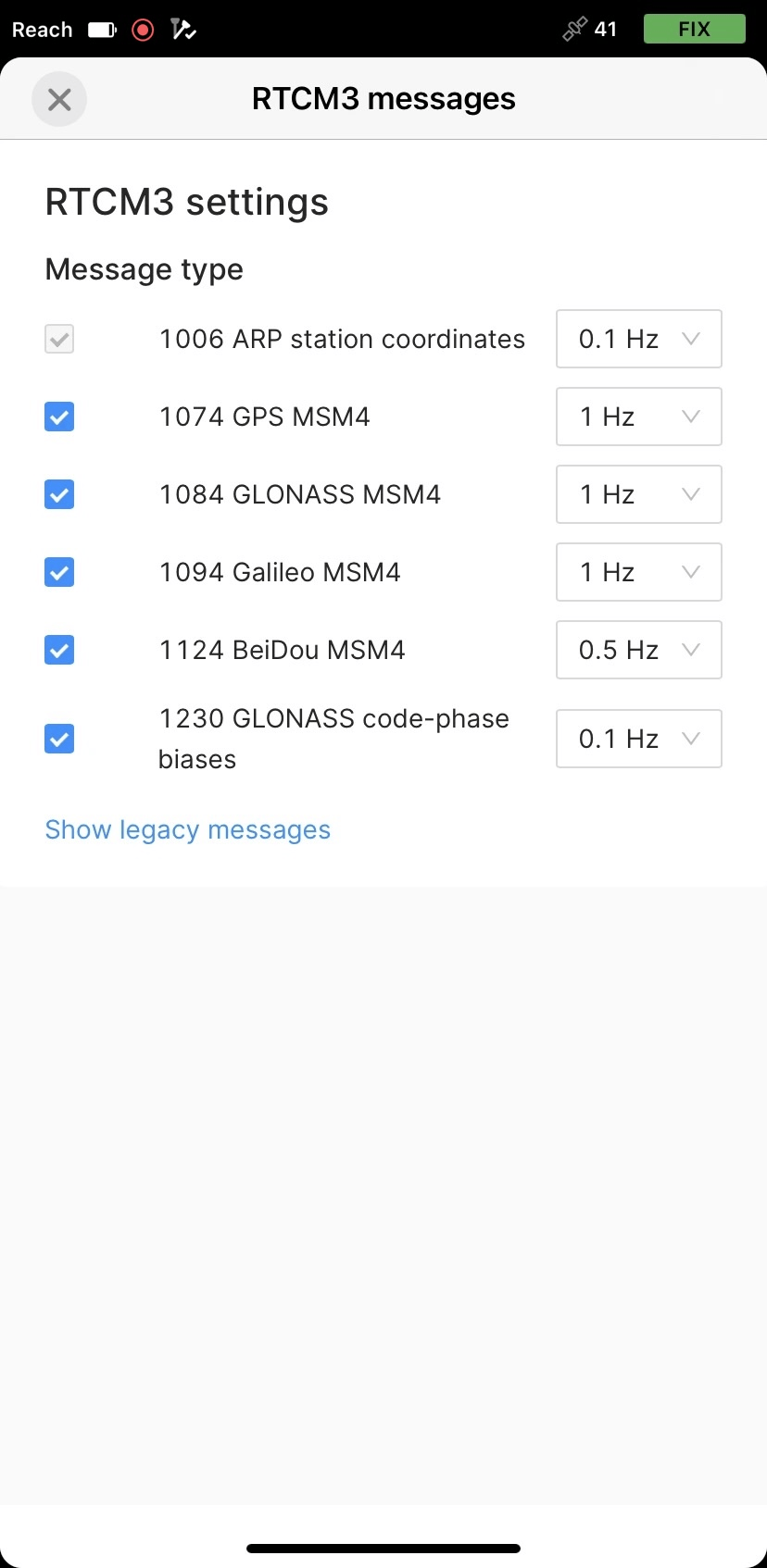

  6. Tap RTCM3 messages and Specify transmitted RTCM3 messages.
    RTCM3 messagesMessage type
    Minimal required messages
    1006ARP station coordinate
    1074GPS MSM4
    Optional messages for other GNSS
    1084GLONASS MSM4
    1094Galileo MSM4
    1124BeiDou MSM4

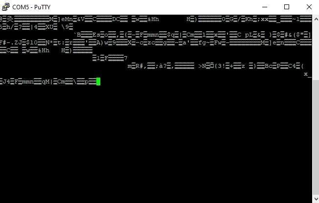

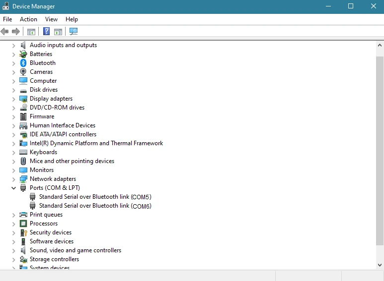

You will need to find out what COM port on your PC is used by Reach RS4 / RS4 Pro. For that, we recommend using the PuTTY client for Windows.
  1. Download and install PuTTY.
  2. Open Device Manager on your computer.
  3. Check available Standard Serial over Bluetooth link ports.

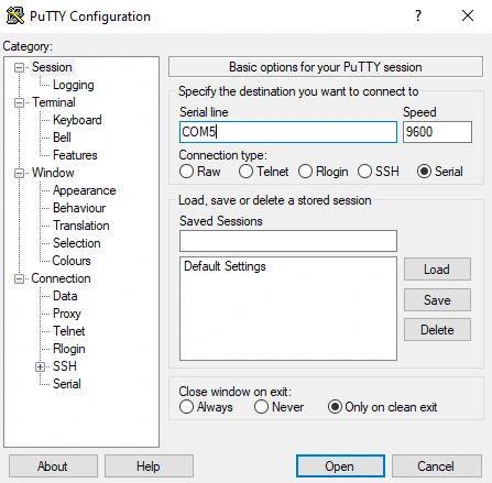

  4. Open PuTTY.
  5. Go to the Session tab.
  6. Specify the COM port in the Serial line.
  7. Choose speed at 9600.
  8. Choose the connection type Serial.

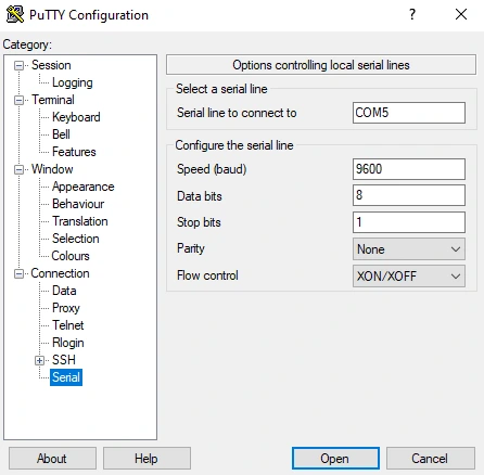

You can do the same in the Serial tab:
  1. Go to the Serial tab.
  2. Specify the COM port in the Serial line to connect to.
  3. Choose speed at 9600.
  4. Click Open
If you have chosen the correct port, you will see the corrections from Reach RS4 / RS4 Pro in the RTCM3 format on the screen. If you cannot see the data coming, choose another COM port in Serial line.

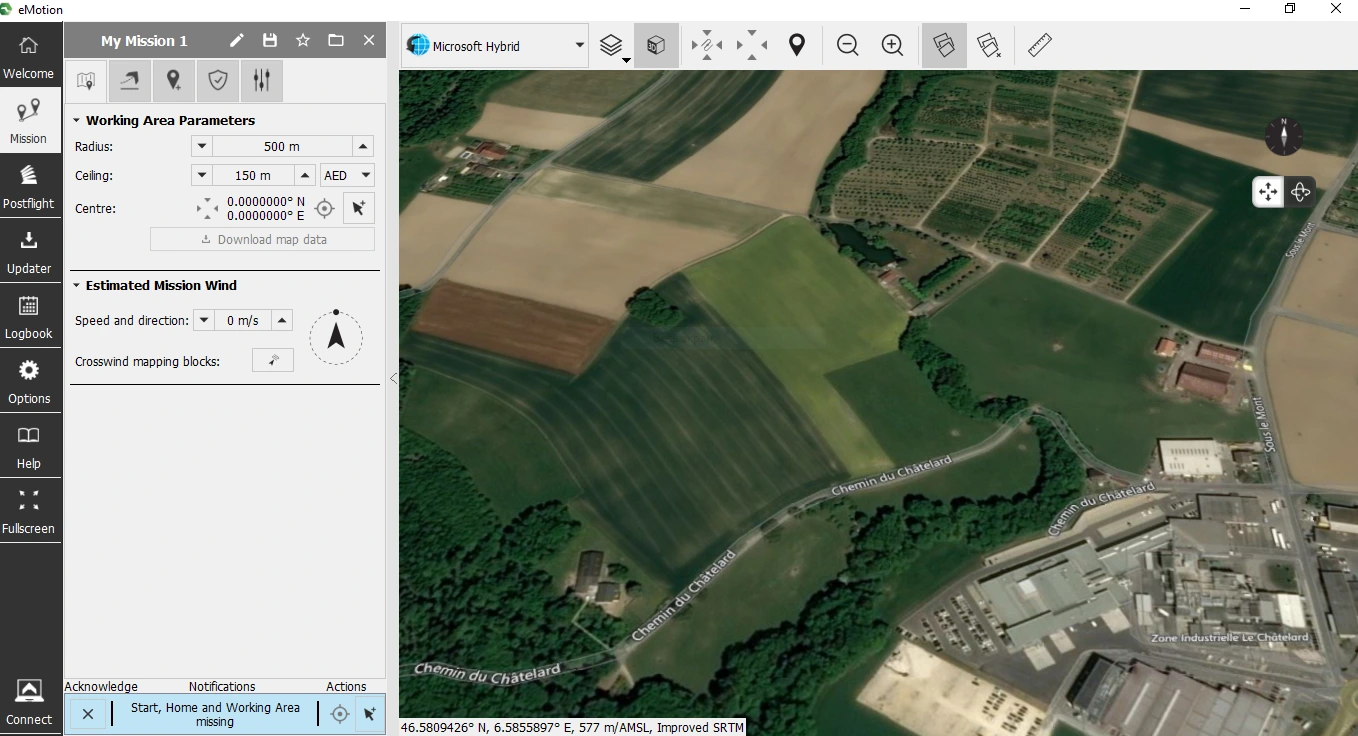

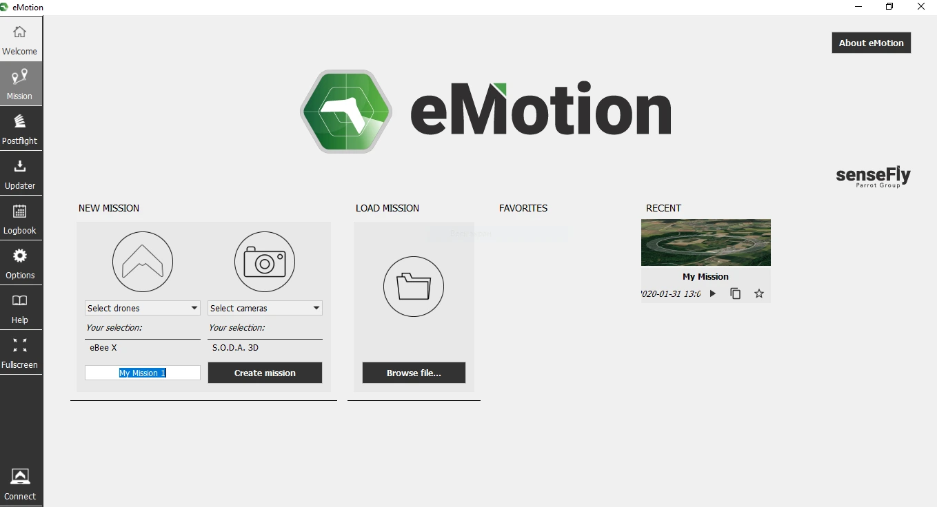

  1. Launch eMotion3.

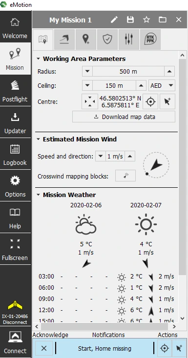

  2. Create a mission and go to the Mission tab.

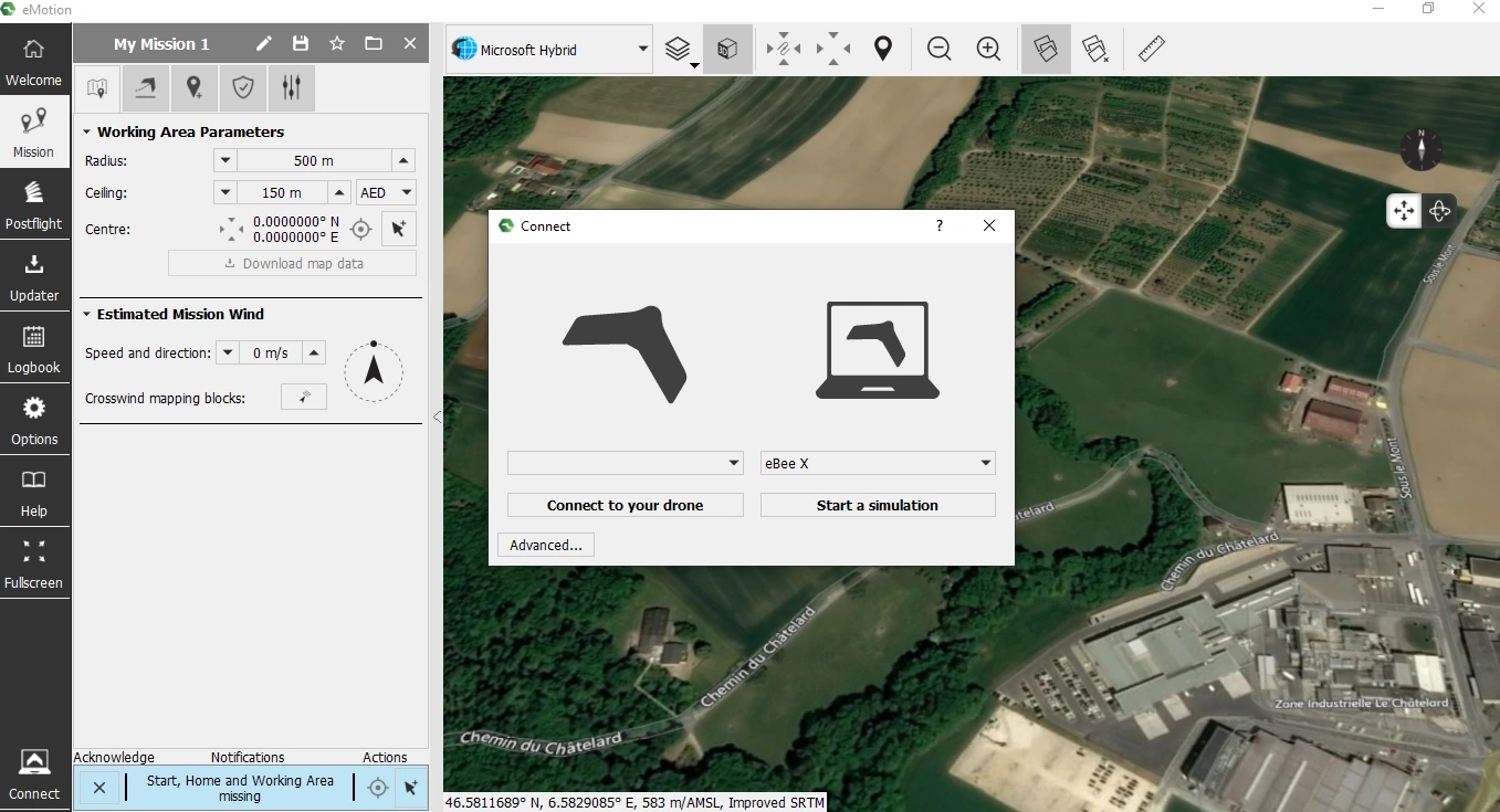

  3. Click the Connect button. Connect to the drone by clicking Connect to your drone or simulate your flight by clicking Start a simulation.

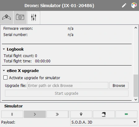

  4. Activate your RTK/PPK license in the eBee plus upgrade tab of the Drone's panel. To activate a license for simulation, tick an Activate update for simulator box.
    Now you can see the RTK tab enabled on your Mission panel on your left.

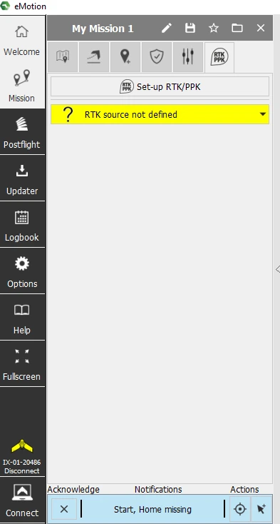

  5. Go to the RTK tab in the Mission panel.
  6. Click Set-up RTK/PPK to configure your base.

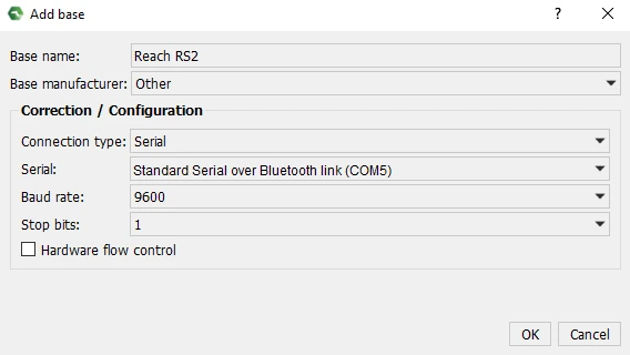

  7. In the opened window, you can specify either a base station, reference points or a VRS. To configure the base station, click Add base + in the Base tab.
  8. Set Reach RS4 / RS4 Pro to a Base name.
  9. Set Other to a Base manufacturer.
  10. Set Connection type to Serial.
  11. Choose the COM port that you checked on the previous step.
  12. Set the same baudrate for all connected devices.
  13. Click OK.

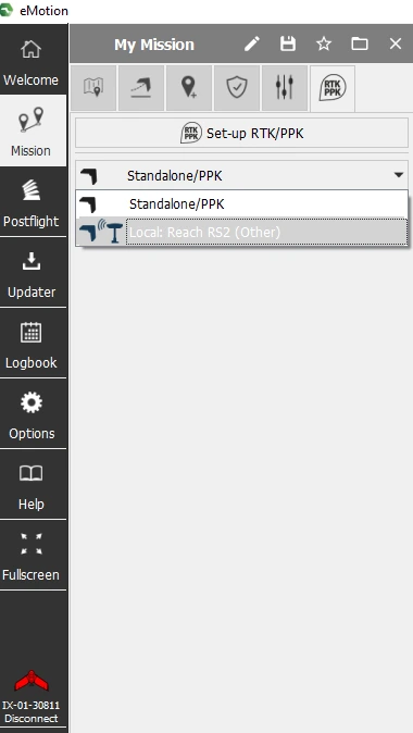

  1. Once you have configured the connection, you can choose the base station in the RTK tab.

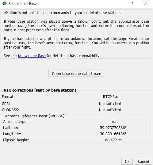

  1. Click on the chosen base station to see the Set up Local Base window.
  2. Click Open base-drone datastream.
If you are testing the setup inside, the GPS and GLONASS fields will show the Not sufficient message.
  1. Check the base position the drone receives.

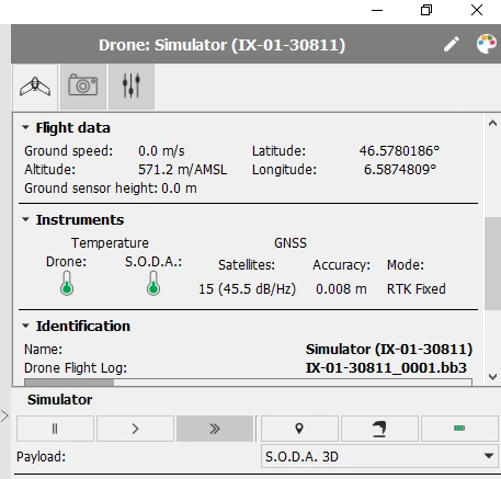

  1. Go to the Drone's panel. In the Instruments tab, you can see that the drone provides centimeter-level accuracy and the mode is RTK-fixed.
Now you have successfully configured RTK corrections on your drone from Reach RS4 / RS4 Pro.
