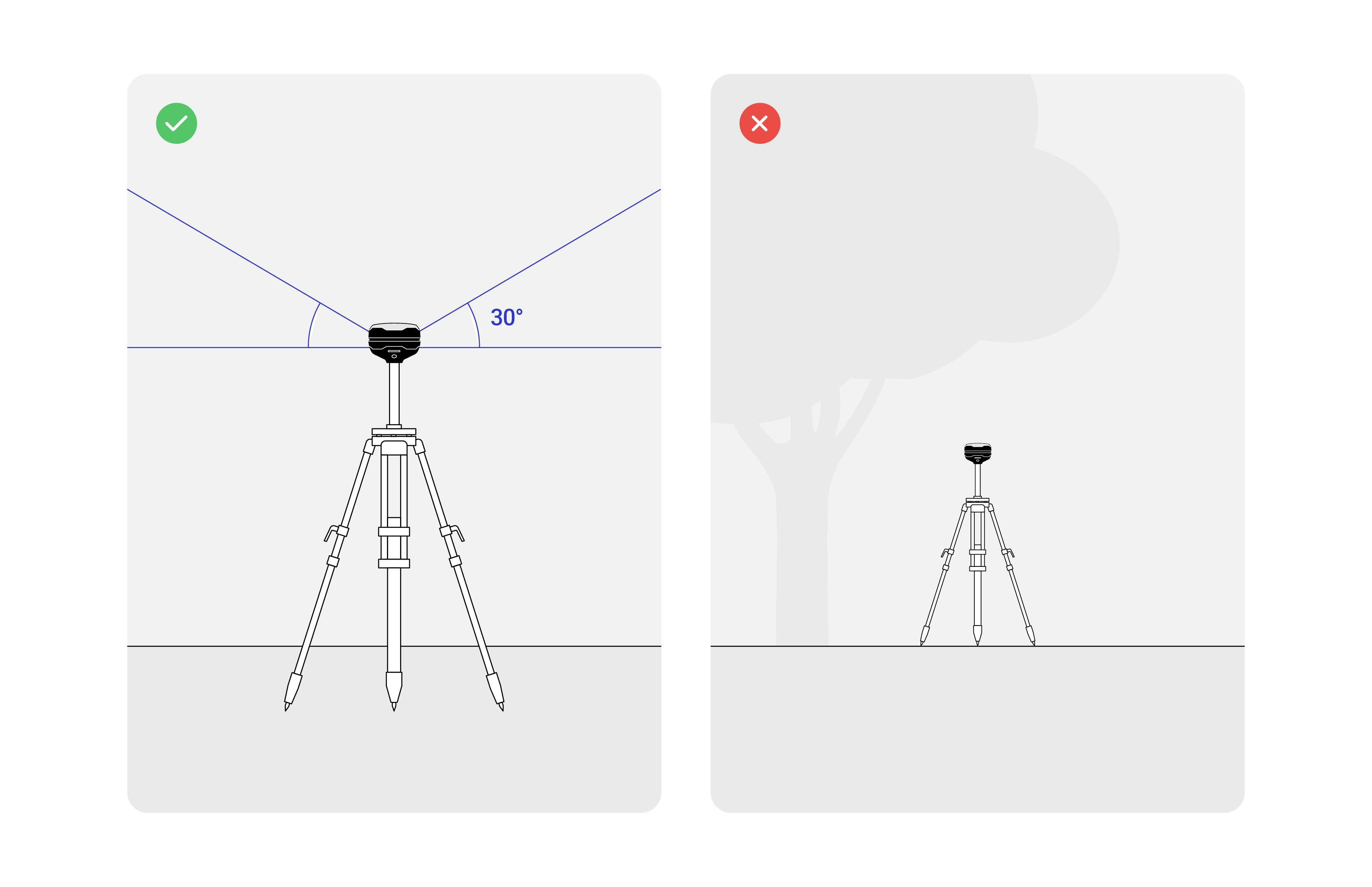

  1. Make sure you choose an appropriate location to place the Reach RS4 / RS4 Pro base station. Take a look at the 2 pictures below. The left picture demonstrates desirable conditions for the base location. The right one is an example of bad surrounding conditions such as the reduced view of the sky, possible obstructions or vegetation nearby.

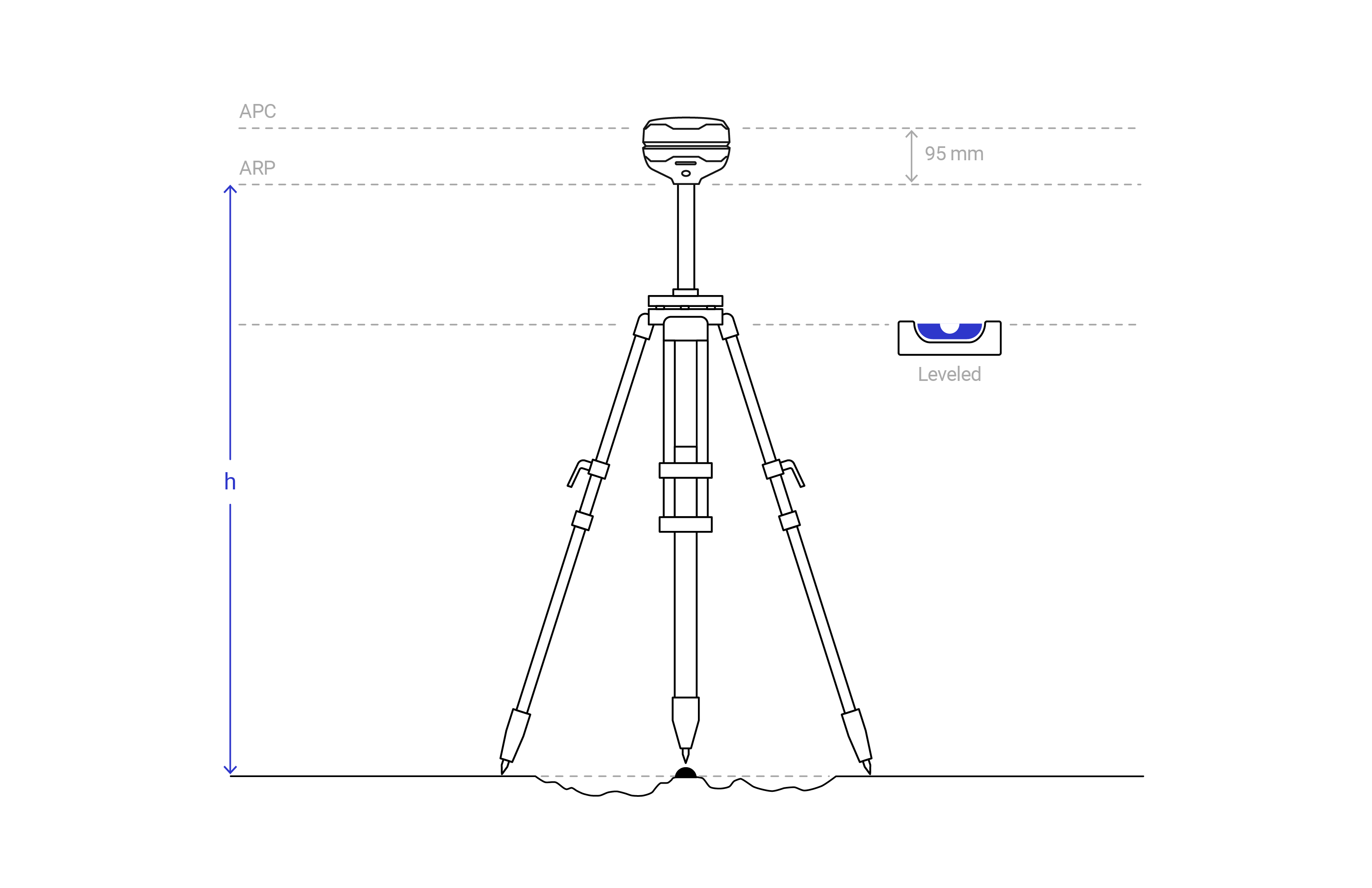

  2. Make sure your Reach RS4 / RS4 Pro is placed precisely above the marked point on the tripod and leveled.
  3. If you are setting up base coordinates manually, measure the antenna height offset.
    The antenna height is measured as the distance between the mark and the antenna reference point (ARP).
    For Reach RS4 / RS4 Pro, consider the antenna height as the distance between the mark and the bottom of Reach RS4 / RS4 Pro (h on the figure below) plus 95 mm.

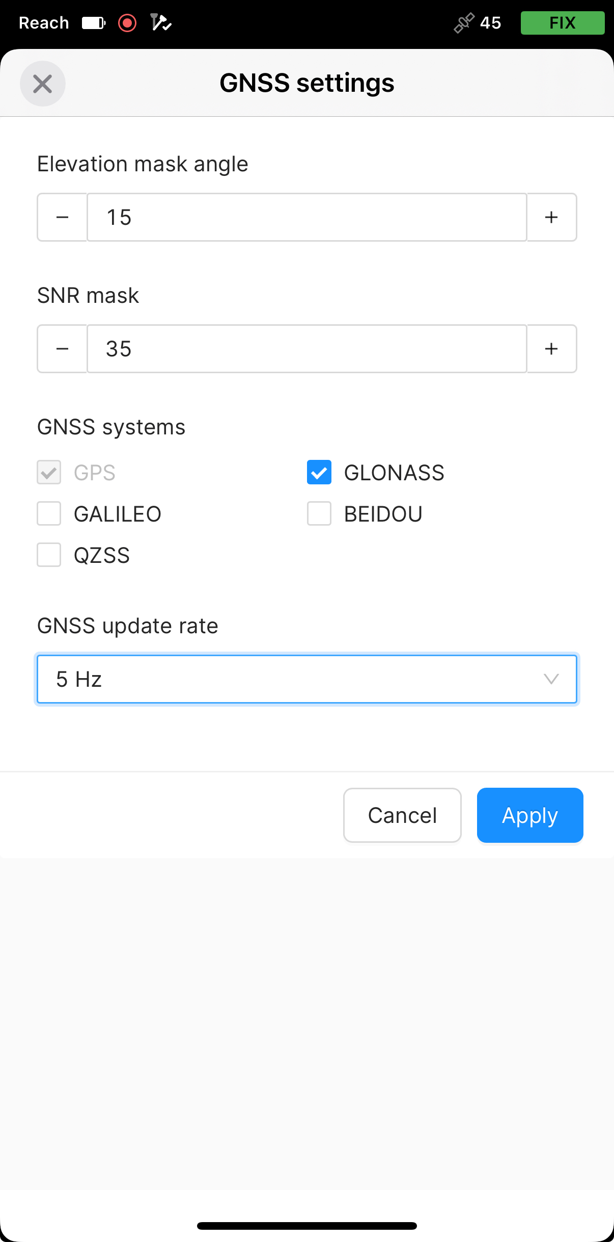

  5. On the Settings screen, tap GNSS settings.
  6. Select GNSS constellations as follows.
    Our default recommendation is all GNSS enabled at 1 Hz.

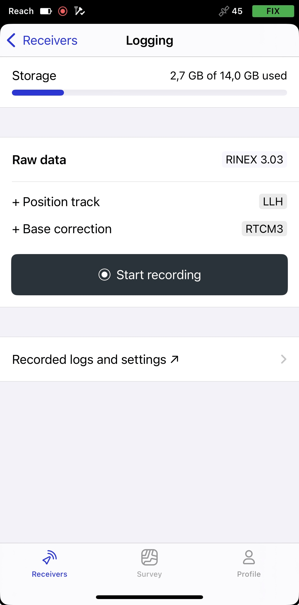

  7. Go back to the Receivers screen and tap Logging.
  8. Tap the Recorded logs and settings button.
  9. To configure logging, tap the Settings button.
  10. In the Format and presets dropdown menu, choose UBX. Apply changes.

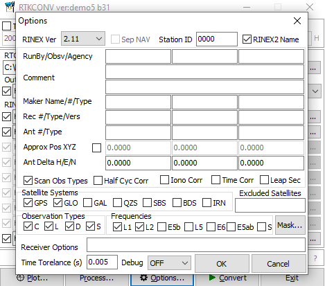

  4. Click the Options button.
  5. Choose RINEX Version 2.11.
  6. Turn on Satellites Systems you need.
  7. Click OK.

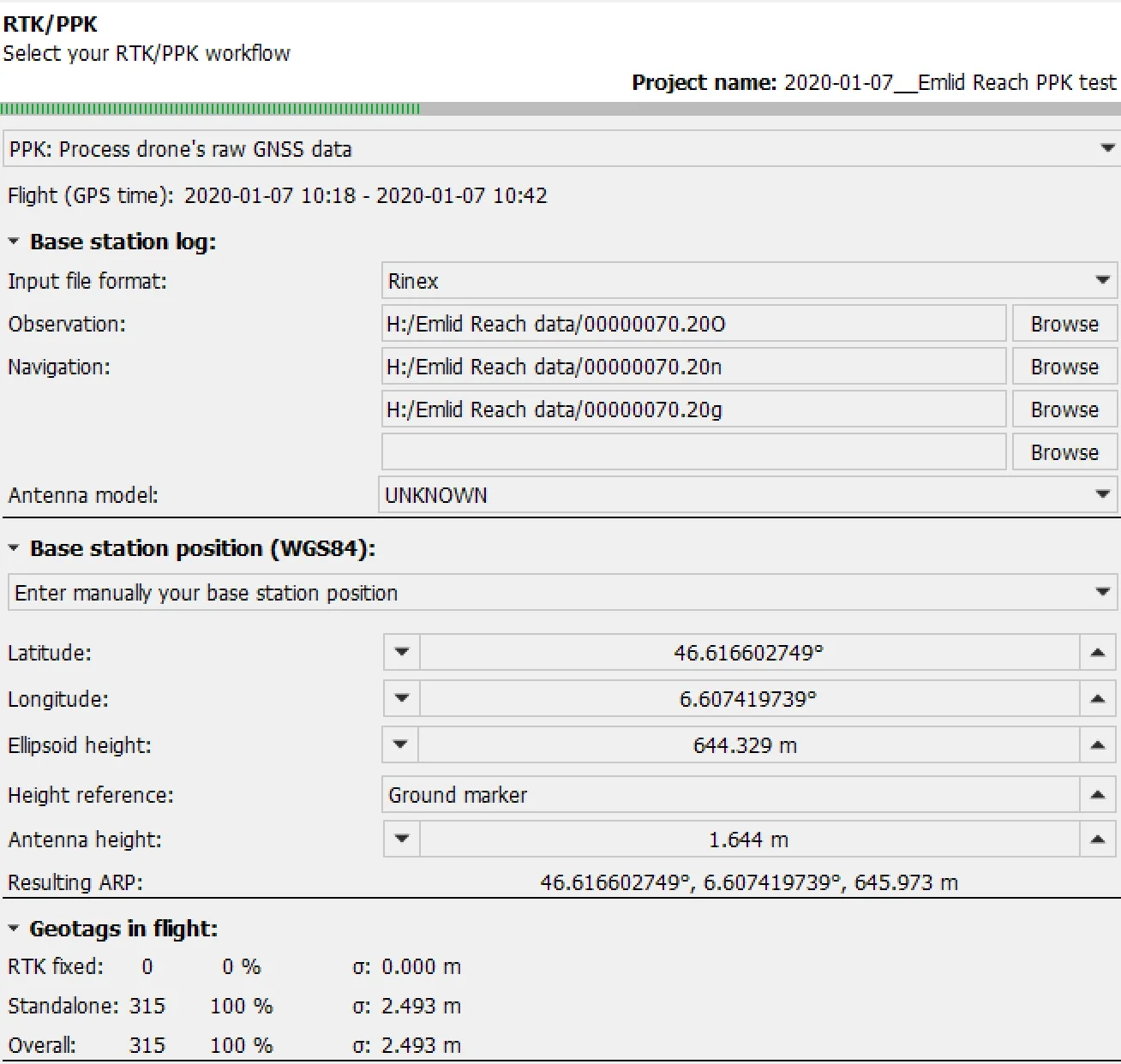

Post-processing with eMotion​
  1. Launch eMotion3 and select post flight FDM (Flight Device Manager).
  2. Create a project and import the flight logs. Proceed to the RTK/PPK workflow tab.
  3. Set Input file format to RINEX.
  4. Select newly converted RINEX O, N and G files from the Reach RS4 / RS4 Pro base.
  5. Set Antenna model to UNKNOWN.
  6. Fill the base position field with the known coordinates of the marked ground point (ground marker).
  7. Set the Height Reference to the Ground marker.
  8. Enter the Antenna height calculated according to the explanation in this step for the receiver.

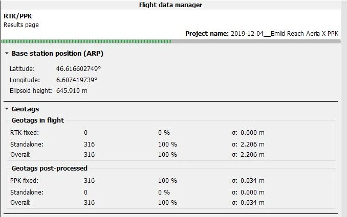

  9. Click Next to calculate the solution.
  10. Once Calculated solution is finished, the Geotags are post-processed based on the RINEX file with the corrected base position.
  1. Proceed to the remaining FDM steps to complete the Postflight process.
Now you have successfully post-processed logs from Reach RS4 / RS4 Pro and the eBee drone.
