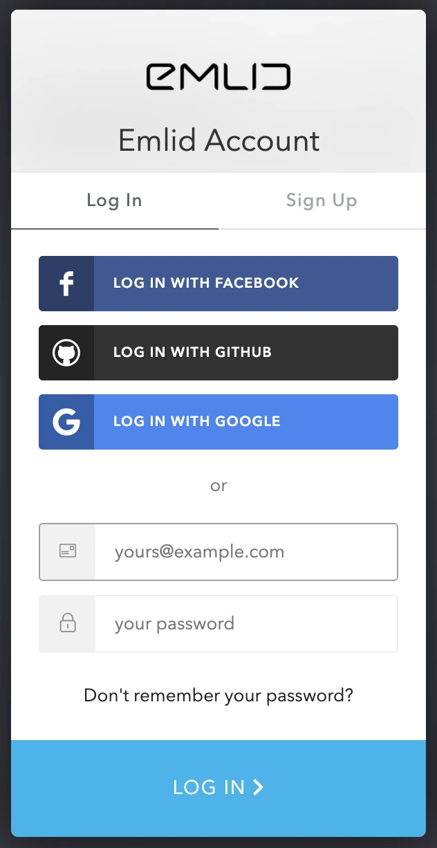

  1. Go to caster.emlid.com.
  2. Sign up or sign in using your Emlid account.
Once you sign up, you will access the page with NTRIP credentials for both the base and rover, which are generated automatically. From this moment, you can use these credentials to connect your base and rover to a mount point.

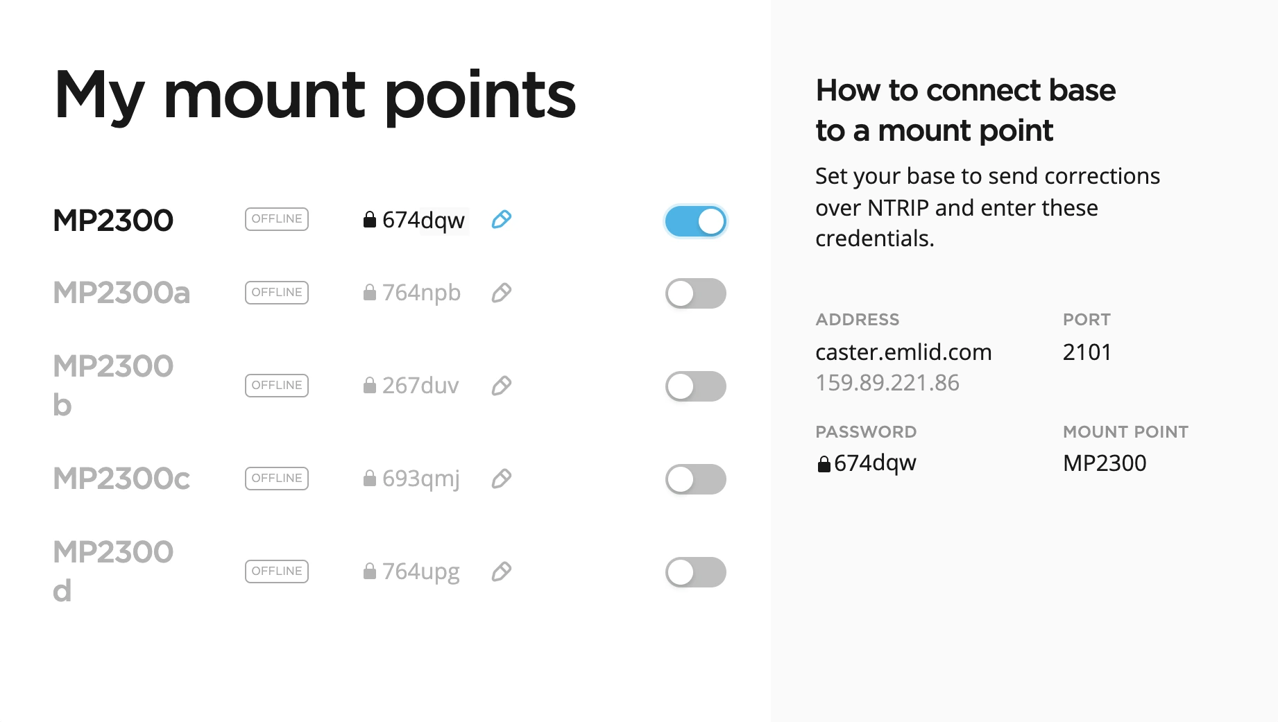

  1. Activate the mount point you want to use by switching on the toggle.

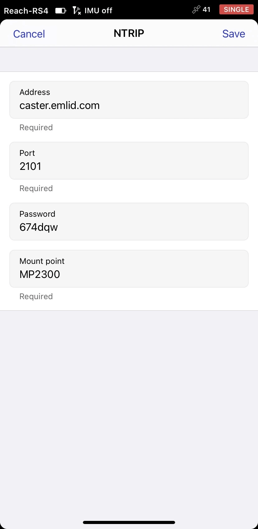

  1. Connect to your base via Emlid Flow, go to Base output, and set it up to send corrections over NTRIP using the obtained credentials:
    • Address
    • Port
    • Password
    • Mount point

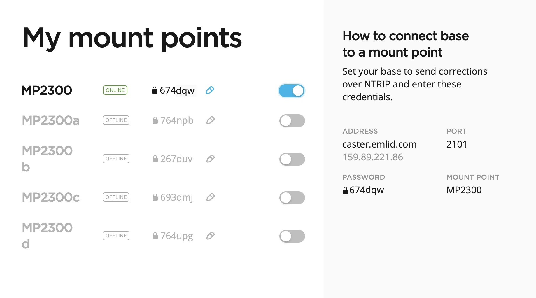

Make sure you configured your base to output corrections via NTRIP.
Once you successfully connect your base, you will see the ONLINE notification next to the mount point name.

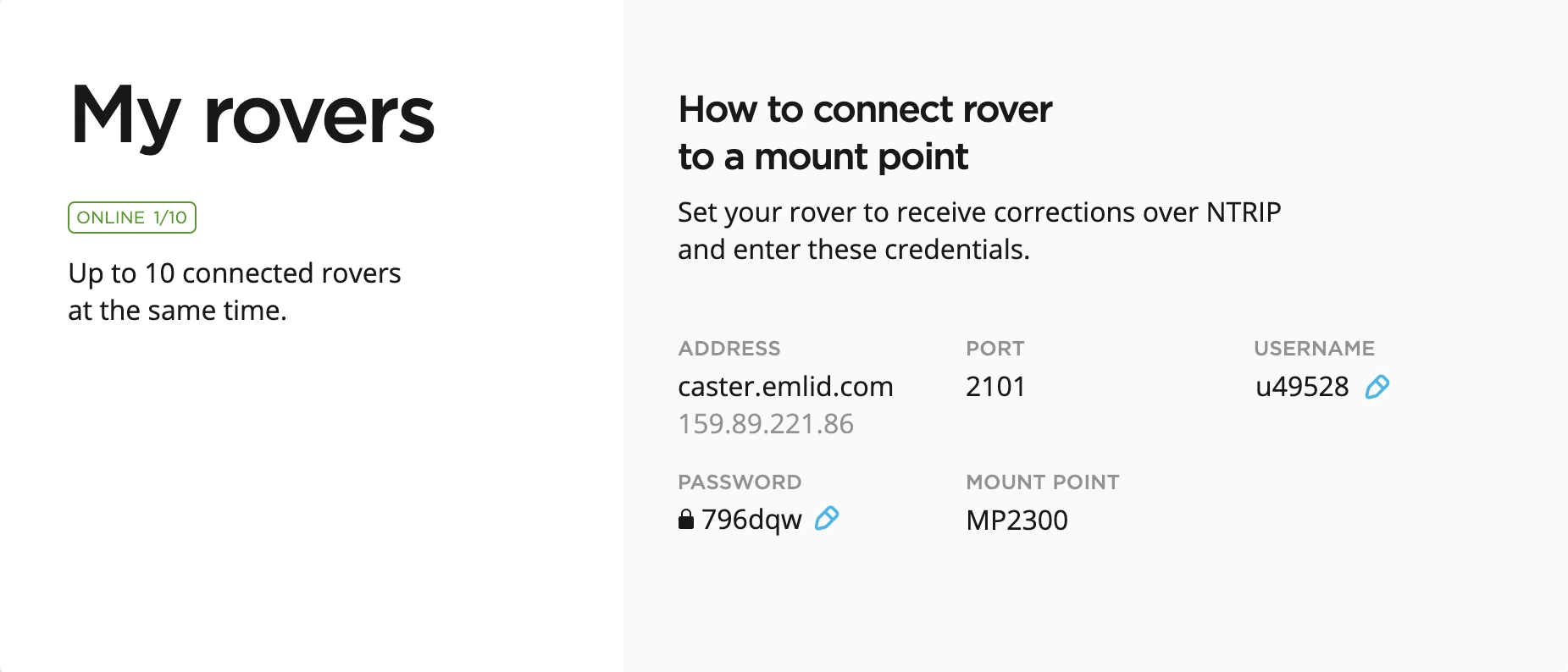

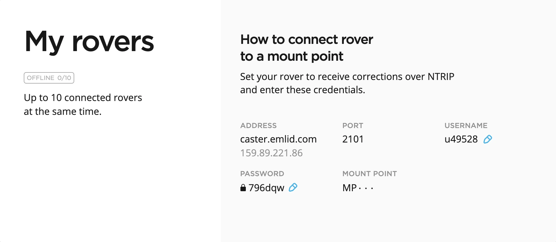

  1. Access the rover's credentials.
Once you activate the mount point for the base, you will see it in the rover's credentials.

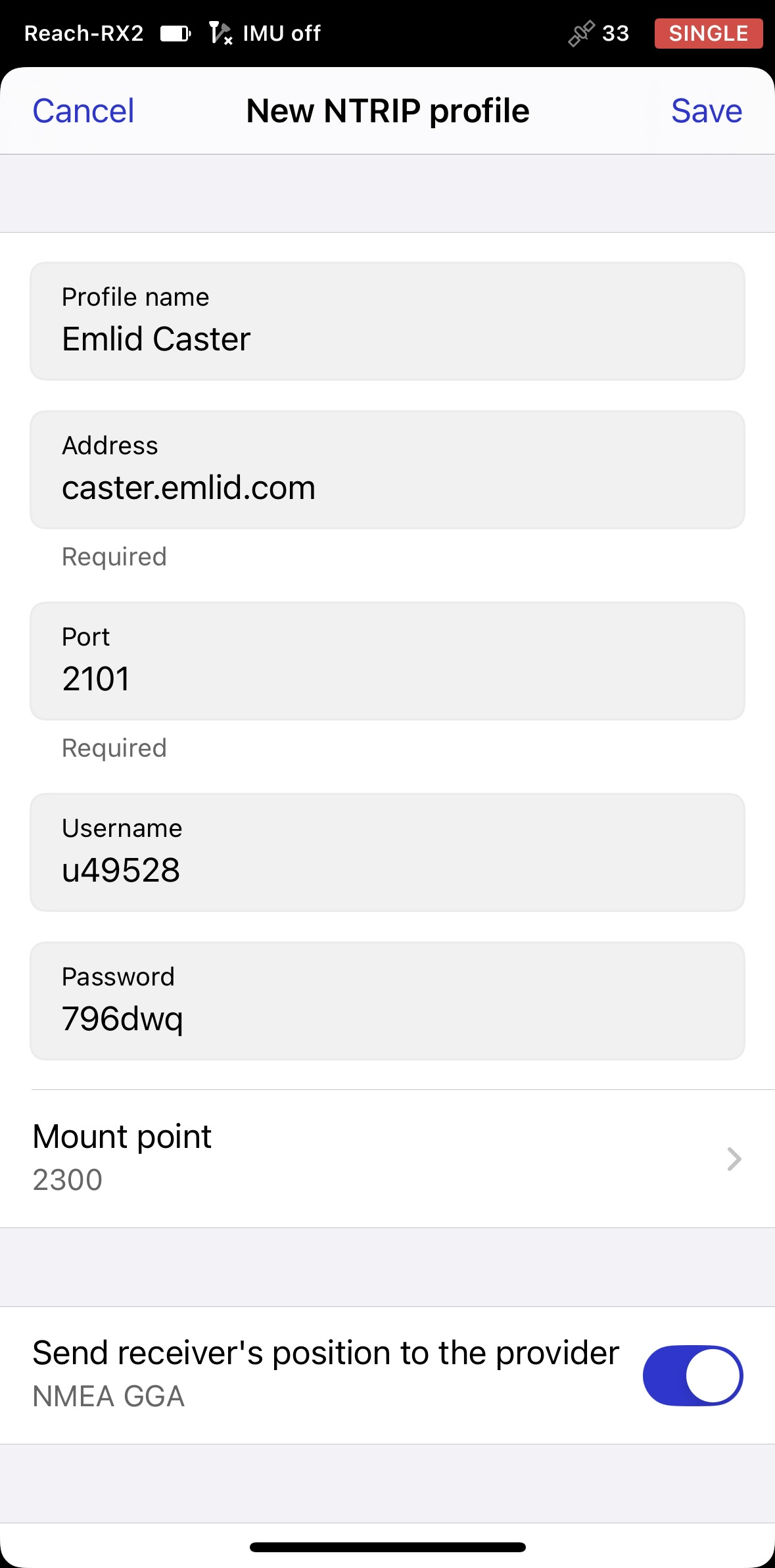

  1. Connect to your rover via Emlid Flow, go to Correction input, and set it up to get corrections over NTRIP using the obtained credentials for the rover:
    • Address
    • Port
    • Username
    • Password
    • Mount point
Make sure you configured your rover to receive corrections from the base via NTRIP.

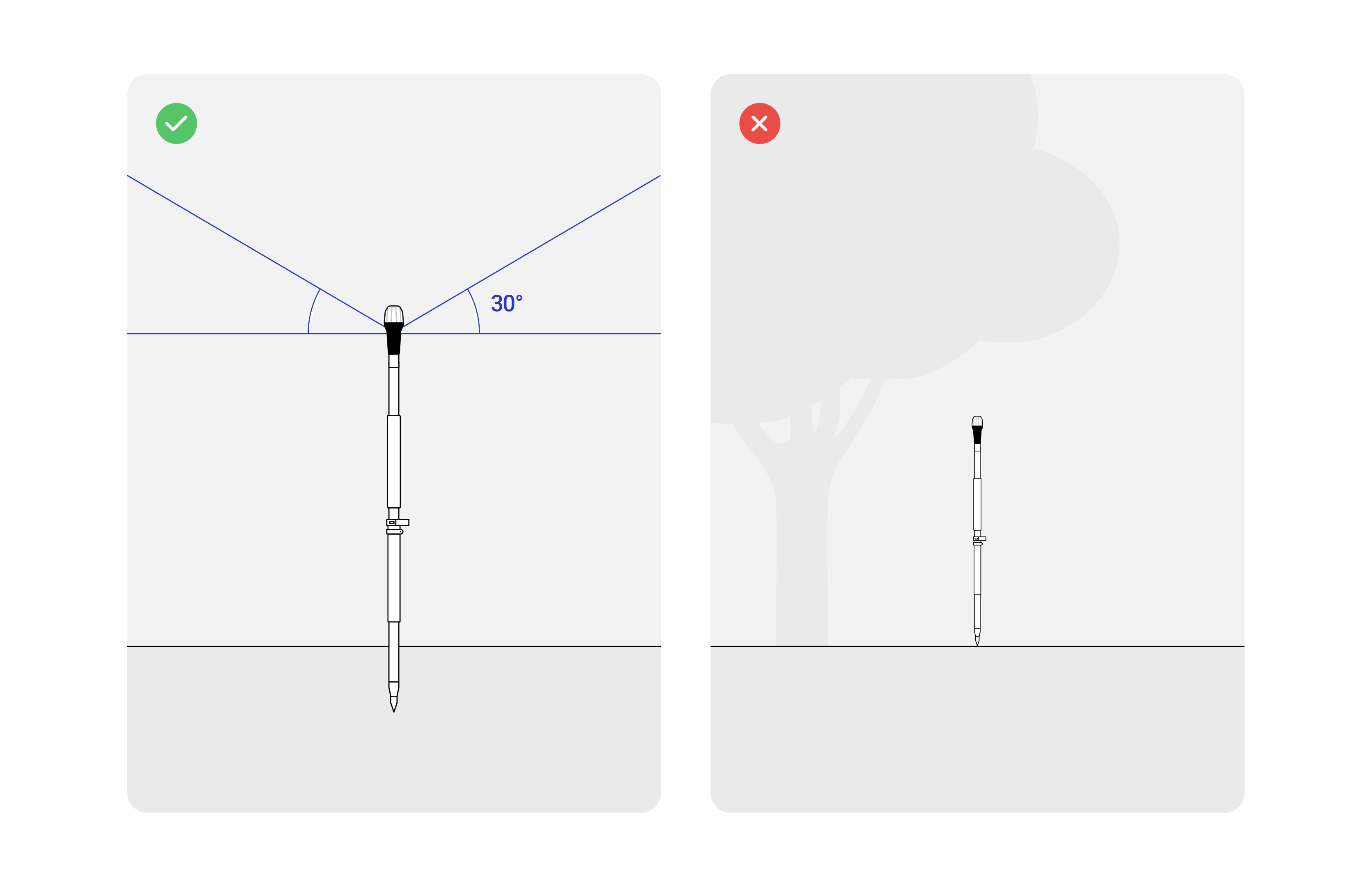

Placing Reach RX2 rover​
Before surveying, make sure your Reach has a clear sky view of at least 30° above the horizon. There should be no obstacles that could block the view like buildings, trees, cars, humans, laptops, etc.
