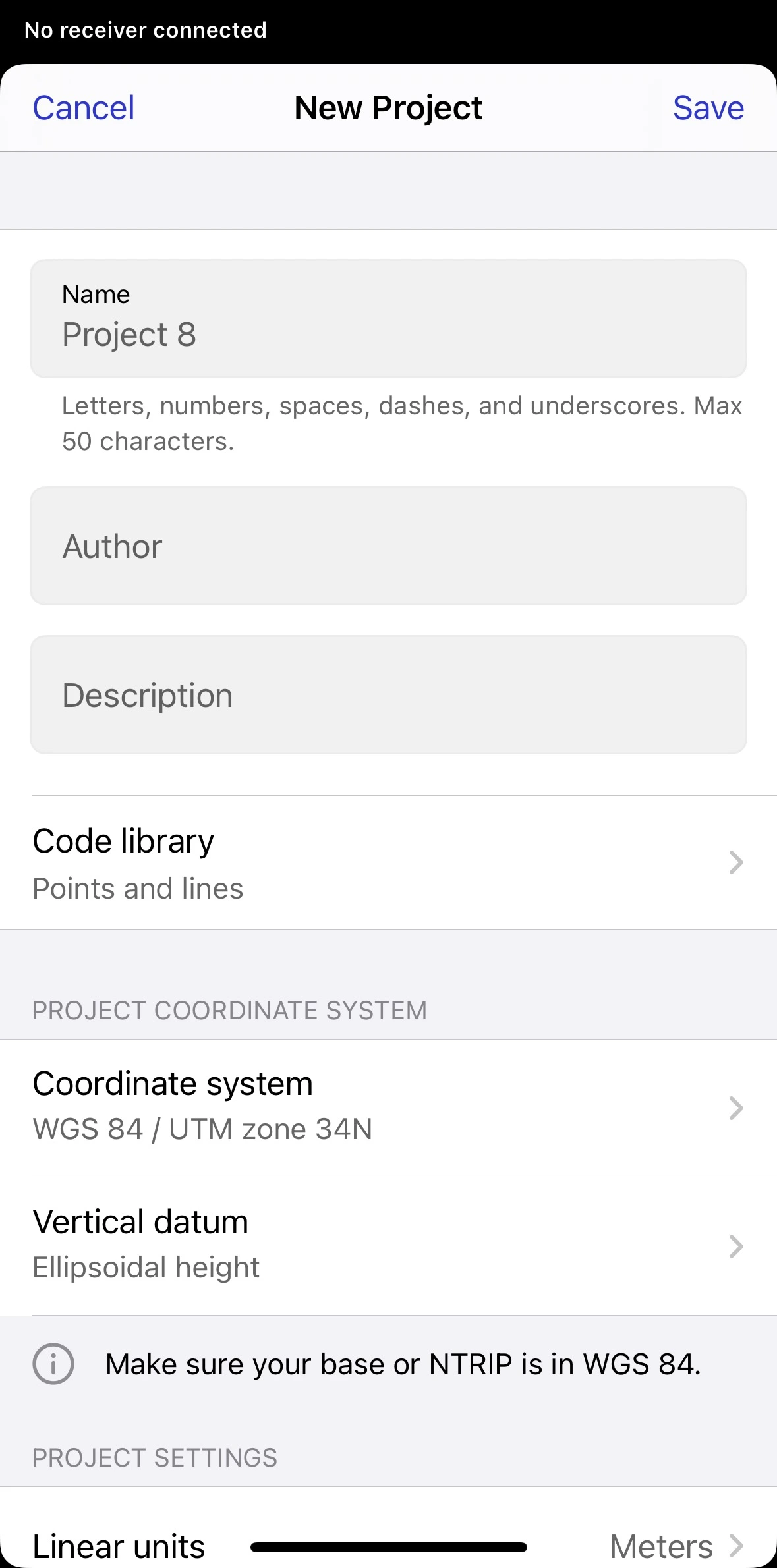

  1. Go to the Survey tab and create a project.
    To learn more, check the How to create a project guide.

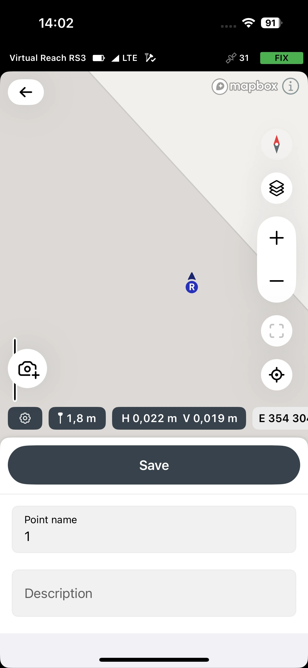

  2. Collect your ground control points.
    To learn more, check the Collect points guide.
