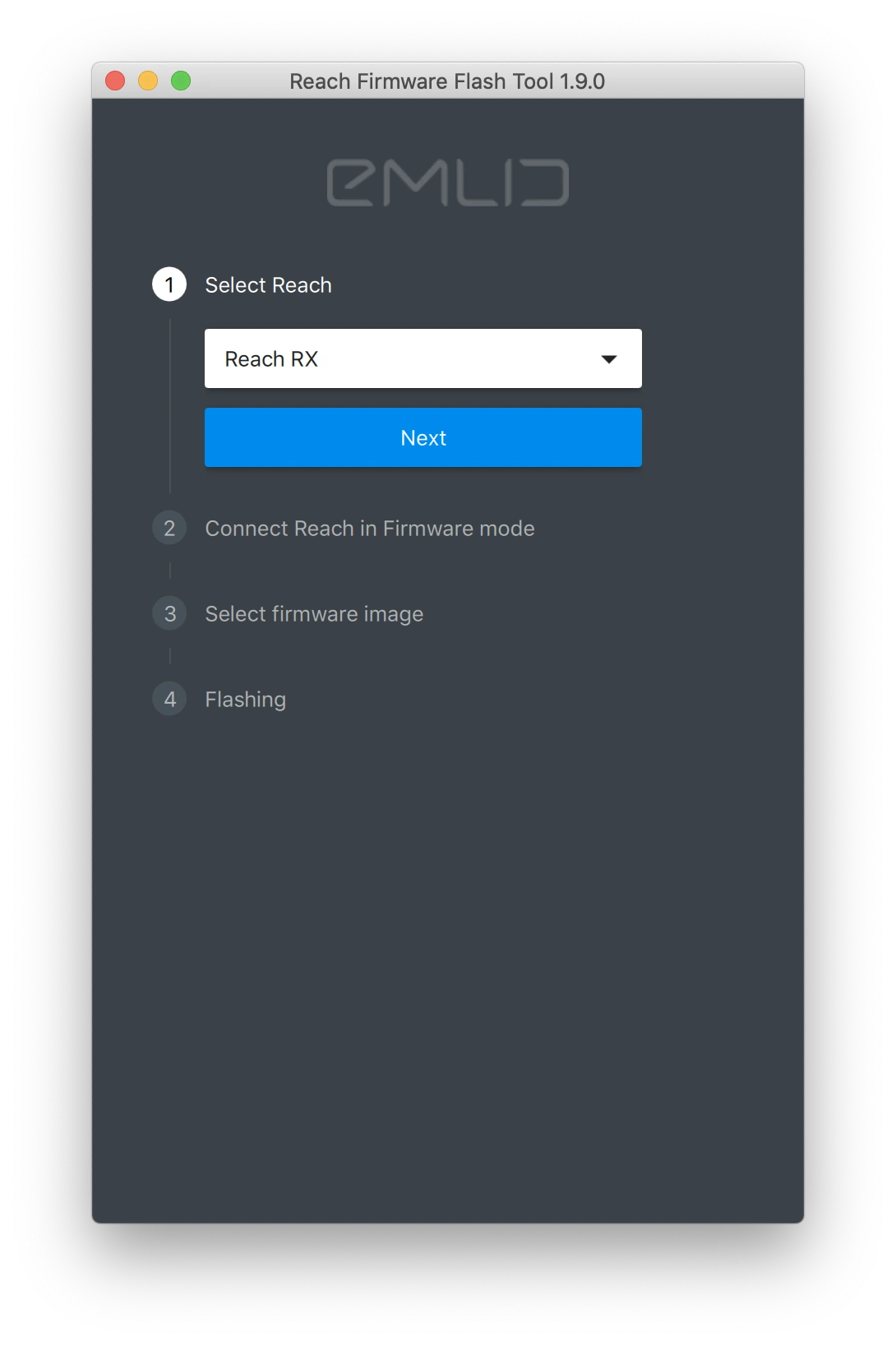

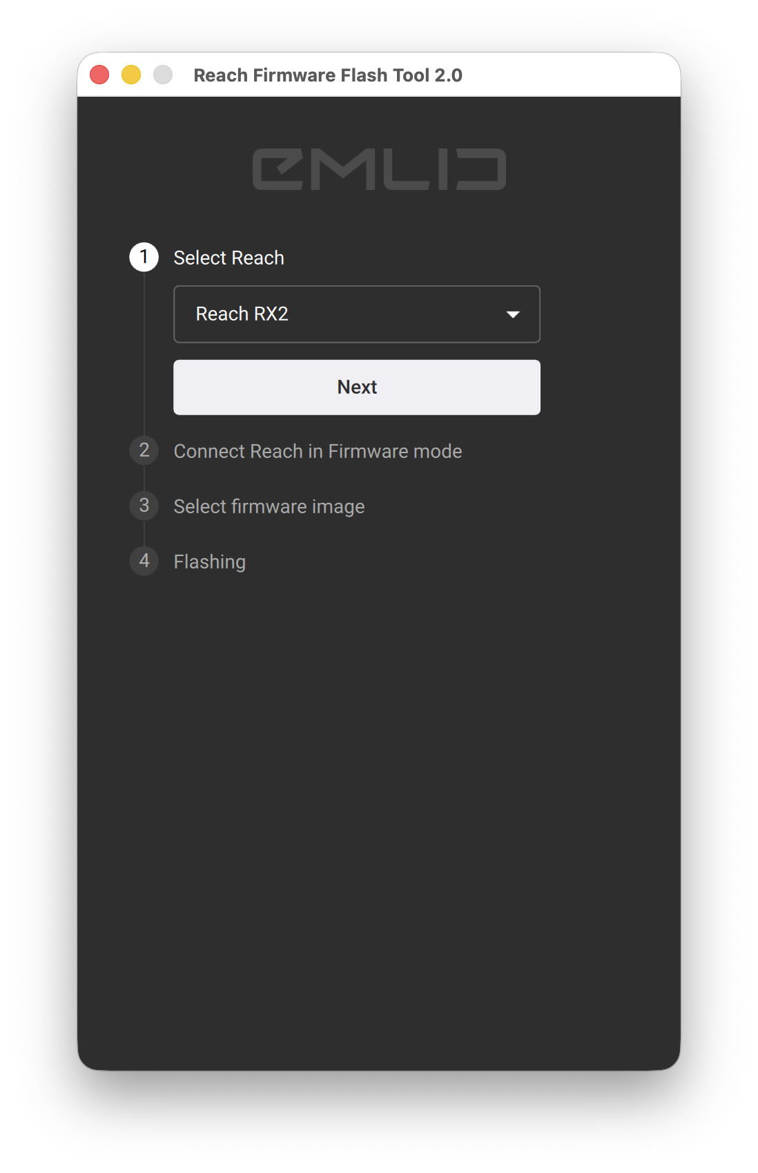

  1. Open Reach Firmware Flash Tool. In the Select Reach dropdown menu, choose Reach RX2. Click Next.
    You can also press the Return/Enter button to proceed to the next step.

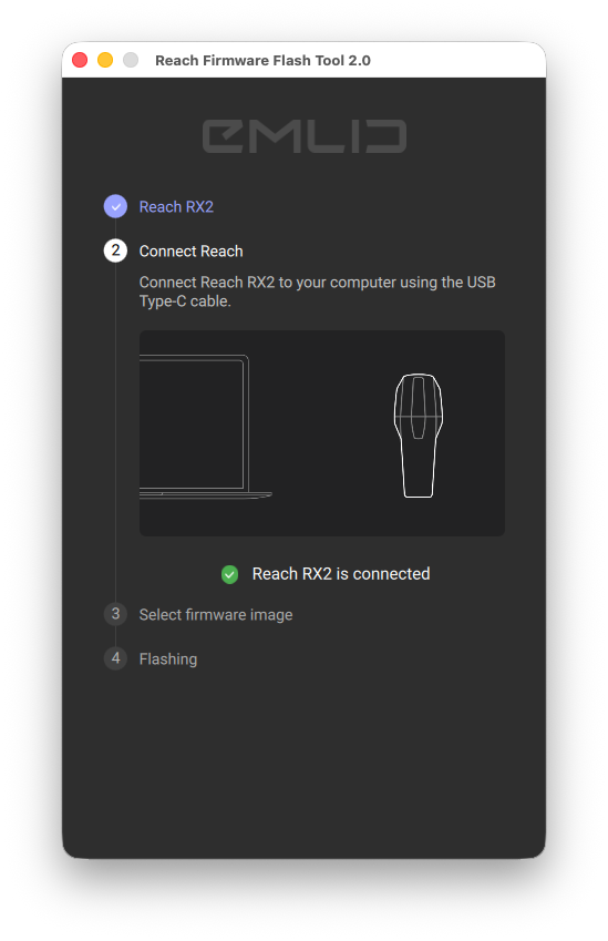

  2. Using the USB Type-C cable supplied with the receiver, connect your Reach RX2 to the PC. You will see the ‘Reach RX2 is connected’ message.
    You can connect your Reach RX2 to the PC in both on and off states.

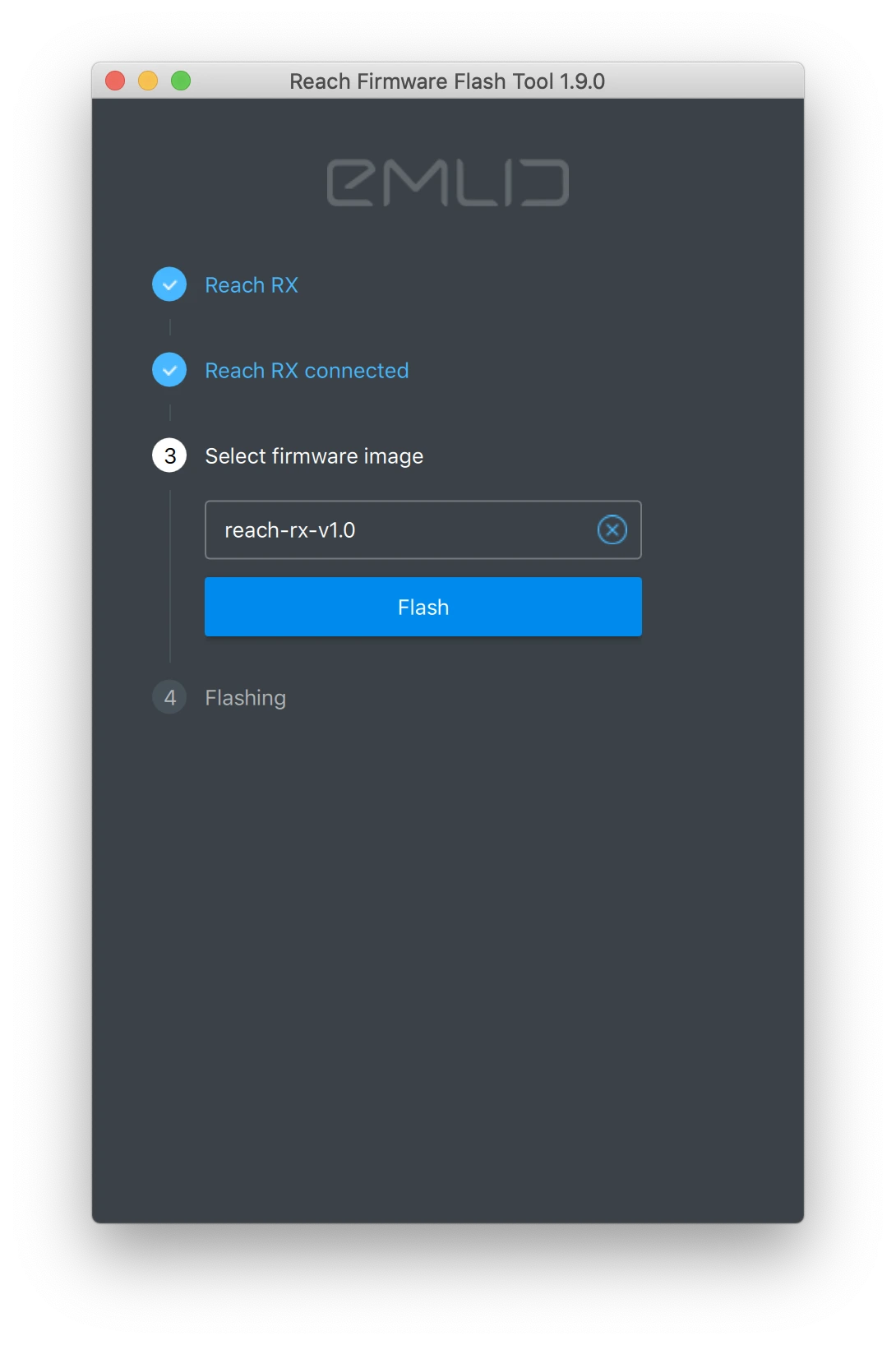

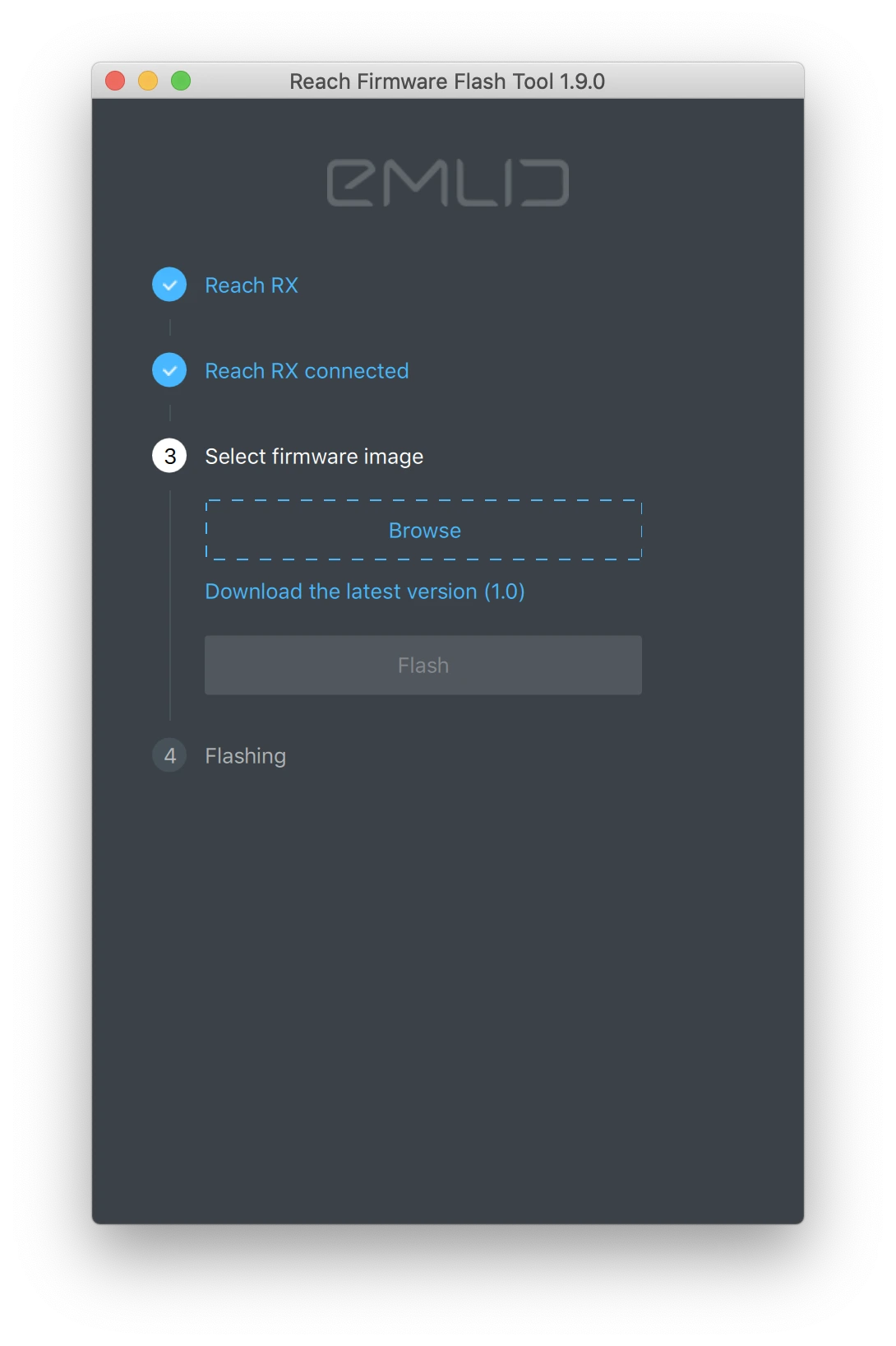

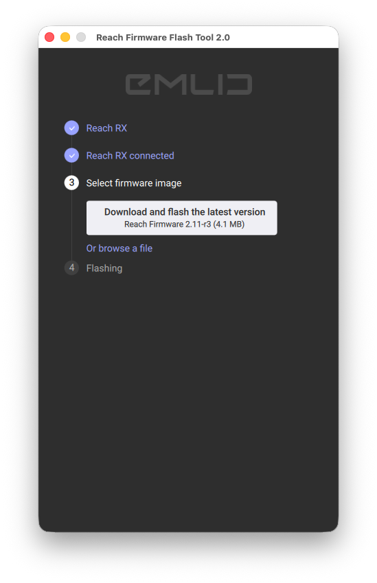

  3. Click Download and flash the latest version. The tool will download the latest firmware image and begin the flashing process.

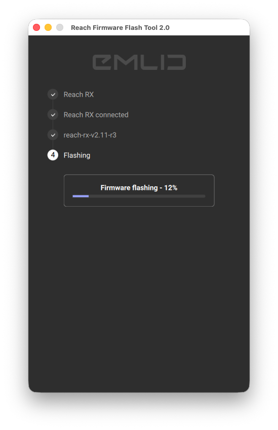

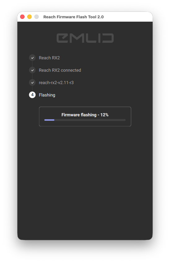

  4. Wait until the end of the flashing process.

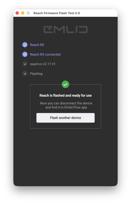

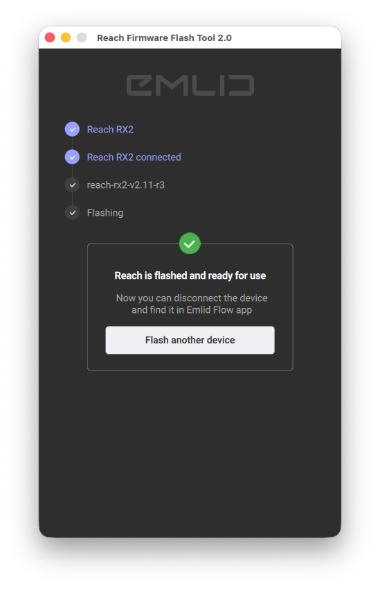

  5. Wait until Reach reboots after flashing. When Reach successfully reboots, you will see the ‘Reach is flashed and ready for use’ message.
    Do not unplug your Reach on this step.
Now your Reach RX2 is flashed and ready for work.
