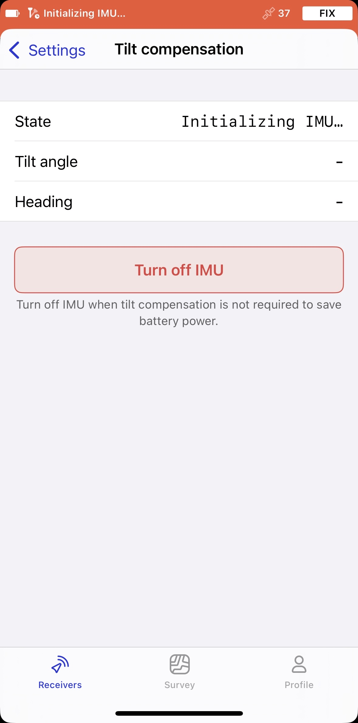

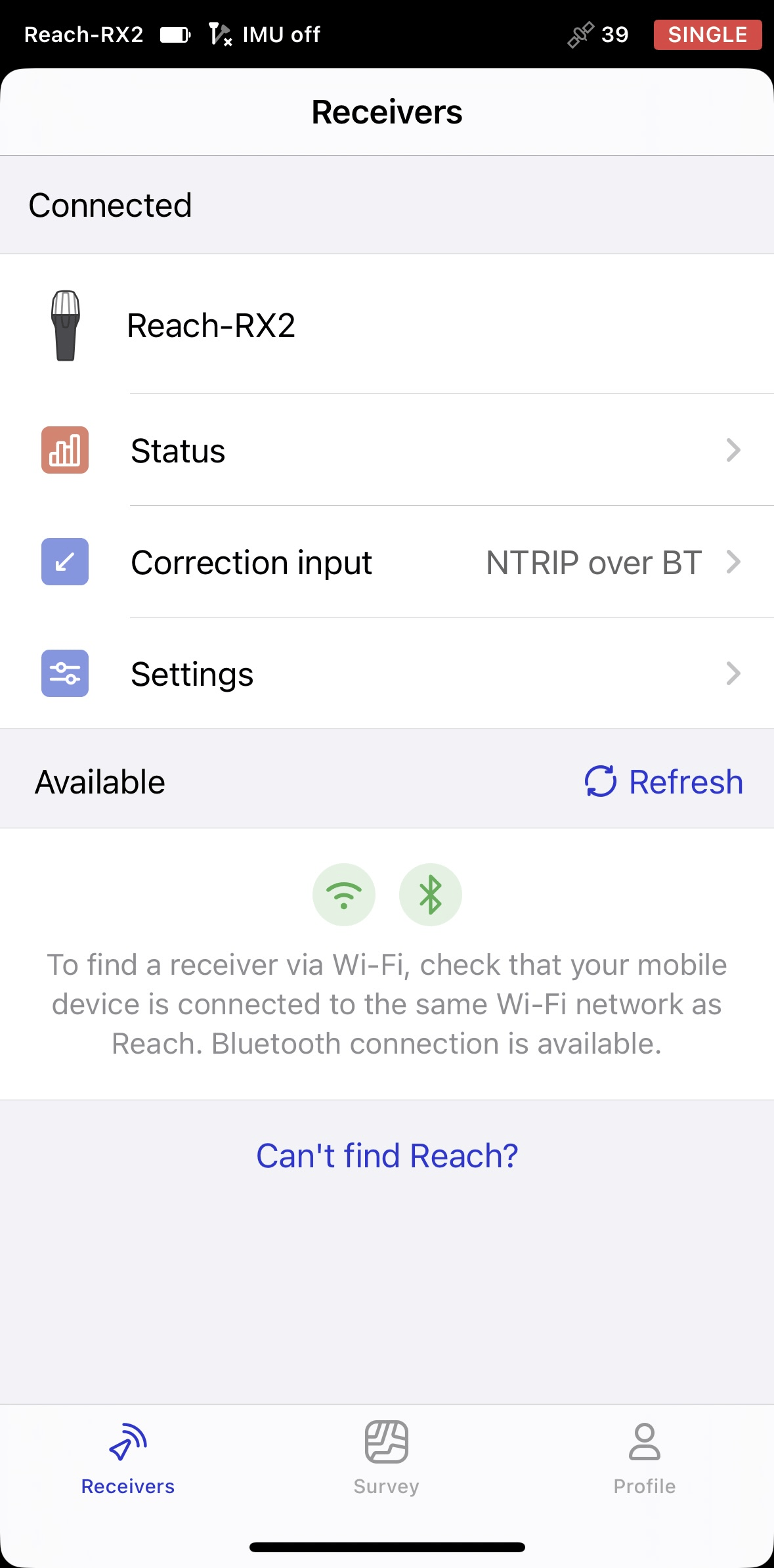

  • If this is the first time you're using Reach RX2 as a rover with tilt compensation, the IMU sensors are already enabled and you'll see the onboarding series, which covers the main steps of working with tilt compensation when you connect to the receiver. If necessary, you can check the tilt compensation onboarding again on the Receiver info screen.
  • If the IMU sensors are not enabled, go to Settings, tap IMU, and turn them on.

  4. Go to Settings and turn on the Tilt compensation.
  5. Watch the tilt compensation status in the Status bar. Once initialization is complete, move the receiver in a figure-eight pattern until you hear a notification sound and see a message indicating that tilt compensation is ready.

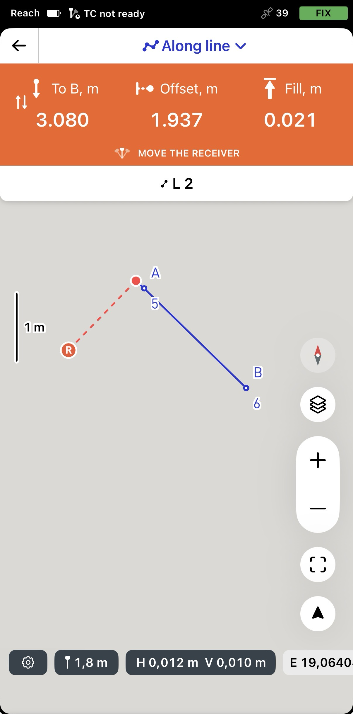

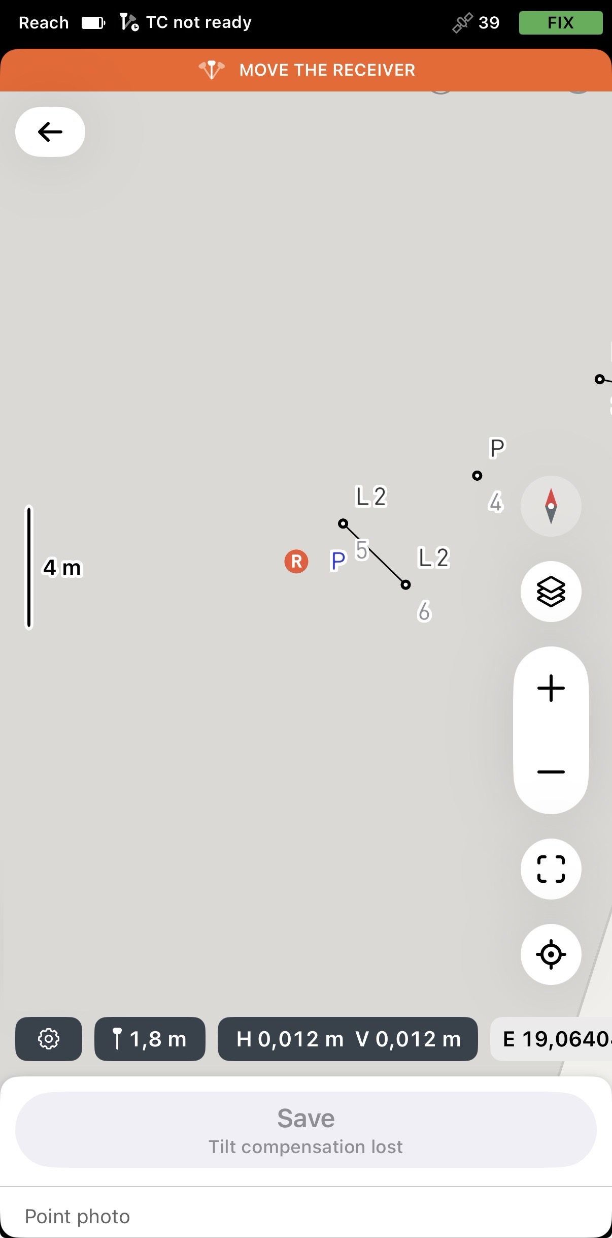

Tilt compensation may be temporarily lost, for example, after a brief loss of RTK FIX or if the receiver remains stationary for some time. If tilt compensation is lost, the app displays orange indicators and shows Move the receiver. Follow the hint and move the receiver in a figure-eight pattern to restore tilt compensation. Until then, data collection and stakeout are unavailable.

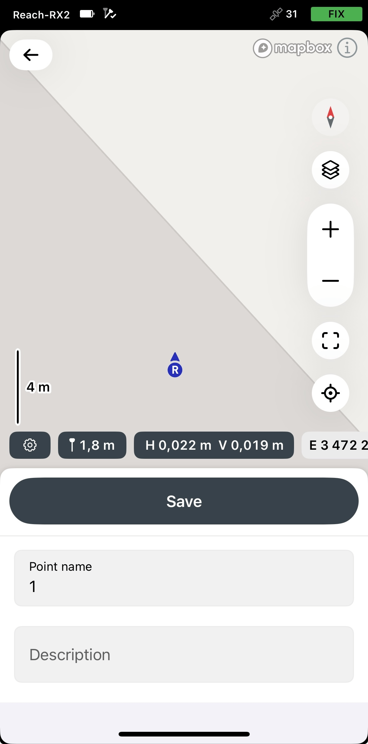

To collect data with tilt compensation, do the following:
  1. Go to the Survey tab and open or create a project.
  2. Tap the Plus button to open the Collector menu.
  3. Collect the point.
    Tap the Status bar, to learn more about tilt compensation. The Status overview has a section with the information about the tilt angle and heading.
Once you collect the point with tilt compensation, it will have the information about the heading and angle of the tilt compensation. You can continue collecting points.
For points collected using averaging, only the maximum tilt compensation angle is specified.

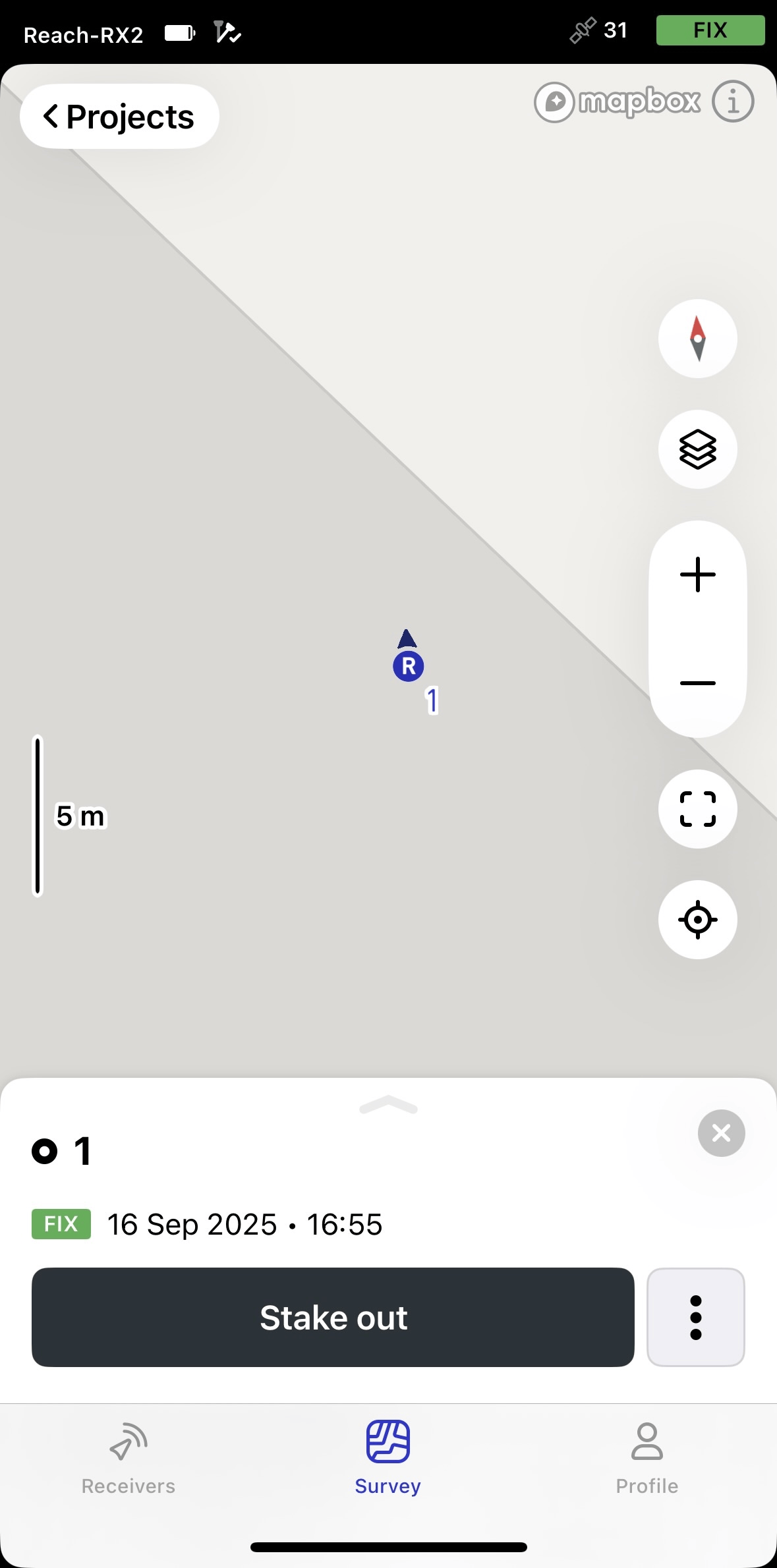

  4. Tap the Stake out button.
  5. Move your Reach in the direction of the point. When you get closer, the map zooms in automatically.
    Turn the LED panel of the receiver towards you while surveying. This way you will see the correct direction and navigate easily on the map. This is applied only when IMU is on.
  6. Move your Reach so that the bull’s-eye turns green, showing that your Reach is less than 2.5 cm (0.08 ft) away from the point you are staking out.
  7. Physically mark the point’s position on the ground.
  8. Switch to another point by tapping the arrow buttons in the Stakeout navigation area.
    To finish staking out the point, close the Stakeout option window.

  • If you don't need tilt compensation at all, you can disable the IMU sensors. To do this, go to Settings, tap IMU and turn them off.
