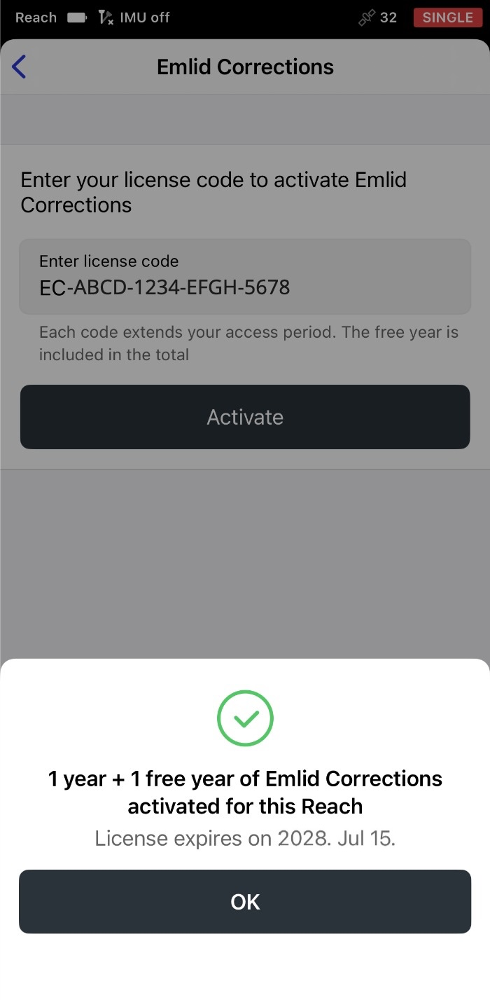

  4. After that, tap I have a license code.

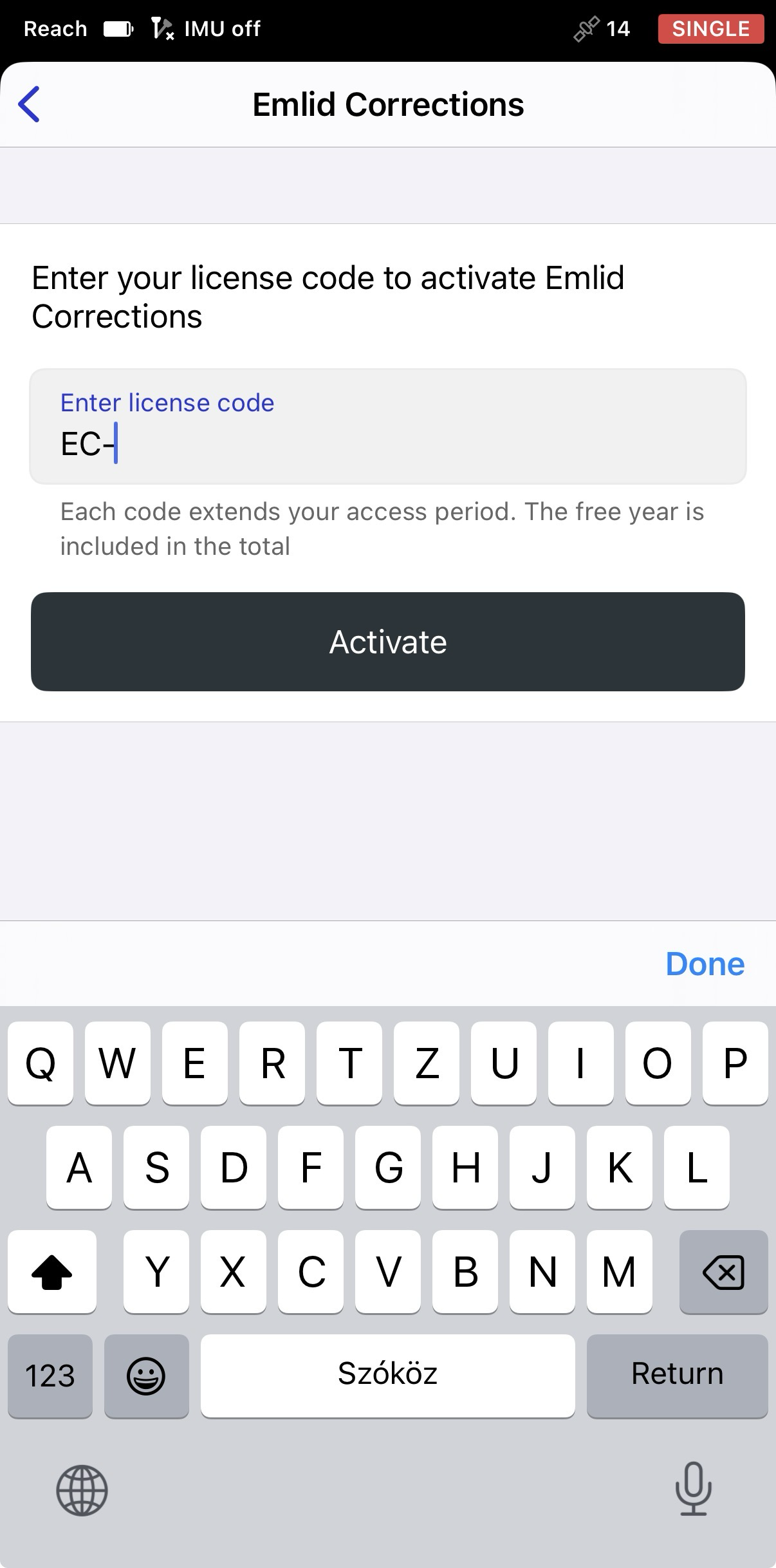

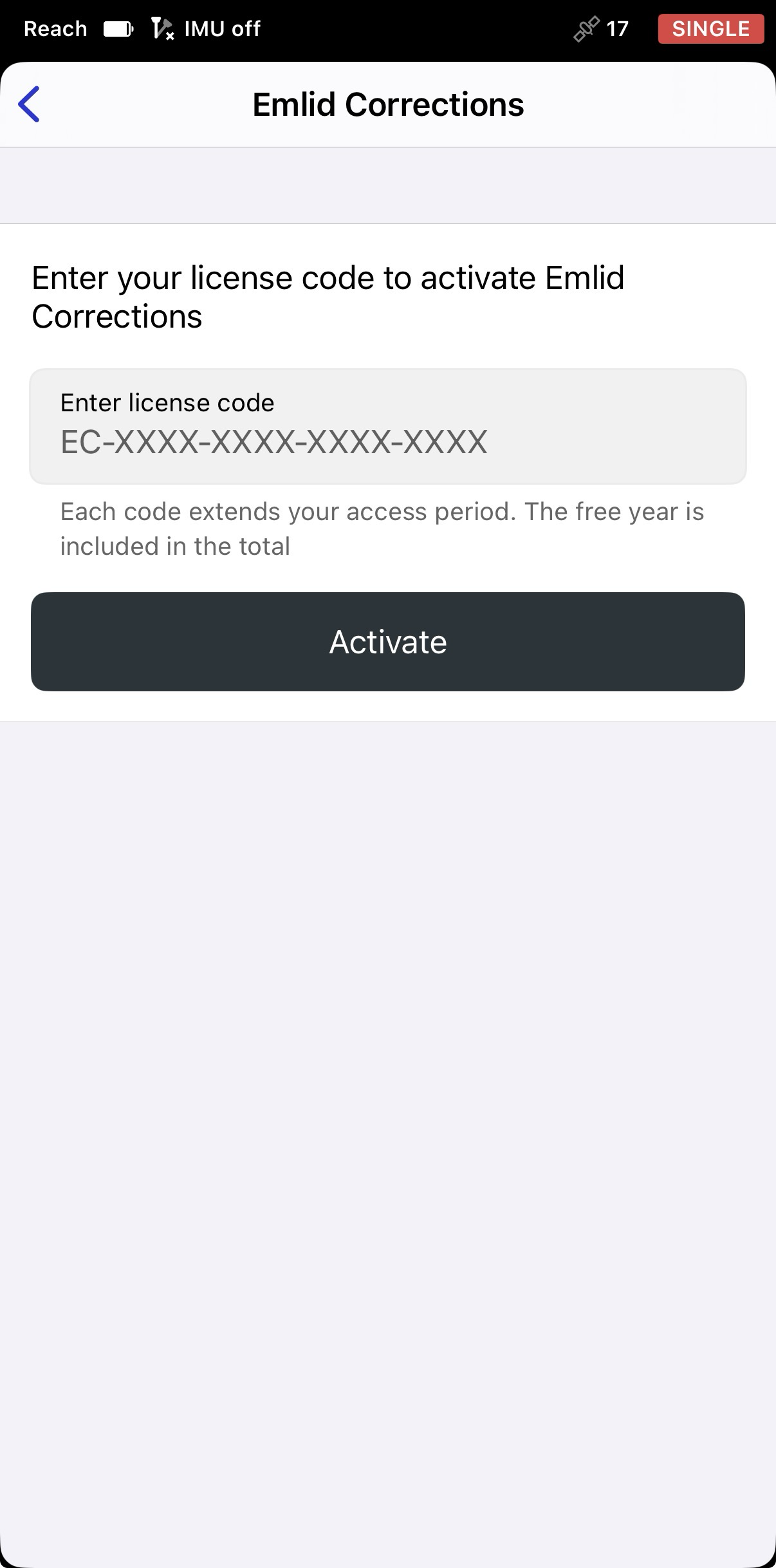

  5. Tap Enter license code.
  6. Enter the license code and then tap Activate.
    Once activation is complete, you'll see the subscription expiration date. The included free one-year subscription is automatically combined with the subscription from your license code.
  7. Tap OK. The Emlid Corrections screen will now show you the information on your license details.

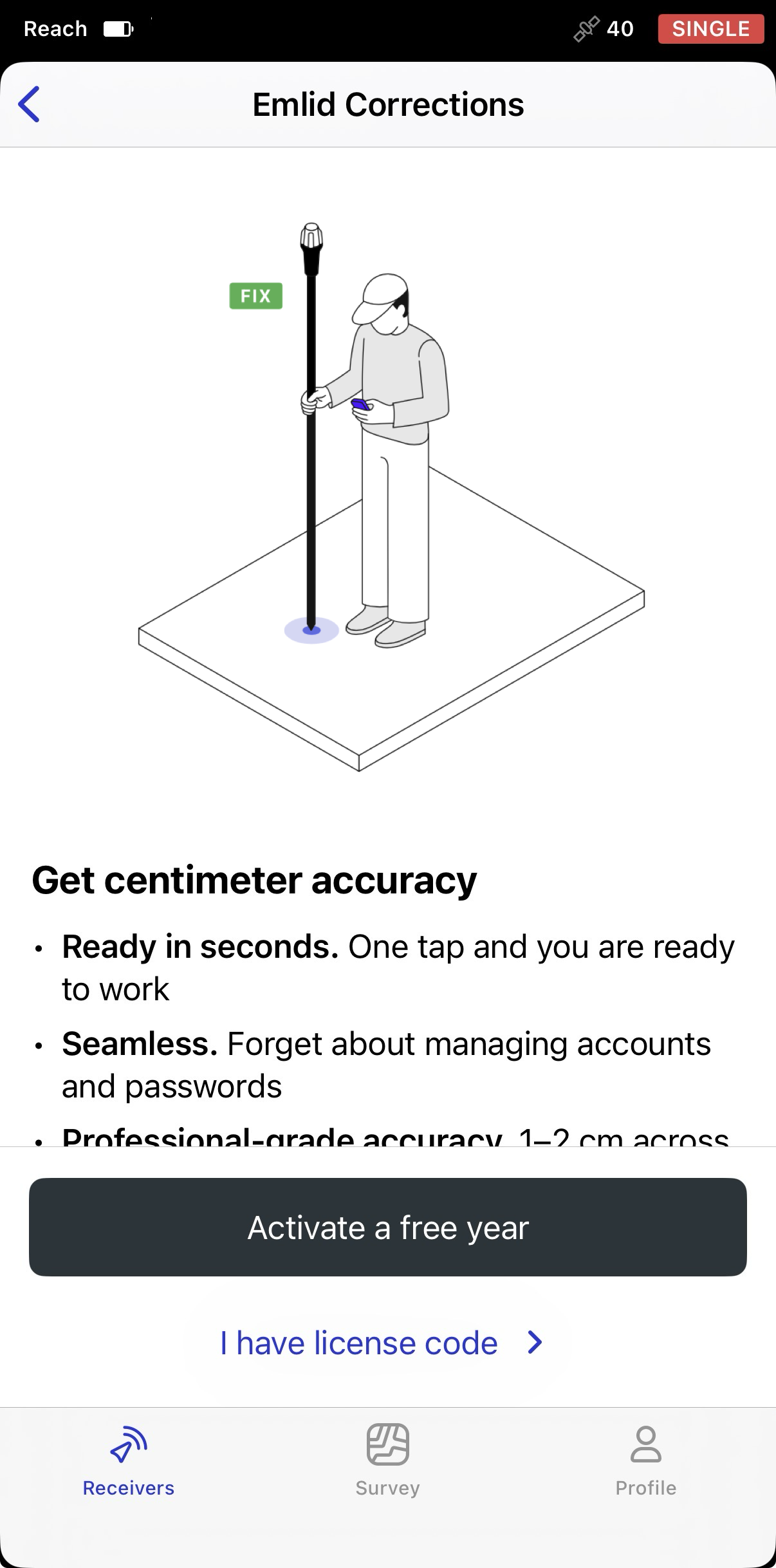

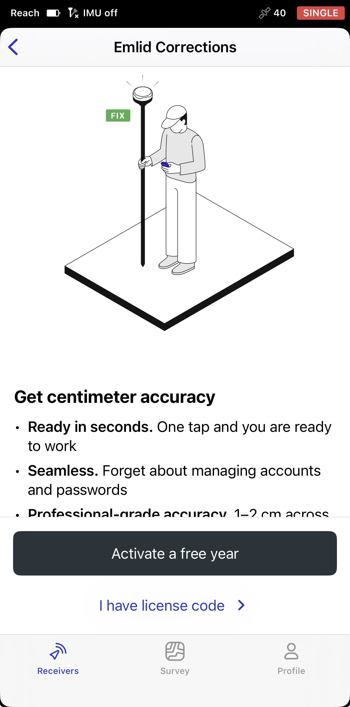

  1. Open Emlid Flow and connect to your Reach receiver.
  2. On the screen that opens after connecting, tap Activate now to start using Emlid Corrections. If you didn’t log in to your Emlid account, do it now.
  3. If you haven’t signed in to your Emlid account, sign in now.

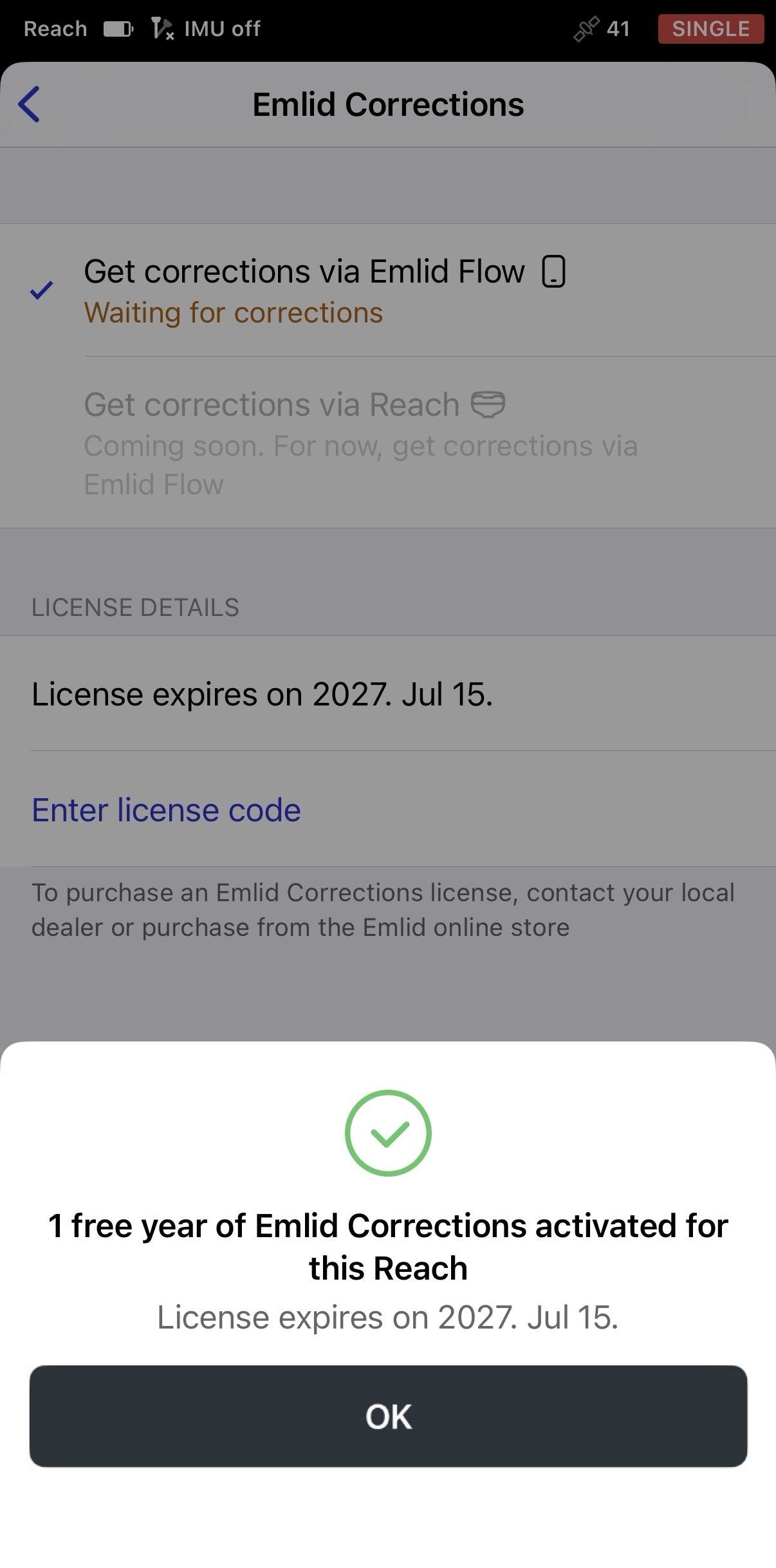

  4. After that, tap Activate a free year to start using Emlid Corrections.
  5. Tap Activate a free year. The free one-year subscription is tied to the receiver on which it is activated and cannot be transferred to another Reach receiver. Once activation is complete, you'll see the subscription expiration date.
  6. Tap OK, and you’ll see the Emlid Corrections screen.

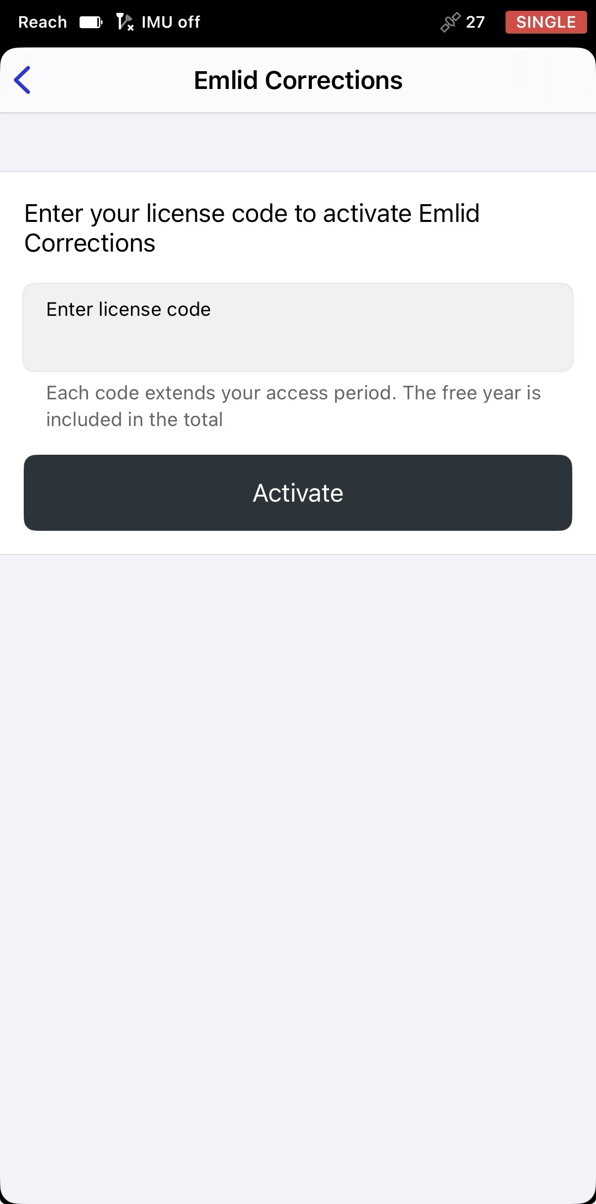

If you purchase an Emlid Corrections license code from the Emlid Store or your local dealer after activating the free period, enter the code in Emlid Flow as follows:
  1. In Settings, tap Correction input, and then Emlid corrections.
  2. Near the Emlid corrections cell, tap the pencil icon.
  3. On the opened screen, tap Enter license code section.
  4. Enter the obtained code. The purchased subscription will be added to the remaining free period, and the updated expiration date is displayed.
The license code is now applied, and the purchased license period is added to your existing Emlid Corrections period.

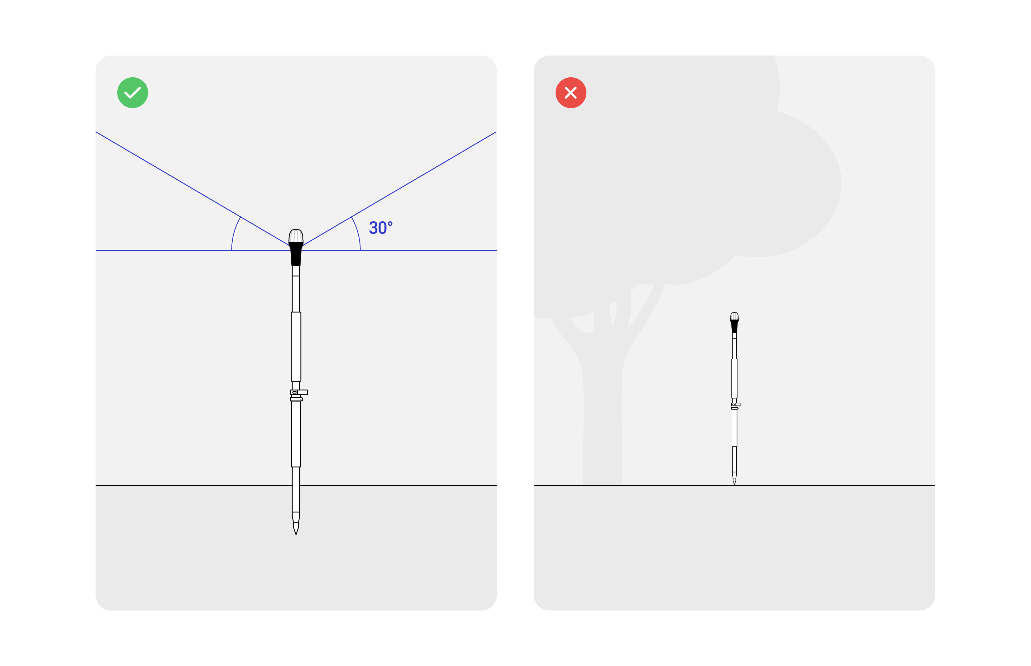

Provide Reach RX2 with clear sky view​
Before surveying, make sure your Reach has a clear sky view of at least 30° above the horizon. There should be no obstacles that could block the view like buildings, trees, cars, humans, laptops, etc.
Learn more about Reach RX2 placement in the Placement guide.
Once the receiver has a clear sky view and satellite visibility, corrections will start within a few seconds.
