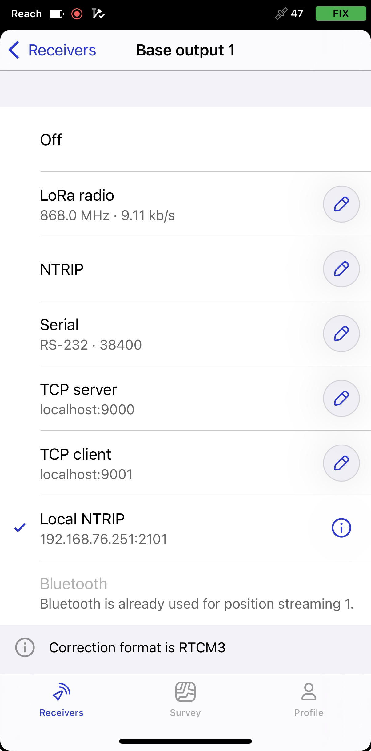

  3. Tap Base output and select the Local NTRIP option.

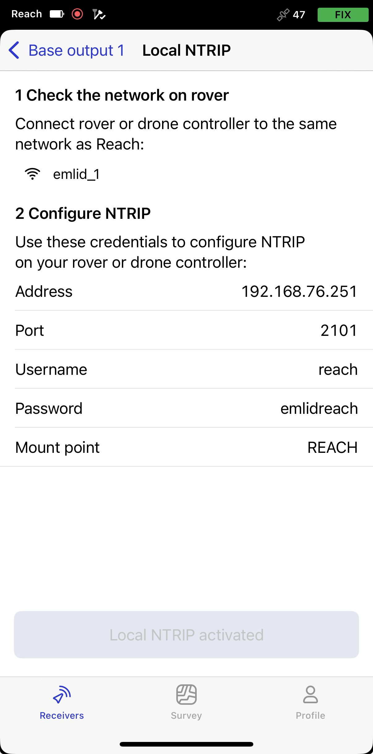

  4. Tap the Information button to access the page with rover credentials.
  5. Connect your controller to the same Wi-Fi network as your Reach.

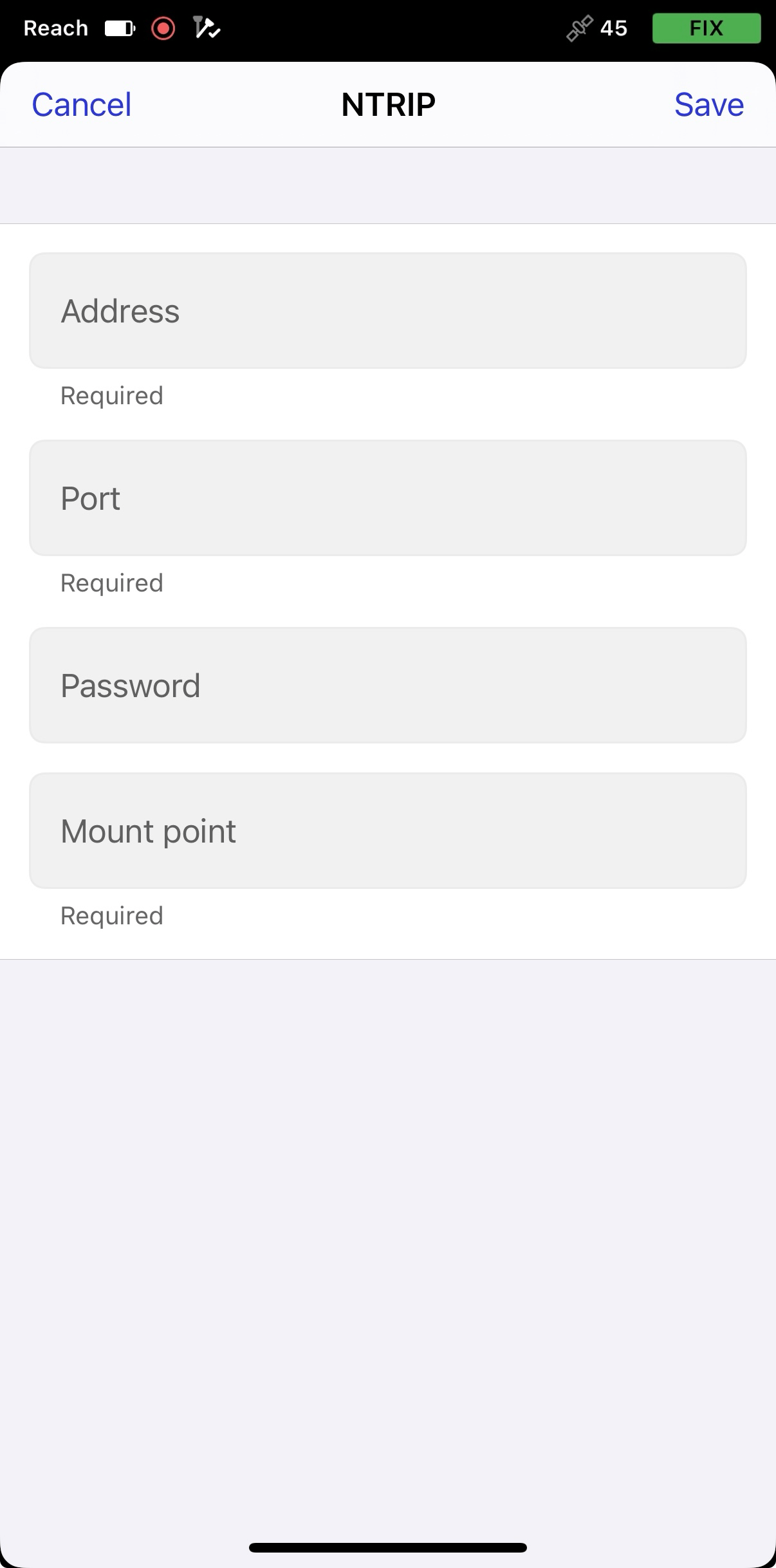

  5. On the Receivers screen, tap Base output and select the NTRIP option.
  6. Tap the Edit button and insert the NTRIP credentials for the base:
    • Address: The URL or IP address of the NTRIP caster.
    • Port: The port used to connect to the caster. The default value is usually 2101 unless your provider specifies a different port.
    • Username: The username used to authenticate with the NTRIP service. In some cases, it may be your name or email address.
    • Password: The password associated with the username.
    • Mount Point: The name of the correction stream provided by the NTRIP service.
      To find out which mount point suits you better, check the website of your NTRIP provider. In general, shorter distances to the reference station improve RTK performance.
    To ensure successful corrections transmitting, double-check the credentials you entered.

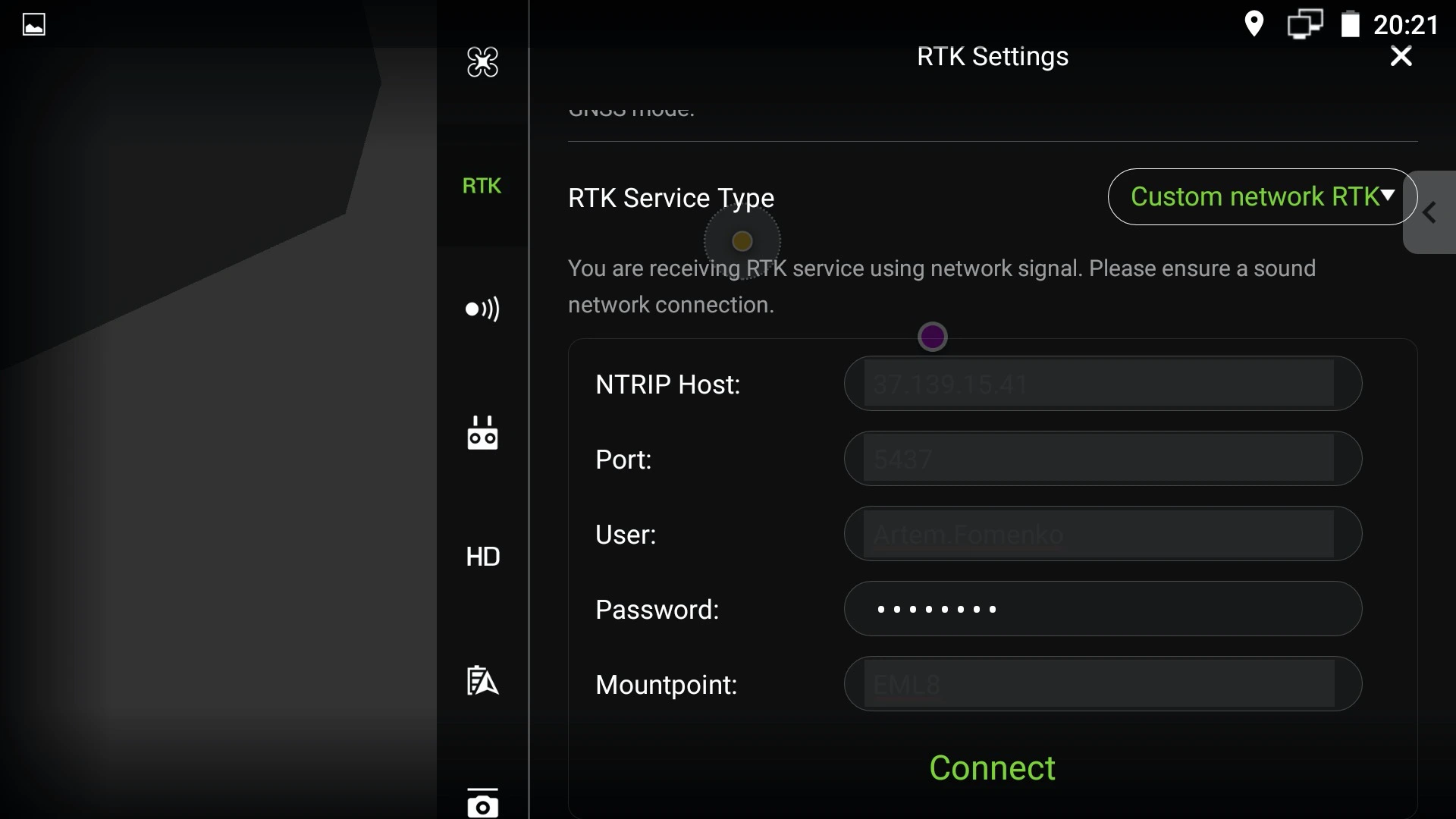

  5. Go to the RTK Settings tab.

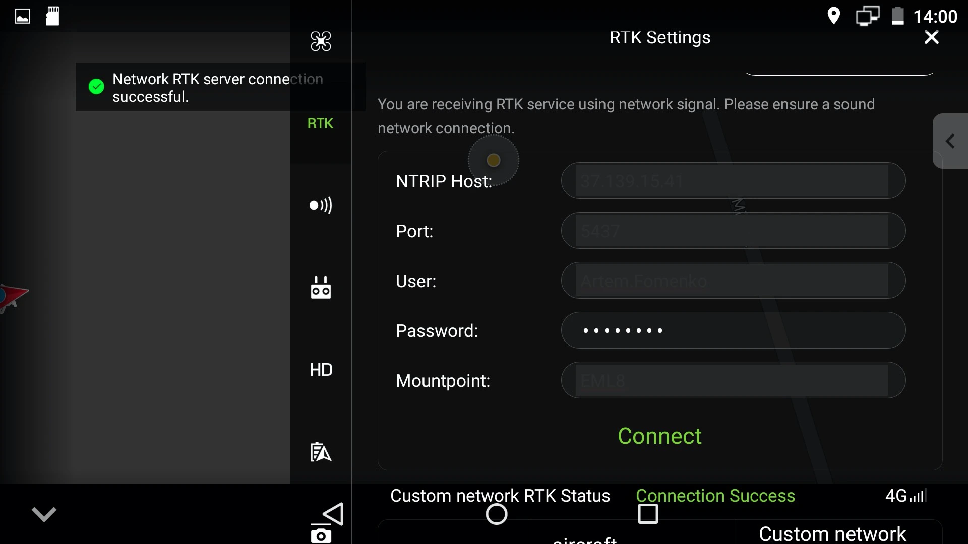

  6. In RTK Service Type, choose Custom network RTK and fill in the NTRIP credentials form:
    • NTRIP Host: The URL or IP address of the NTRIP caster.
    • Account: The username used to authenticate with the NTRIP service. In some cases, it may be your name or email address.
    Fill in the credentials you obtained when accessing Emlid Caster or enabling the Local NTRIP option in Emlid Flow. Make sure that you use the credentials for the rover.
  7. Tap the Connect button. The "Network RTK server connection successful" message will appear. That means that the base is successfully connected.

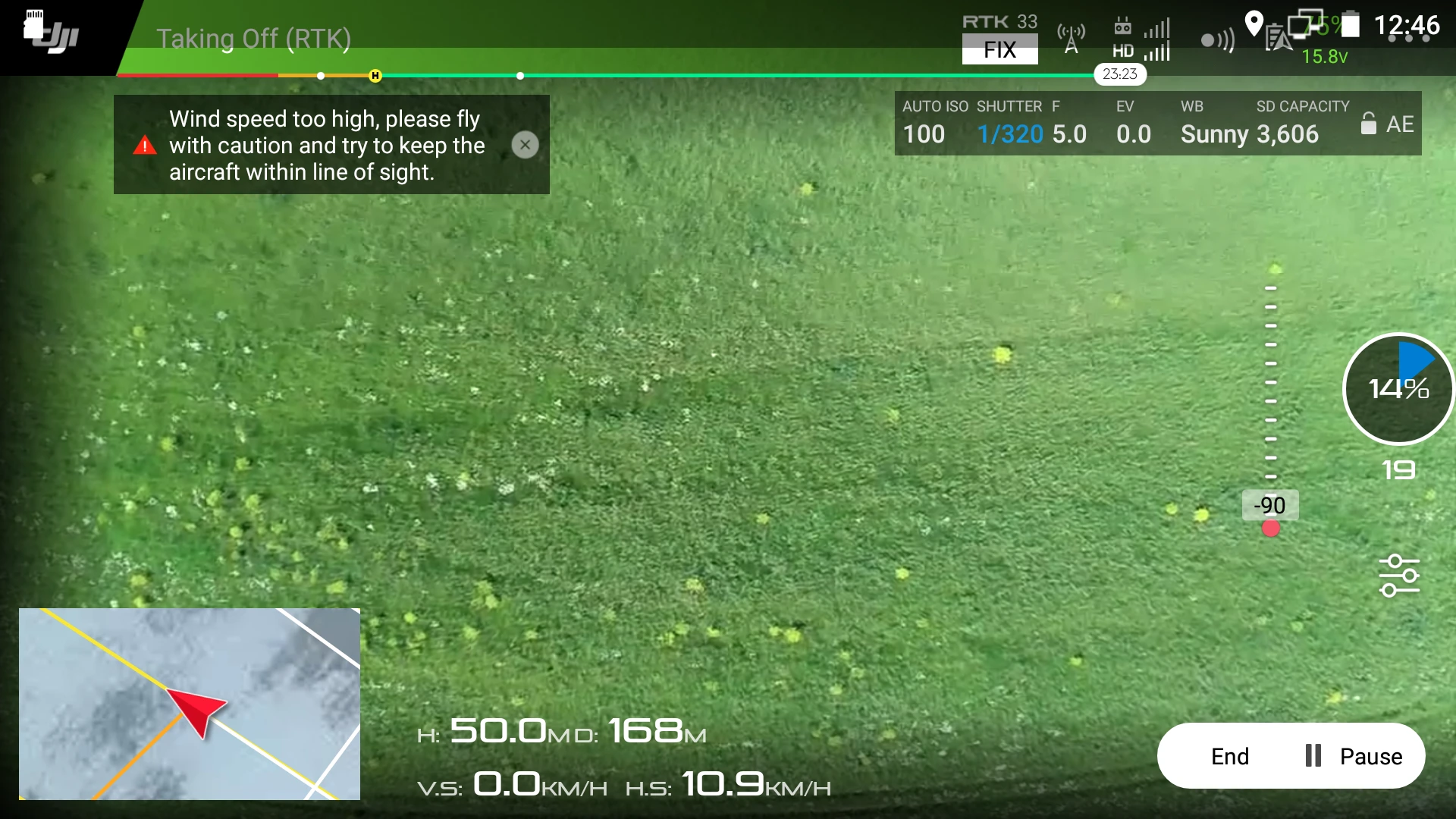

When the RTK connection is successfully established, all status indicators turn green, including the RTK icon.
Perform Flight​
When you set up communication between your Reach RS4 / RS4 Pro and a drone, you can perform the flight. Provide your DJI RTK drone with a clear sky view and proceed to the mission.
Once the flight is completed, you can download the geotagged images and use them for further mapping in photogrammetry software.
