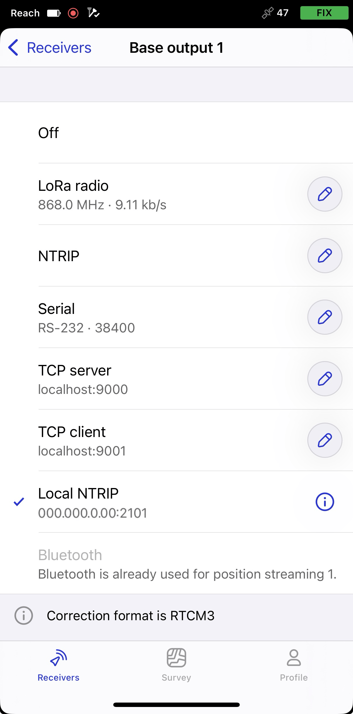

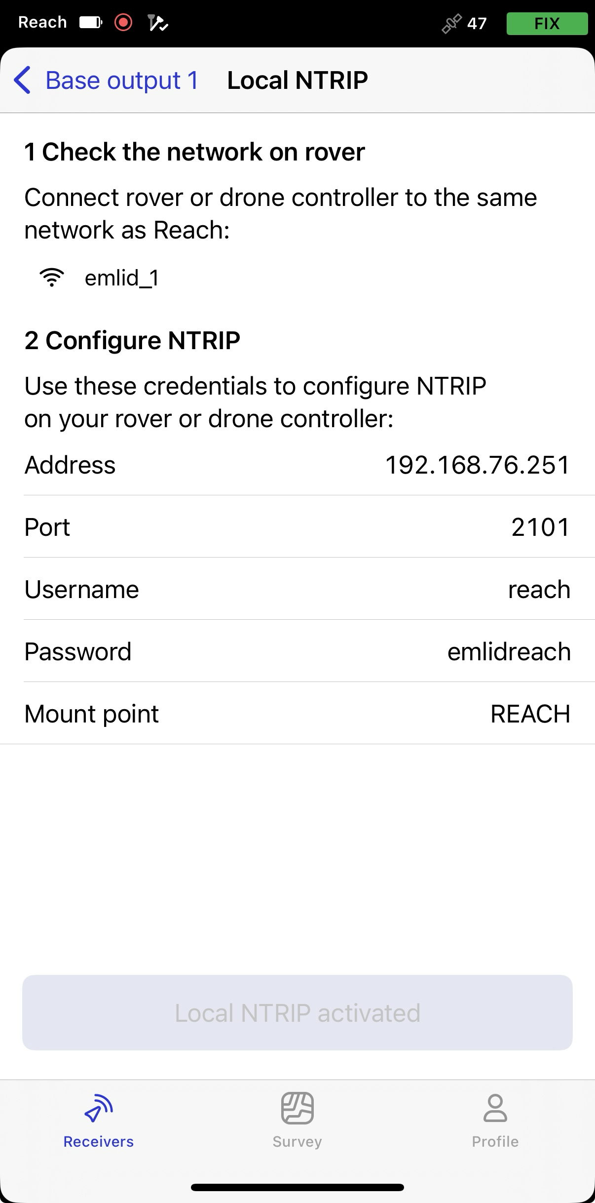

  3. Tap Base output and select the Local NTRIP option.
  4. Tap the Information button to access the page with rover credentials.
  5. Connect Autel Smart Controller to the same Wi-Fi network as your Reach.
To ensure a proper connection, keep the distance between the drone’s controller and your base within several meters.

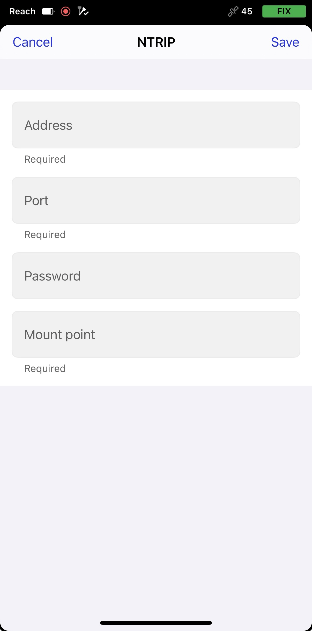

  5. On the Receivers screen, tap Base output and select the NTRIP option.
  6. Tap the Edit button and insert the NTRIP credentials for the base:
    • Address: The URL or IP address of the NTRIP caster.
    • Port: The port used to connect to the caster. The default value is usually 2101 unless your provider specifies a different port.
    • Username: The username used to authenticate with the NTRIP service. In some cases, it may be your name or email address.
    • Password: The password associated with the username.
    • Mount Point: The name of the correction stream provided by the NTRIP service.
      To find out which mount point suits you better, check the website of your NTRIP provider. In general, shorter distances to the reference station improve RTK performance.
    To ensure successful corrections transmitting, double-check the credentials you entered.

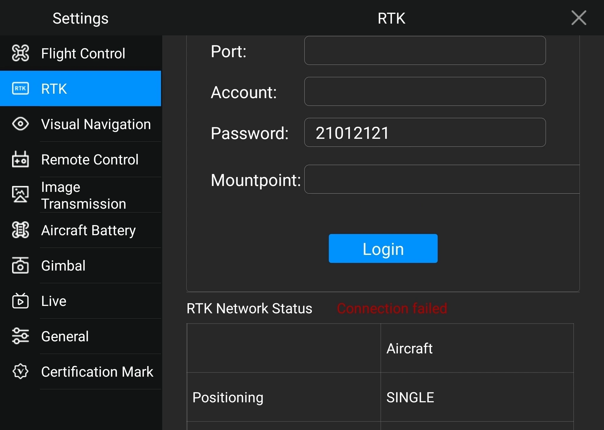

  3. Open the Autel Explorer app. Tap the Camera button.
  4. To open the Settings screen, tap the gear icon in the top right corner.

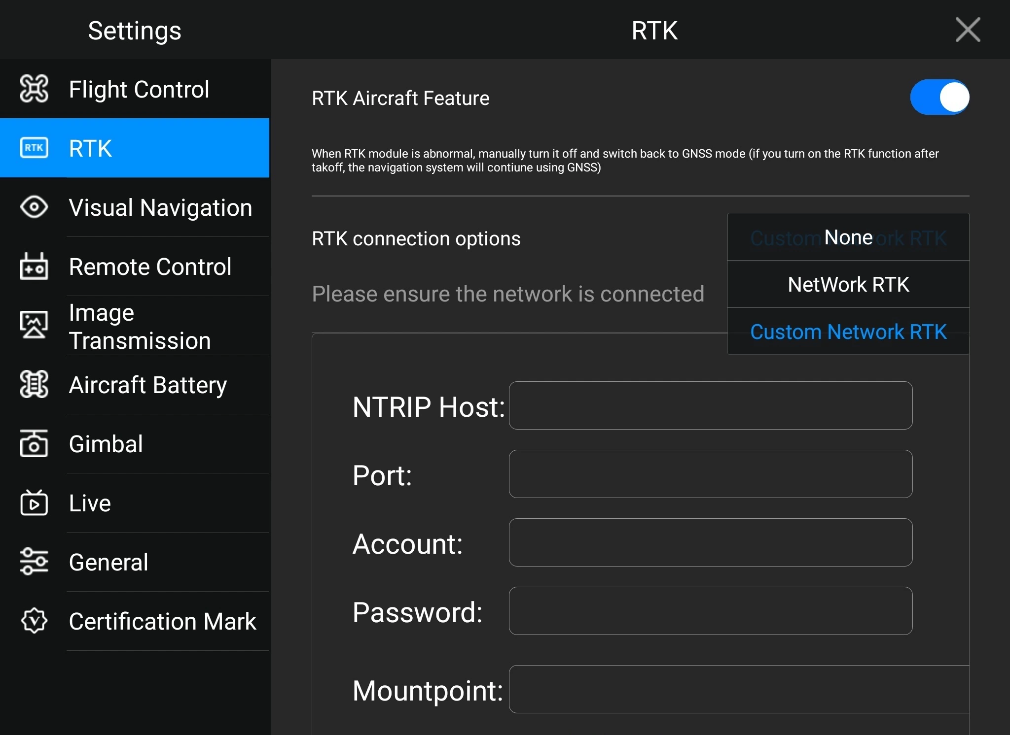

  5. Go to the RTK screen.
  6. Turn on the RTK Aircraft Feature option. In RTK connection options, choose the Custom Network RTK option and fill in the NTRIP credentials:
    • NTRIP Host: The URL or IP address of the NTRIP caster.
    • Account: The username used to authenticate with the NTRIP service. In some cases, it may be your name or email address.
    Fill in the credentials you obtained when accessing Emlid Caster or enabling the Local NTRIP option in Emlid Flow. Make sure that you use the credentials for the rover.

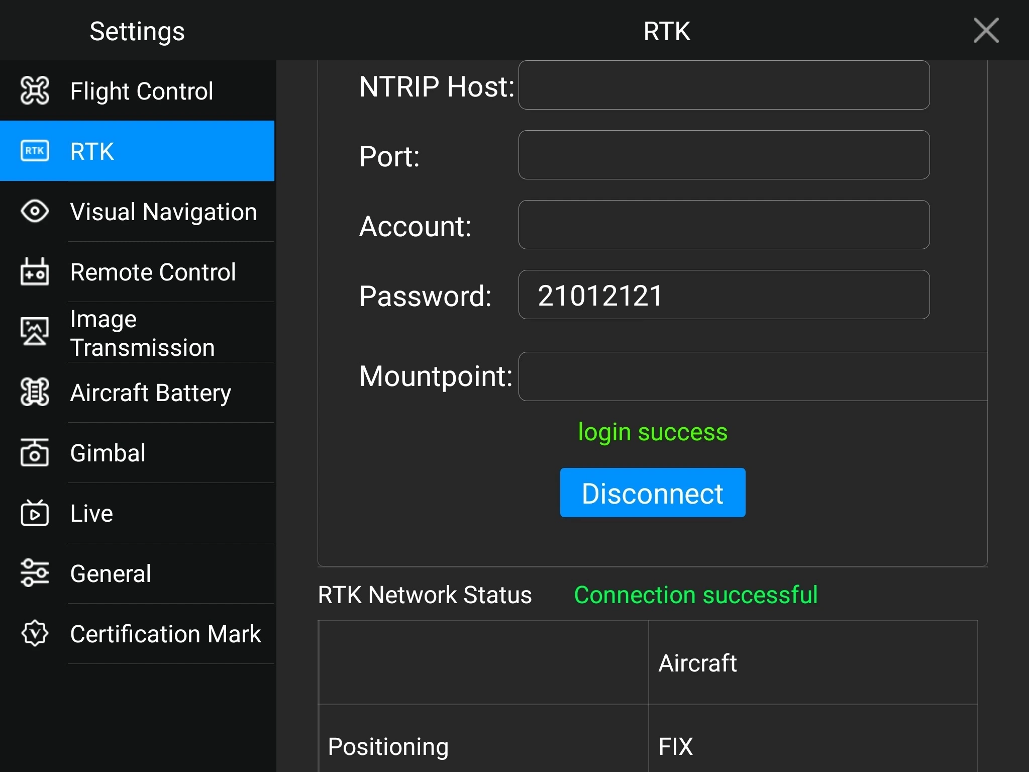

  7. Tap Login.
  8. The login success message will appear if the base is successfully connected. RTK Network Status should change to the Connection successful state.

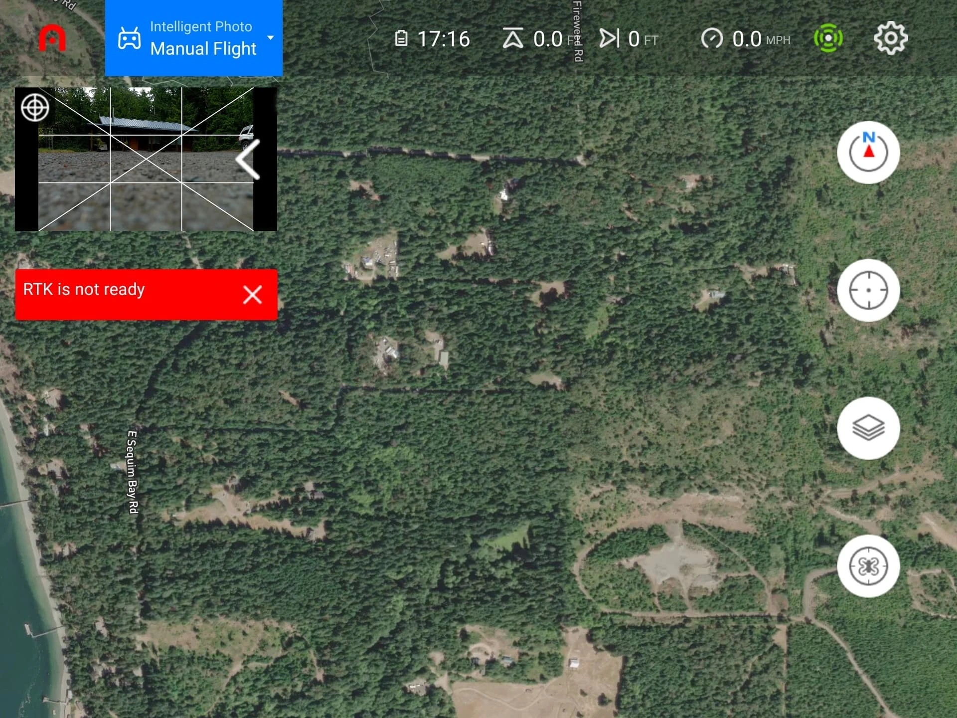

Perform Flight​
When you set up communication between your Reach and a drone, you can perform the flight. Provide Autel EVO II Enterprise with a clear sky view and proceed to the mission.
