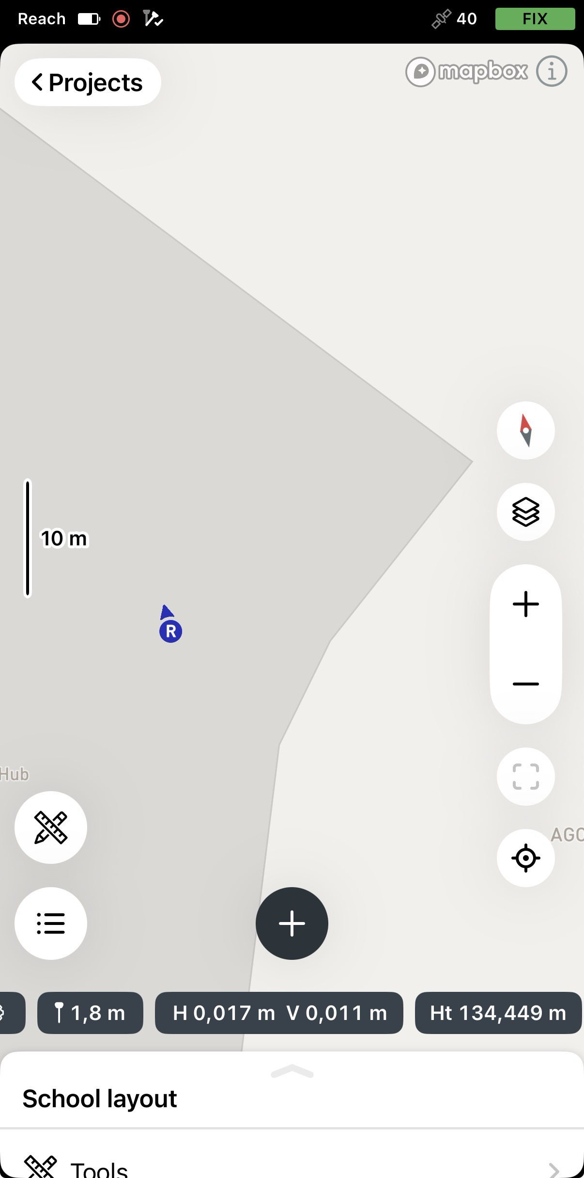

  1. Open the Emlid Flow app and connect to your Reach.
  2. Go to the Survey tab and open or import a project.
    To learn how to import a project, check the Create or import project guide.
  3. Set the pole height. By default, this parameter is set to 1.8m.
    If you work with Reach RS4 / RS4 Pro or Reach RX2, enable the quick release if you use one.

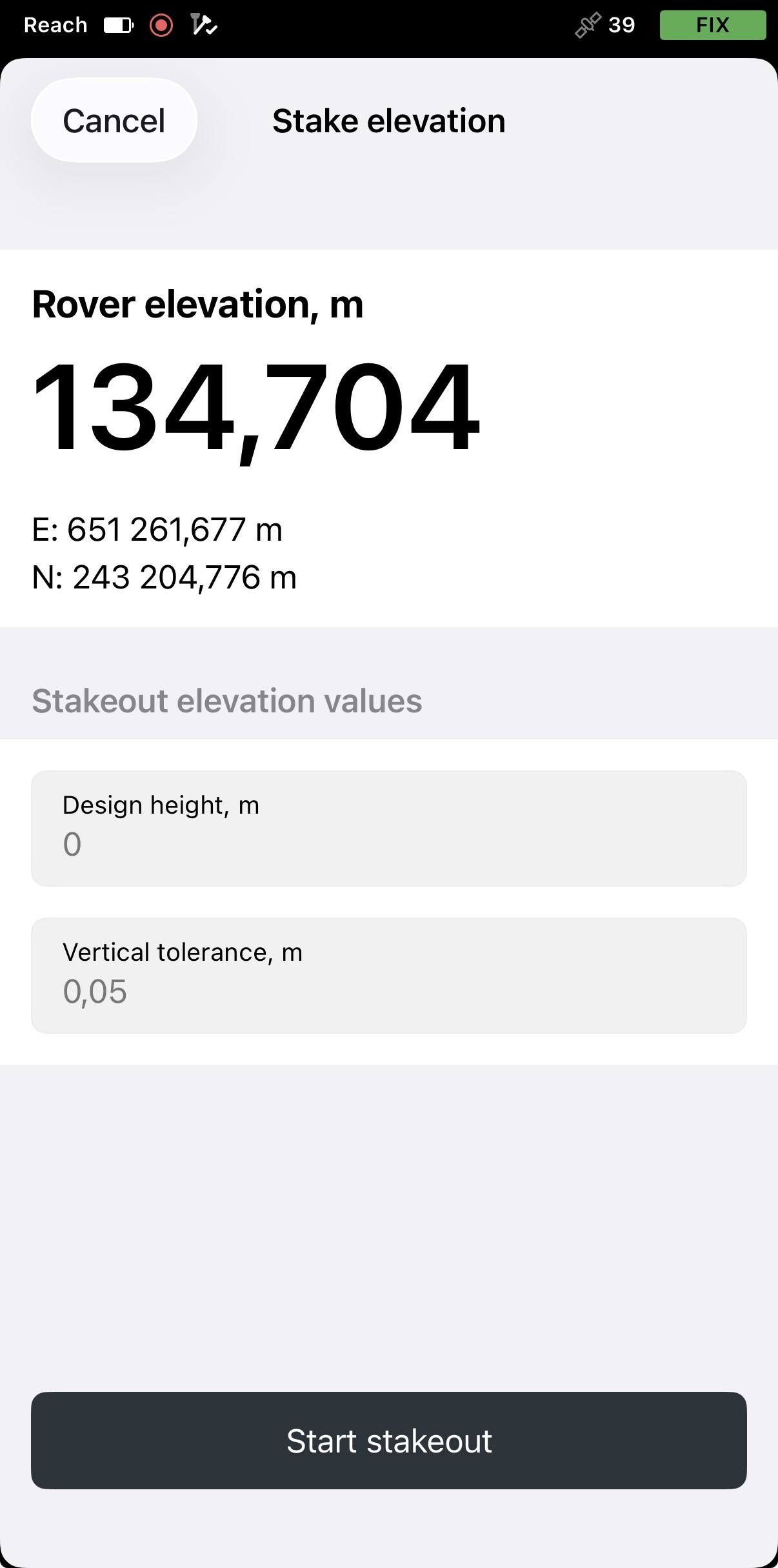

  4. On the Survey screen, tap the elevation value in the bottom status chip.

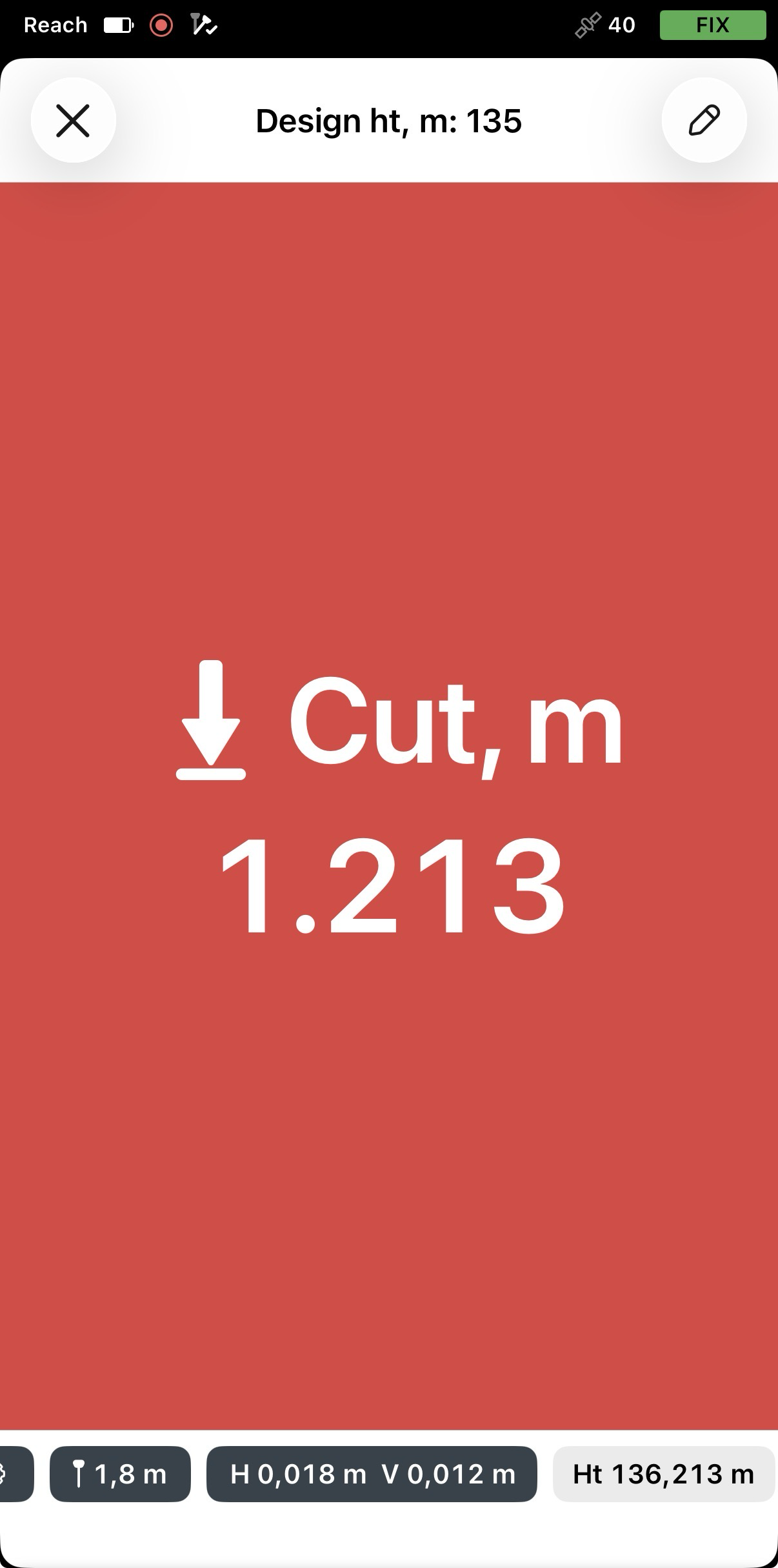

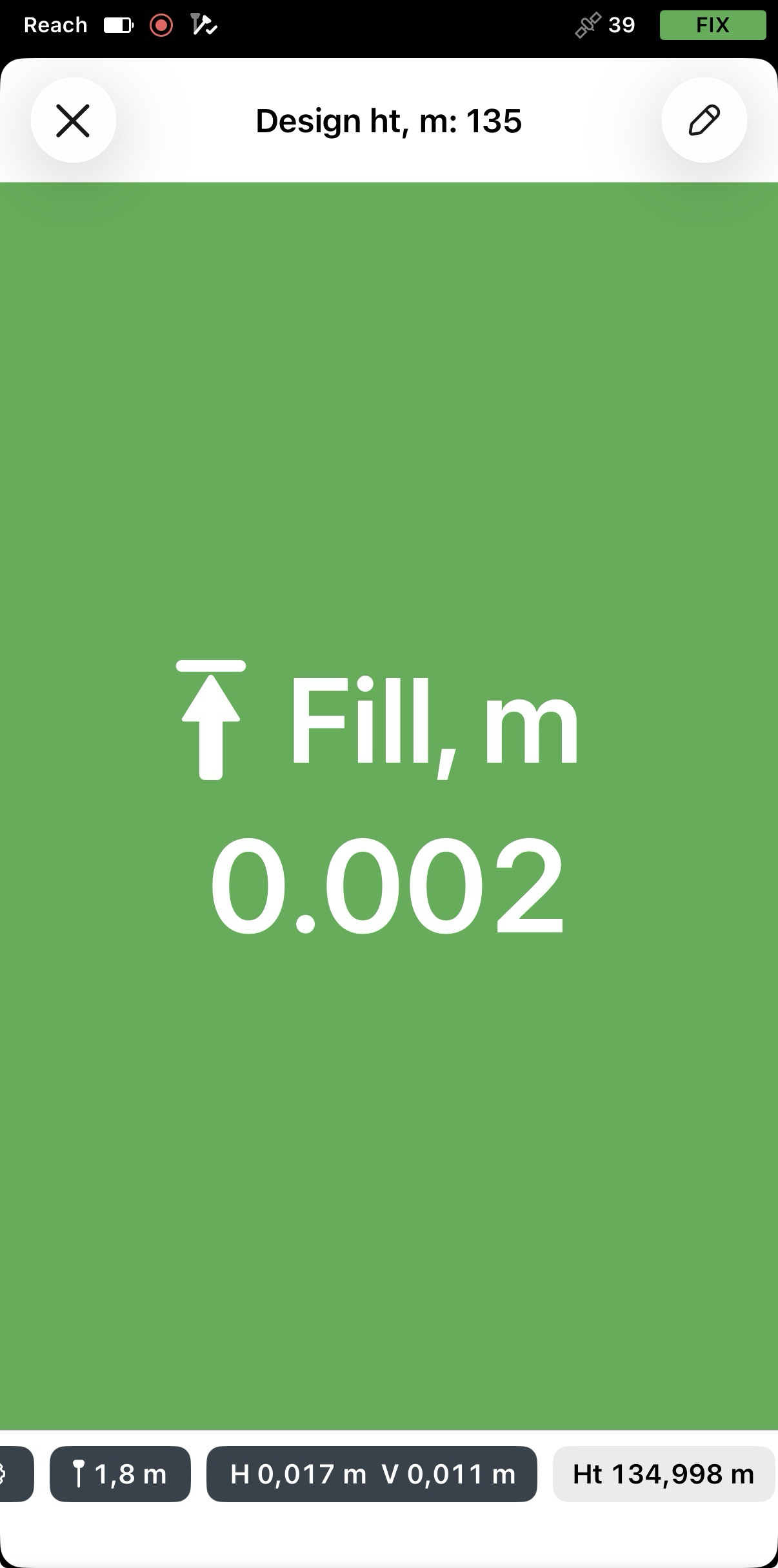

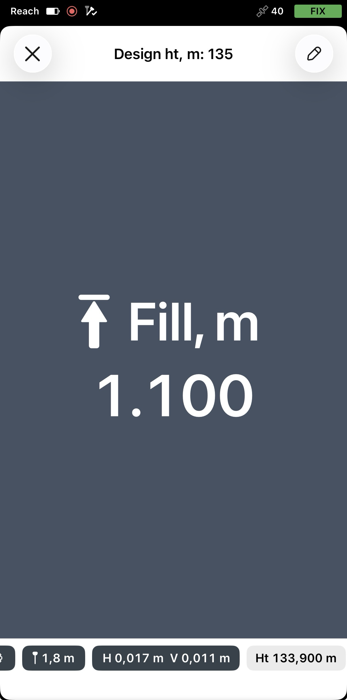

  5. Enter the design height to set the target elevation and set the vertical tolerance according to your project requirements, then tap Start stakeout.
  6. Move around the area and watch the color-coded cut/fill feedback: red means cut, gray means fill, and green means you’re within the specified tolerance. If you find a spot that is out of tolerance, mark it on the ground and add or remove material as needed.
If you want to change the design height or vertical tolerance values during work, tap the Edit button in the upper-right corner and adjust the values as needed.
