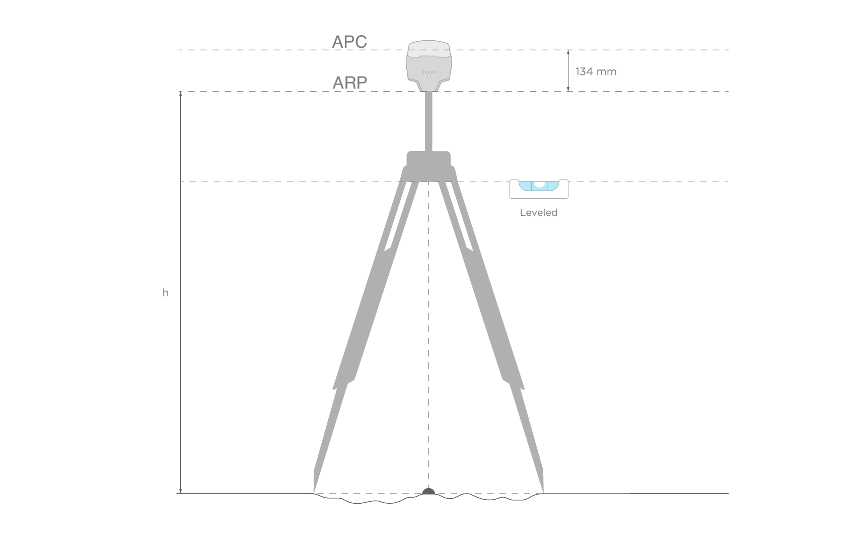

Antenna Phase Center​
The antenna phase center (APC) is the effective point in a GNSS antenna to which satellite signal reception is referenced. It is not a fixed physical point–its location shifts with the direction of the incoming signal and differs by frequency band. The precise location of the antenna phase center is determined through the National Geodetic Survey’s calibration measurements, which are essential for precise GNSS positioning.
Using the obtained APC value, Emlid Flow compensates for the offset between the antenna reference point (ARP) on the bottom of Reach receivers and the APC, so you only need to enter the tripod or survey pole height.
Antenna Reference Point​
The antenna reference point is the center point on the bottom of the receiver. It is used for calculation of the antenna height.
