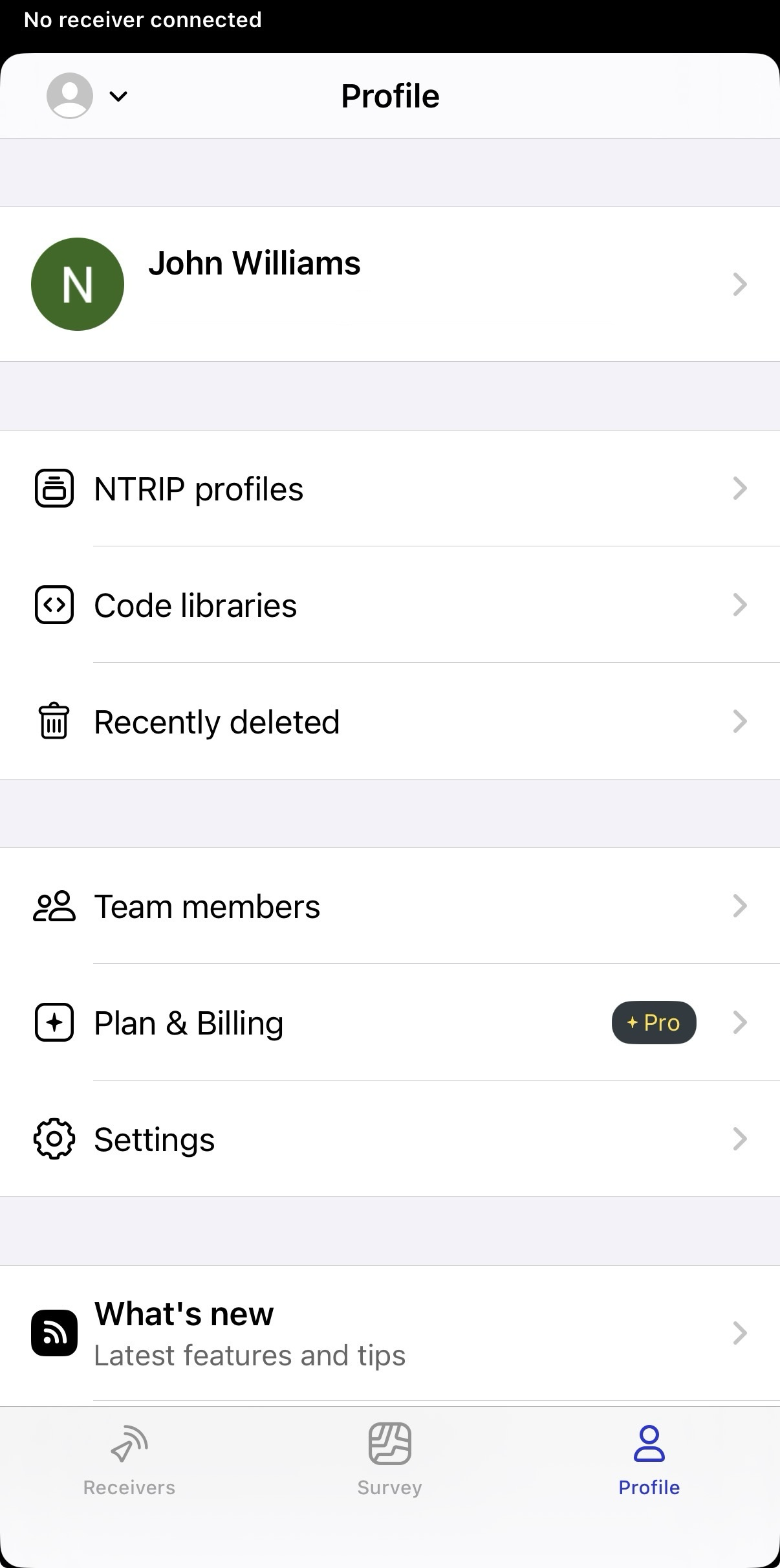

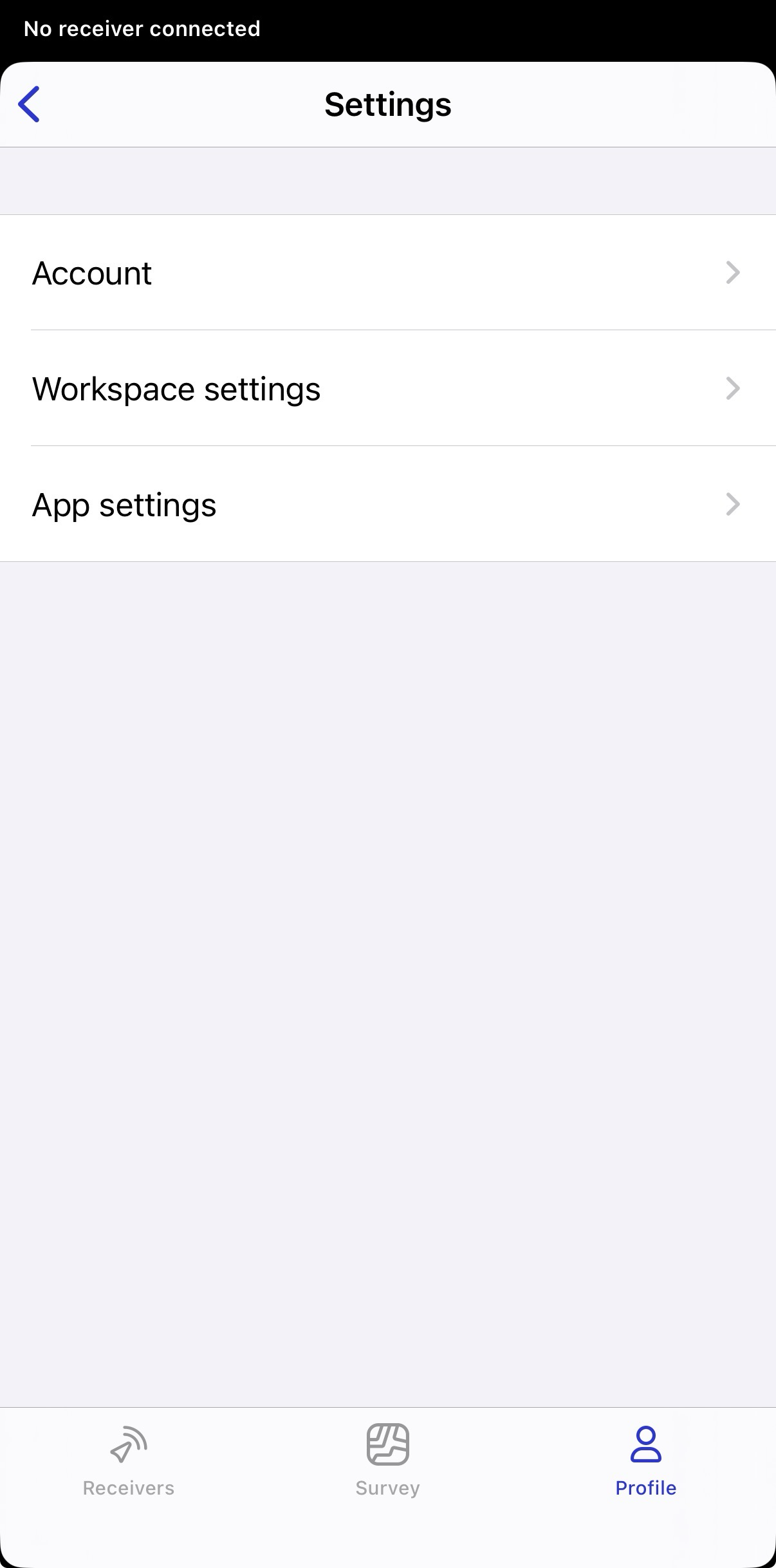

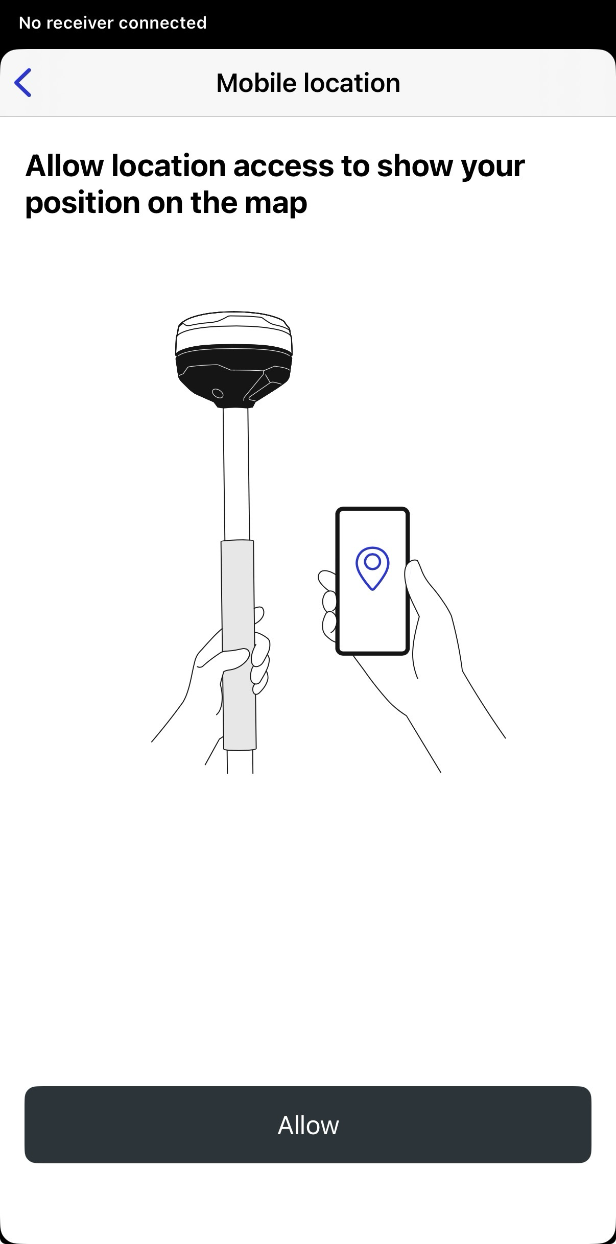

  2. Open Emlid Flow and go to the Profiles tab and tap Settings.

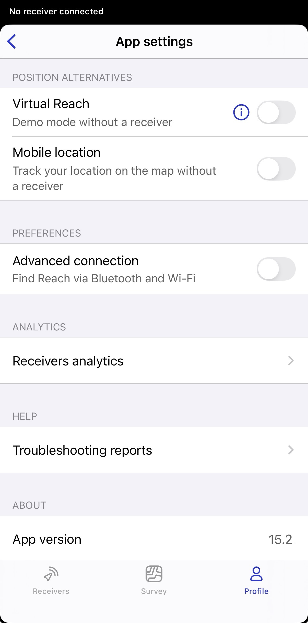

  3. Go to App settings and enable Mobile location.

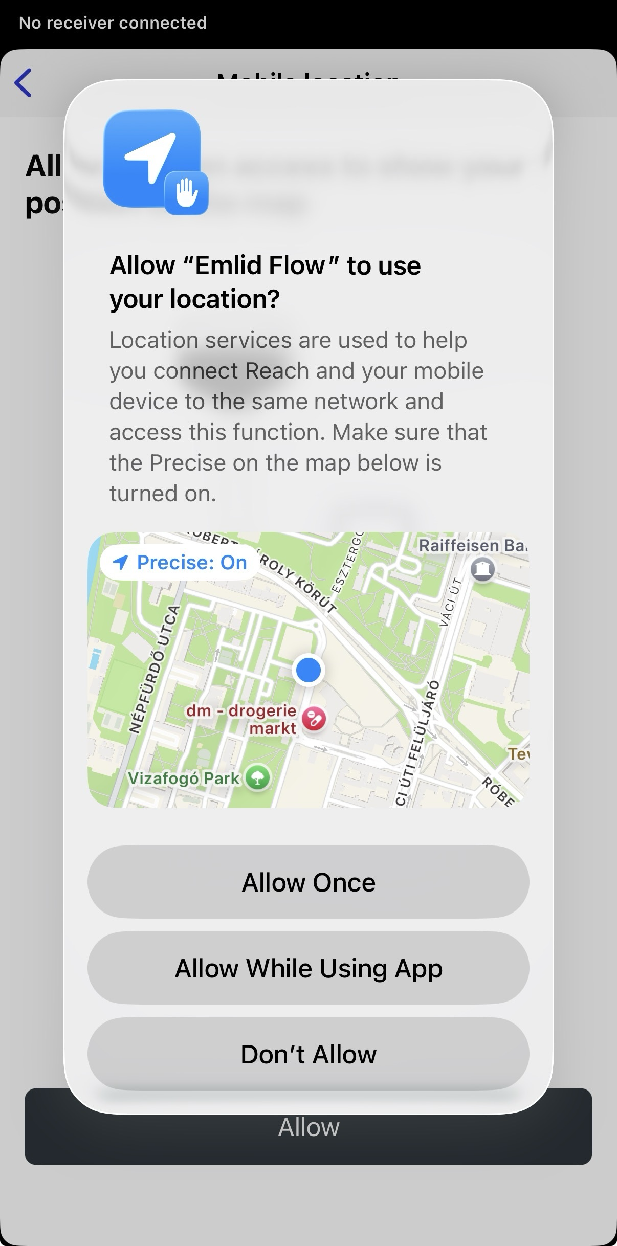

  4. When prompted, allow Emlid Flow to access your device's precise location. Location data is used only in real time and is not stored or transmitted to our servers.

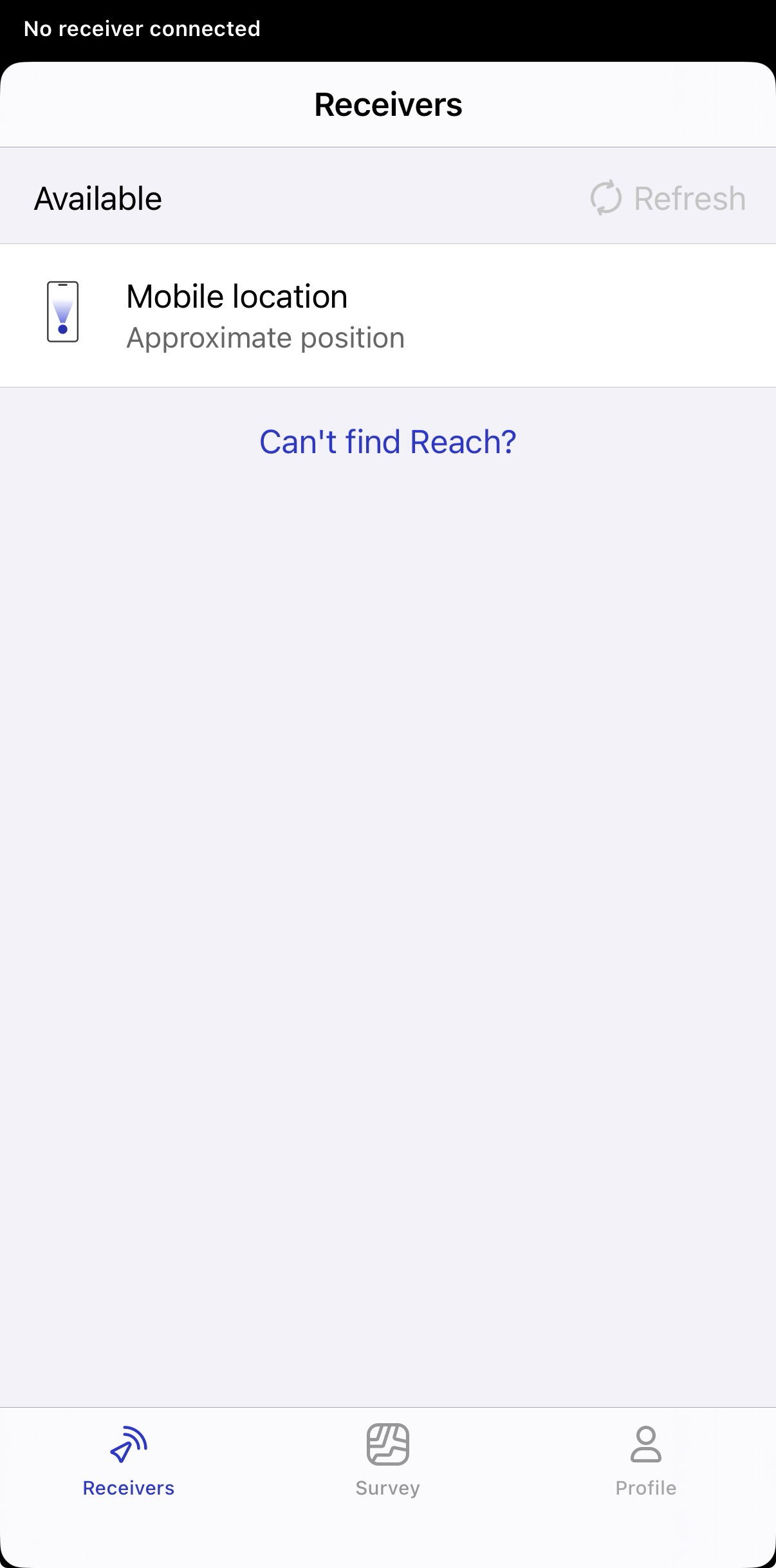

  5. Once it is enabled, go to the Receivers tab and choose Mobile location as your receiver.

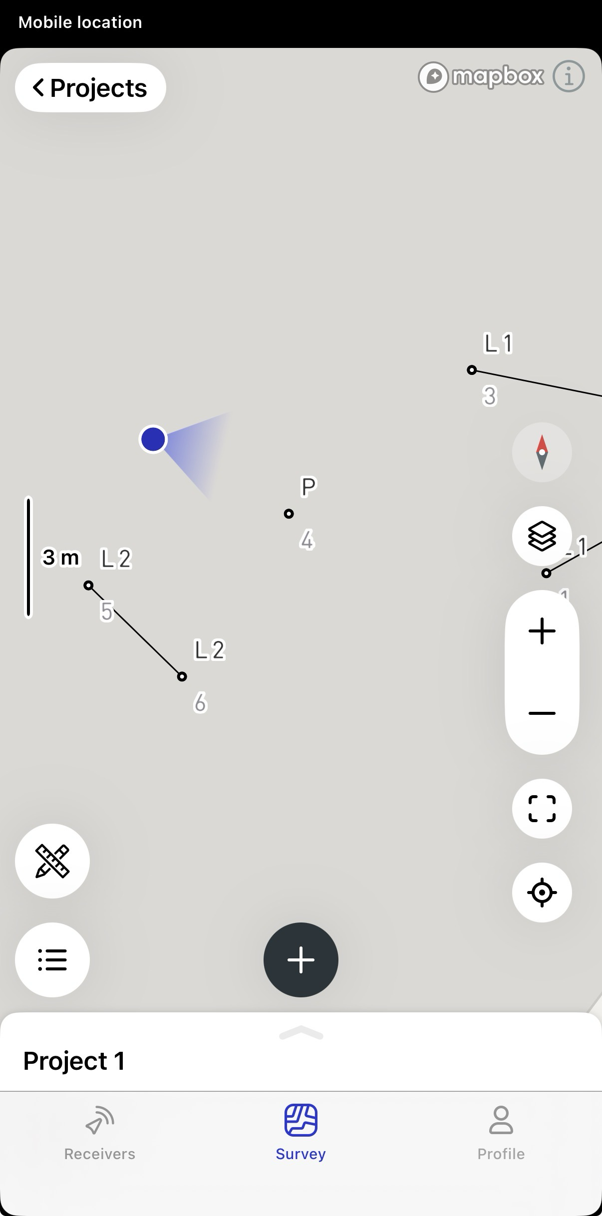

  6. Open your project and see your approximate position on the project map while navigating the site.
You can now use Mobile location to navigate in the fields using your device's built-in location until you're ready for higher-accuracy positioning.
