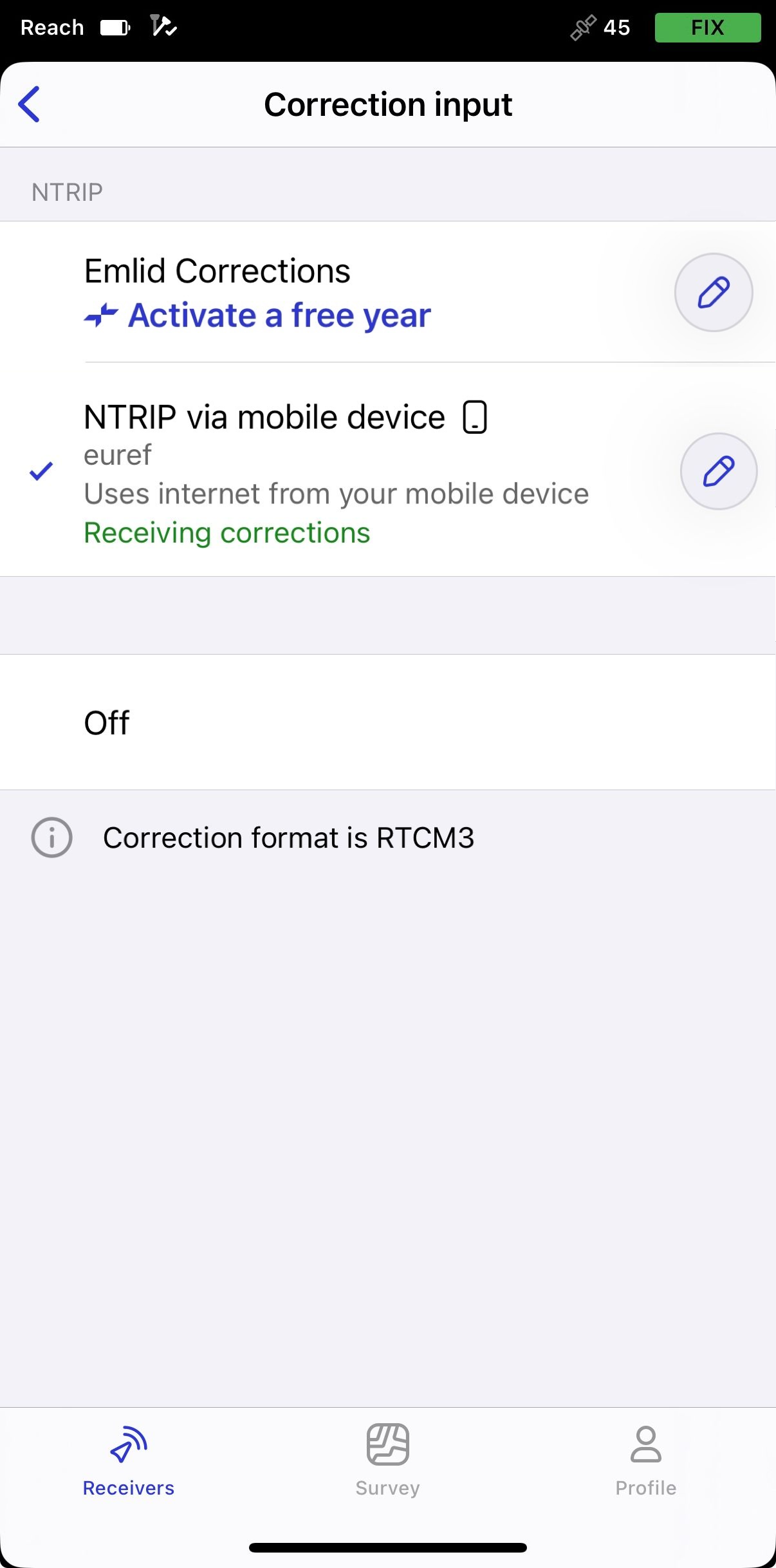

To achieve centimeter-level accuracy when surveying with Reach RX2, set up your receiver to receive NTRIP corrections in the Emlid Flow app. Do as follows:
  2. Go to Correction input and tap NTRIP over mobile device.
  3. Tap the Edit button to configure receiving corrections from the NTRIP base.

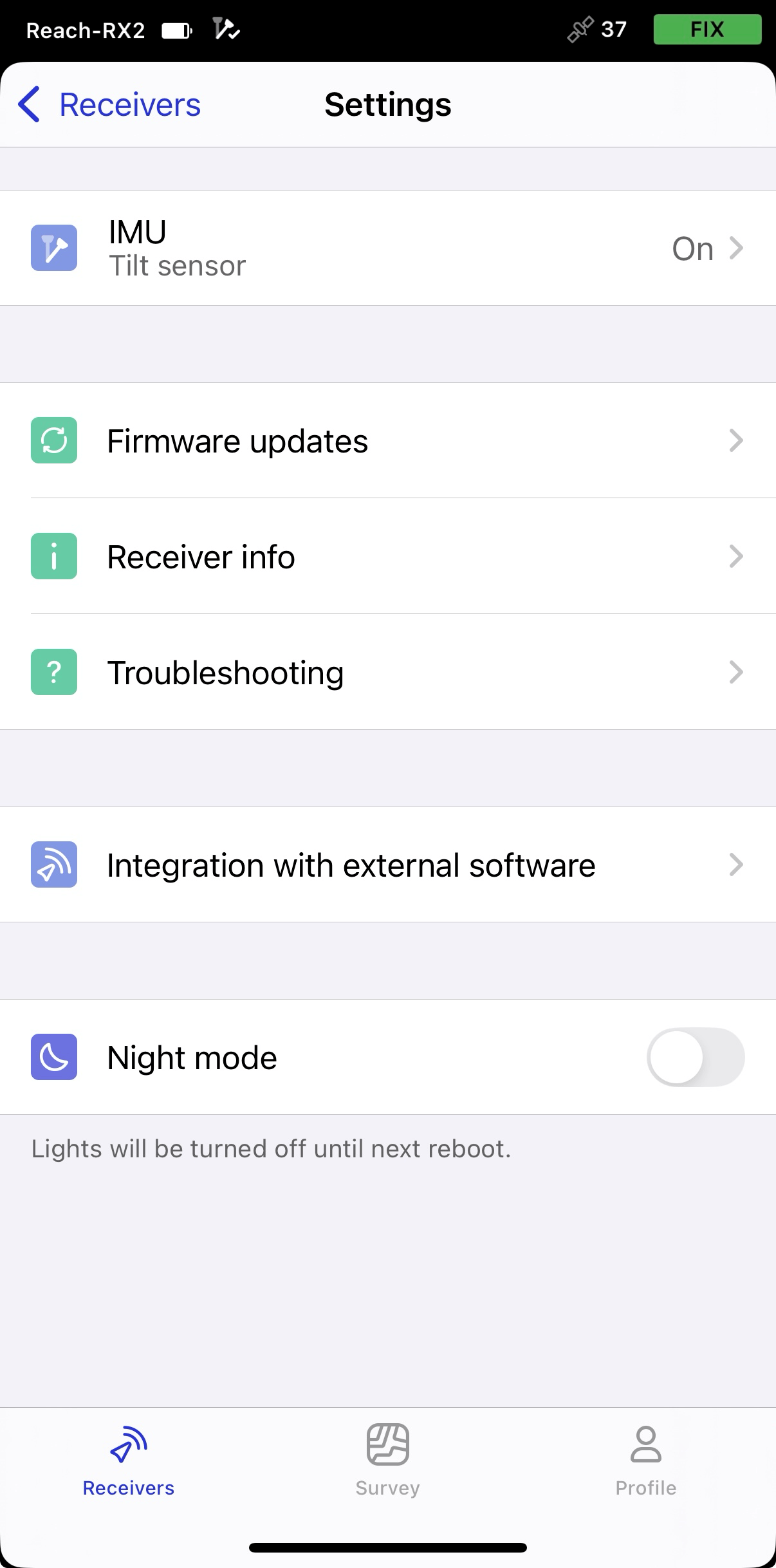

  1. In Emlid Flow, open Settings and go to Integration with external software.
  2. Turn on the toggle to enable streaming compensated position.

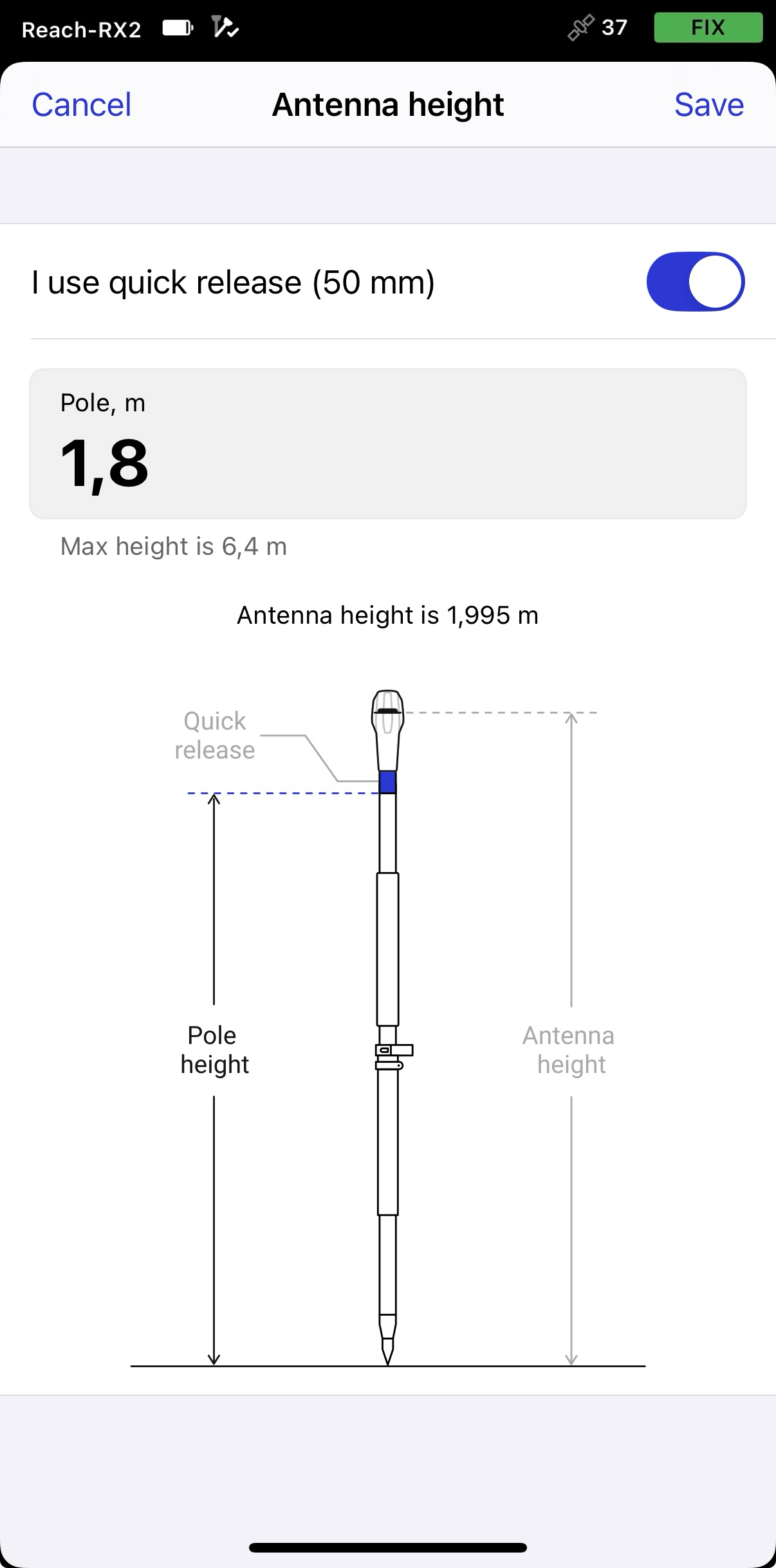

  3. Set the antenna height. You only need to enter the pole height. Emlid Flow automatically applies the antenna phase center offset and adjusts the measurements accordingly.
    If you use a quick release, turn on the toggle to include its height in the antenna height calculation.
    When sending compensated NMEA messages, set the antenna height only in Emlid Flow. Setting it in third-party apps as well may cause discrepancies.

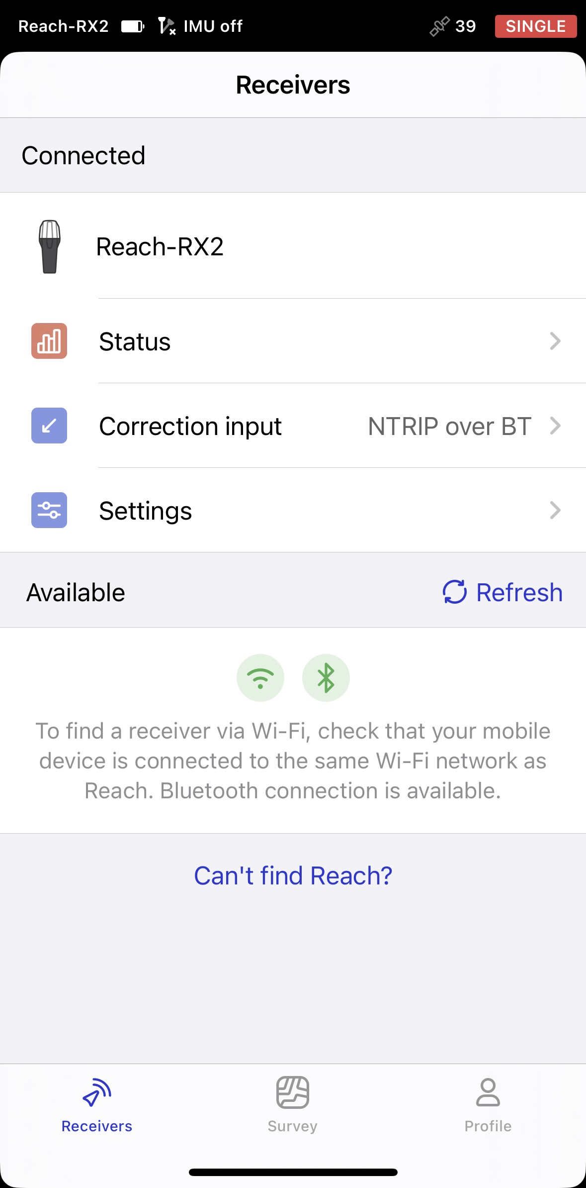

To pair your Reach RX2 with Mergin Maps, first, you need to pair it with the iOS device as follows:

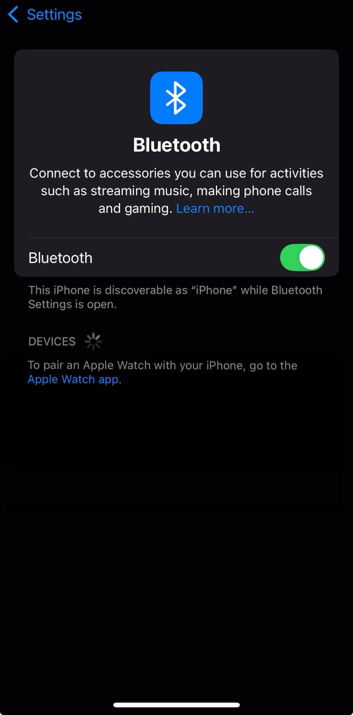

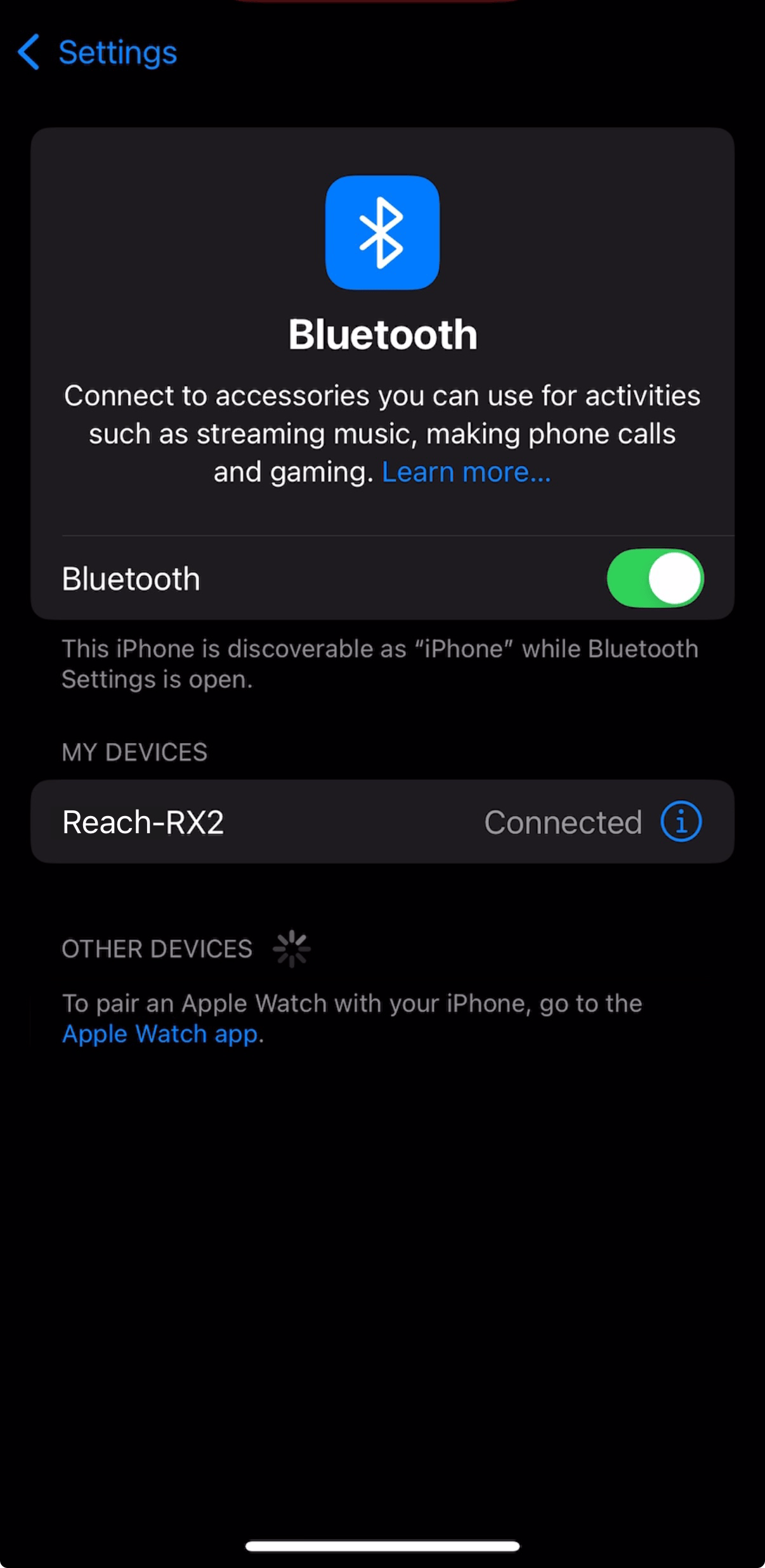

  1. Navigate to the Bluetooth configuration screen on your iOS device and enable Bluetooth.

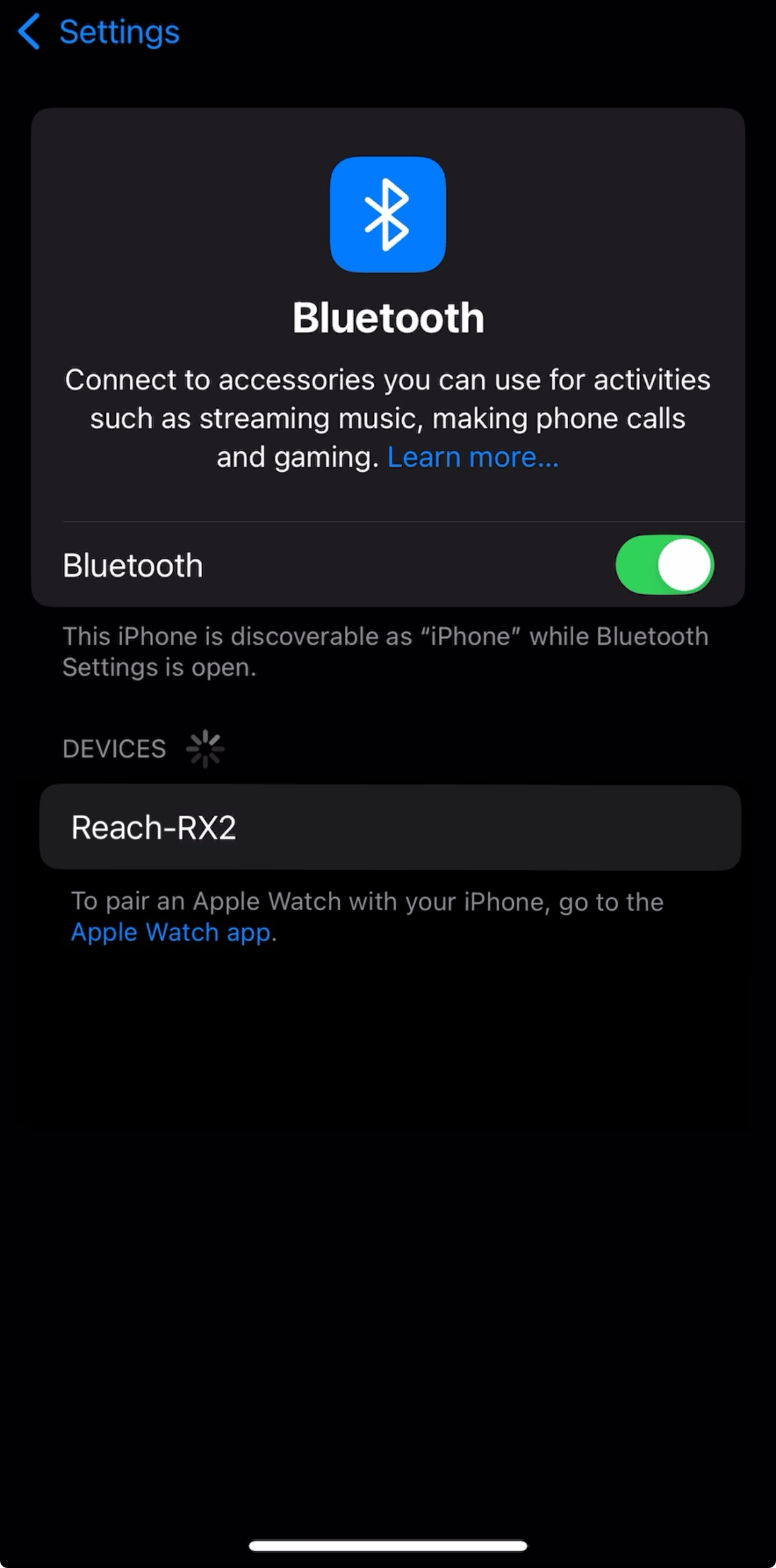

  2. Wait for your Reach RX2 to be listed as an available device.
    Keep Reach within a few meters from the device.
  3. Tap the name of your Reach in the list of available devices on the iOS device. You should see the note "Connected".
    If your device requires a PIN code, enter 123456.

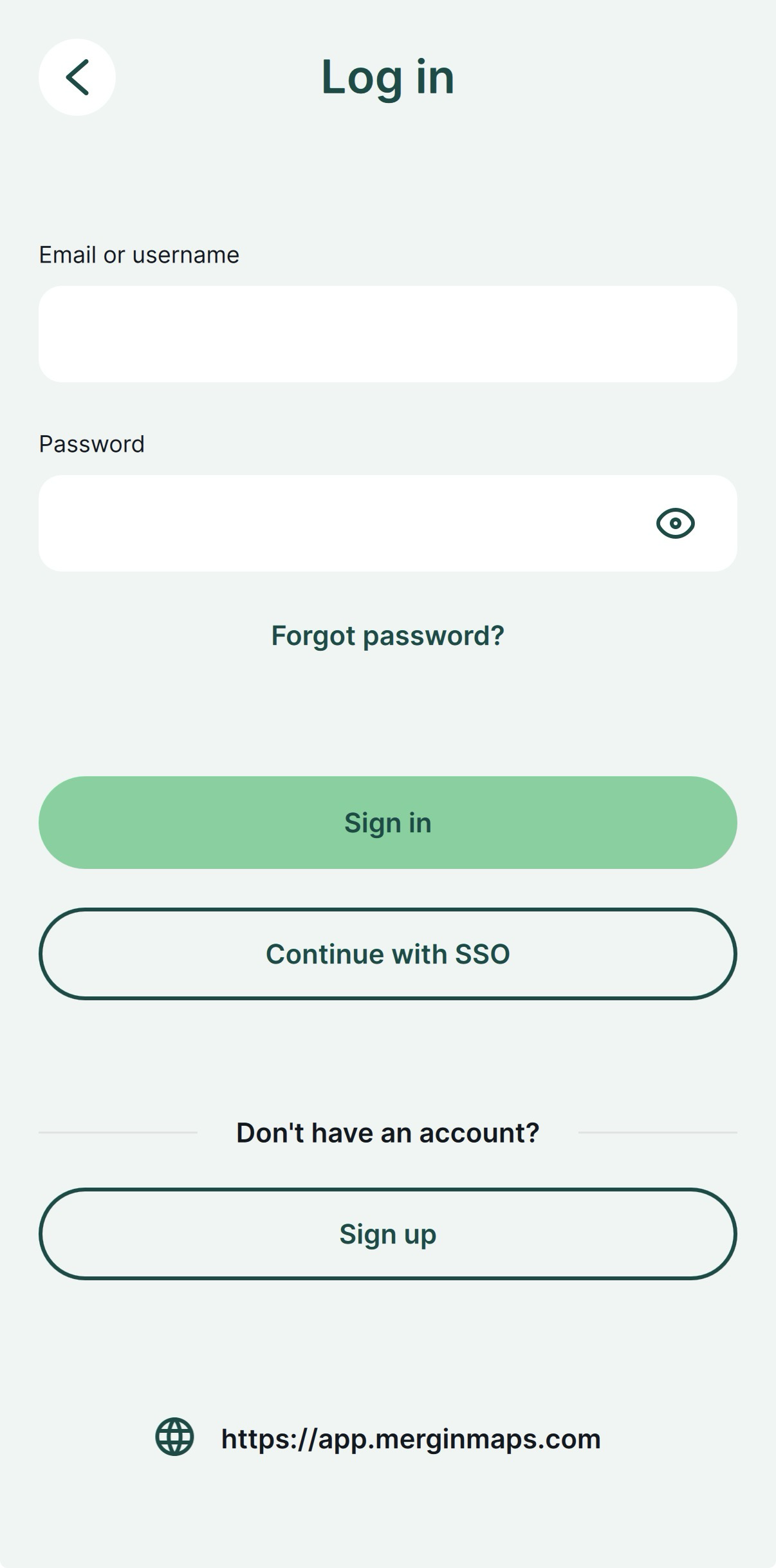

  1. Open the Mergin Maps app and create an account if you don’t have one yet to access the app.

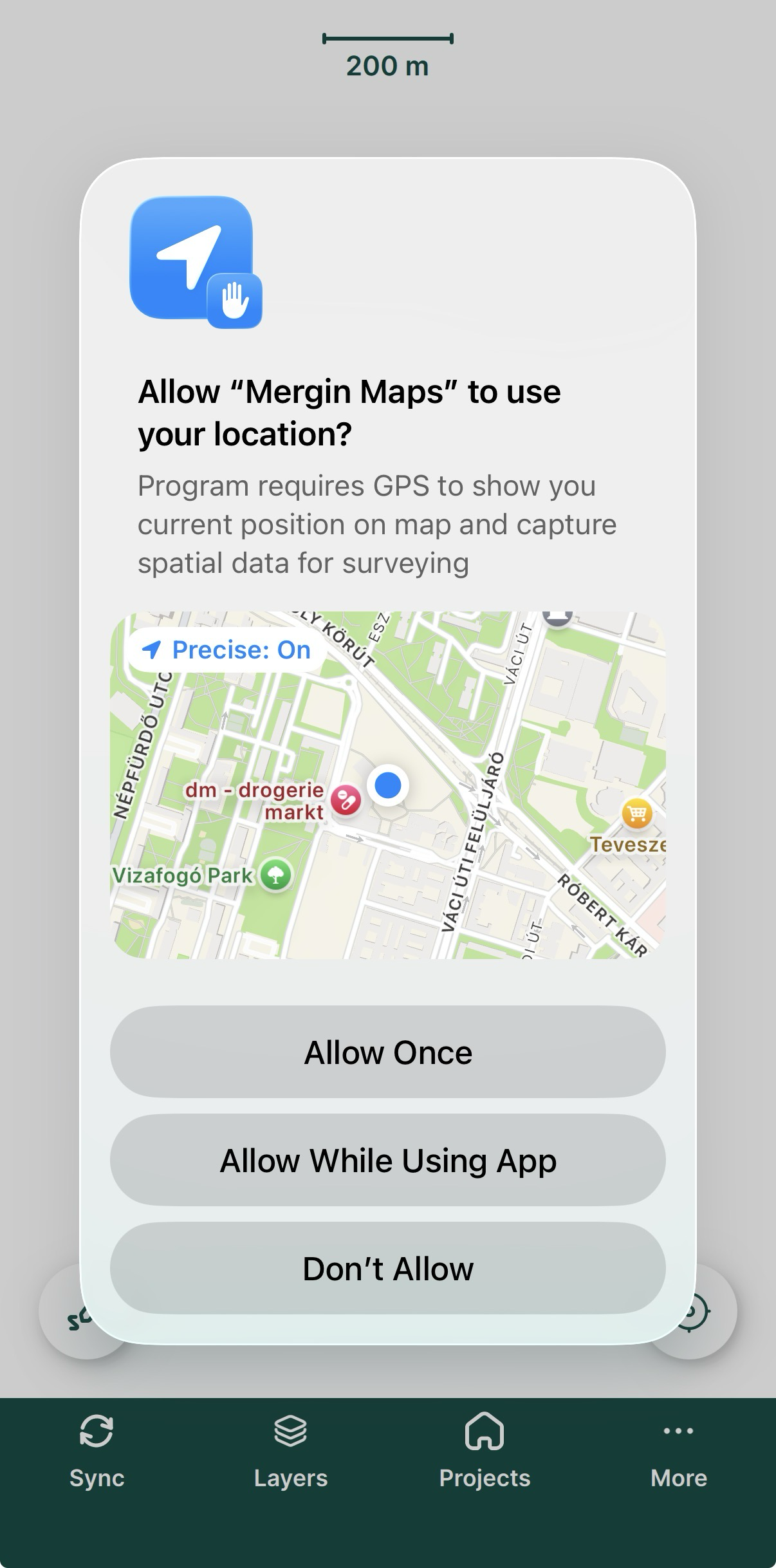

  3. If prompted, allow precise location.

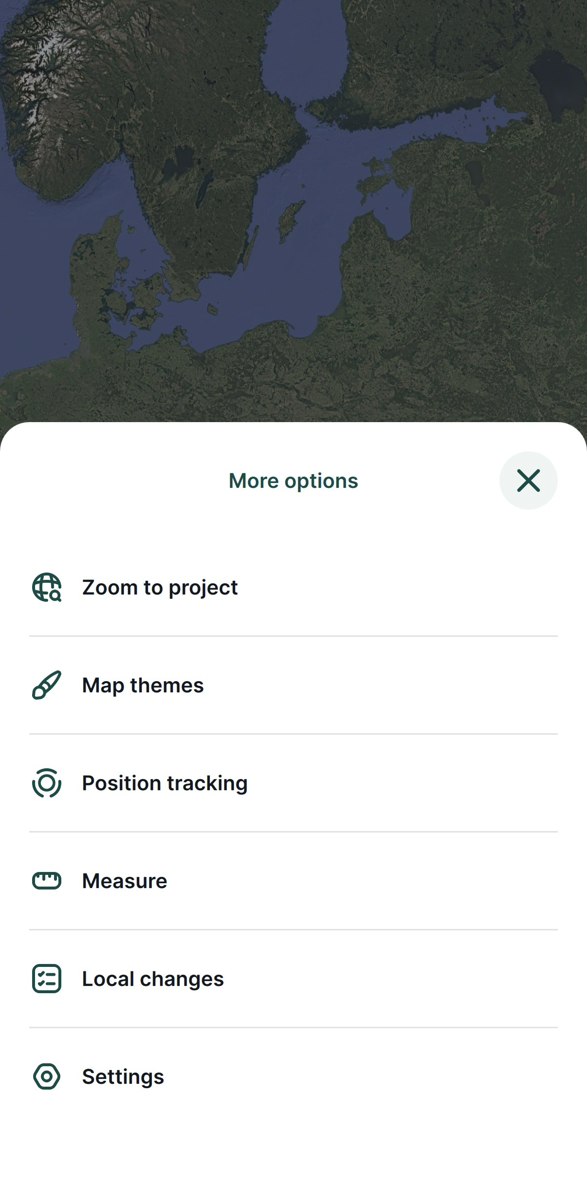

  4. On the opened screen in the lower right corner, tap More and Settings.

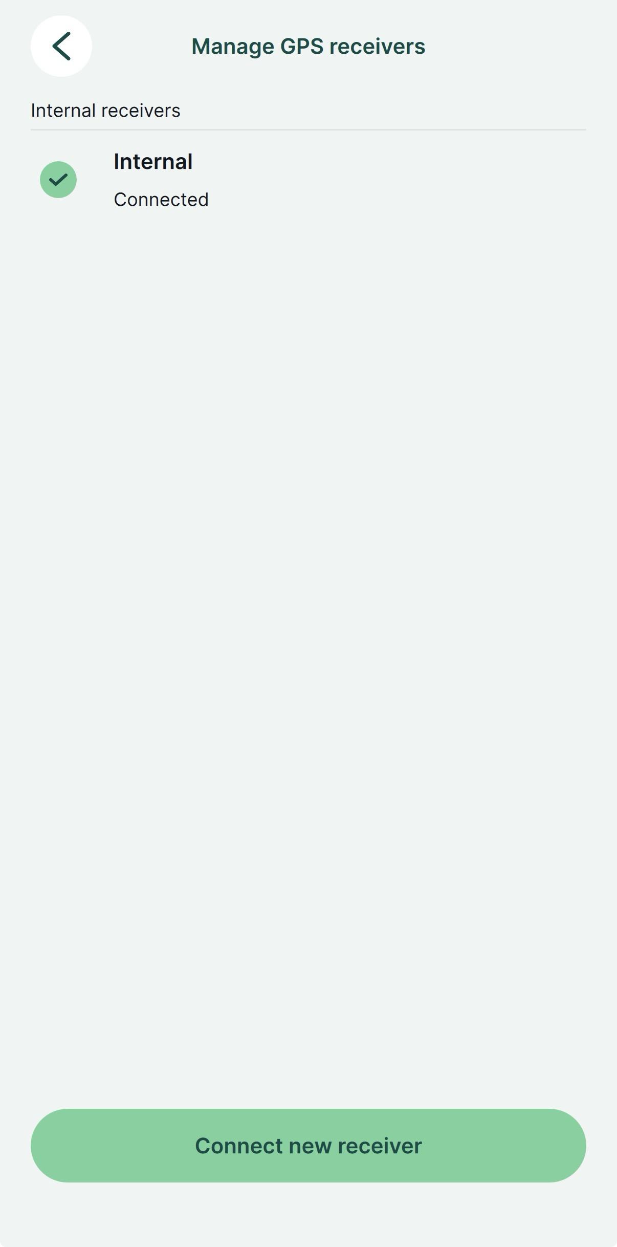

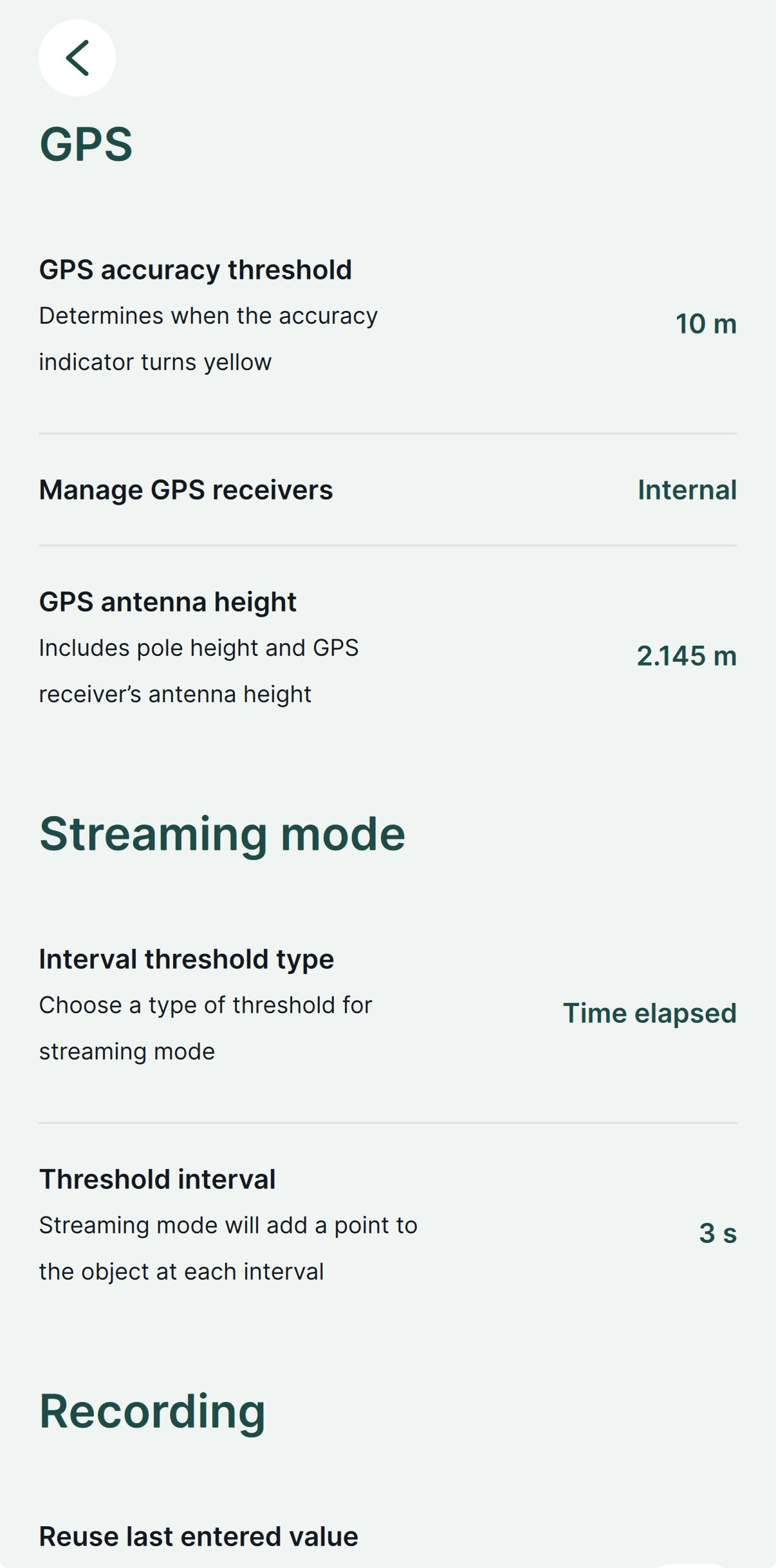

  5. In Settings, tap Select GPS receiver.
  6. Choose Internal.

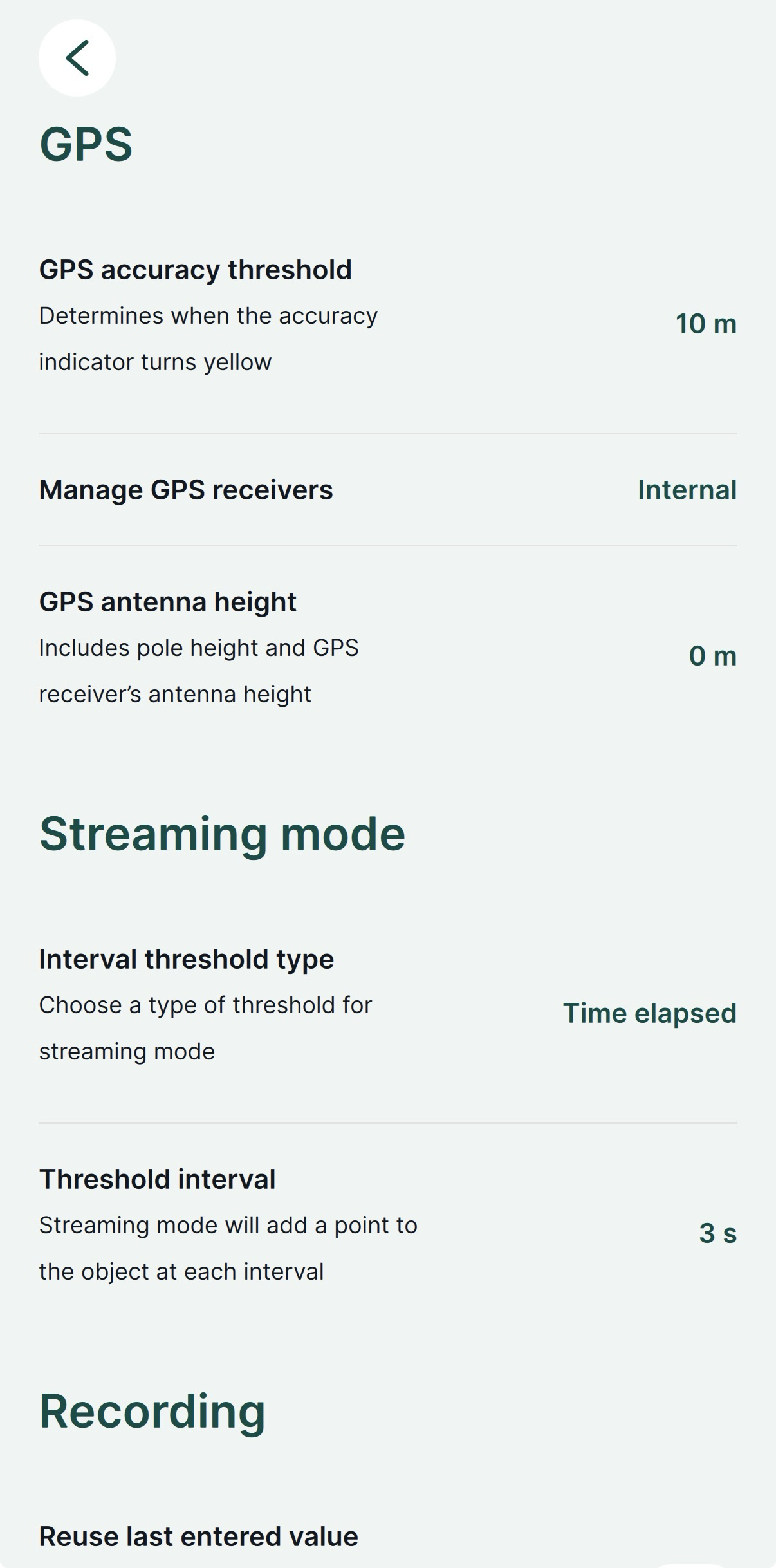

  7. This step is only required when you don’t stream compensated NMEA position. Go back to Settings and set the antenna height. For Reach RX, the antenna height is the distance from the mark on the ground to the center point on the Reach’s bottom, antenna reference point (ARP), plus the height of the receiver to the antenna phase center (APC), antenna height offset. The antenna height offset equals to 145 mm.

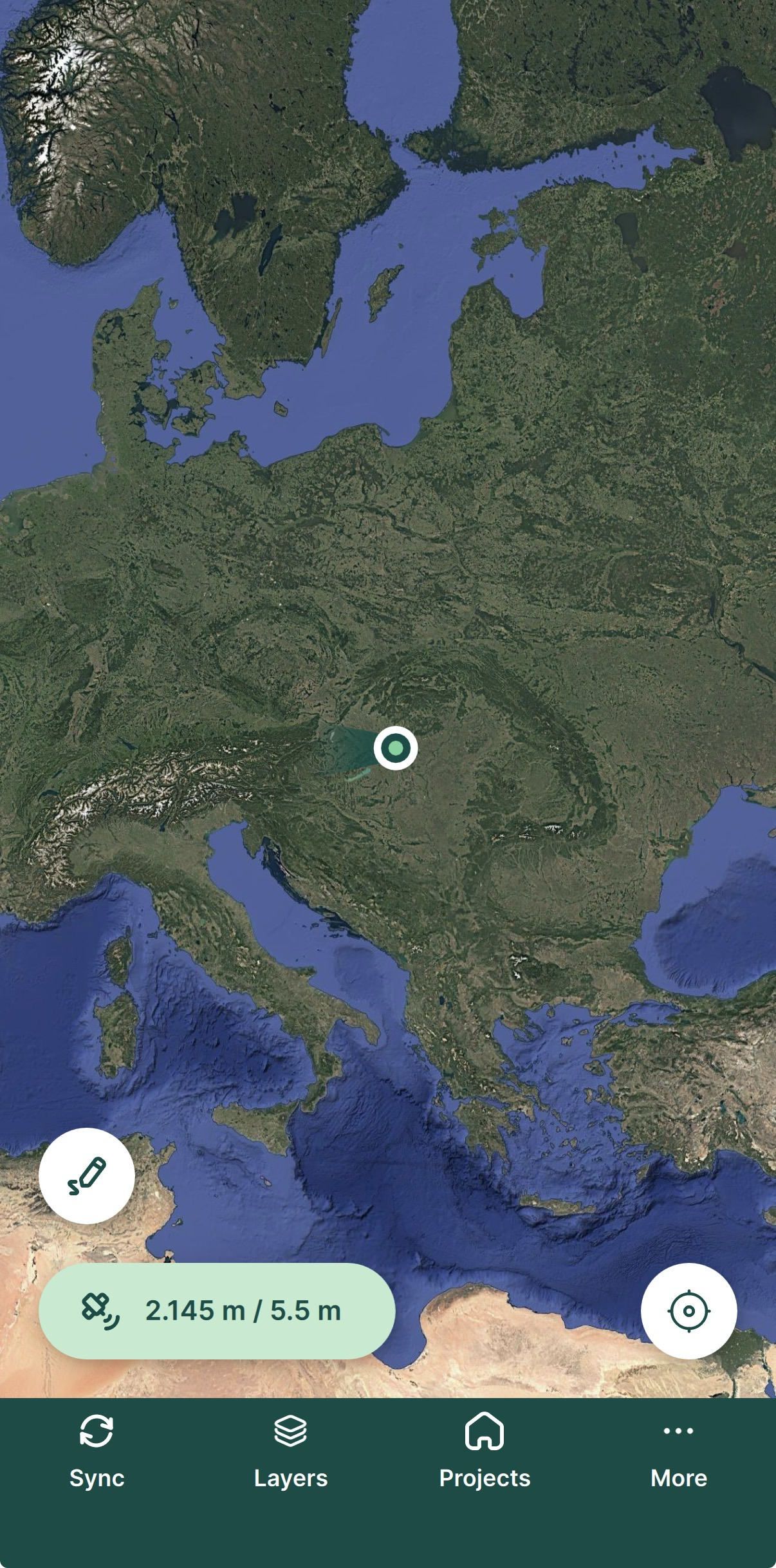

  8. Go to the GPS tab and check the RTK status and accuracy on the map. To check the detailed GPS info, go to Emlid Flow.
