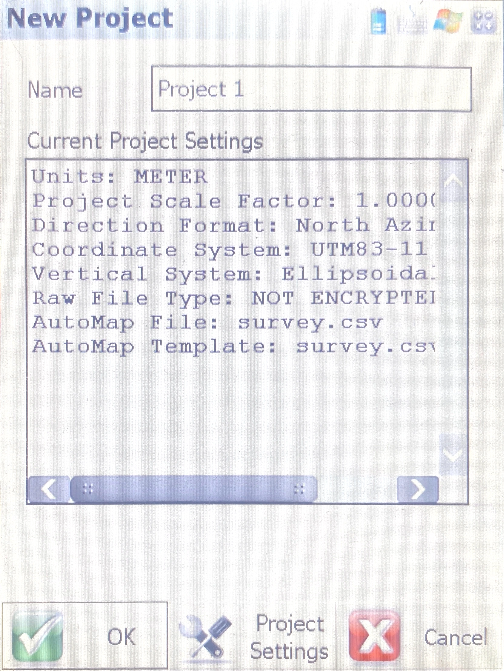

  1. Launch FieldGenius and create a new project. At this step, you can configure the units and coordinate system in Project Settings. When it’s done, click OK to proceed.

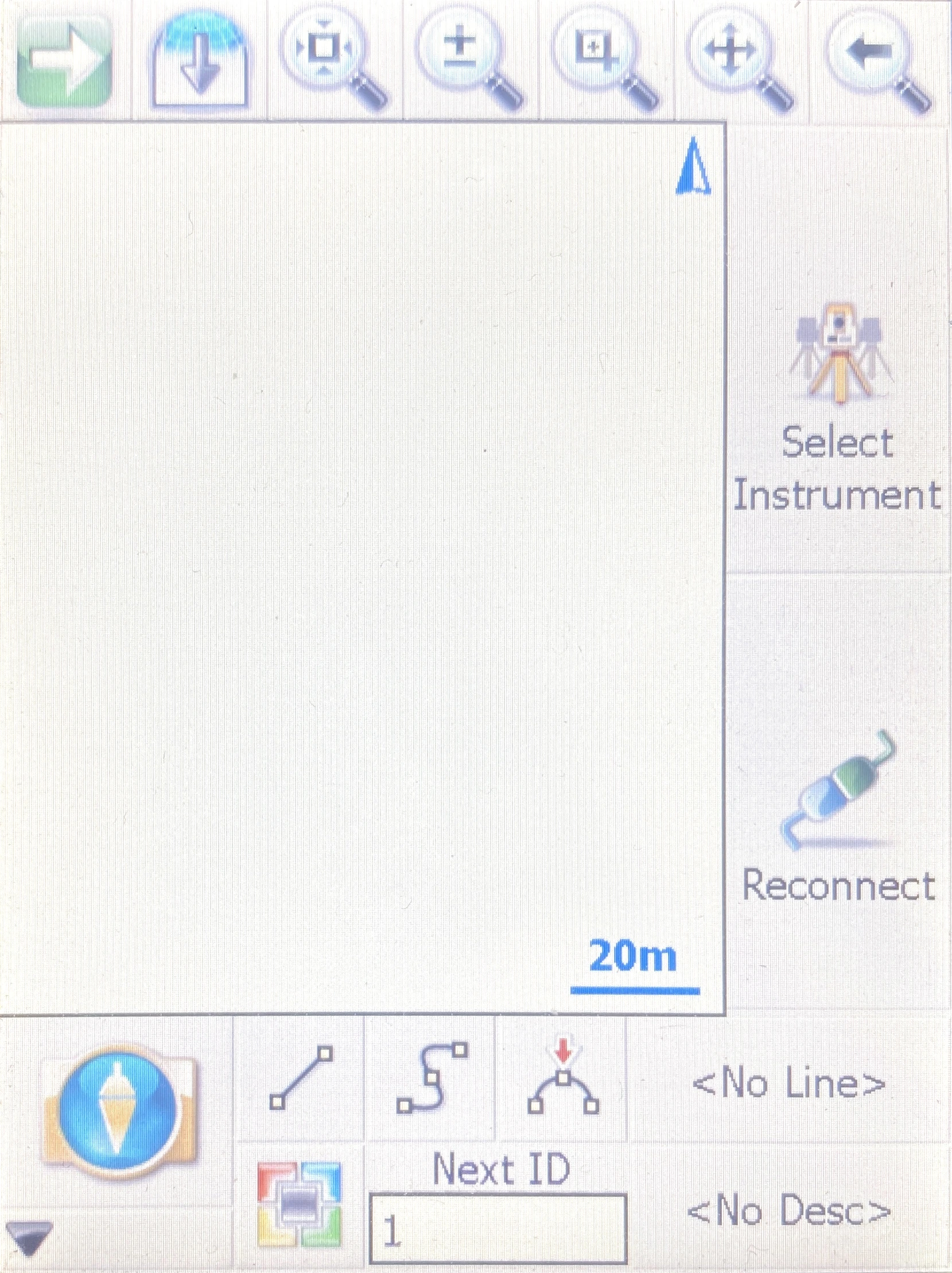

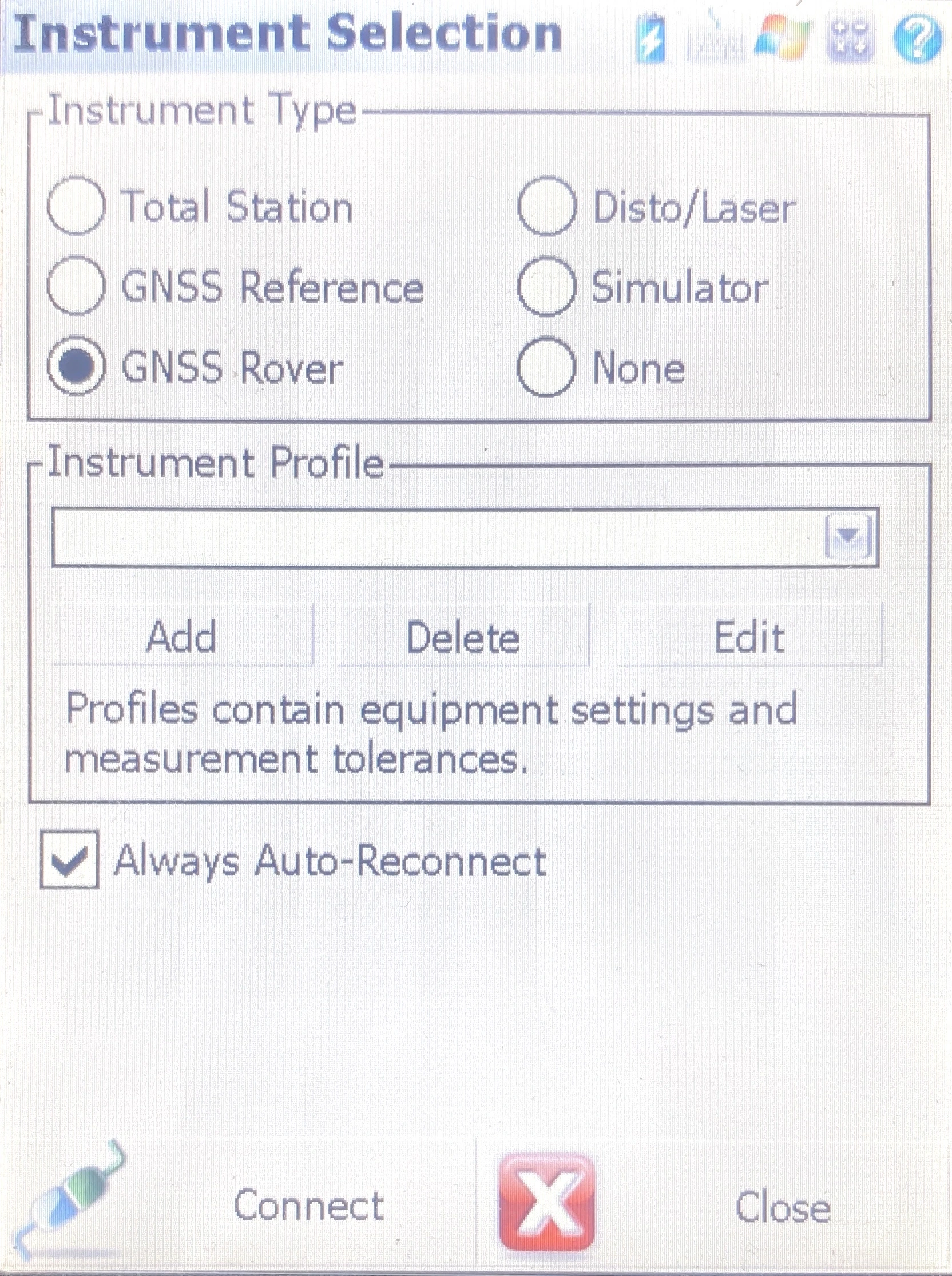

  1. You will see the FieldGenius interface. Choose Select Instrument.

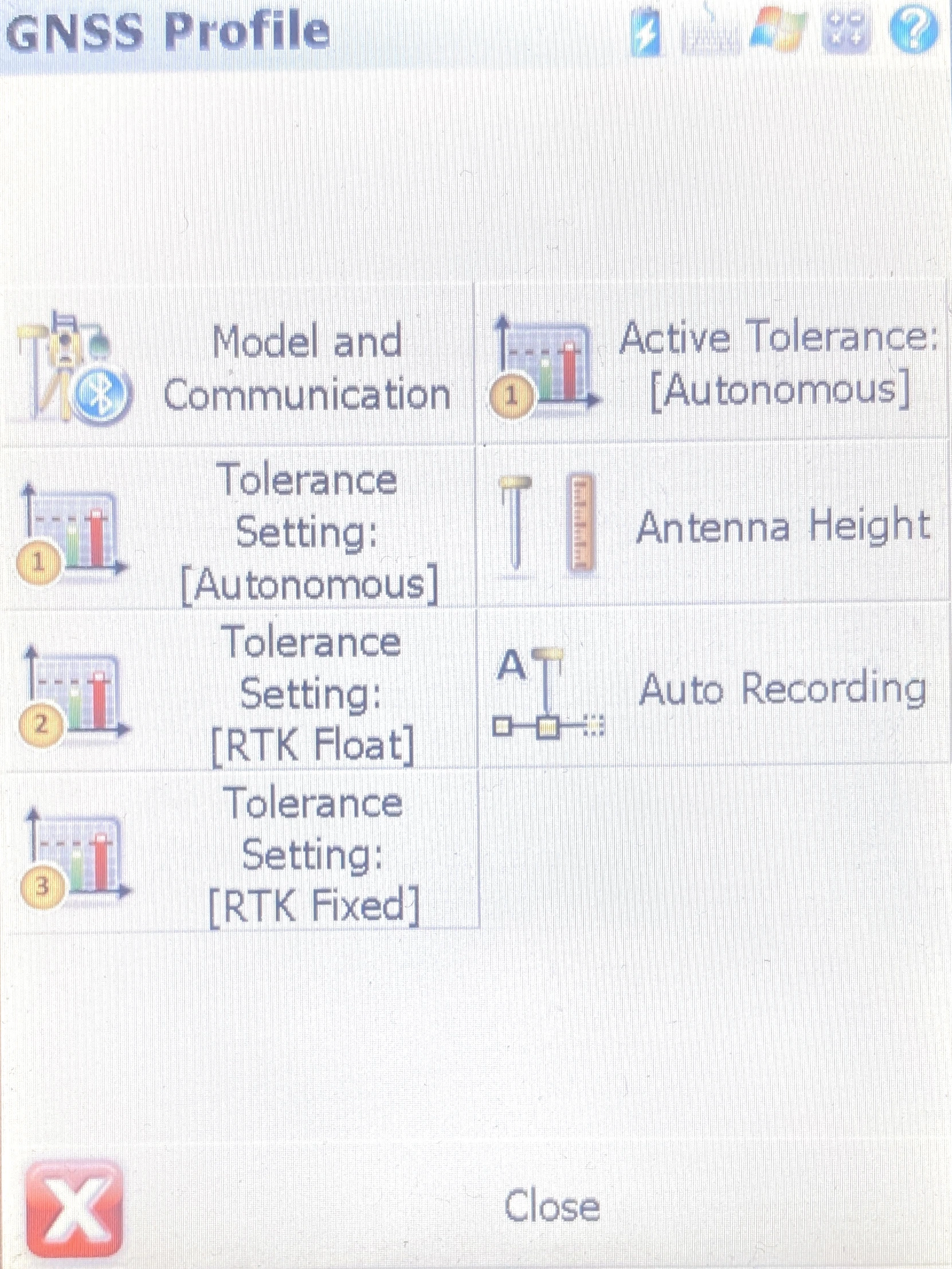

  1. Choose the GNSS Rover as an instrument type and add a new instrument profile.
  1. Set the Reach profile name and click Save.

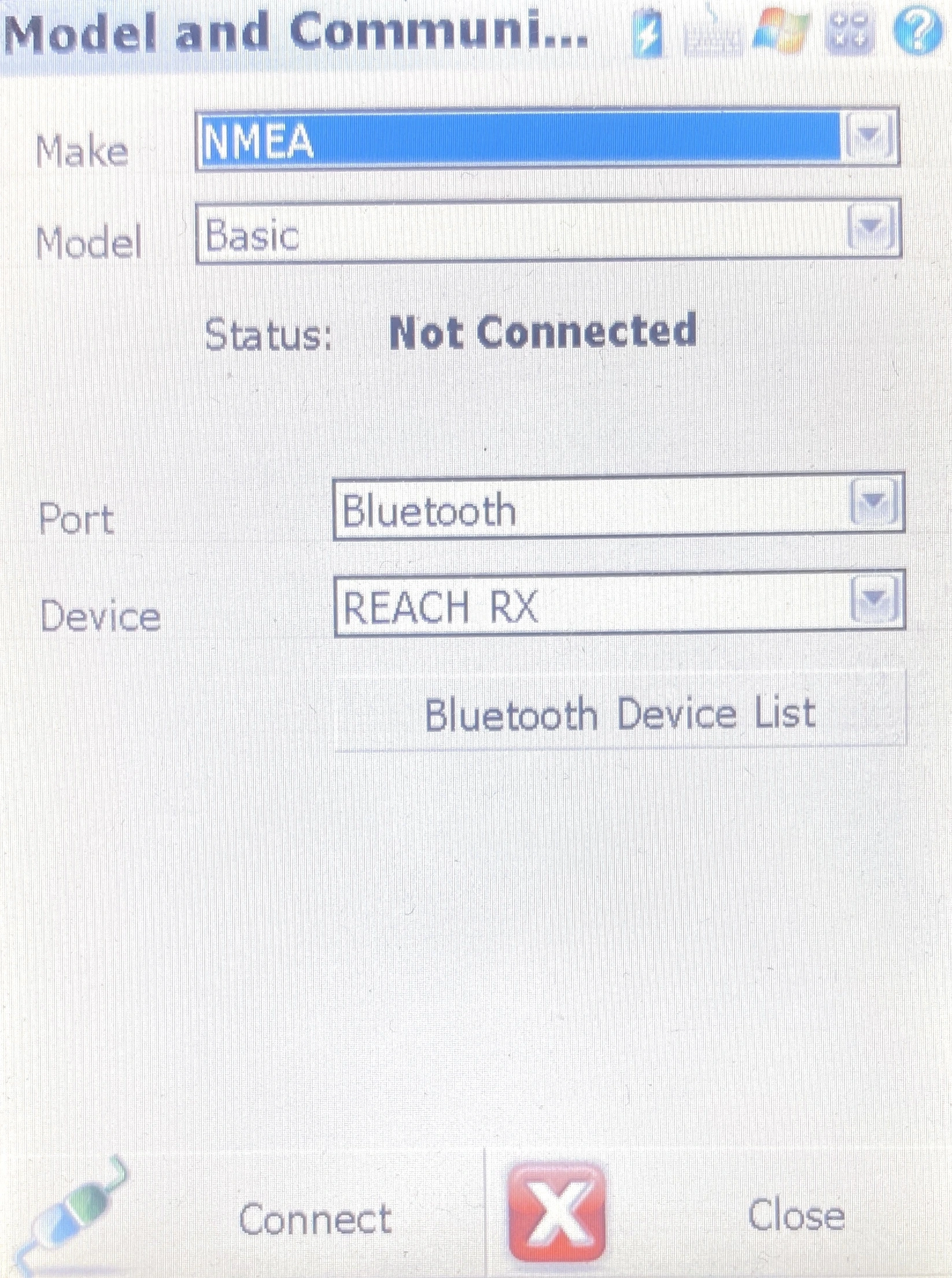

  1. Click Edit to configure the receiver parameters.
  1. Select Model and Communication.
  2. Fill in the required fields as follows:
    • Select NMEA for Make.
    • Leave Basic for Model.
    • Specify the profile name.
    • Leave Bluetooth for Port.

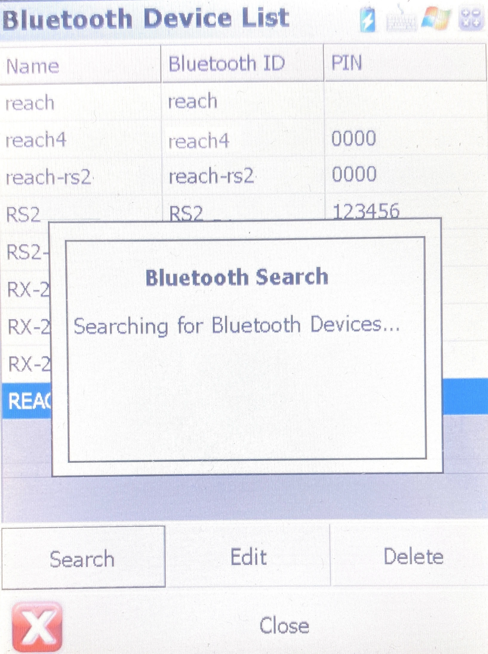

  1. Click Bluetooth Device List and search for your Reach RX2.

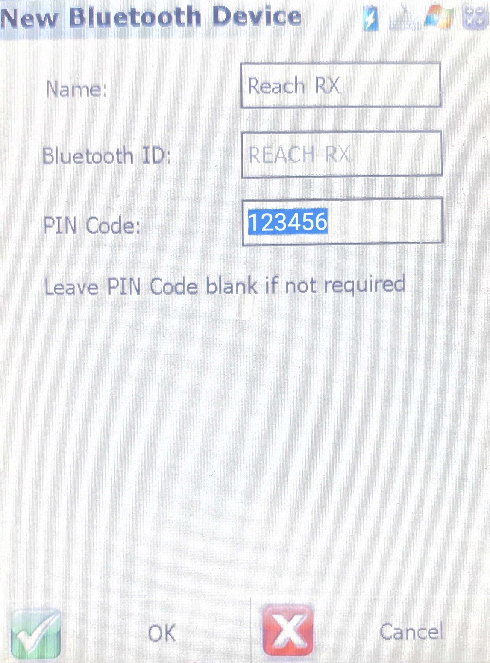

  1. Once you have found your Reach RX2, select it, enter 123456 as a PIN code, and click OK.
  1. After adding the Reach device to Bluetooth Device List, click Close and return to Model and Communication settings.
  2. Click Connect.

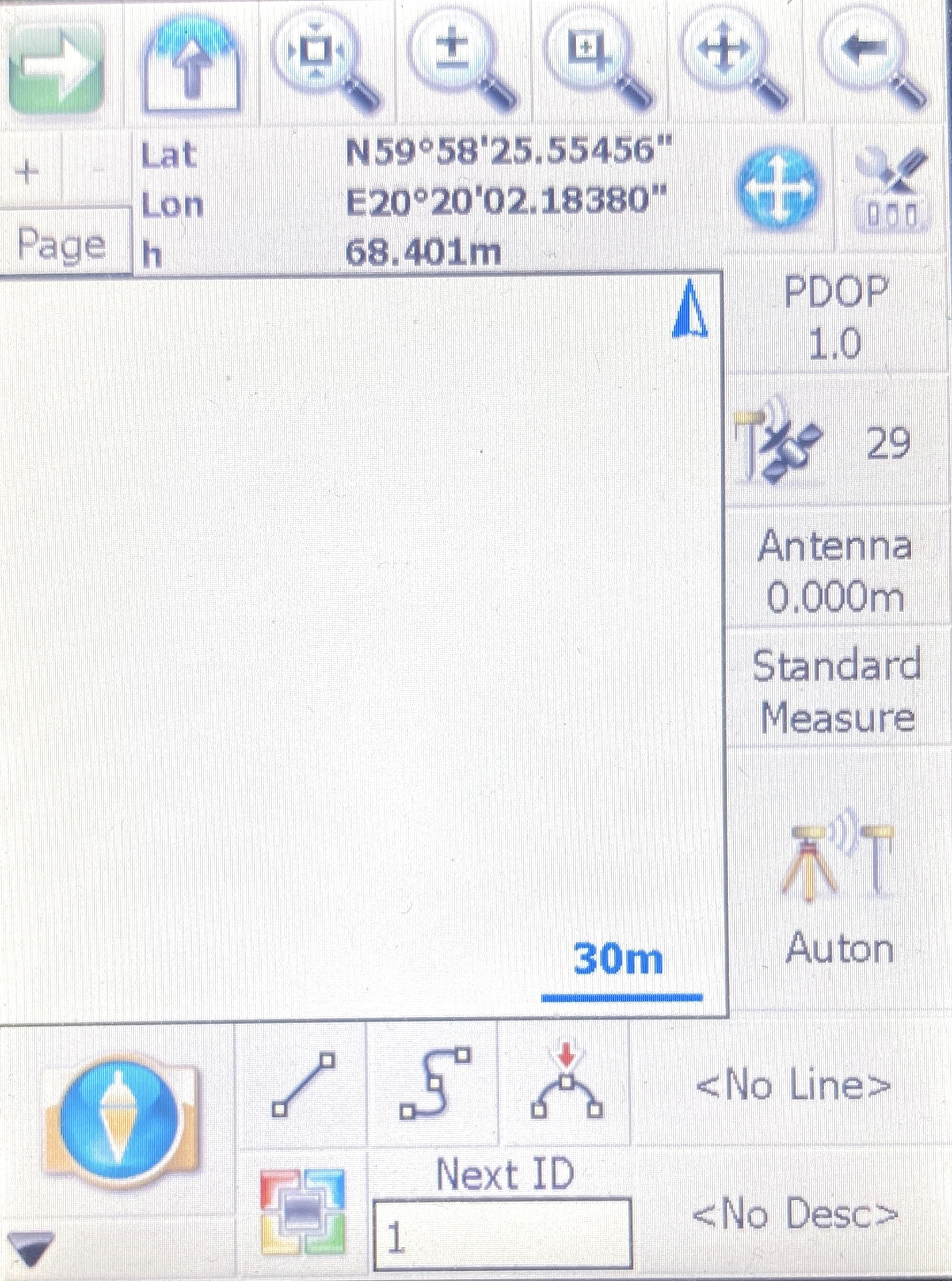

If the connection is successful, the position will be displayed with a number of satellites and PDOP.
Once you have established the connection between Reach RX2 and FieldGenius, you will be prompted to the main screen.

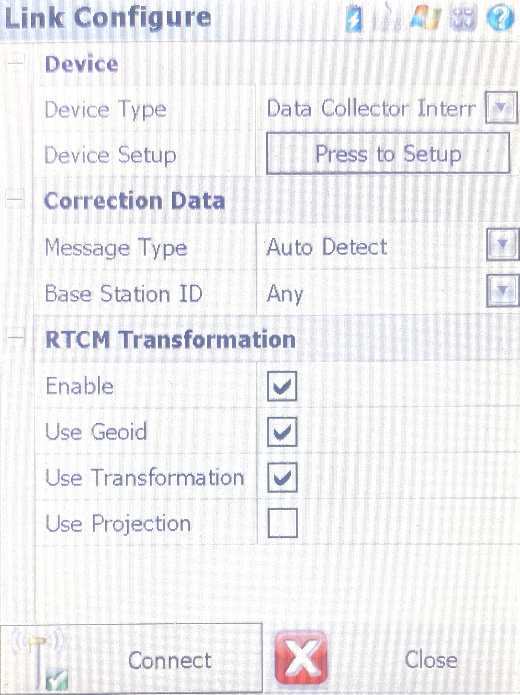

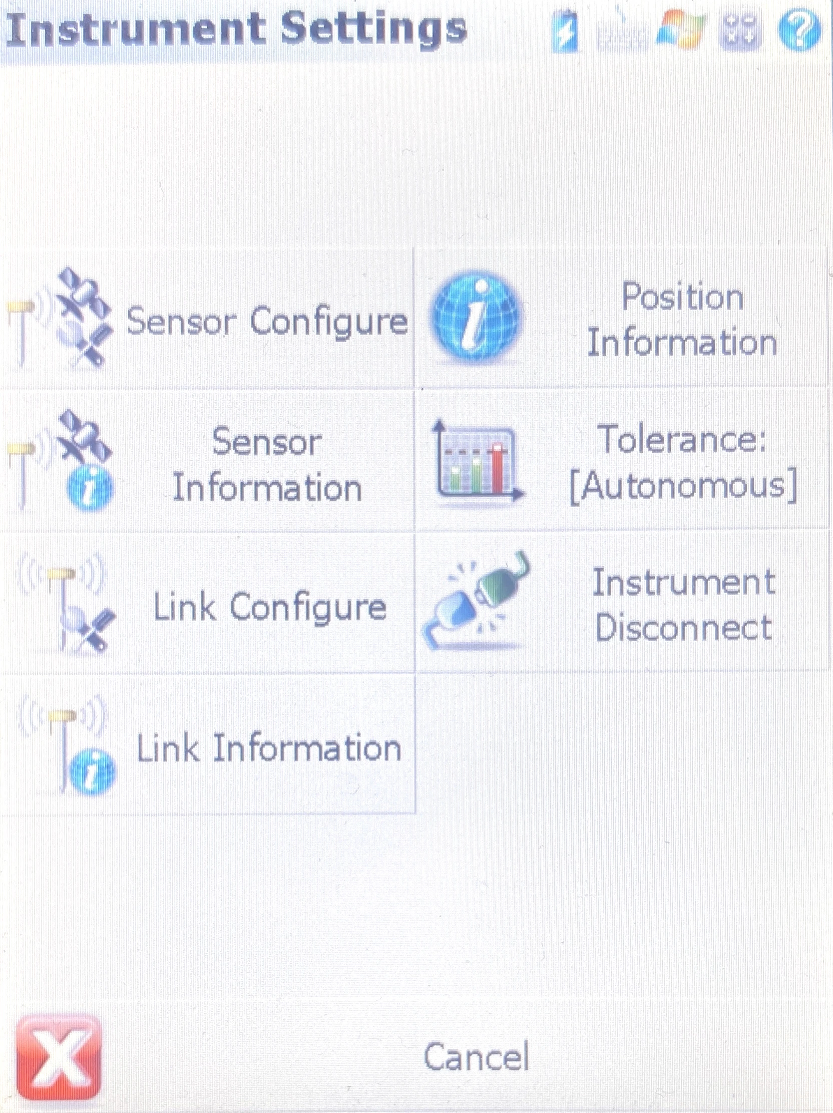

  1. Go to Instrument Settings.
  1. Choose Link Configure.

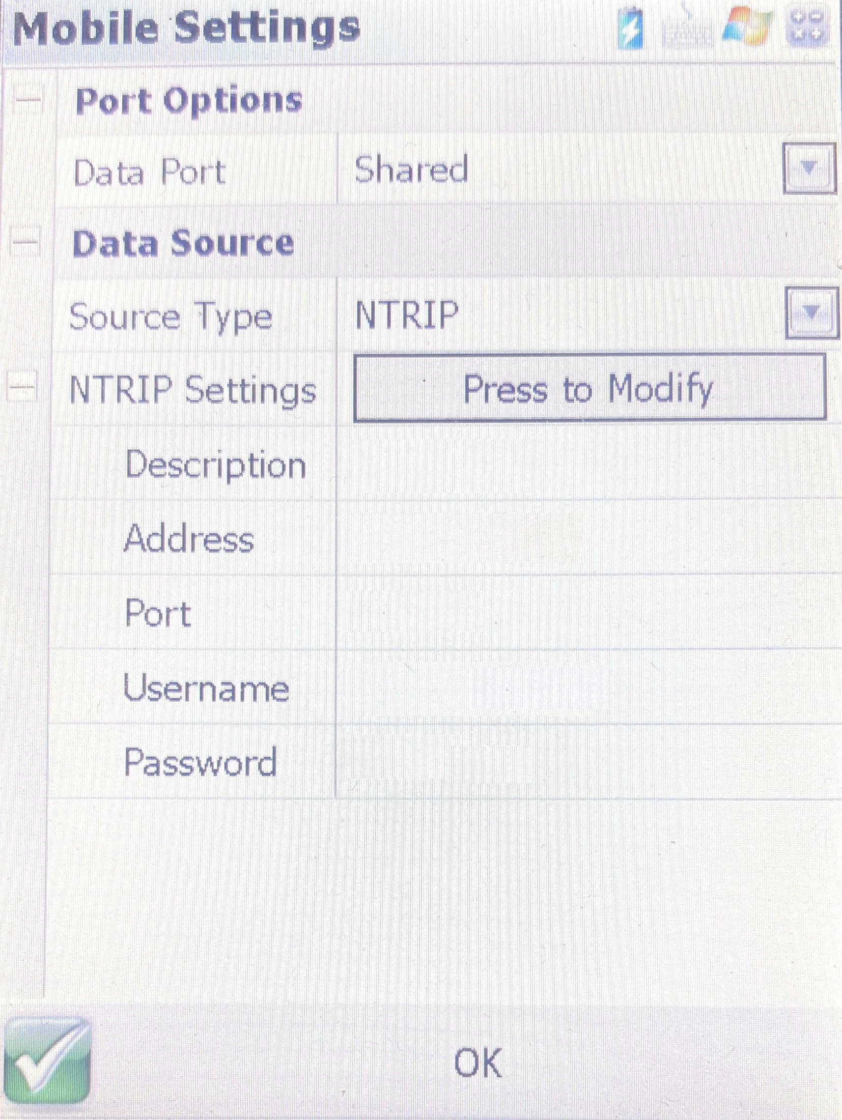

  2. Select Data Collector Internet in Device Type and click Press to Set up.

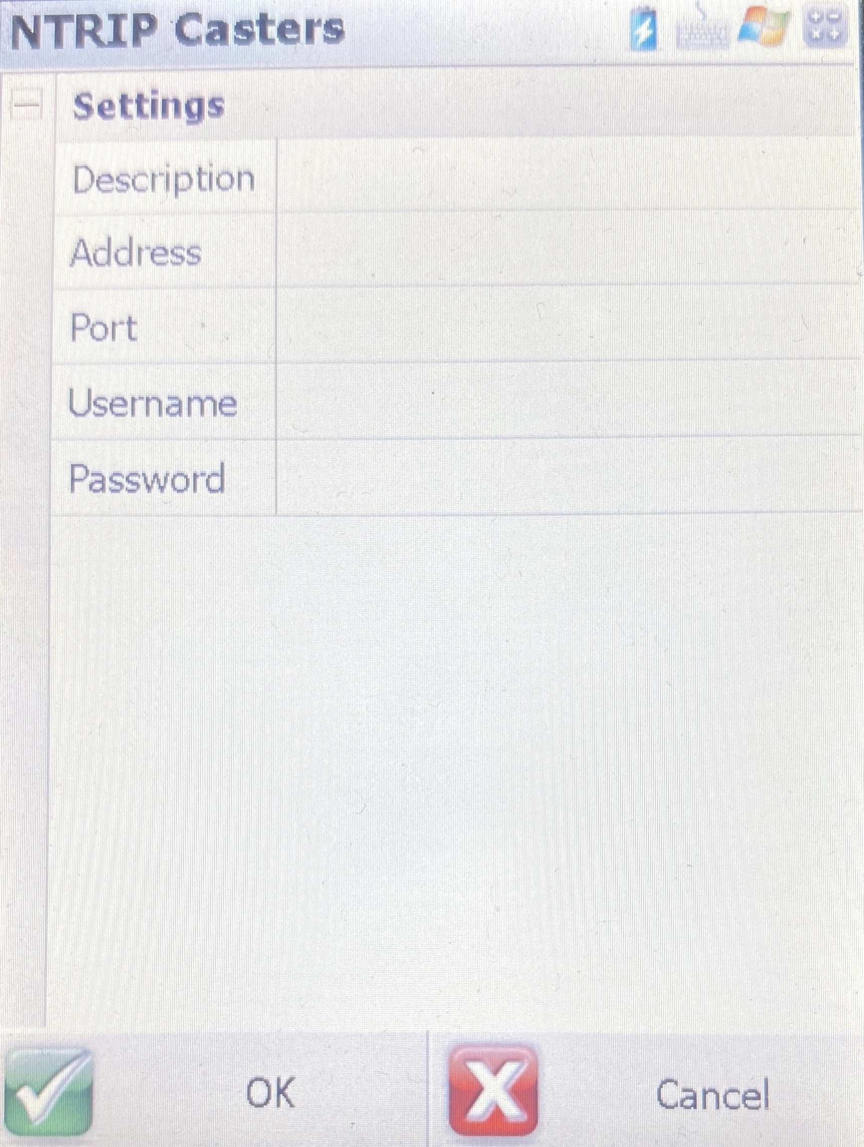

  1. In the dialog window, click Press to Modify.
  1. In the NTRIP Casters dialog, click Add and fill in the information from your NTRIP provider. Click OK.
  1. Select the created NTRIP caster and click OK to finish the setup.

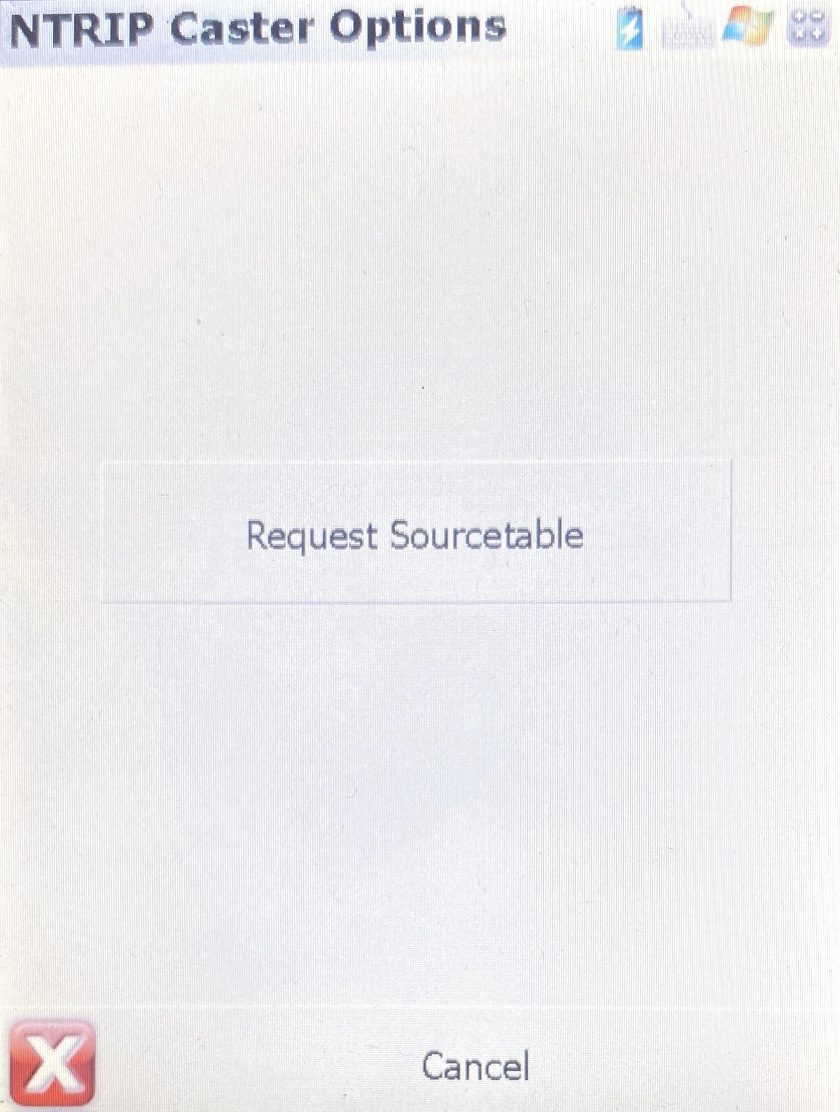

  2. In the Link Configure dialog, click Connect.

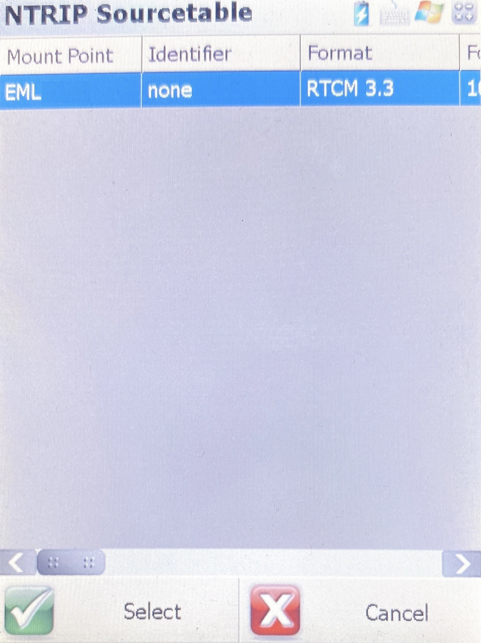

  3. Once connected to the Internet, request the sourcetable, choose the mount point and click Select to choose.

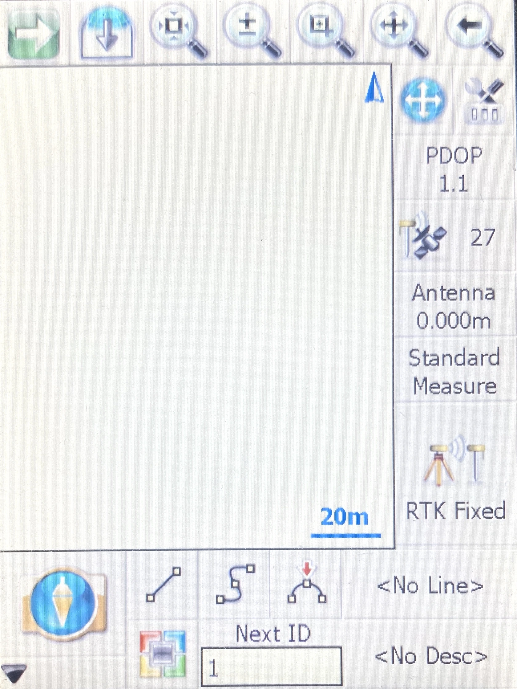

In a moment, you will see the solution status in the FieldGenius interface. It should be RTK Fixed.
You can also check the solution status in Emlid Flow—the Status LED should become solid green.
