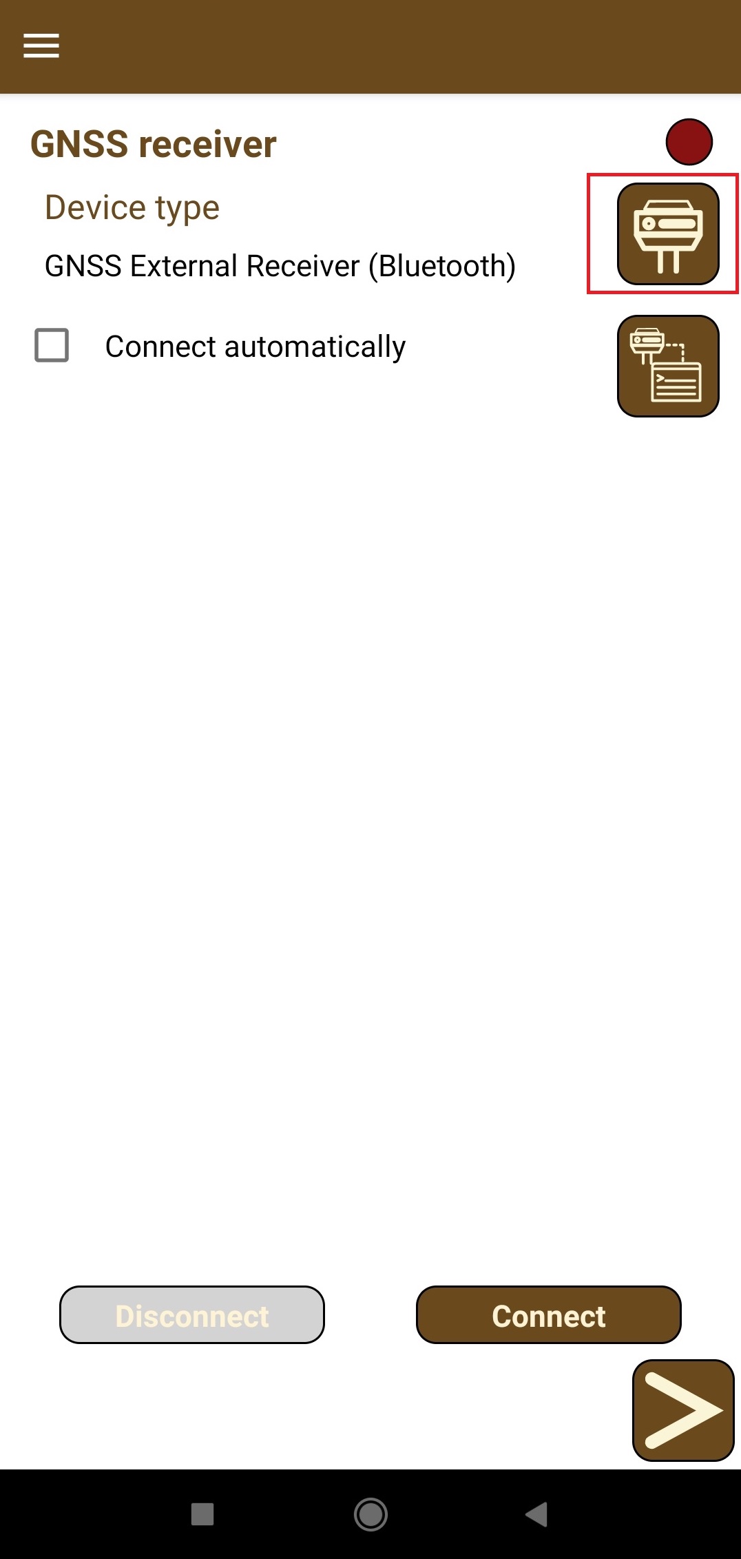

  1. Open the Aplitop TcpGPS app and tap the receiver icon next to Device type.

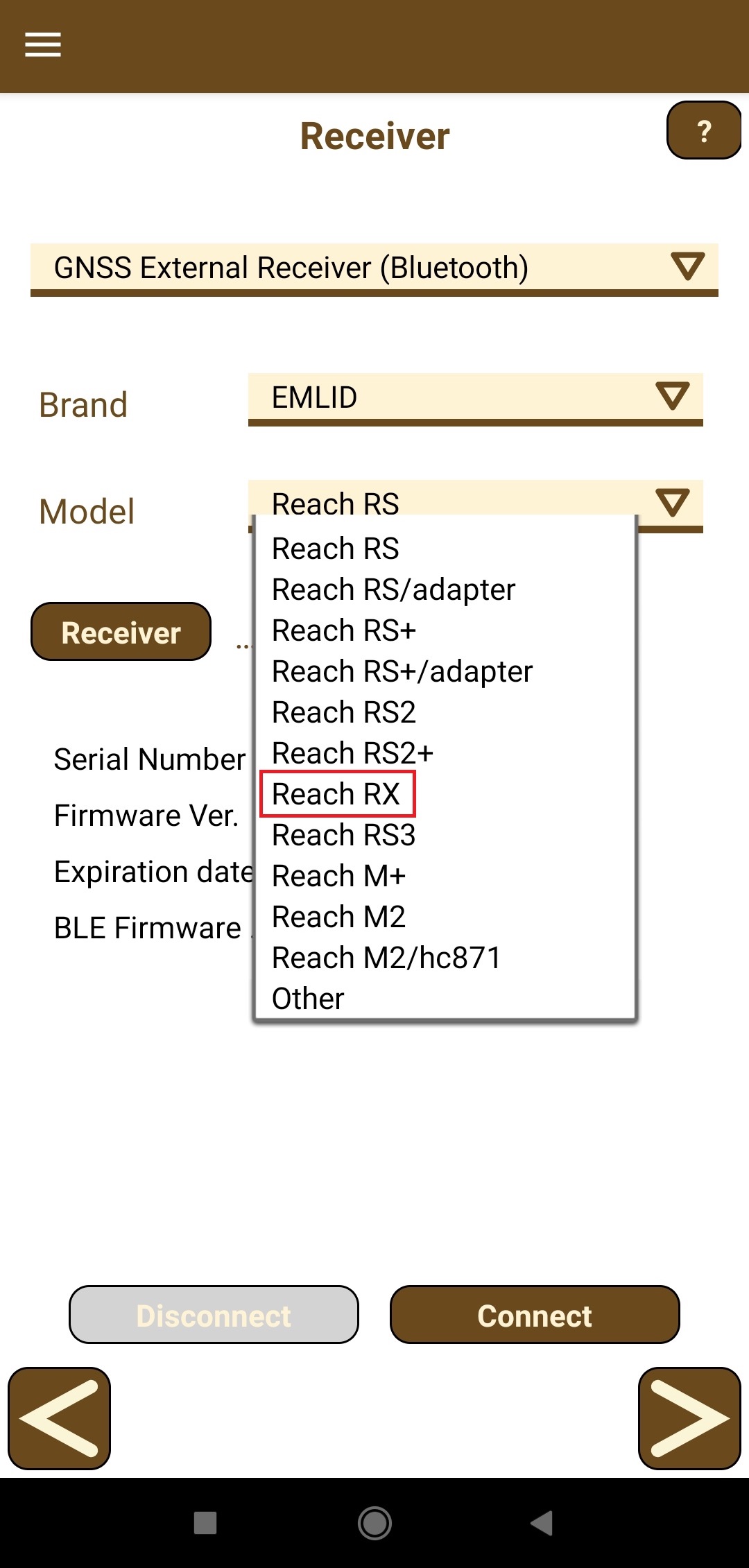

  2. On the opened screen, select the following:
    • GNSS External Receiver (Bluetooth) for Device type
    • EMLID for Brand
    • Reach RX2 for Model

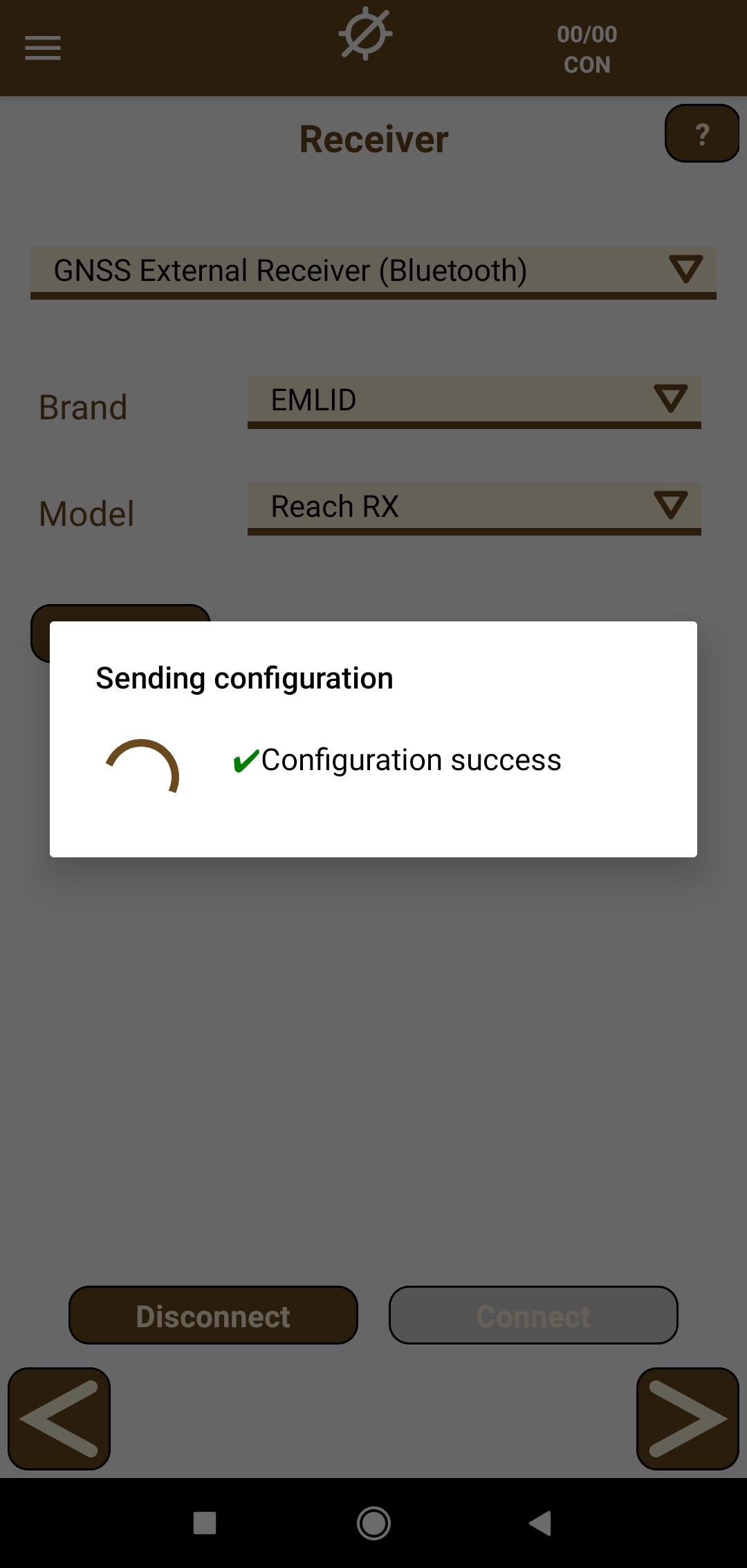

  3. Tap the Receiver button and select the Bluetooth device. If the receiver is not on the list, tap the Search button.
  4. Tap the Connect button and wait for the configuration of Reach.

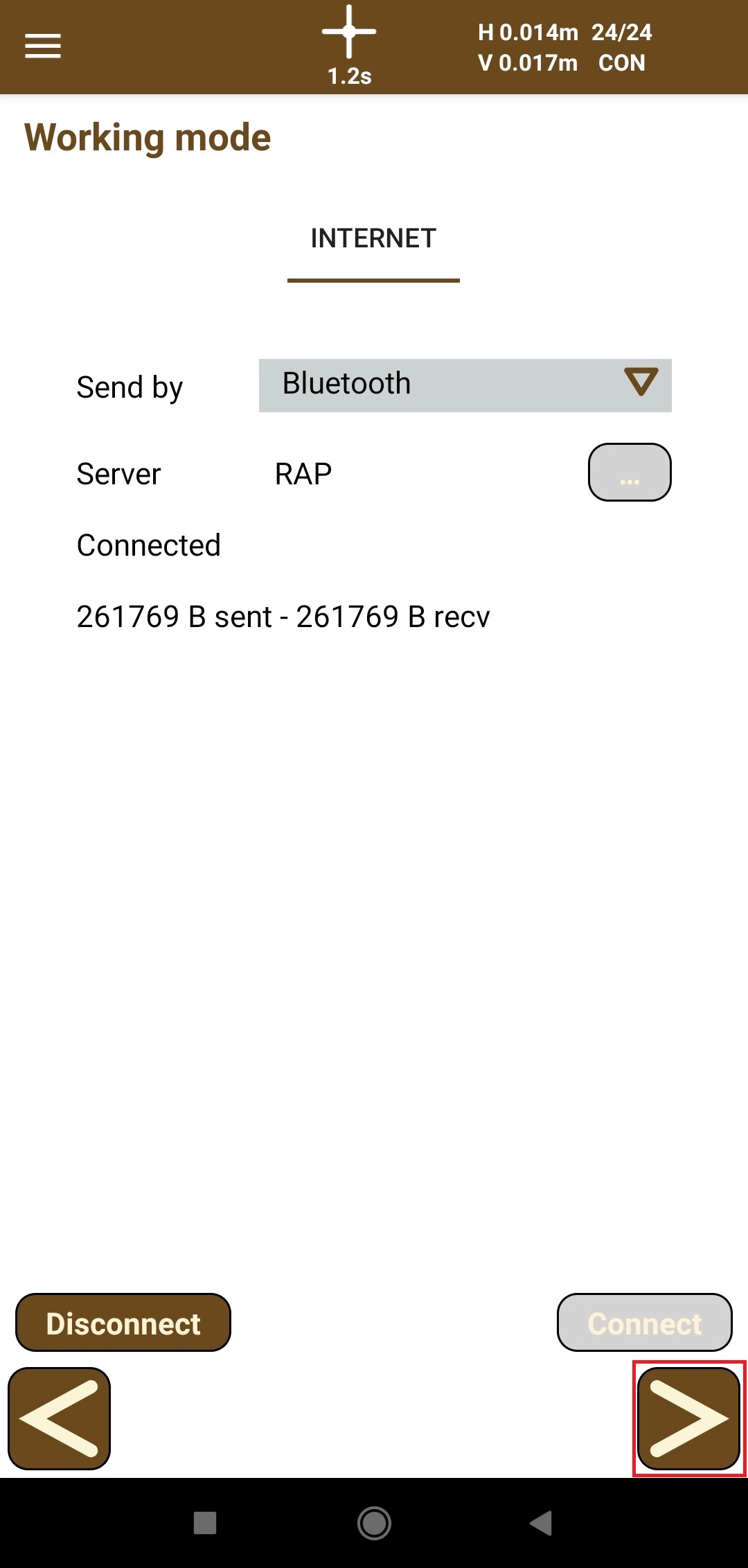

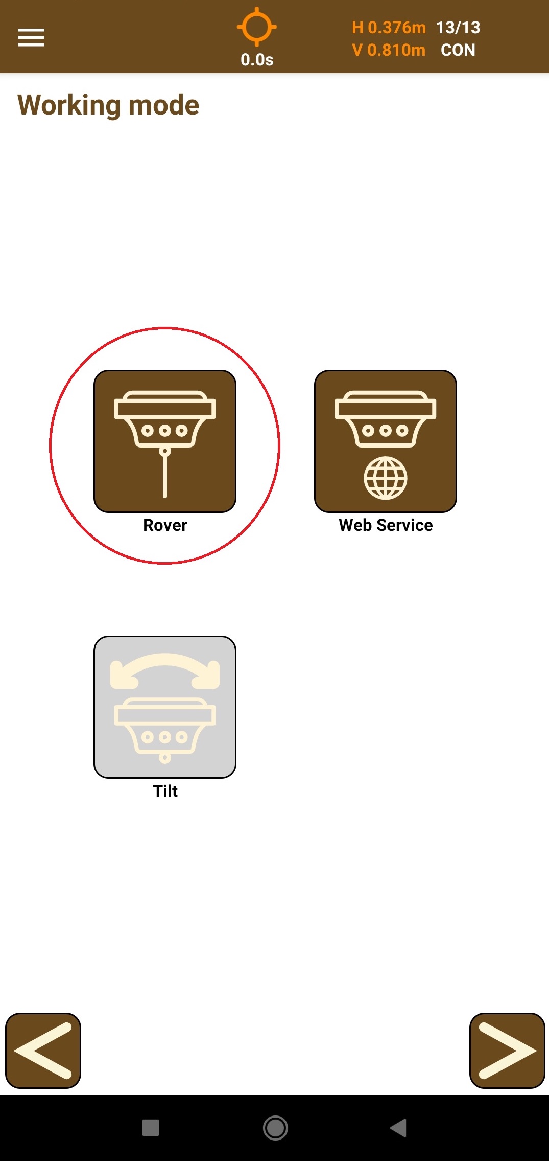

  5. Tap the forward arrow button and on the opened Working mode screen, tap the Rover button.

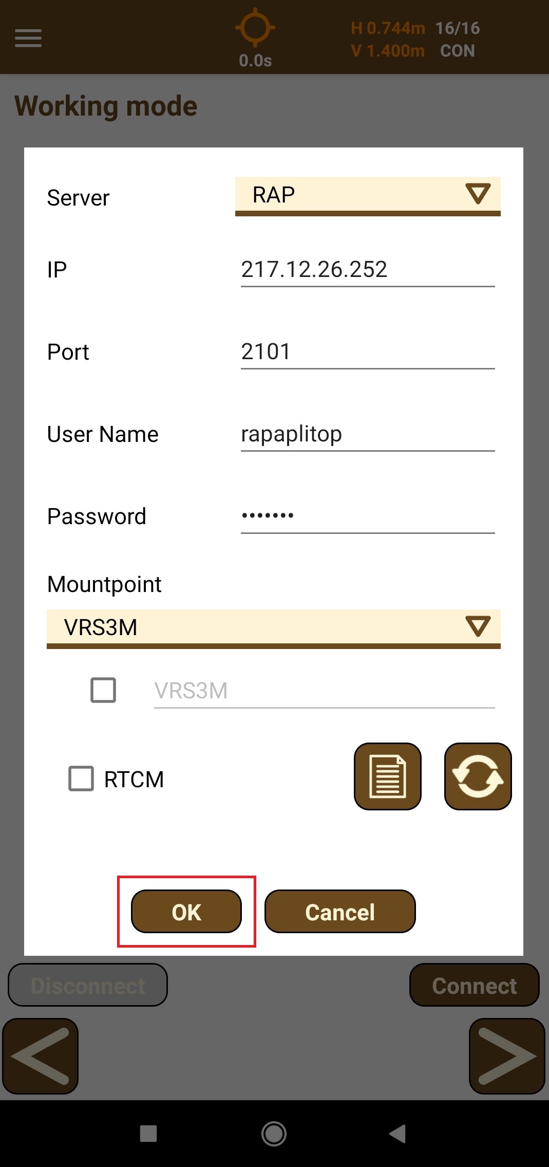

  6. Configure NTRIP to send RTK corrections over Bluetooth.

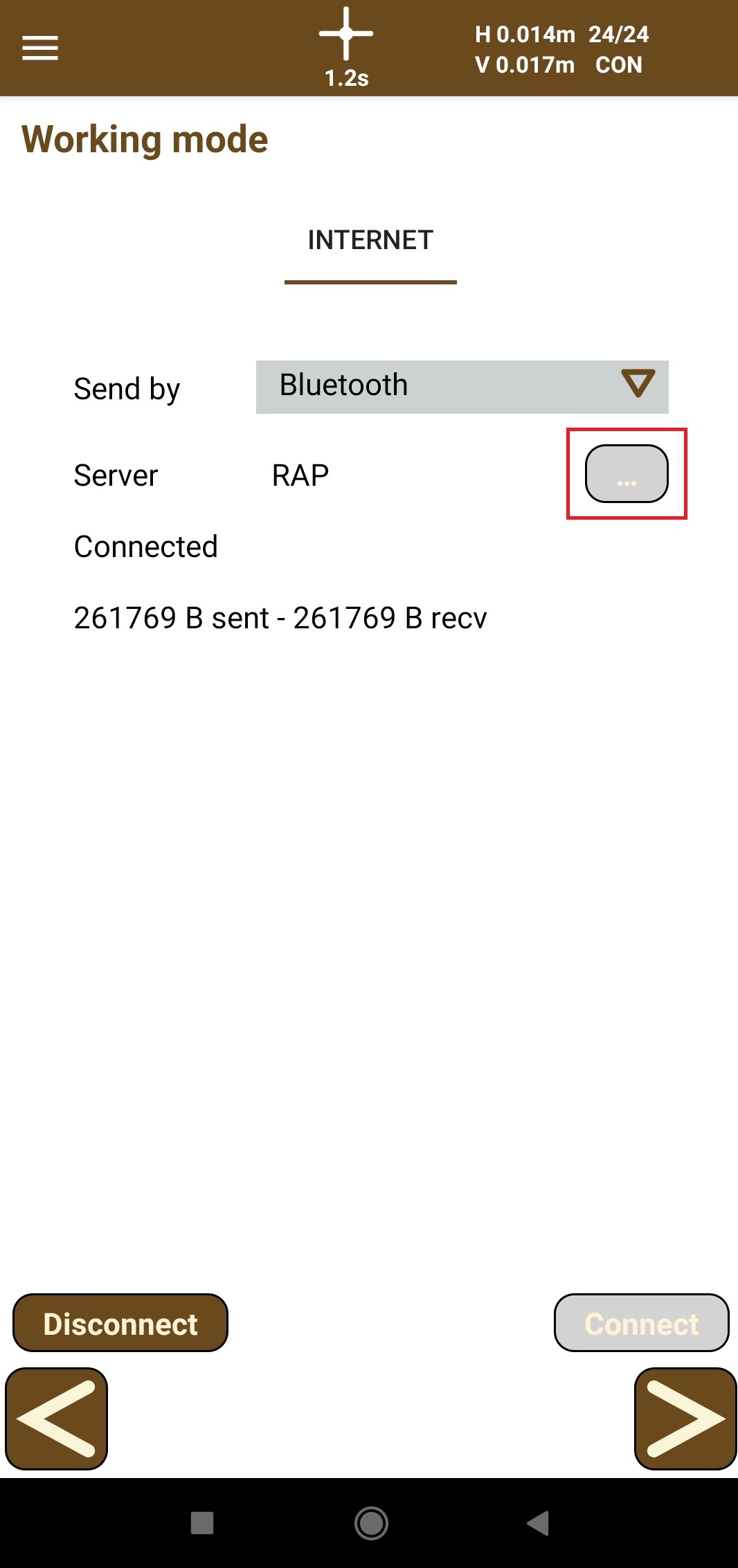

  7. To set up the NTRIP server, tap the three dots button and specify the following parameters:
    • Name of the profile
    • IP
    • Port
    • User name
    • Password
    • Mountpoint
    After that, tap the OK button.
  8. Tap the Connect button and check that the number of bytes sent and received grows.

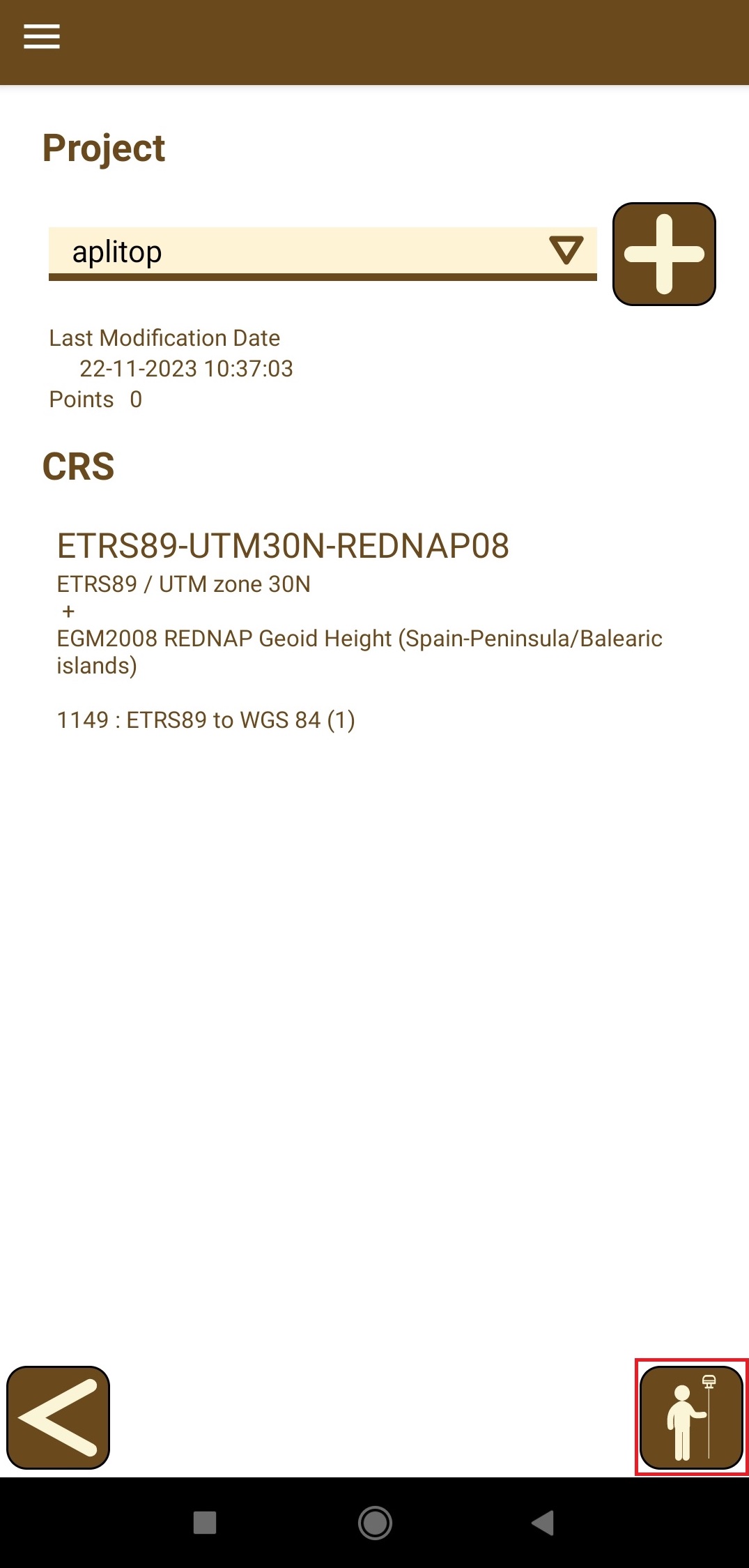

  9. Tap the forward arrow button and select or create a project.

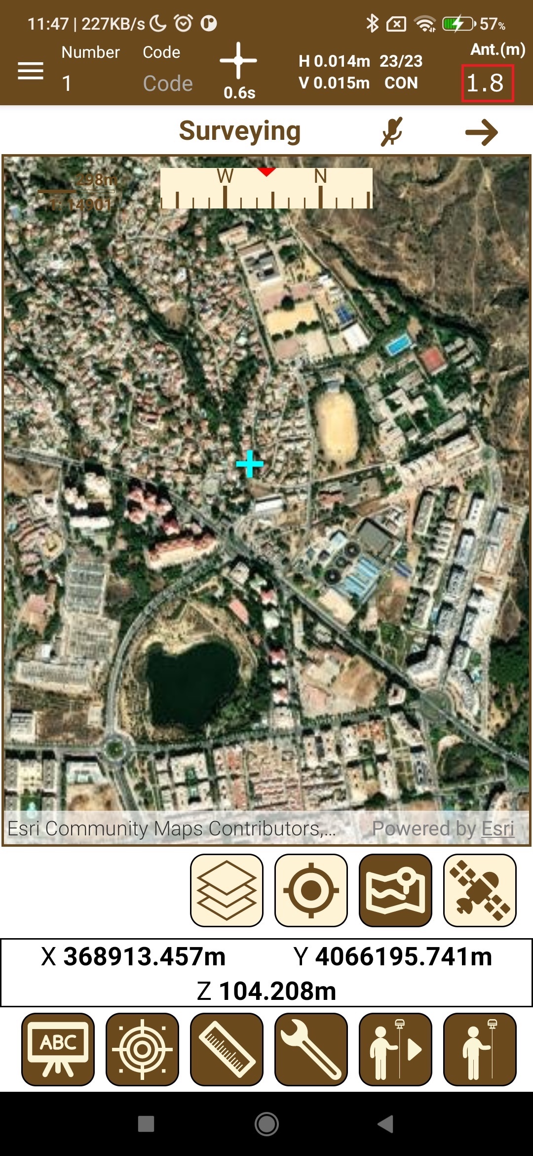

  10. Tap the survey button, enter the antenna height on the right side of the status bar, and start working with TcpGPS for Android and Reach RX2.
