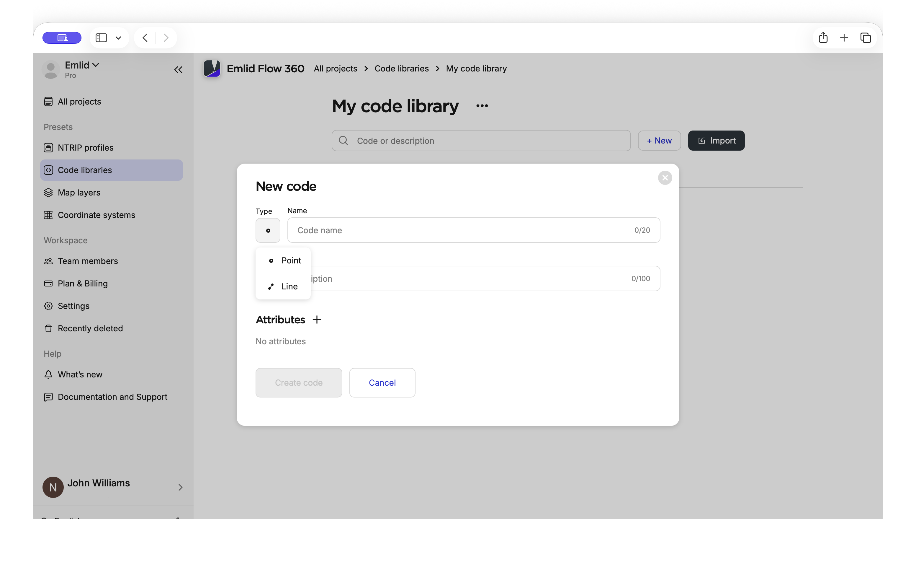

If you forgot to add some codes that you need in the field, you can easily create codes on the go in Emlid Flow.

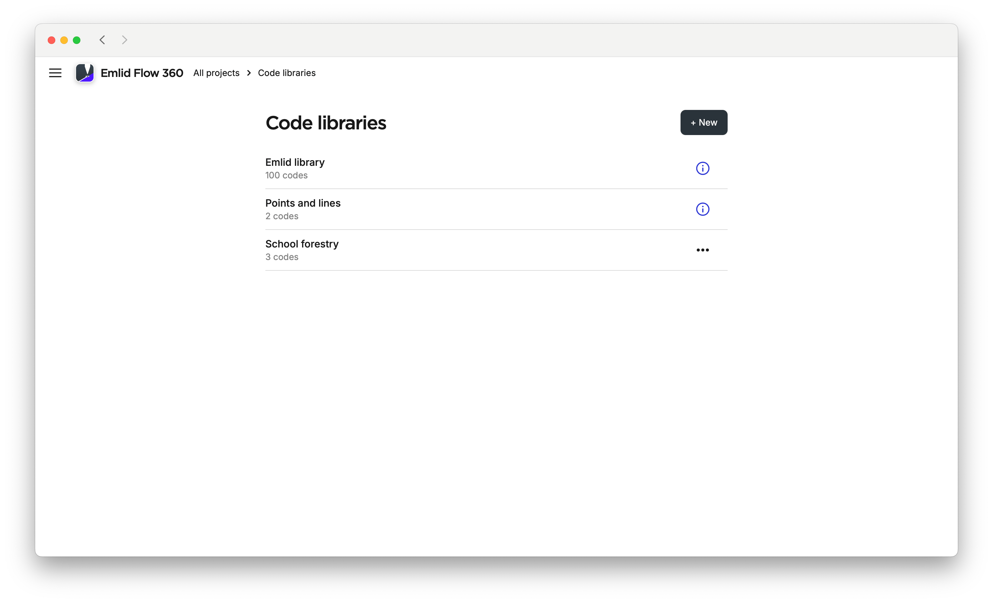

  1. In the menu on the left, click Code libraries.

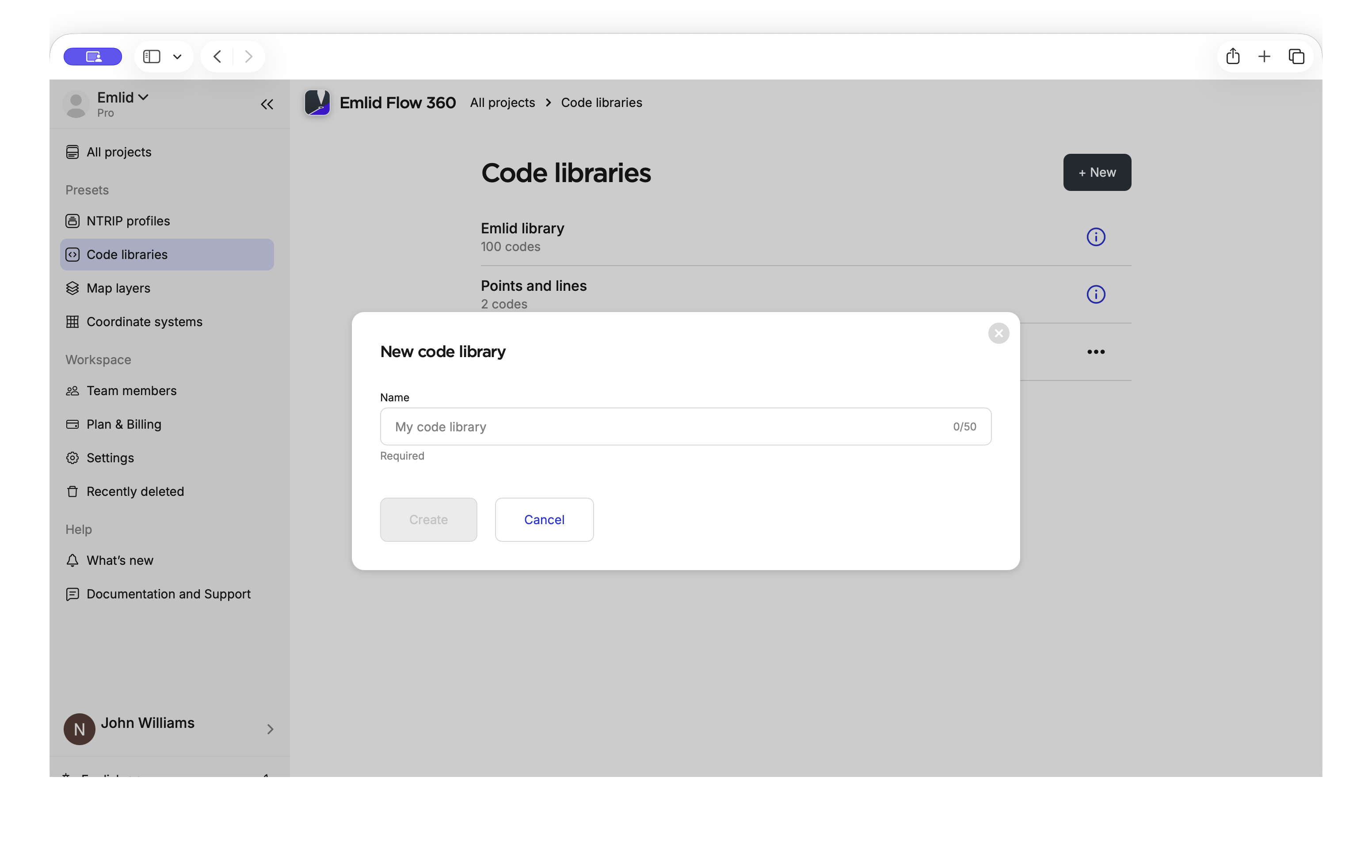

  2. Click + New.
  3. Name your library and click Create.

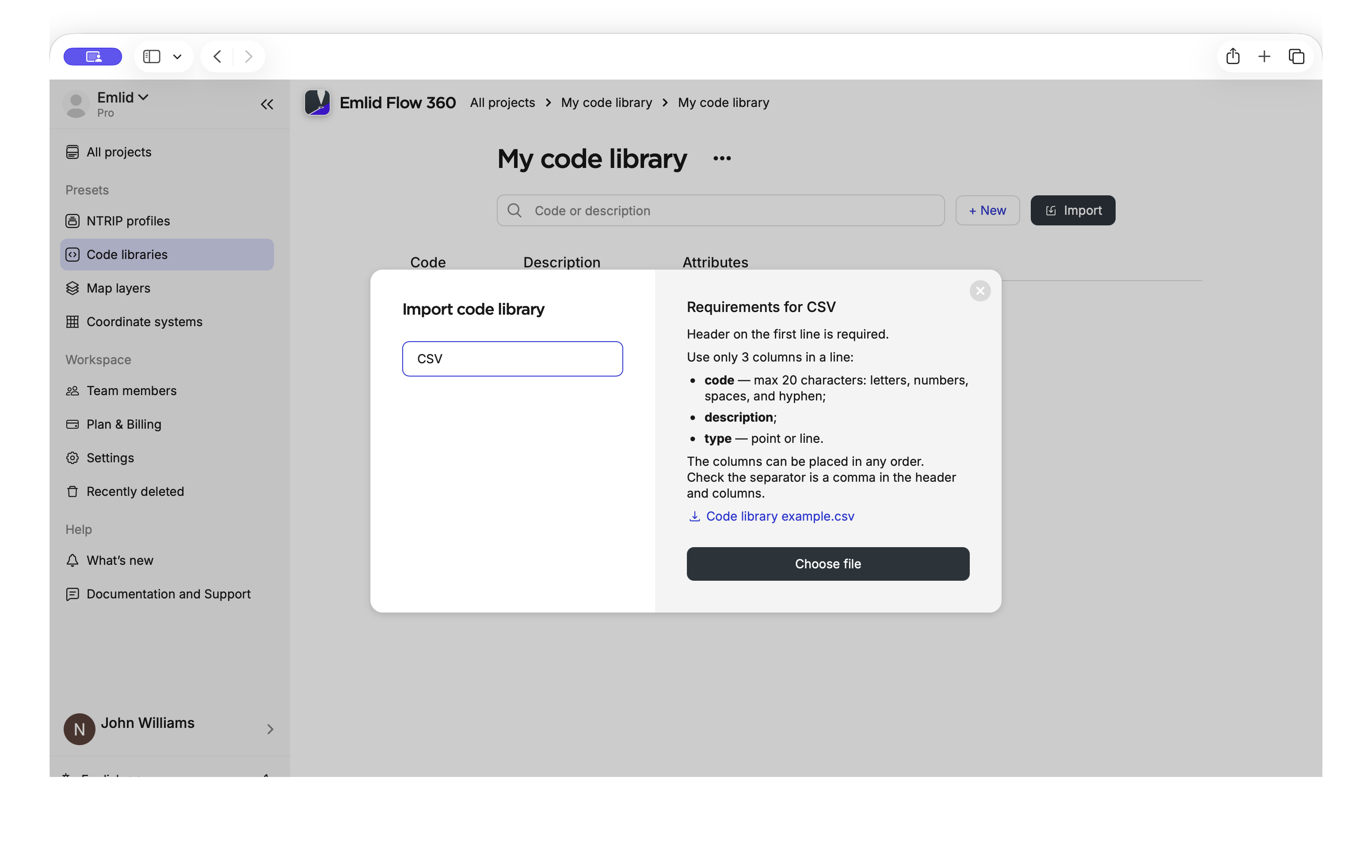

  4. To add survey codes to your library, click the Import button.
  5. Import the file with survey codes by clicking Choose file. When the library is imported, you will see the confirmation sign.

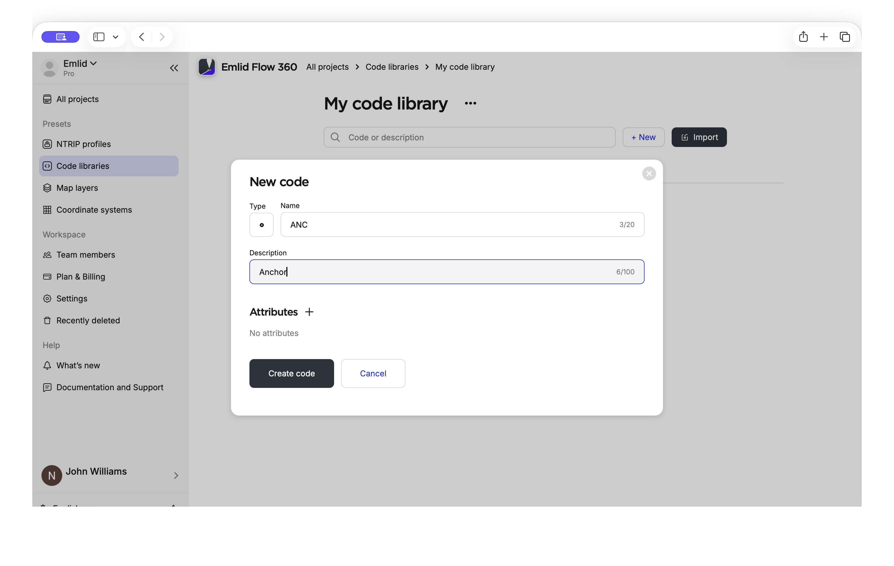

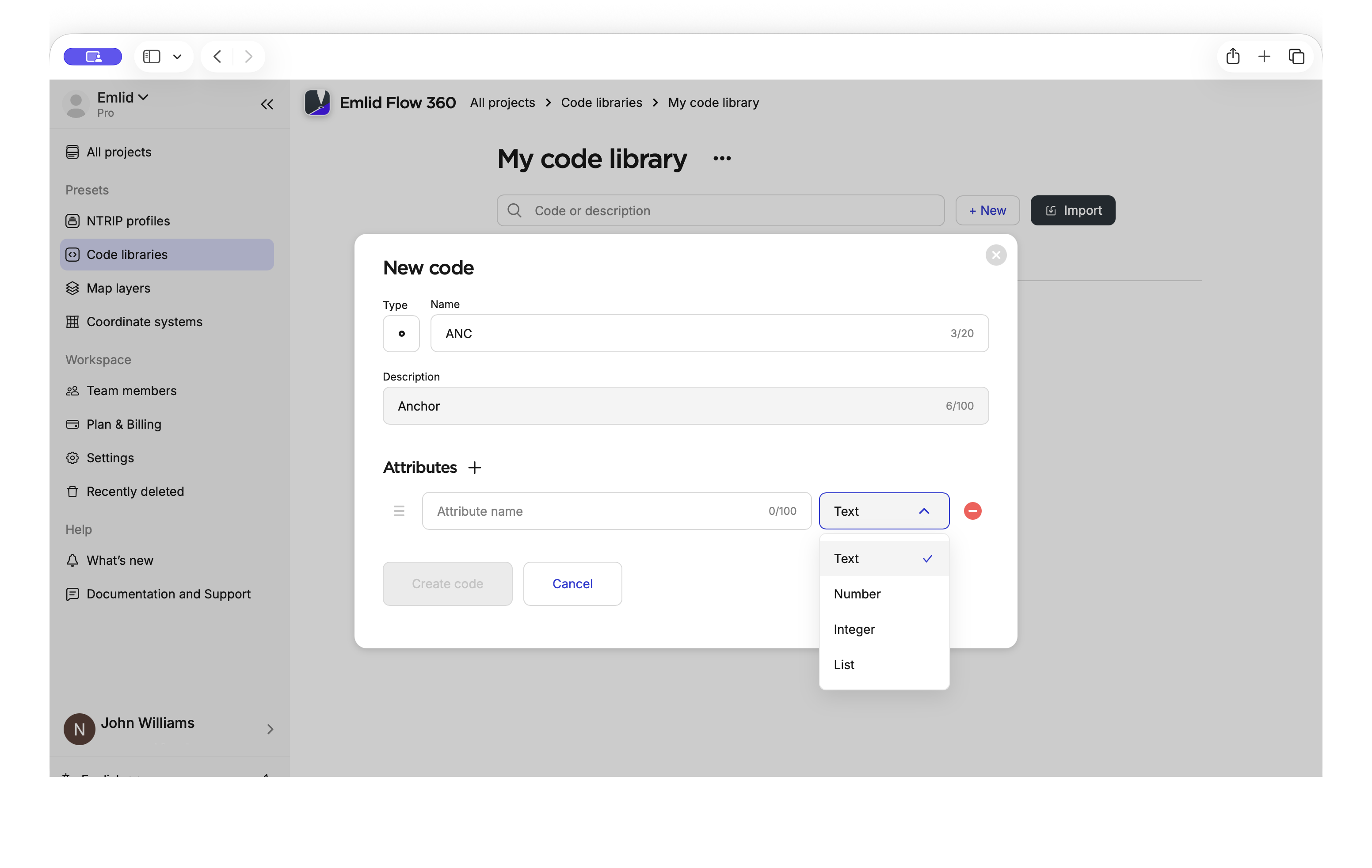

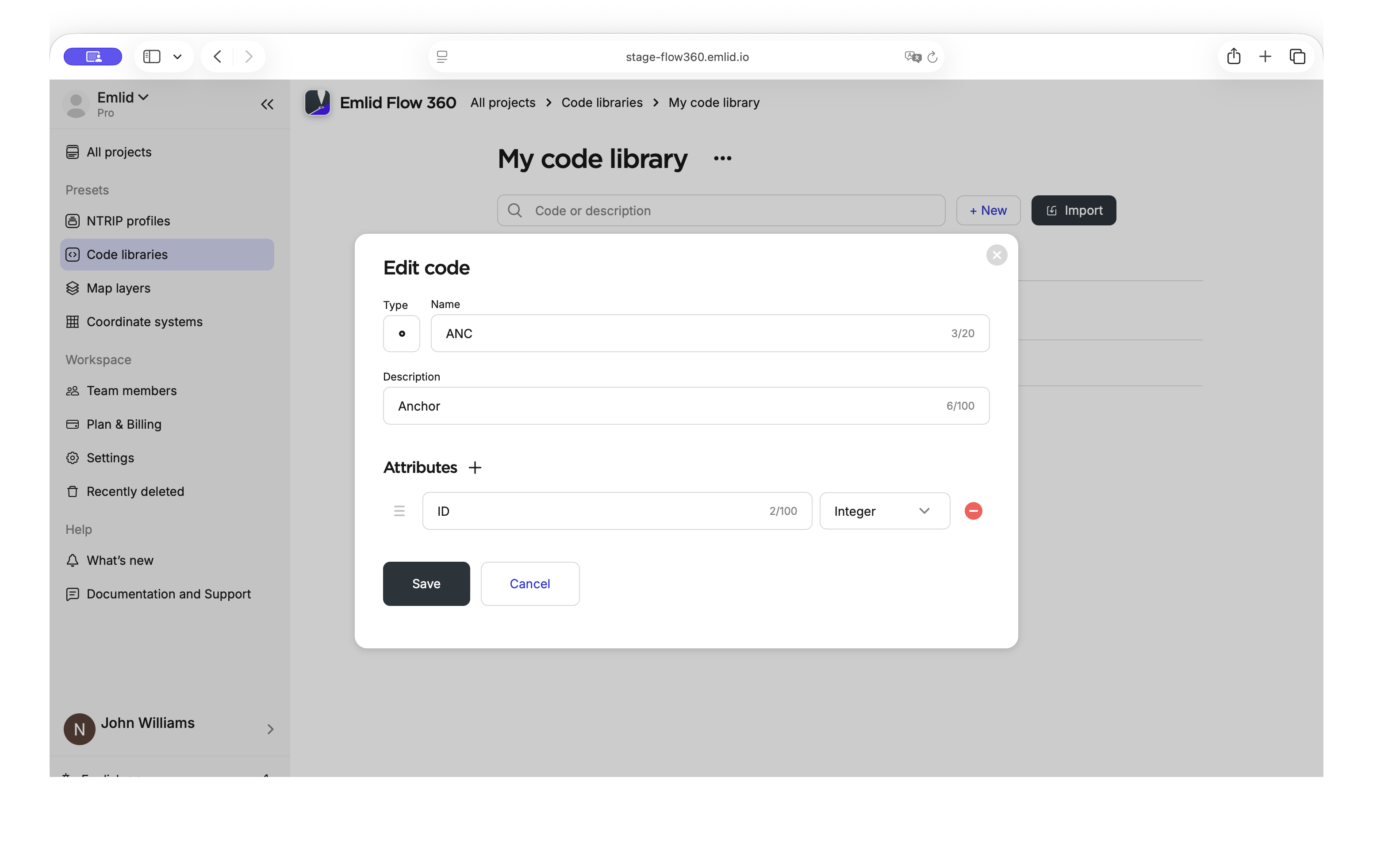

Adding codes to existing code libraries

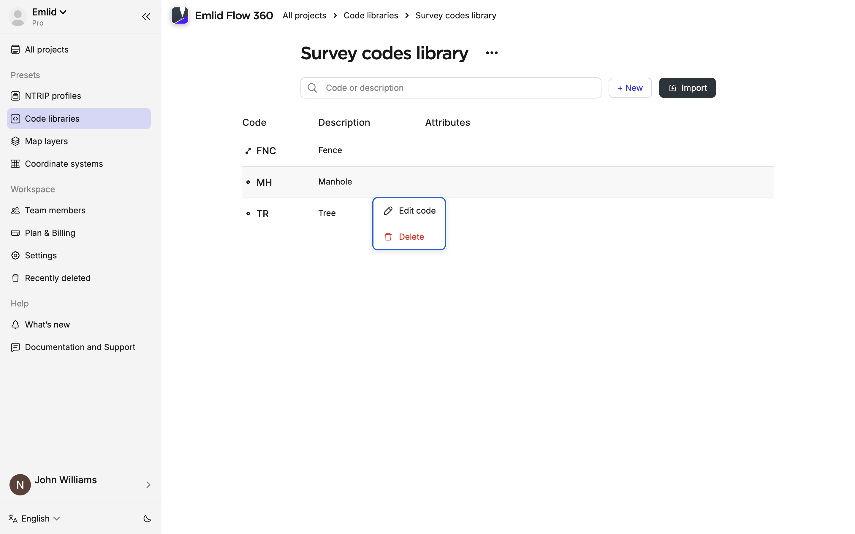

You can add new codes only to the libraries created by you.
To add new codes to your existing code libraries, do the following:

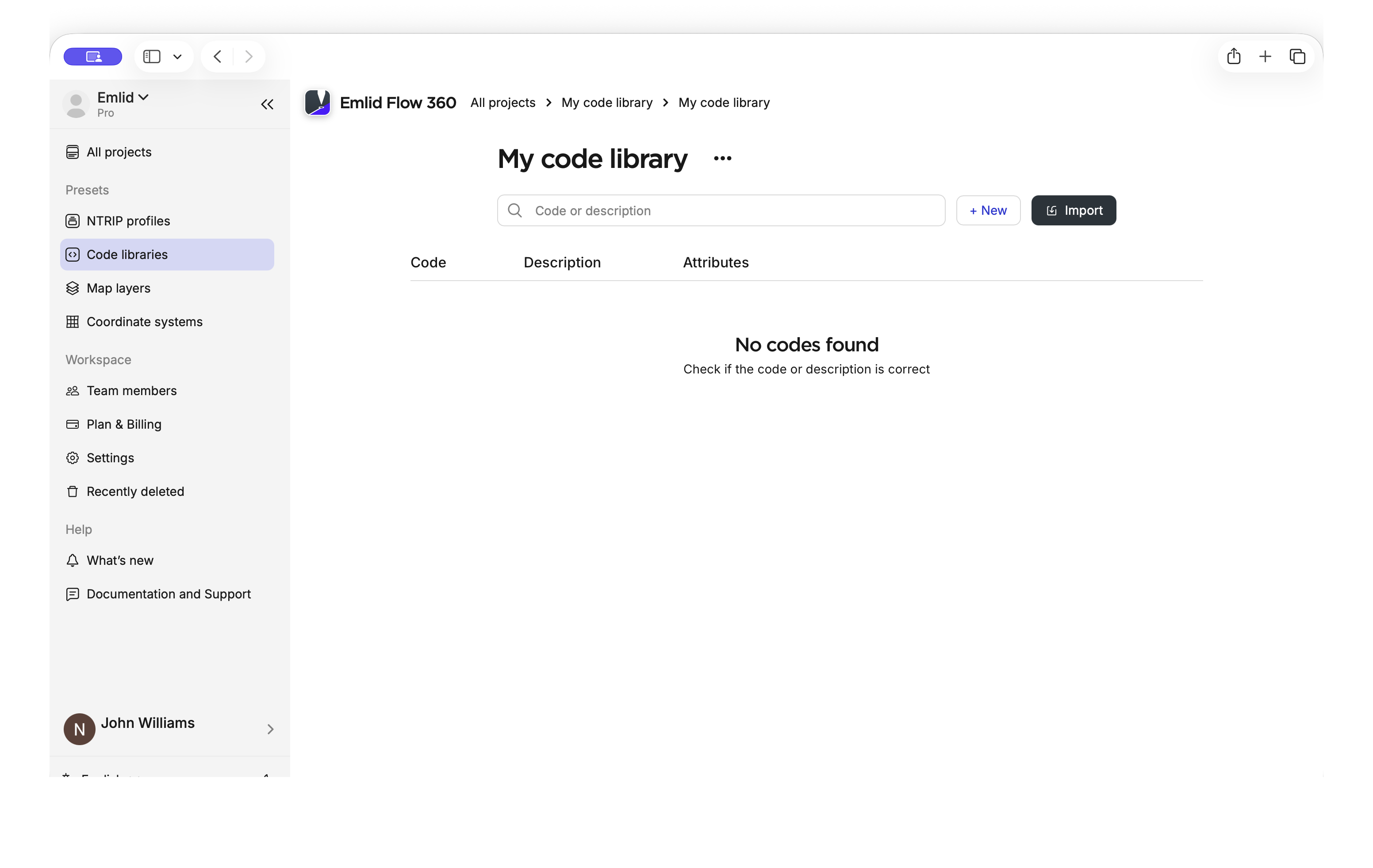

  1. Navigate to the My code libraries screen.
  2. Select the library where you want to add new codes.
  3. To add new codes, click Import.
  4. Import the file with new survey codes by clicking Choose file. When the codes are imported, you will see the confirmation sign.
    A single code library can’t contain two survey codes with the same code name. Before adding new codes to your library, make sure the file you’re uploading doesn't duplicate the already existing codes.
Once you added new codes to your code library, the code library will be updated with new codes among all your devices.
