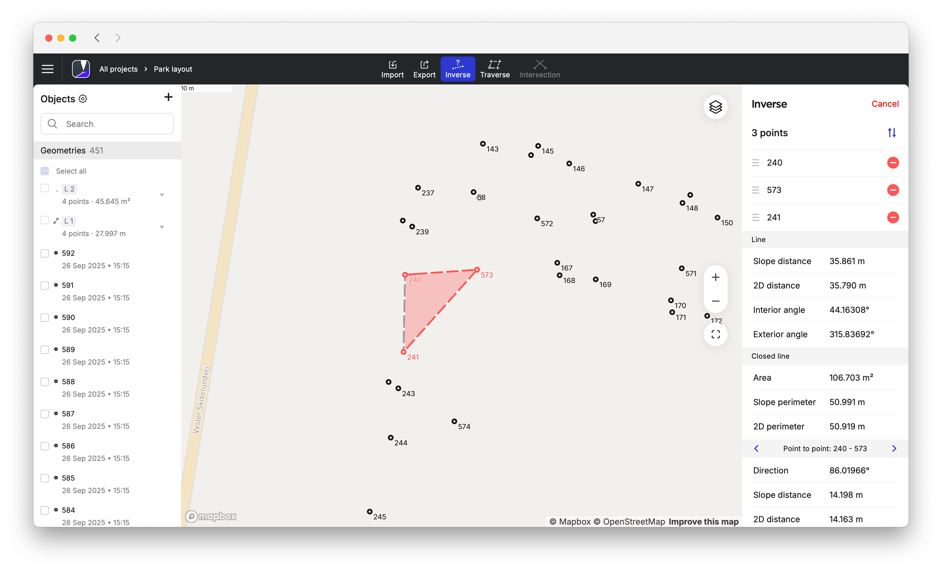

To apply the Inverse tool in the Emlid Flow 360 app, follow these steps:
Open the project in Emlid Flow 360.
Tap Inverse at the top of the screen to calculate the results.
Select the points you want to calculate the inverse for from the map or Objects list.
tipIn Emlid Flow & Emlid Flow 360 you can also find the point-to-point, line, and closed line information for each line. To see this information, just tap on the line.
Find the calculated results on the right side of the screen. To calculate results for more than two points, use the arrow buttons to switch to a different set of two points.
noteThe displayed results will be different depending on the selected points. If you select 2 points, you'll see the point-to-point calculations. If you select 3 points, you'll also see the calculations on the
area,Area of an object is the total amount of space enclosed by its shape on flat surface.
slope perimeter,Slope perimeter of an enclosed object is the sum of slope distances of its sides with the height difference consideration.
slope distance, interior and exterior angle, etc.Slope distance from point A to point B is the length of the straight line AB, measured along the slope, taking the height difference between the points into account.
noteYou can only use Closed line and Line for geometry measurements. It is not possible to import or export them as geometrical figures.
tipYou can change the order of the points in the Inverse section by dragging and dropping them. To delete a point, tap the delete button.
To exit the Inverse calculation mode, tap Cancel in the upper-right corner.

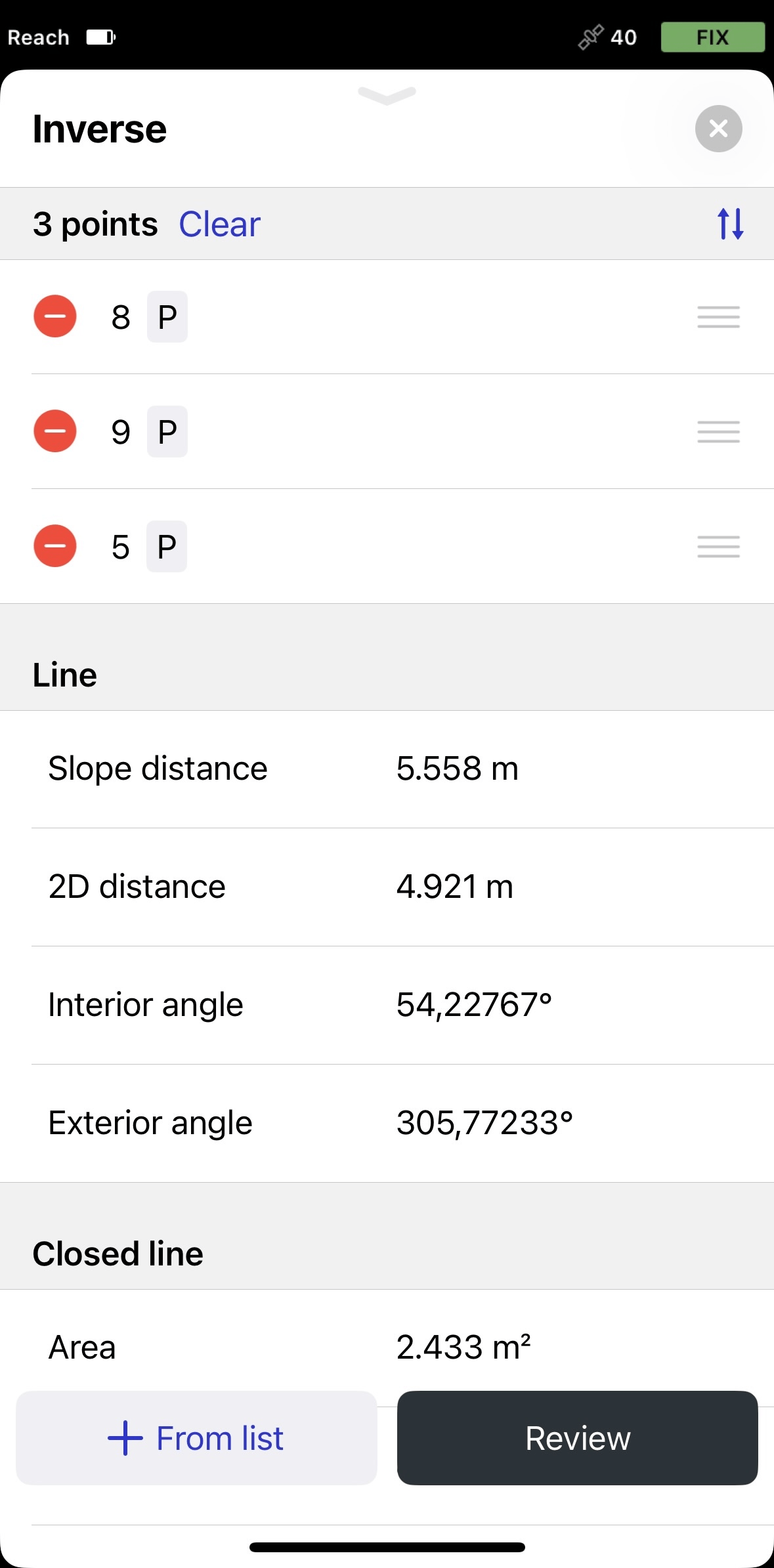

To apply the Inverse tool in the Emlid Flow app, follow these steps:
Open the project in Emlid Flow.
Tap the tools button at the bottom left corner of the screen.
Tap Inverse.
Click Review to see the calculated results. To calculate results for more than two points, use the arrow buttons to switch to a different set of two points.
noteThe displayed results will be different depending on the selected points. If you select 2 points, you'll see the point-to-point calculations. If you select 3 points, you'll also see the calculations on the area, slope perimeter, 2D perimeter, interior and exterior angle.
To exit the Inverse calculation mode, tap the close button in the upper-right corner.
