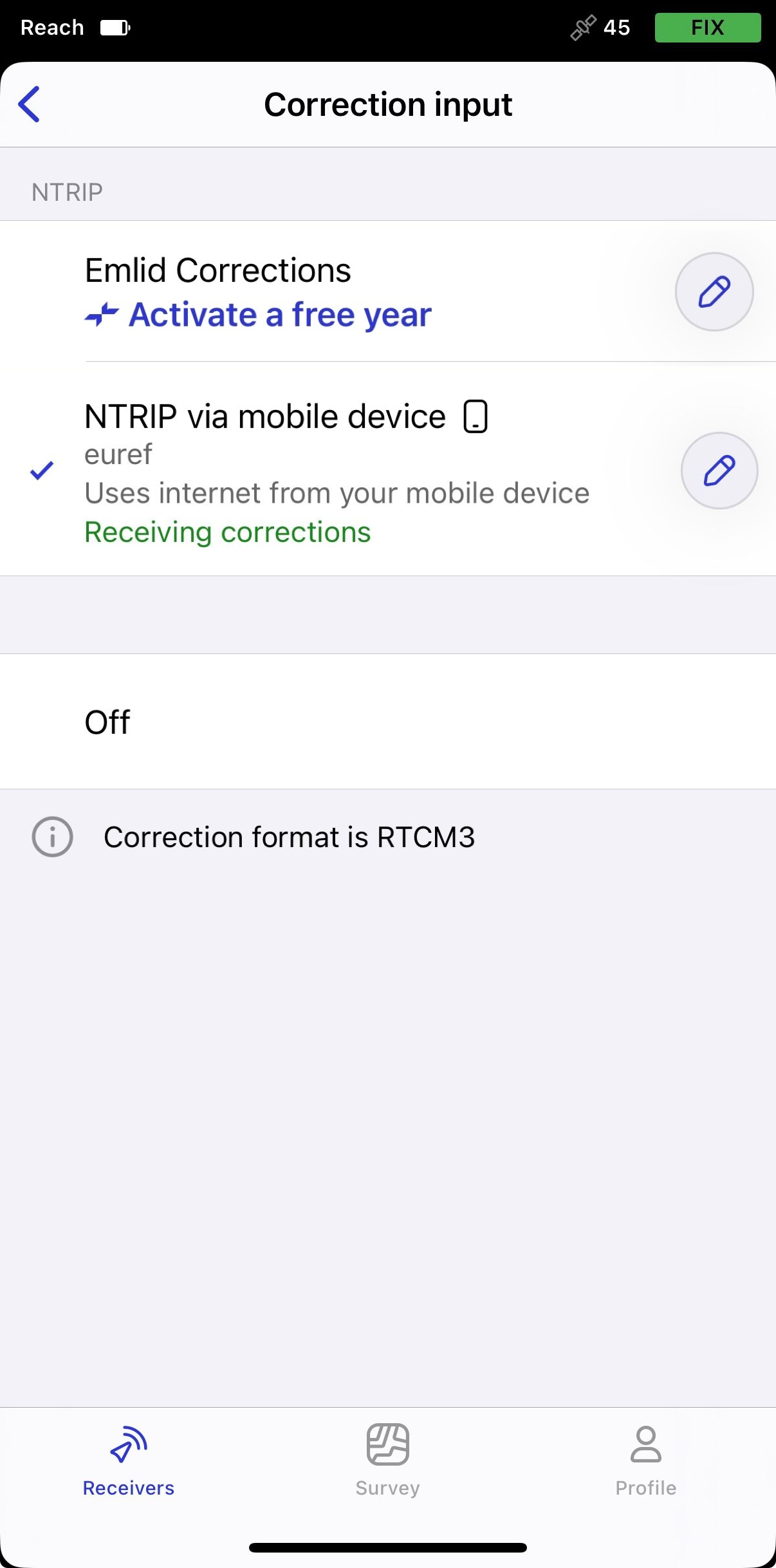

To achieve centimeter-level accuracy when surveying with Reach RX, set up your receiver to receive NTRIP corrections in the Emlid Flow app. Do as follows:

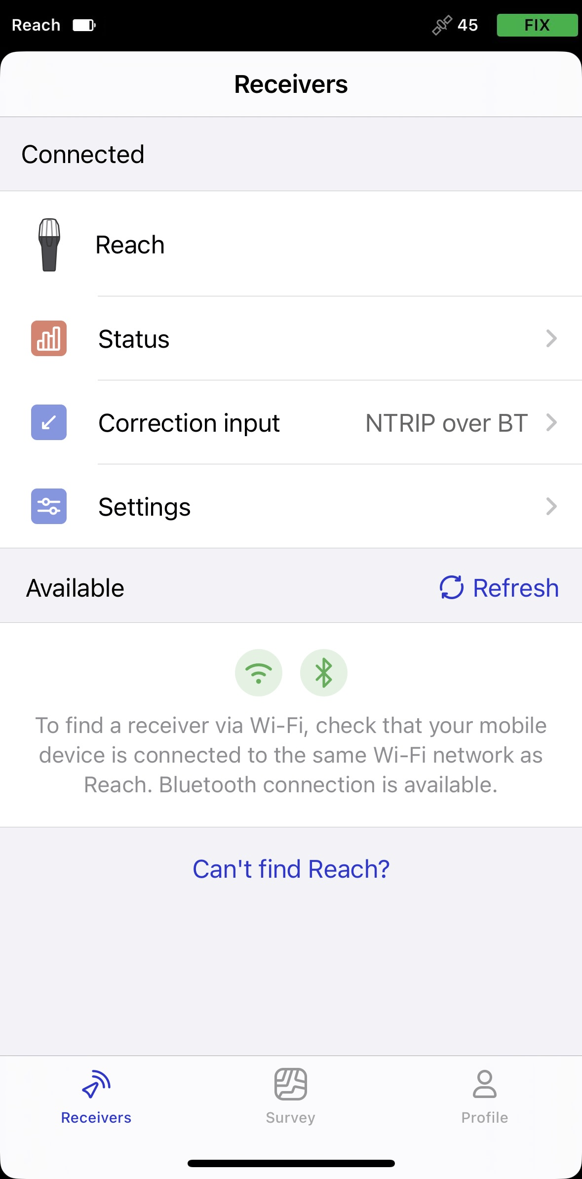

  1. Open Emlid Flow and connect to your Reach.
  2. Go to Correction input and tap NTRIP over mobile device.
  3. Tap the Edit button to configure receiving corrections from the NTRIP base.
    To start receiving corrections, make sure that your receiver has satellite visibility.

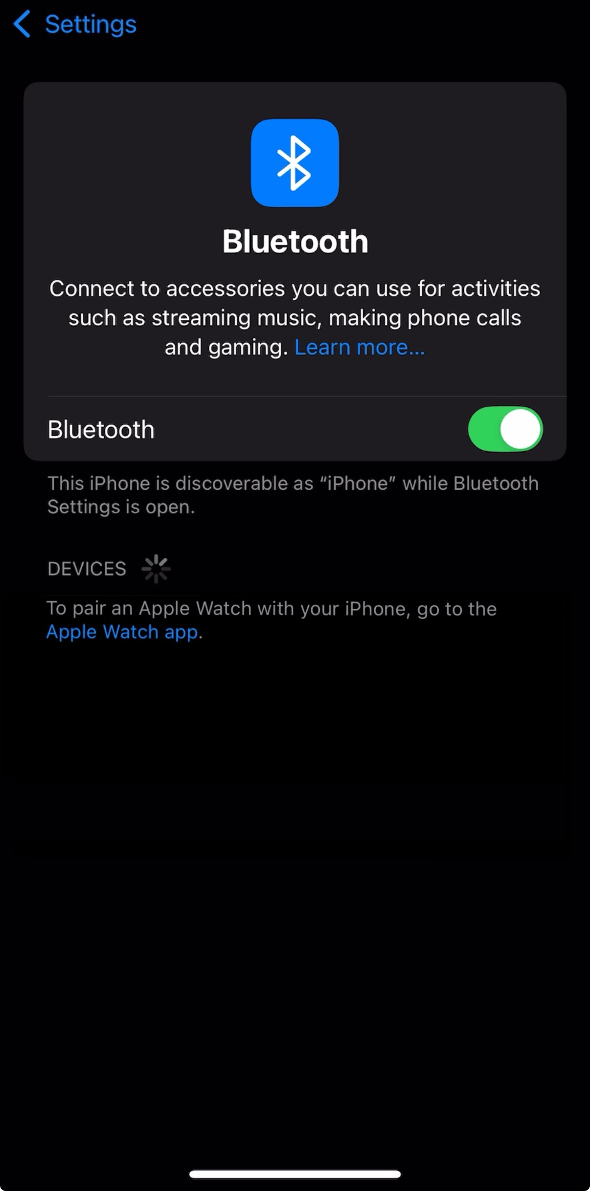

To pair your Reach RX with Mergin Maps, first, you need to pair it with the iOS device as follows:

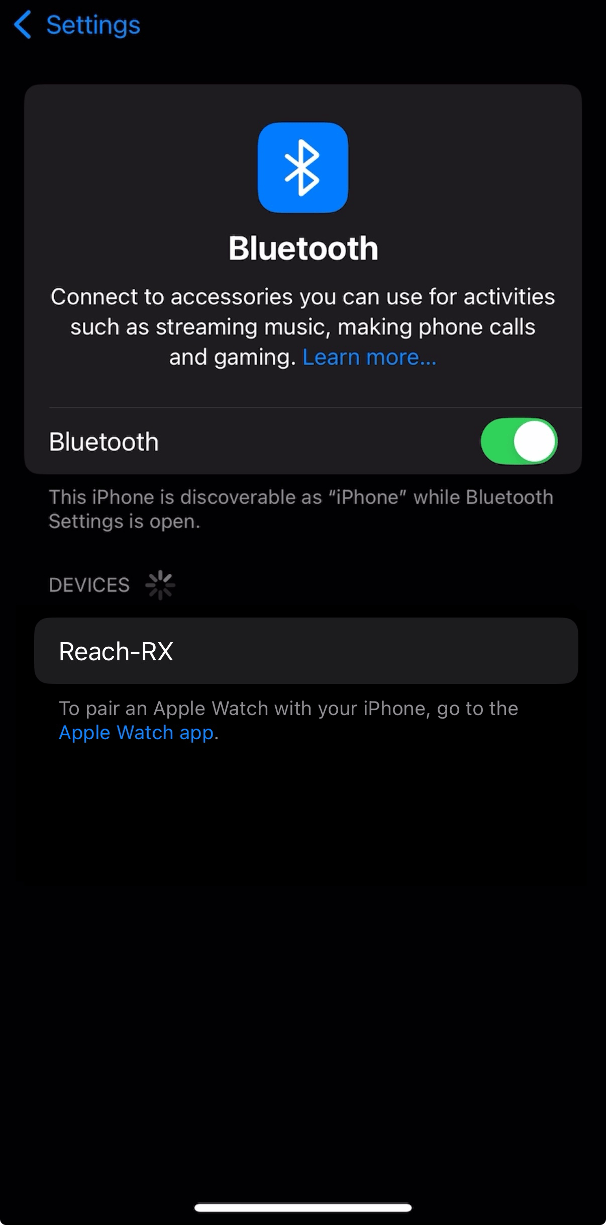

  1. Navigate to the Bluetooth configuration screen on your iOS device and enable Bluetooth.
  2. Wait for your Reach RX to be listed as an available device.
    Keep Reach within a few meters from the device.

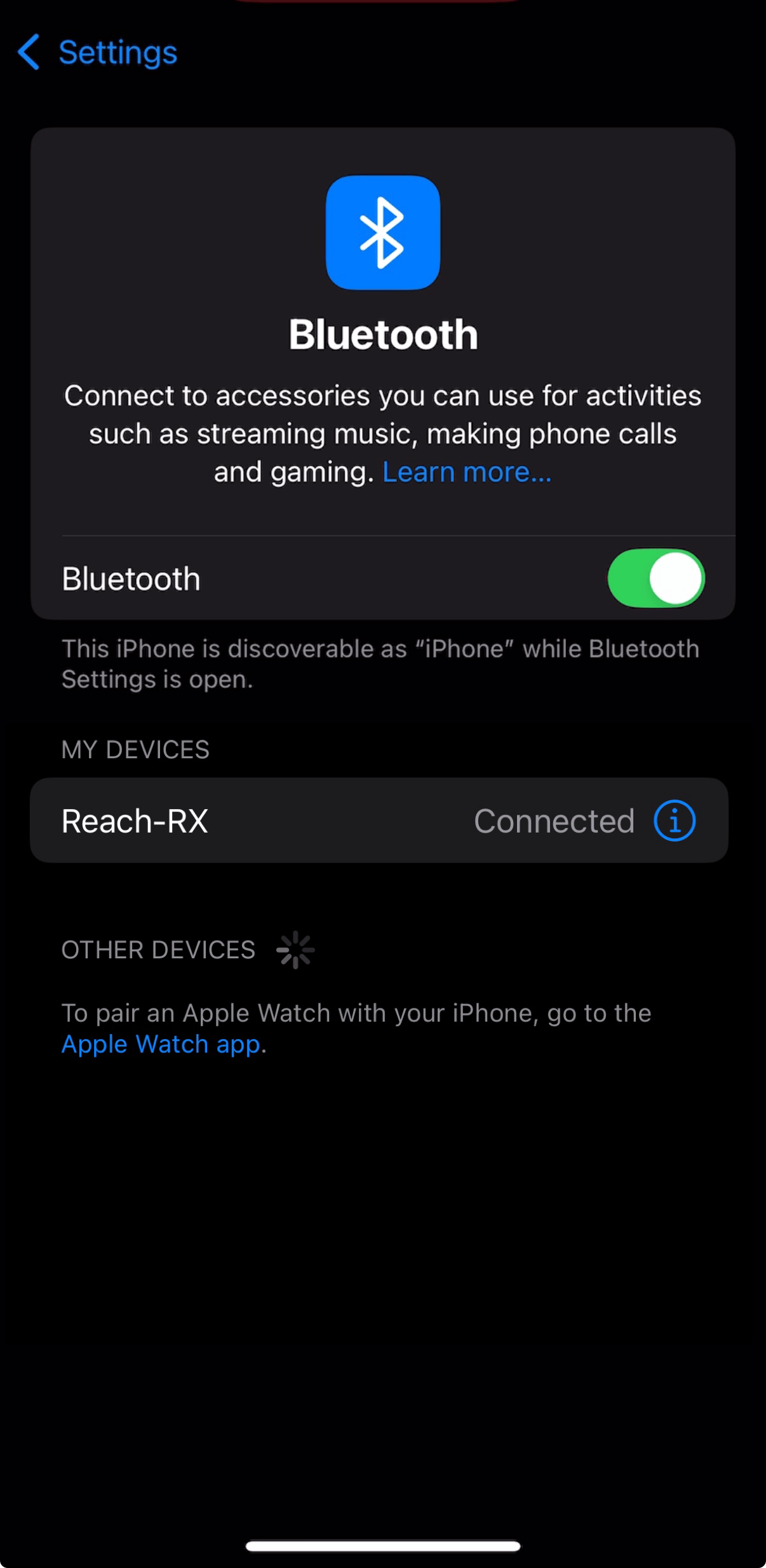

  3. Tap the name of your Reach in the list of available devices on the iOS device. You should see the note "Connected".
    If your device requires a PIN code, enter 123456.

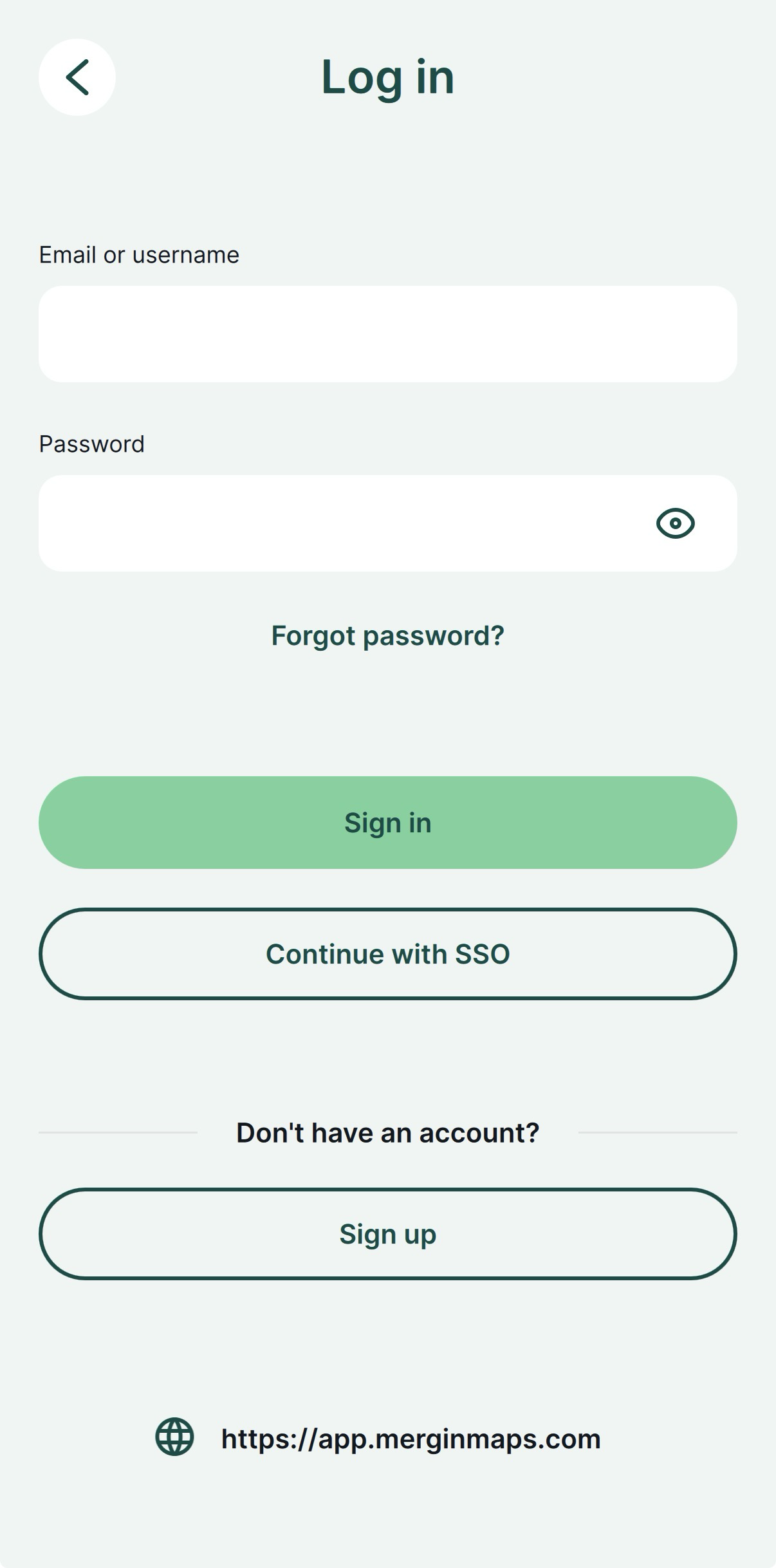

  1. Open the Mergin Maps app and create an account if you don’t have one yet to access the app.

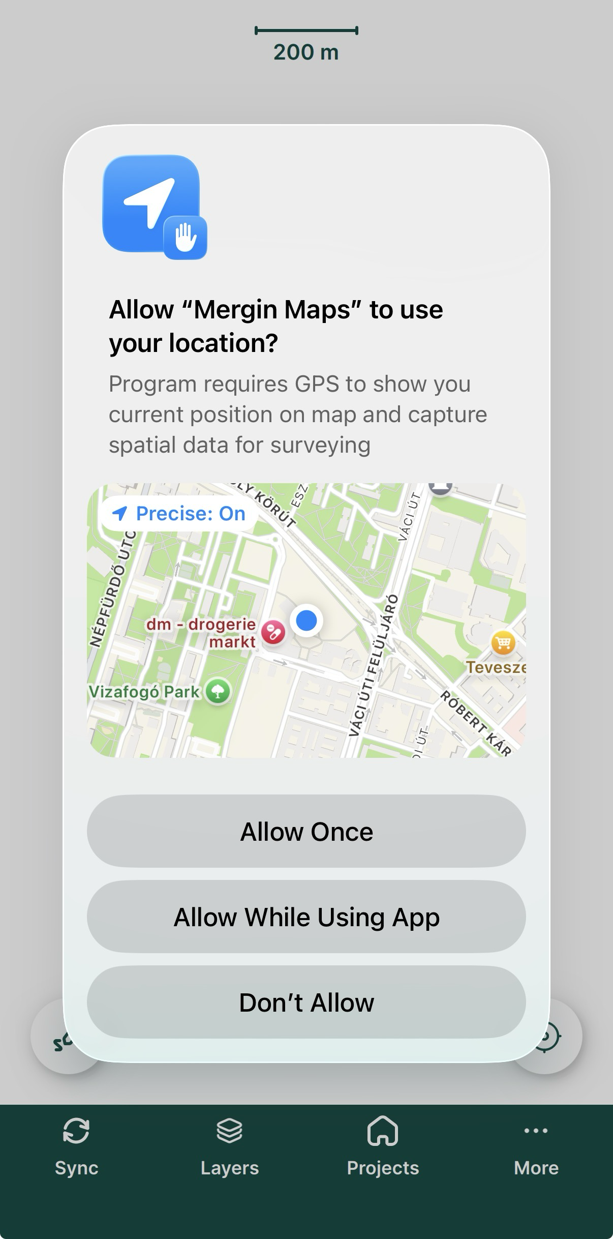

  3. If prompted, allow precise location.

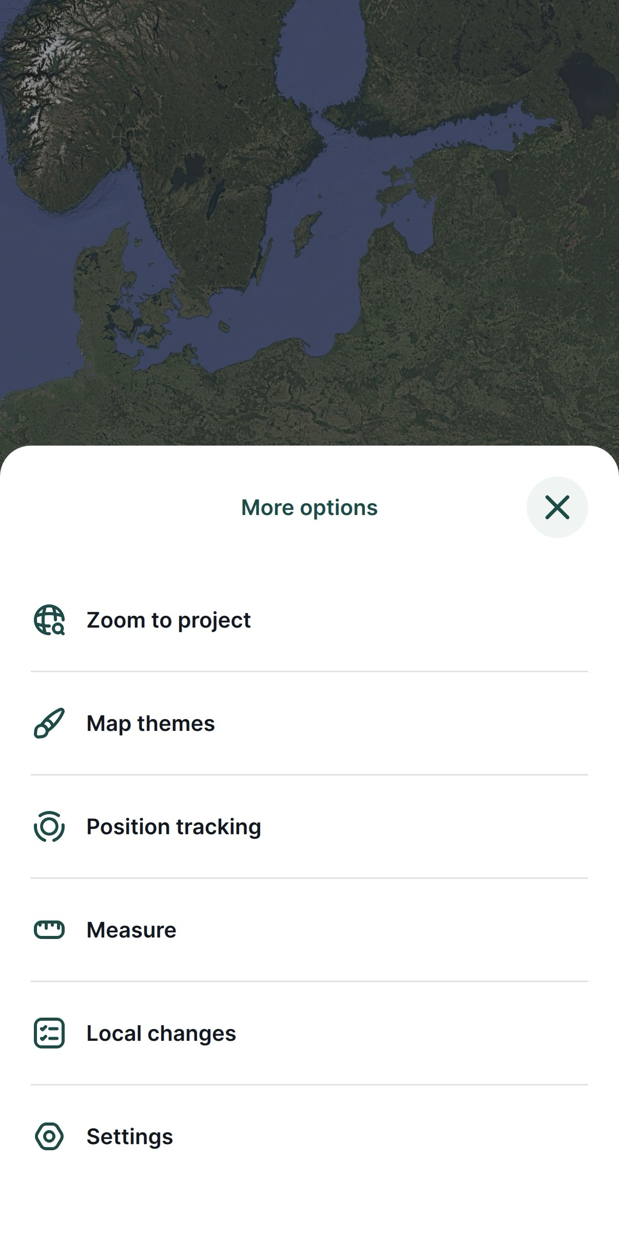

  4. On the opened screen in the lower right corner, tap More and Settings.

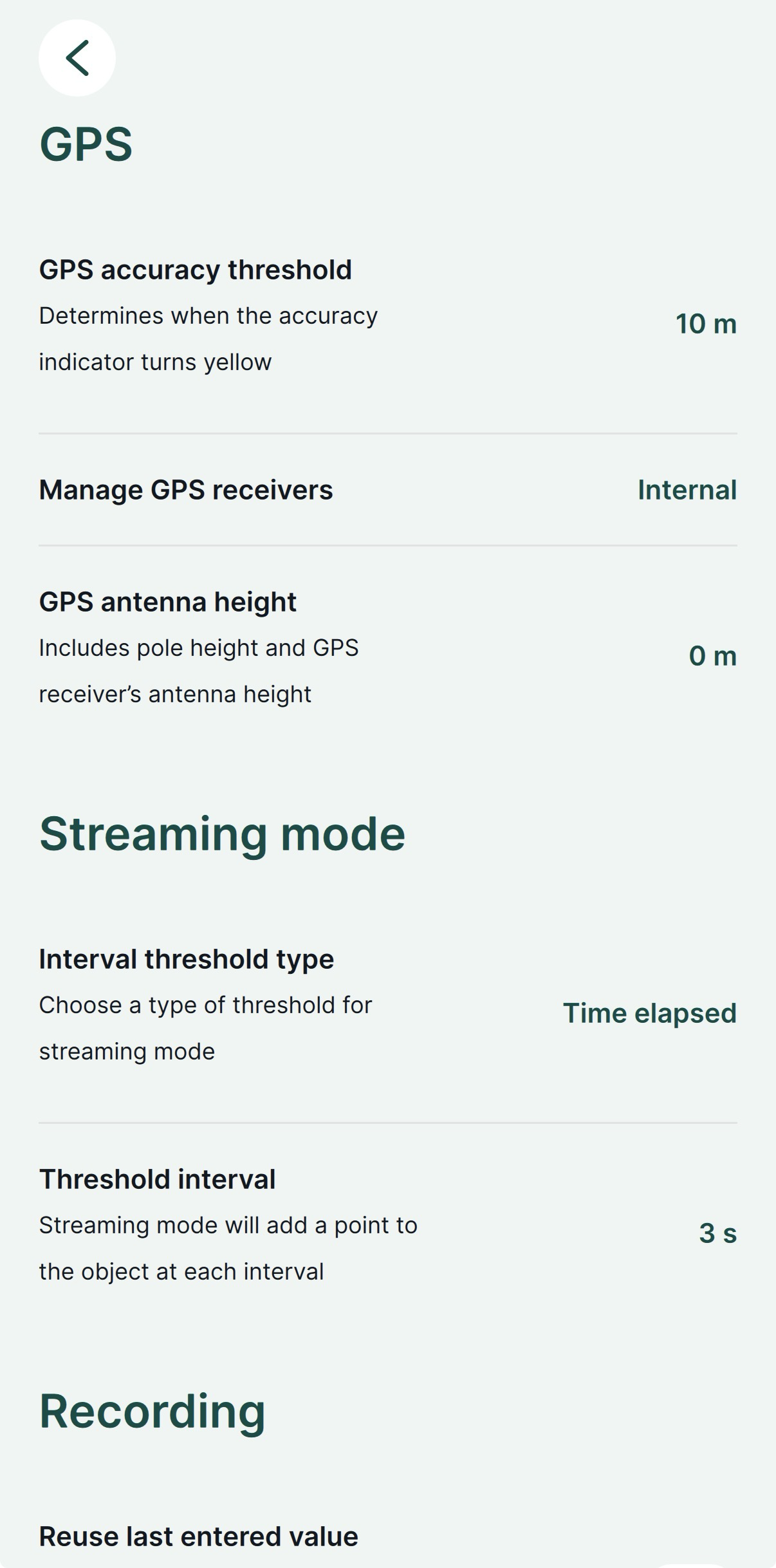

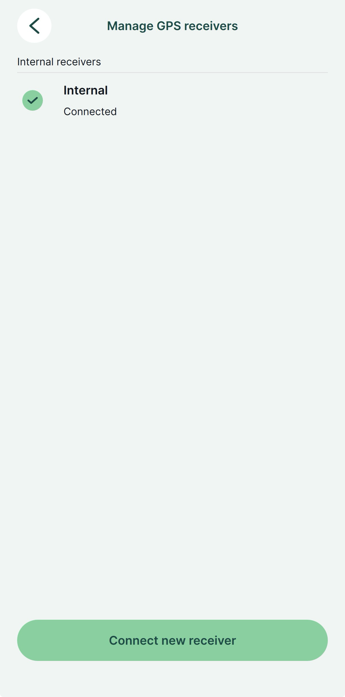

  5. In Settings, tap Select GPS receiver.
  6. Choose Internal.

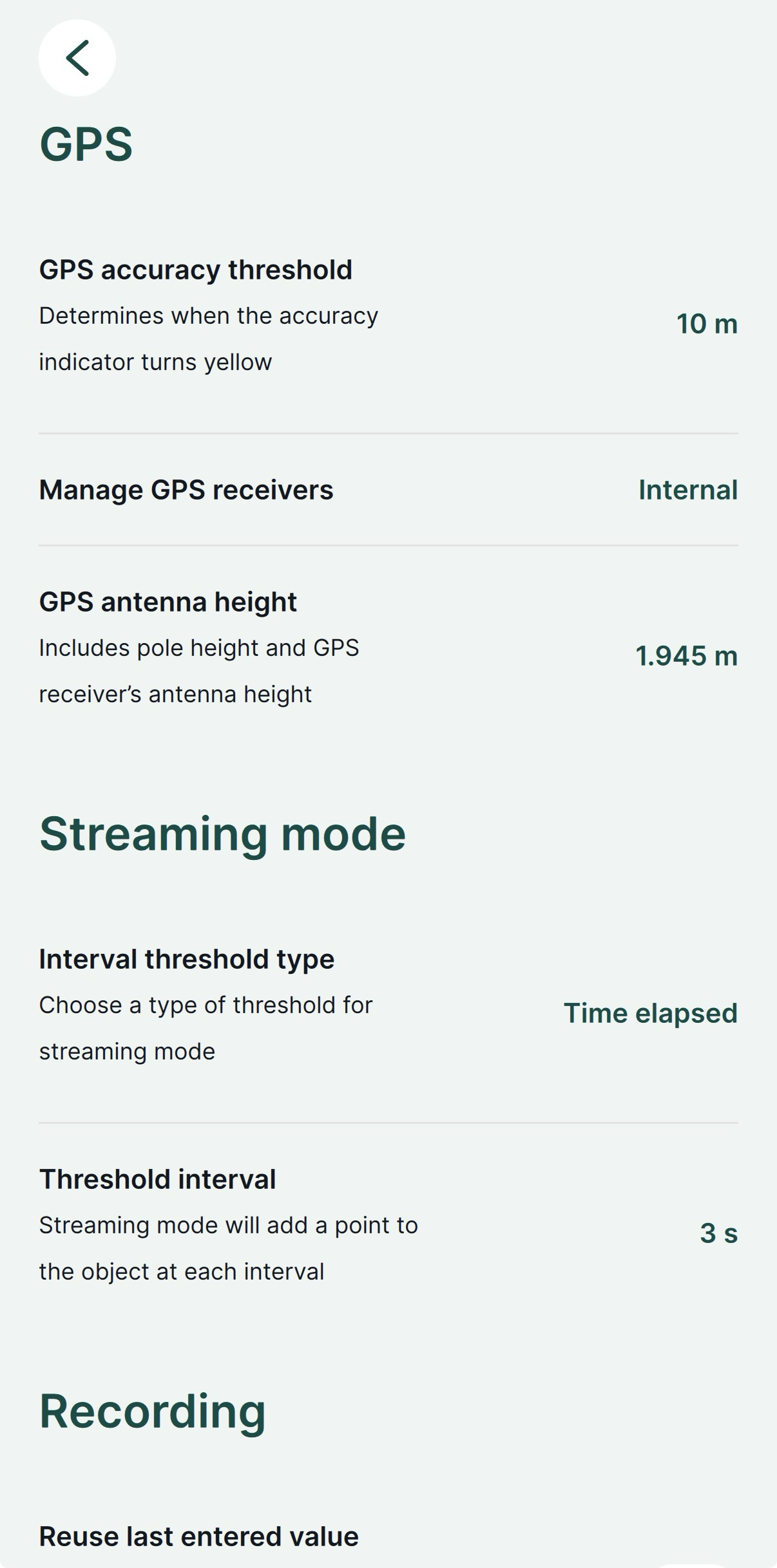

  7. Go back to Settings and set the antenna height. For Reach RX, the antenna height is the distance from the mark on the ground to the center point on the Reach’s bottom, antenna reference point (ARP), plus the height of the receiver to the antenna phase center (APC), antenna height offset. The antenna height offset equals to 145 mm.

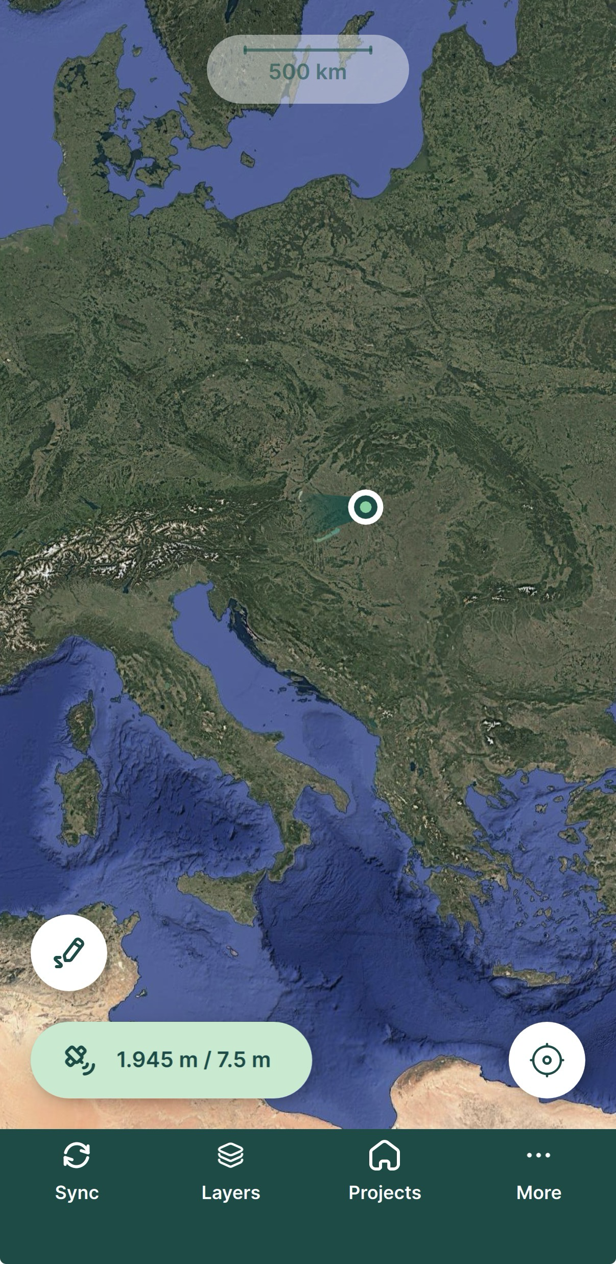

  8. Go to the GPS tab and check the RTK status and accuracy on the map. To check the detailed GPS info, go to Emlid Flow.
