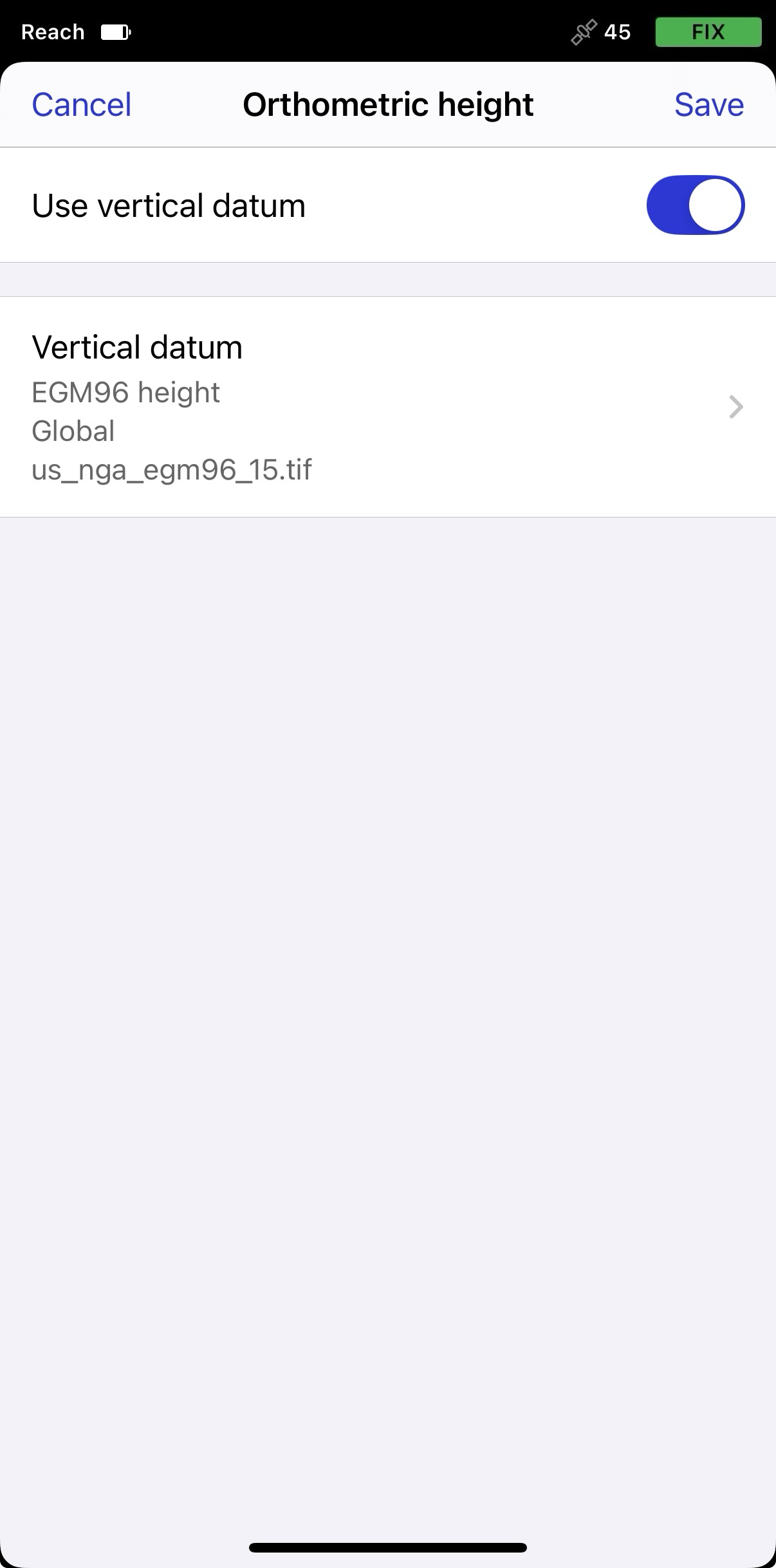

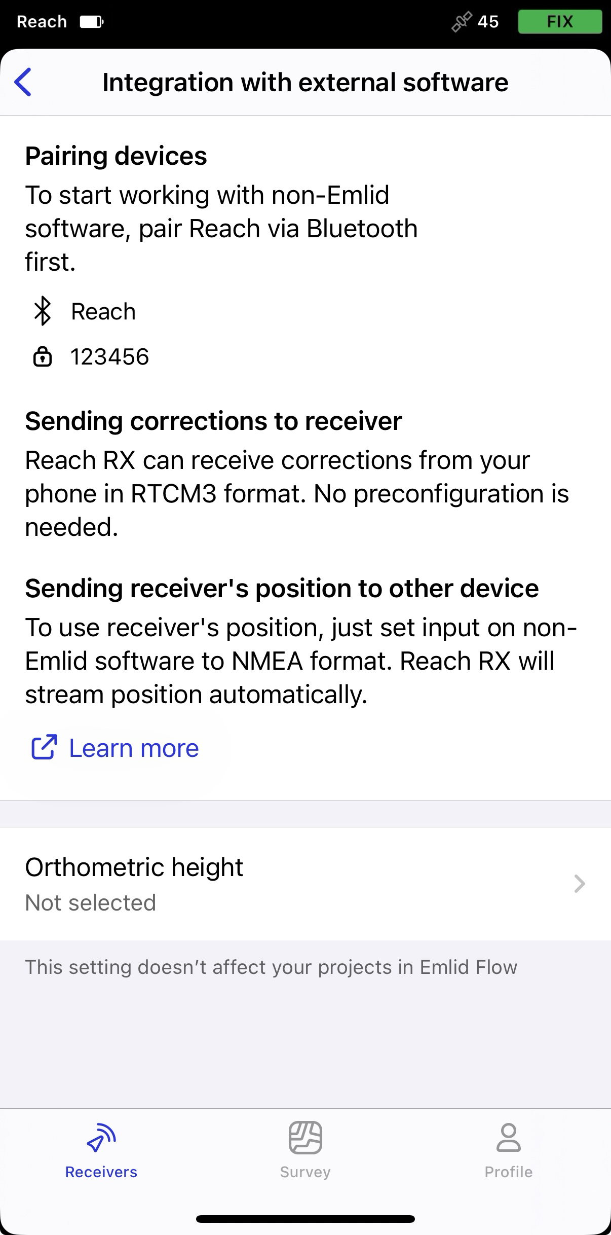

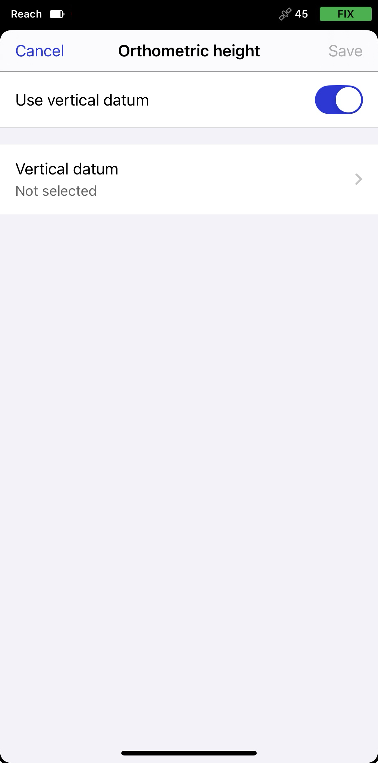

  1. In Emlid Flow, go to the Integration with external devices tab.
  2. Tap Orthometric height and turn on the toggle to use vertical datum.

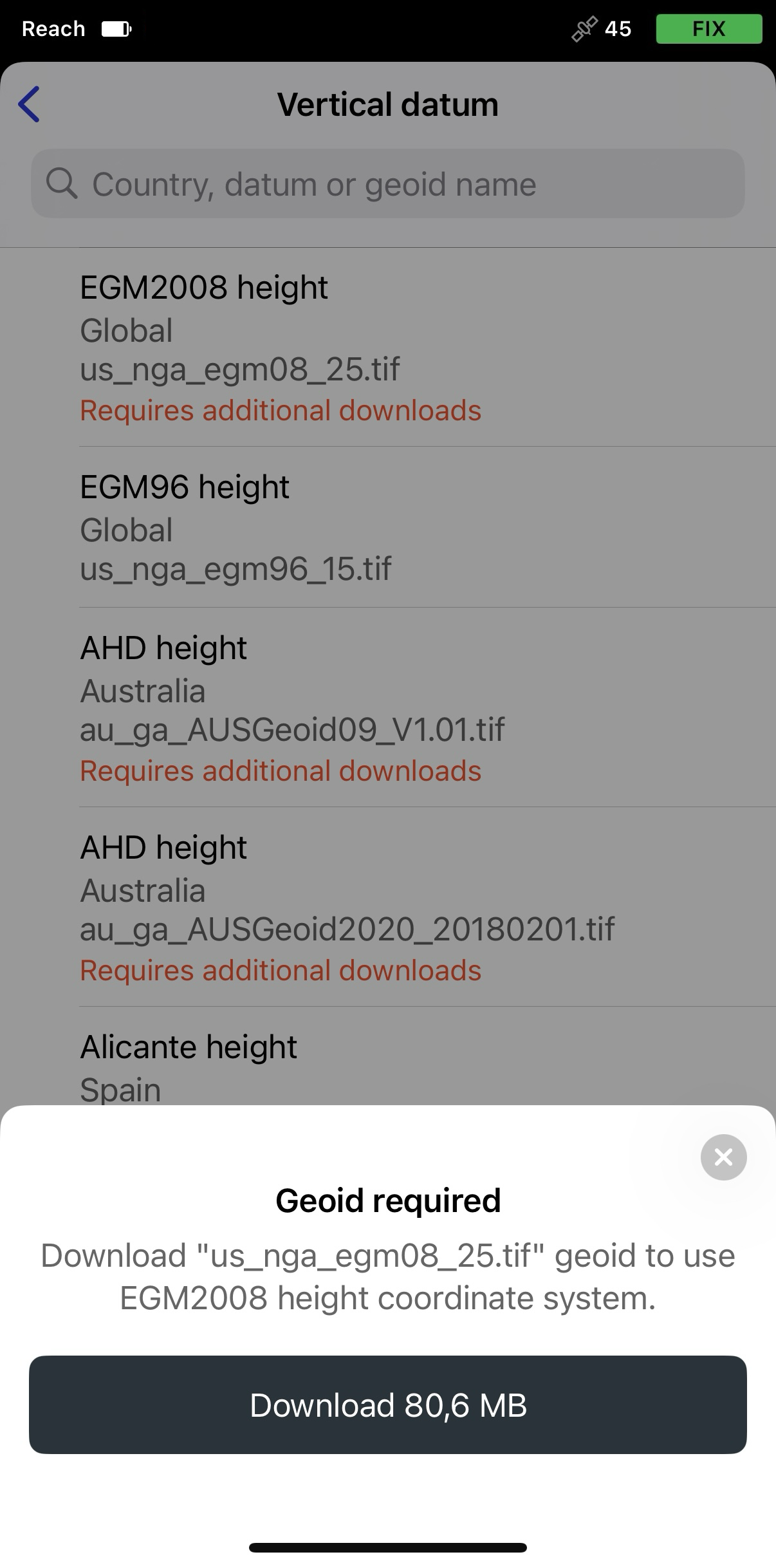

  3. Tap Vertical datum, then select the geoid for your location. If needed, download the geoid by tapping Download.
  4. Tap Save.

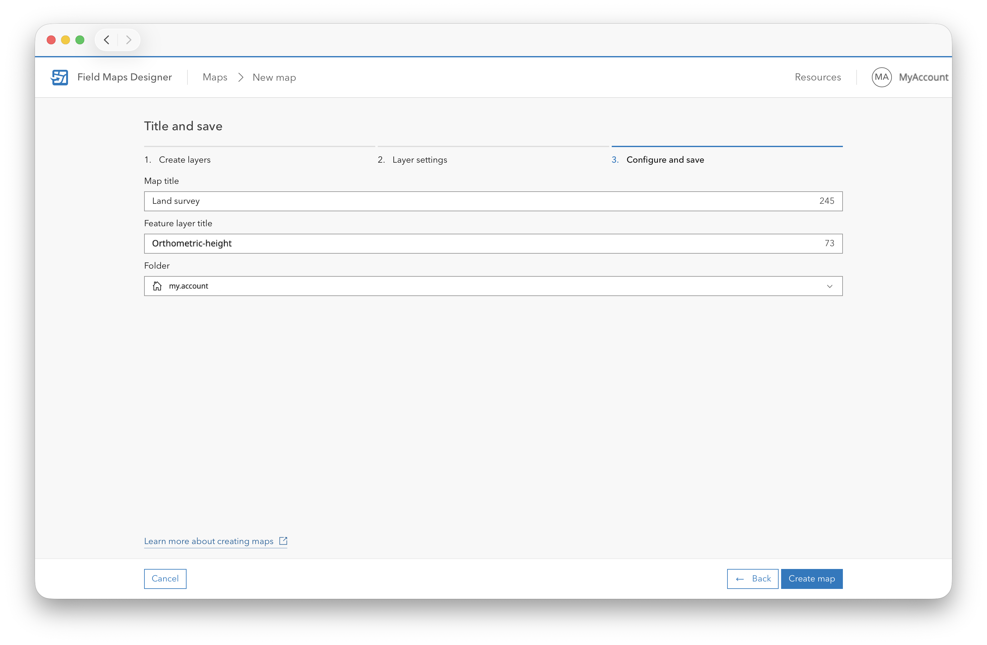

Before collecting field data with ArcGIS Field Maps, you need to create and configure your web map in ArcGIS Design, using a feature layer with Z-values enabled to support orthometric heights. Follow the steps below:

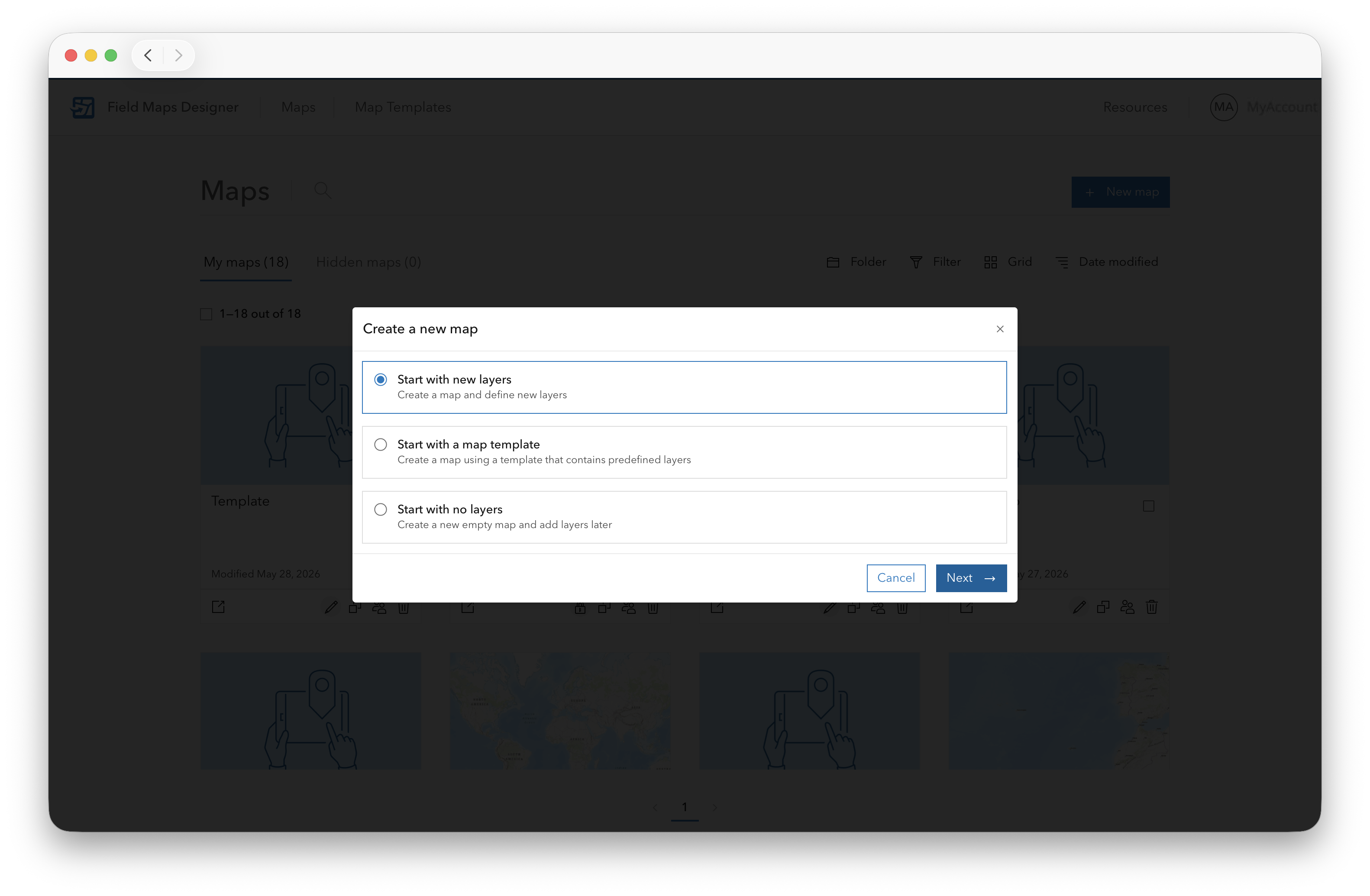

  1. Sign in to ArcGIS Design using your Esri account.
  2. Click +New Map, then Start with new layers, and Next.

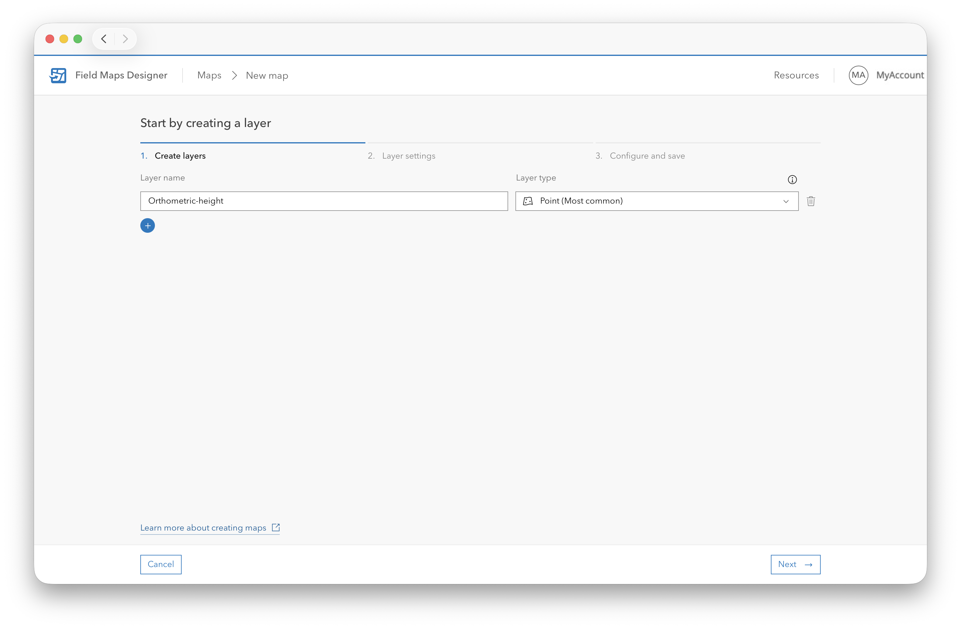

  3. Enter a name for the layer and choose the geometry type required for your workflow:
    • Point
    • Line
    • Polygon
  4. Click Next to open the layer settings.
    Settings cannot be changed after the layers are created.

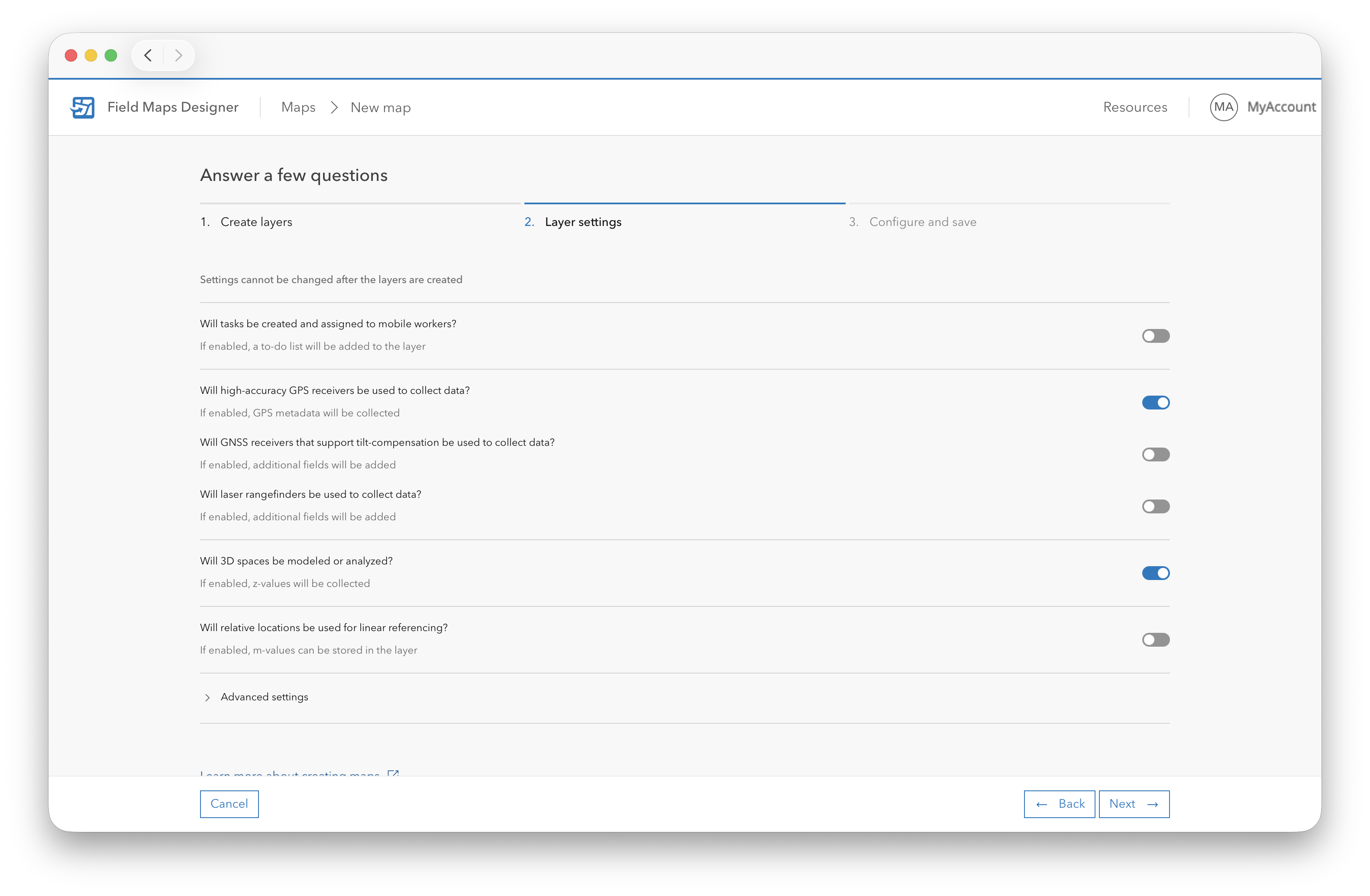

  5. Enable the settings for high-accuracy data collection:
    • Will high-accuracy GPS receivers be used to collect data?
    • Will 3D spaces be modeled or analyzed?

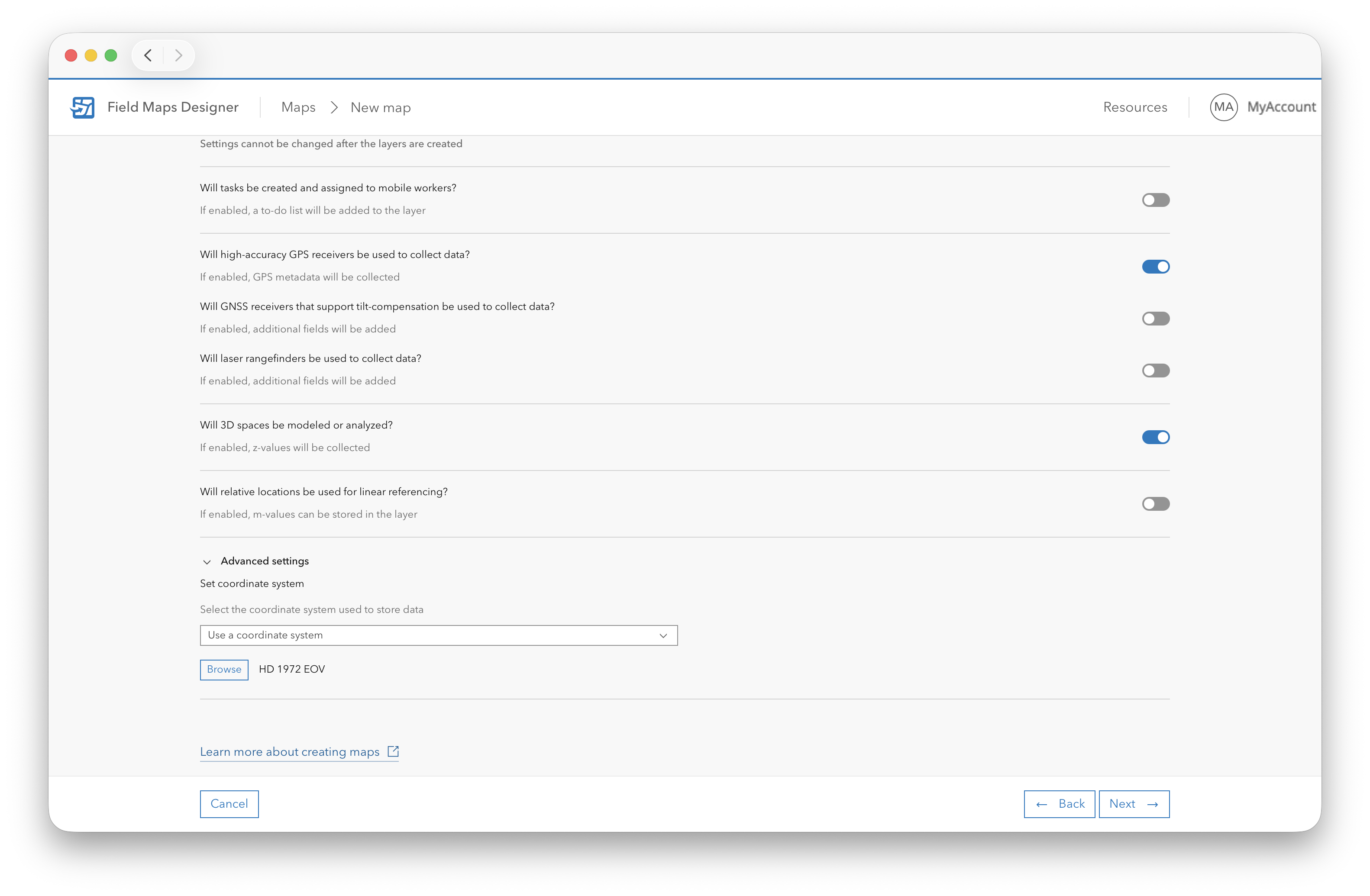

  6. Open Advanced settings to configure the coordinate system for the project.
    You can:
    • Use the same coordinate system as the basemap.
    • Select a different projected coordinate system appropriate for your region.
    Make sure the selected coordinate system matches the region and survey requirements of your project.
  7. Enter the map title and layer title, select the folder where you want to place it, and click Create map.

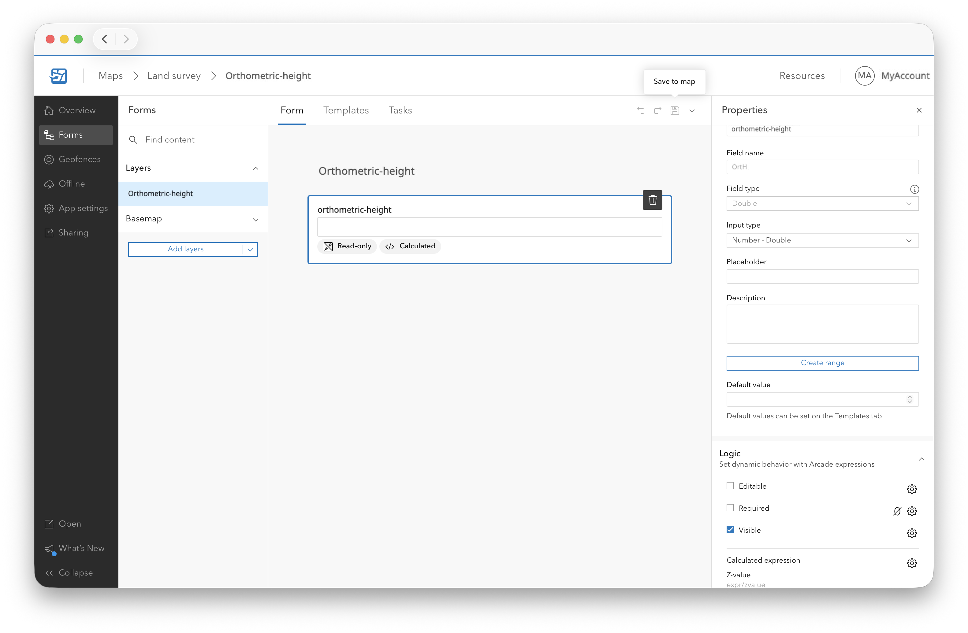

  8. Once the map is created, open the Forms section.
  9. Select the feature layer you created and add the Number→Double field. A double-precision field is required because orthometric heights contain decimal values and survey-grade workflows require centimeter-level accuracy.
  10. Enter a display and a field name.
  11. Save the field configuration using the save icon.
  12. In the right-hand panel, scroll to Calculated expression.
  13. Click the gear icon and select New expression.

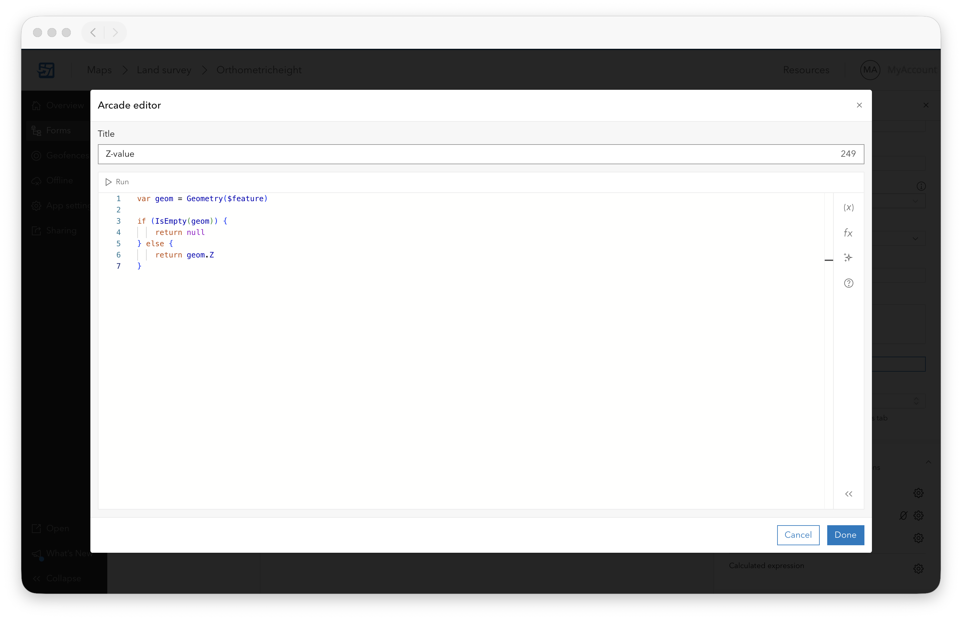

  14. Add the following Arcade expression to extract the Z-value from the feature geometry and use it as the orthometric height value:
    var geom = Geometry($feature)
    if (IsEmpty(geom)) {
    return null
    } else {
    return geom.Z
  15. Click Done.
  16. Save the form configuration again using the save icon.

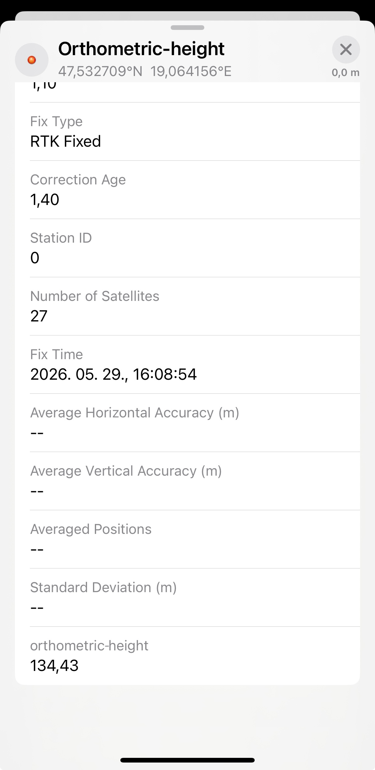

You can now return to your web map in ArcGIS Field Maps on your mobile device with the feature layer applied. When used with the Reach RX receiver, ArcGIS Field Maps will display orthometric heights for the collected objects.
