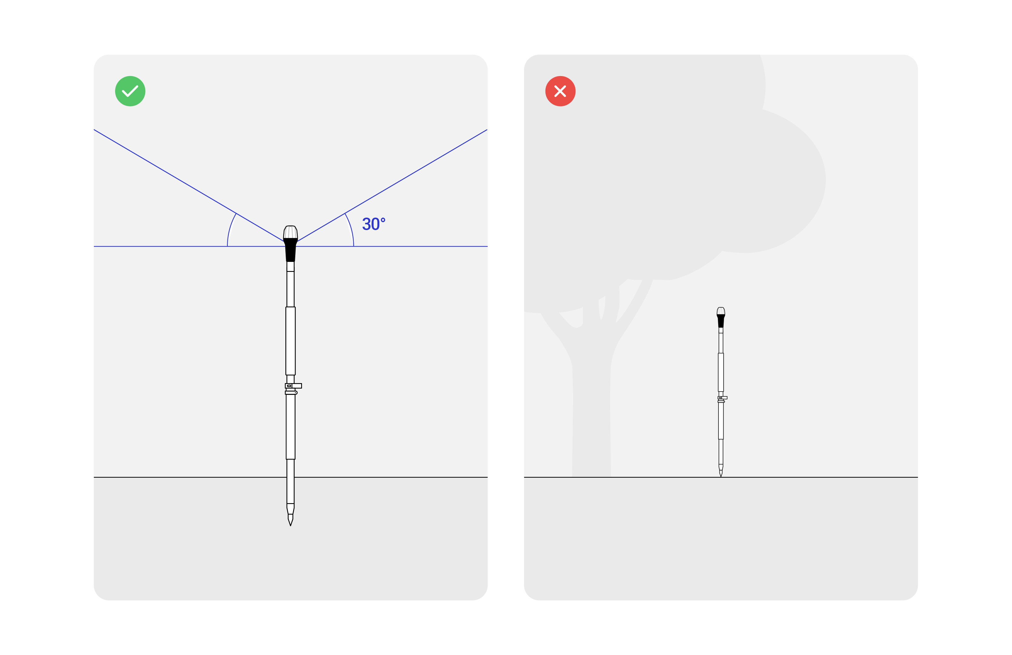

Placing Reach RX rover​
Before surveying, make sure your Reach has a clear sky view of at least 30° above the horizon. There should be no obstacles that could block the view like buildings, trees, cars, humans, laptops, etc.
Placing third-party base​
To properly place your third-party base, follow these instructions:
  1. Follow the instructions of your base's manufacturer.
  2. Make sure there no obstacles that could block the view like buildings, trees, cars, humans, laptops, etc.
  3. Make sure there are no electronics nearby.
