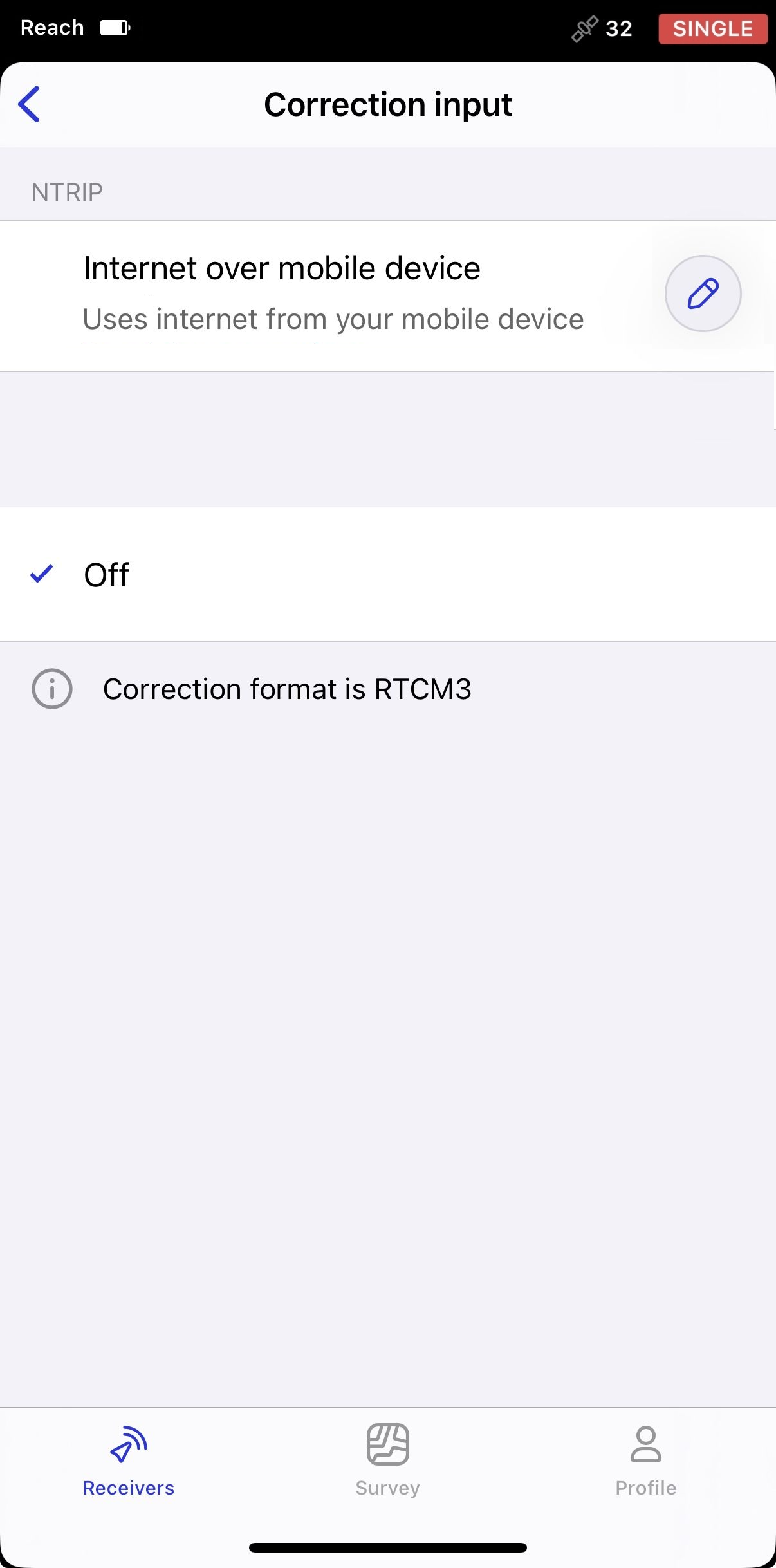

  2. Tap Correction input and configure your Reach RX to receive network corrections over Bluetooth.

    When using NTRIP, Dynamic status messages provide setup guidance and display the current correction input status, so you can quickly determine whether any action is required.
  1. Tap Add profile and enter the credentials and connection details provided by your NTRIP service provider:
    • Address: The URL or IP address of the NTRIP caster.
    • Port: The port used to connect to the caster. The default value is usually 2101 unless your provider specifies a different port.
    • Username: The username used to authenticate with the NTRIP service. In some cases, it may be your name or email address.
    • Password: The password associated with the username.
    • Mount Point: The name of the correction stream provided by the NTRIP service.
      To find out which mount point suits you better, check the website of your NTRIP provider. Make sure that the baseline doesn't exceed 60 km (37 mi).
    On some Android devices, default keyboards do not provide a minus sign. To get access to it, we recommend downloading Gboard, a virtual keyboard app, from the Google Play Store.
    If your NTRIP provider requires information about the receiver's position, such as VRS service, enable Send receiver's position to the provider.
  2. Tap Save. If you are outdoors and everything is configured correctly, you will start receiving corrections in a few seconds.
    To start receiving corrections, make sure that your receiver has satellite visibility.
    You can add a required number of NTRIP profiles and choose between them right on the Correction input screen later.
