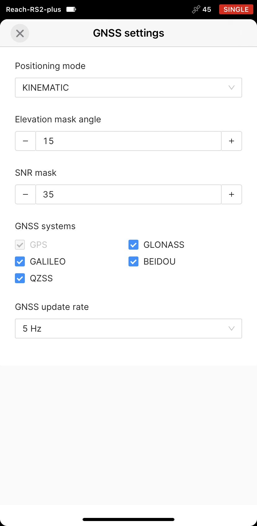

To set up your Reach as a rover for RTK mode with NTRIP, you need to configure GNSS settings and correction input in Emlid Flow. First, configure GNSS settings following the steps below:
Open Emlid Flow and connect to your receiver.
Go to Settings and tap GNSS settings. We recommend the following settings:
- The positioning mode is set to Kinematic.
- The elevation mask angle is set at 15 degrees.
- The SNR mask angle is set at 35 degrees.
- All satellite systems are selected.
- The GNSS update rate is set at 5 Hz.
Tap Apply.

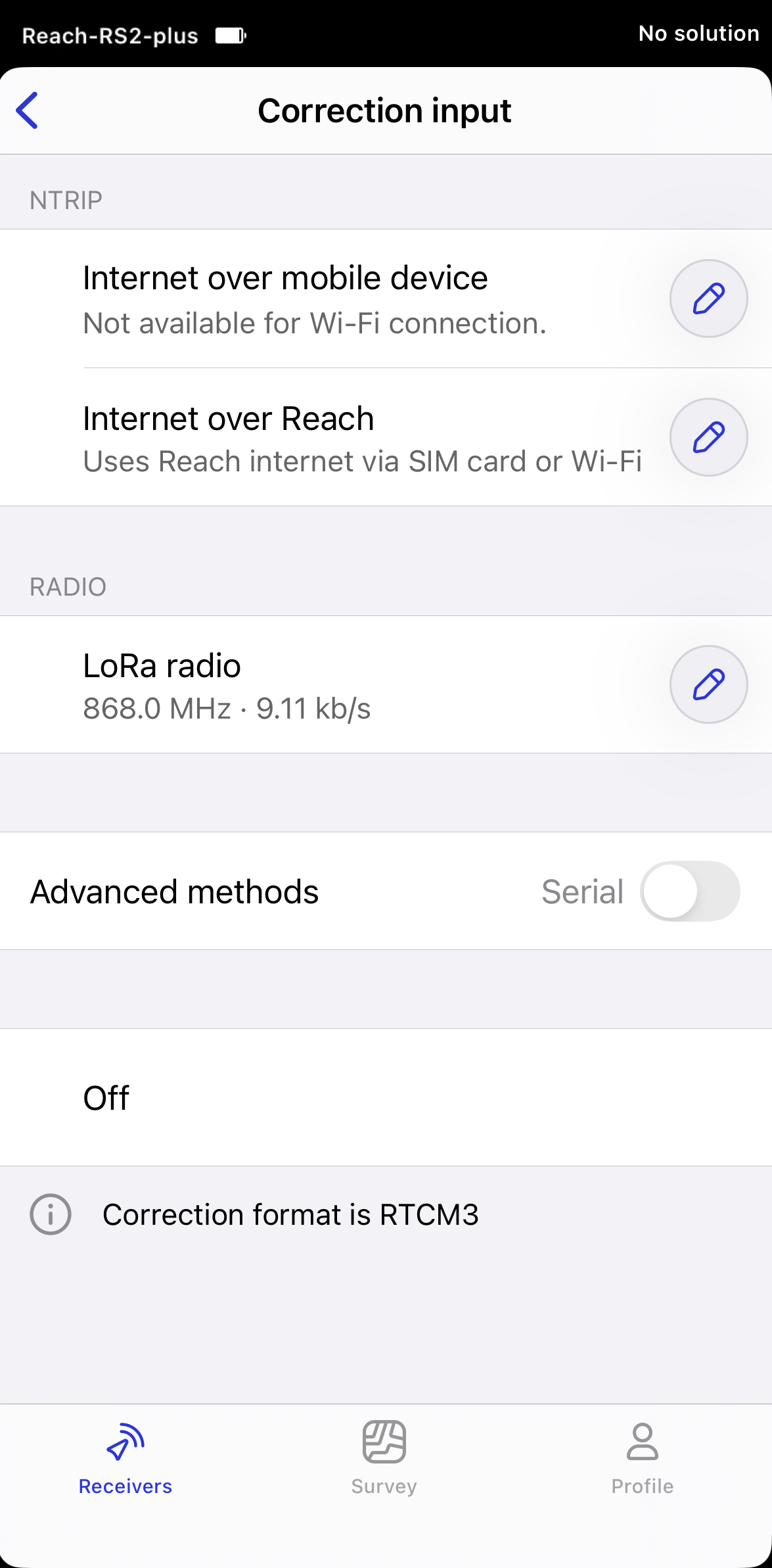

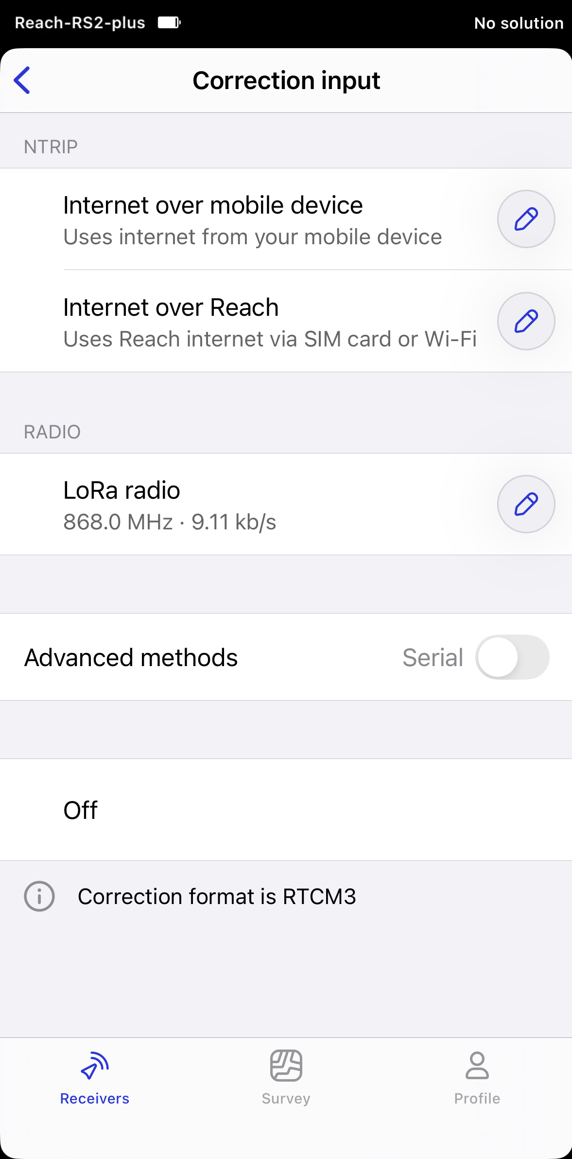

Go to the Correction input screen.
In the NTRIP section, select how the receiver will receive corrections from an NTRIP provider. The available options depend on how your mobile device is connected to the receiver.
If you connected to the receiver via Bluetooth, you have two options:
Pick NTRIP via mobile device to use your phone's or tablet's internet connection. This is a recommended method which requires no setup.
Pick NTRIP via Reach to use the receiver’s internet connection via a SIM card or Wi-Fi network. In this case, you can provide internet access using one of the following methods:

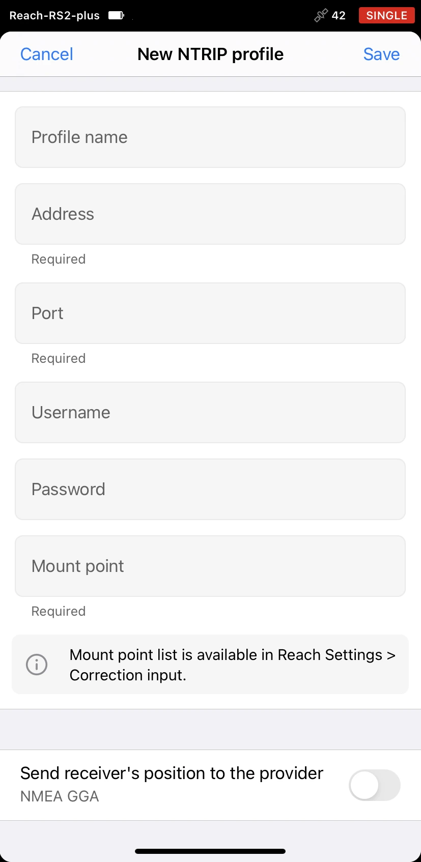

Tap Add profile and enter the credentials and connection details provided by your NTRIP service provider:
Address: The URL or IP address of the NTRIP caster.
Port: The port used to connect to the caster. The default value is usually 2101 unless your provider specifies a different port.
Username: The username used to authenticate with the NTRIP service. In some cases, it may be your name or email address.
Password: The password associated with the username.
Mount Point: The name of the correction stream provided by the NTRIP service.
tipTo find out which mount point suits you better, check the website of your NTRIP provider. In general, shorter distances to the reference station improve RTK performance.
ANDROID KEYBOARD TECH TIPOn some Android devices, default keyboards do not provide a minus sign. To access it, we recommend downloading Gboard, a virtual keyboard app, from the Google Play Store.
noteIf you use a VRS service, you need to enable Send receiver's position to the provider.

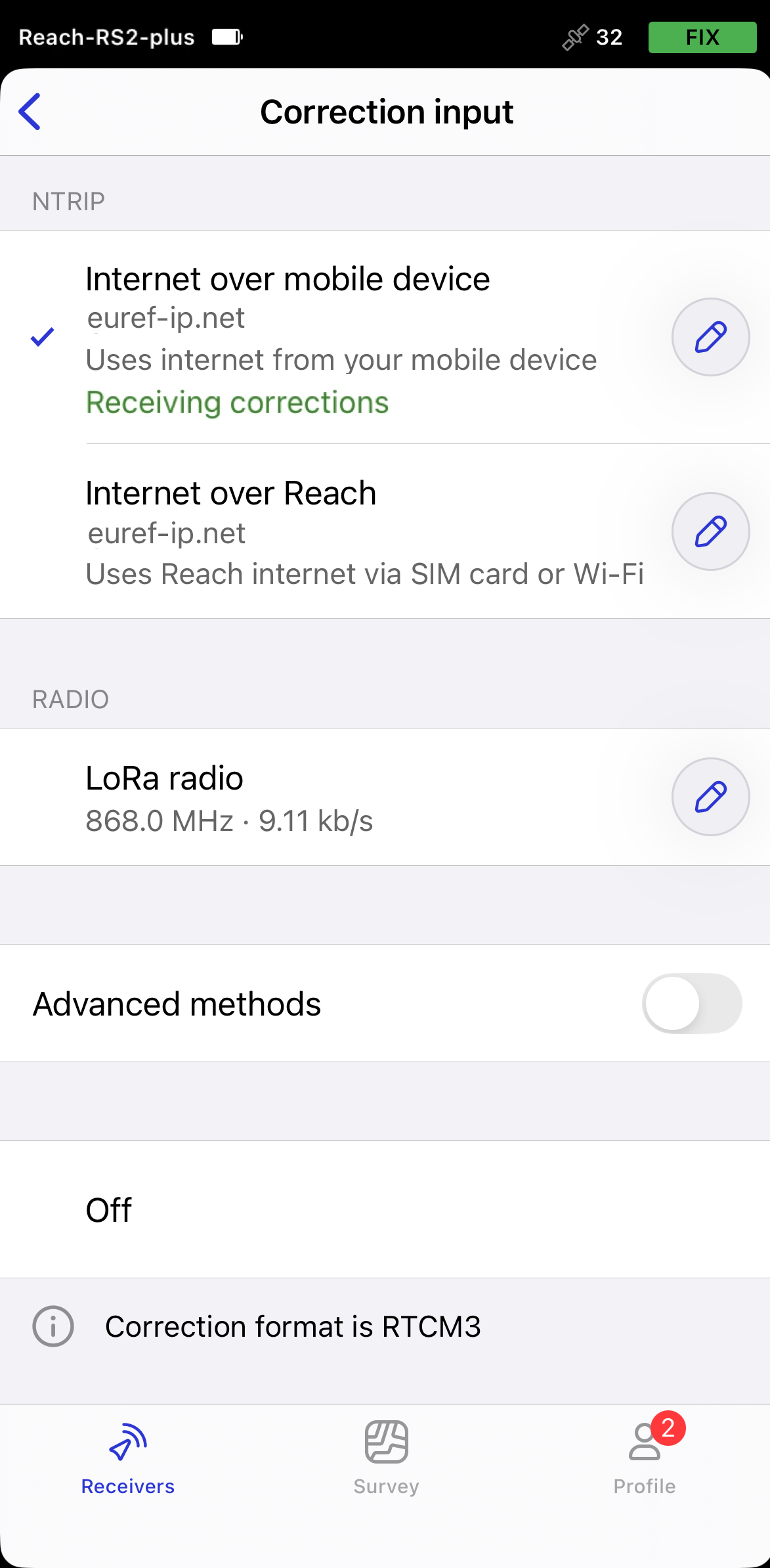

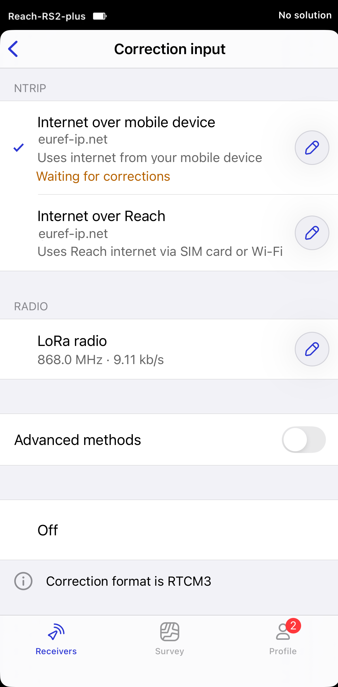

Tap Save. If everything is configured correctly, the Waiting for corrections notification will appear first. Once the receiver has a clear sky view and satellite visibility, corrections should start within a few seconds.

Once the receiver has a clear sky view and satellite visibility, corrections will start within a few seconds.
