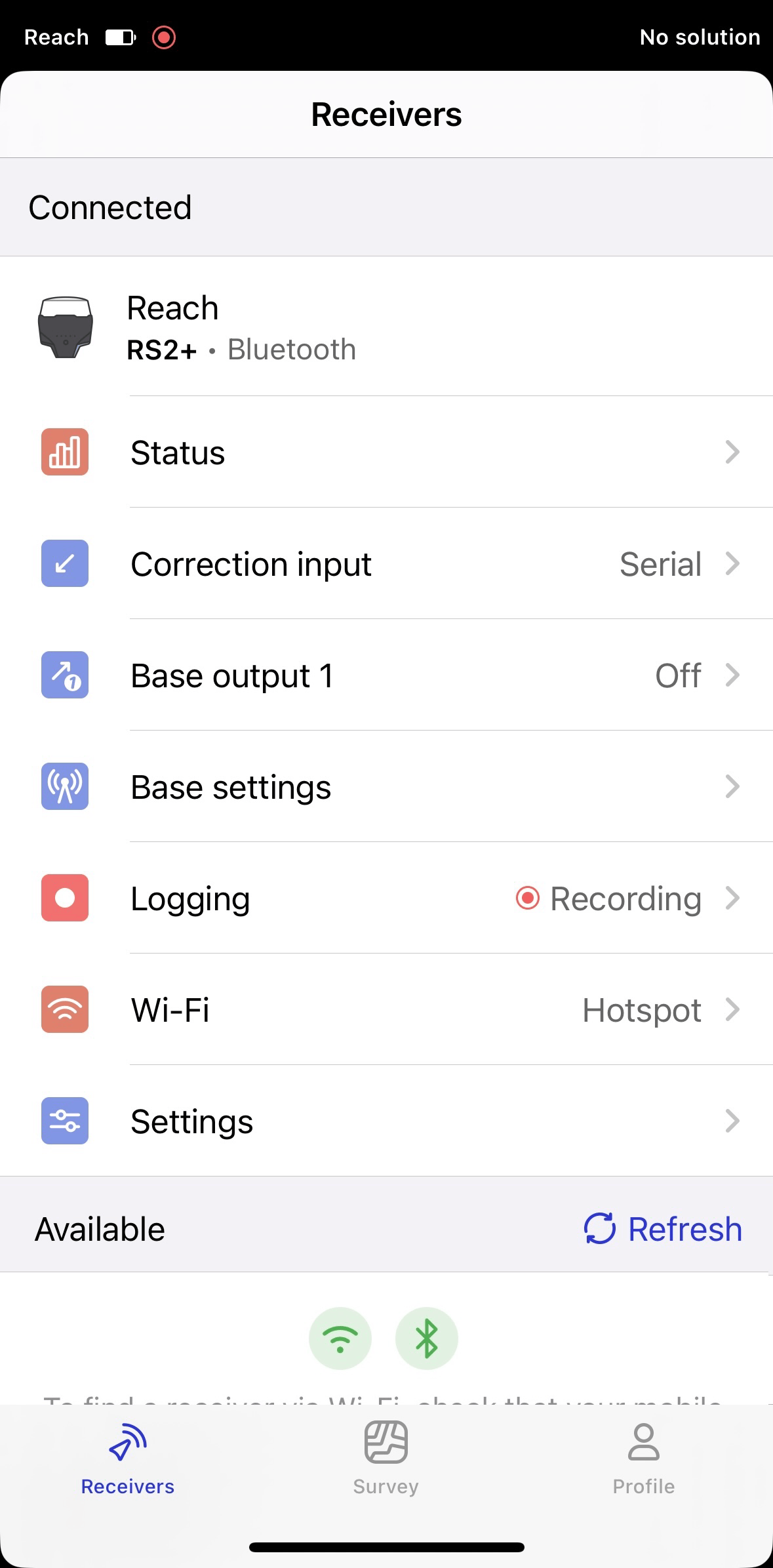

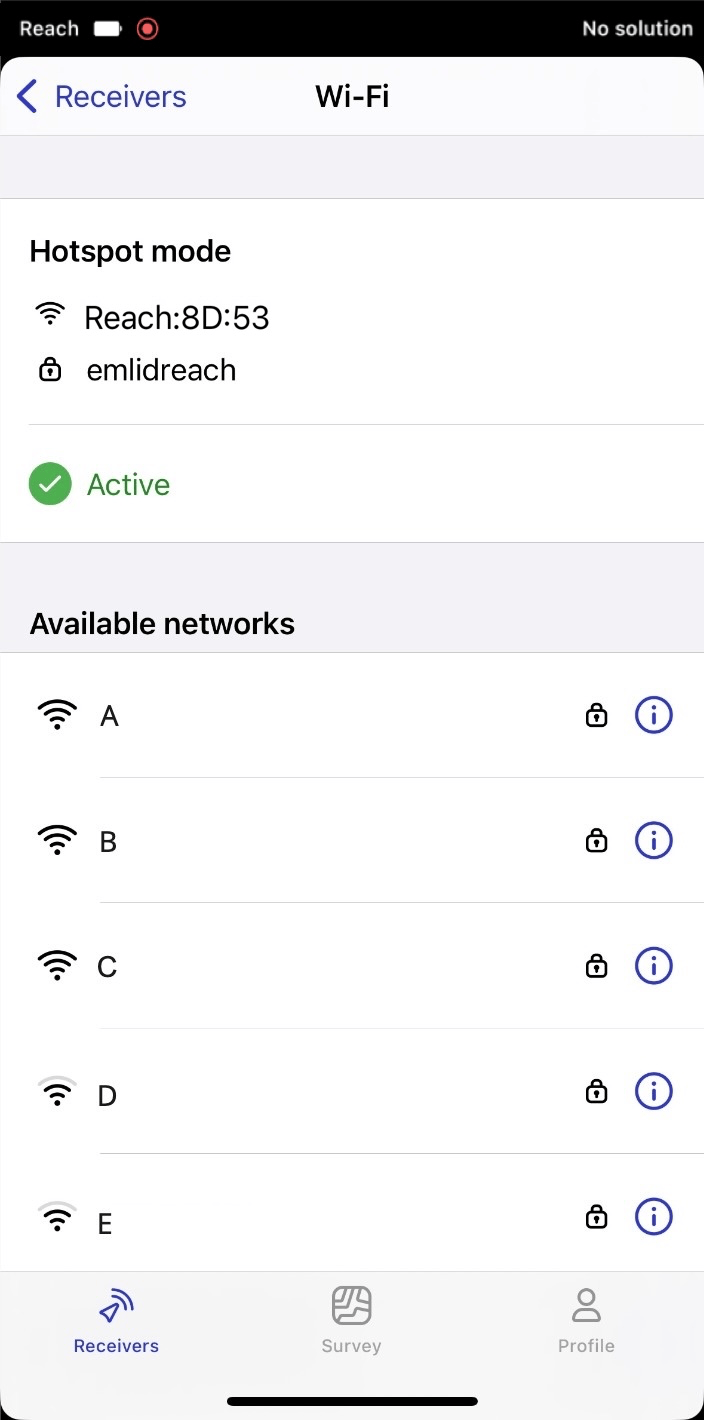

On the Receivers screen, tap Wi-Fi.
Choose your Wi-Fi network from the list.

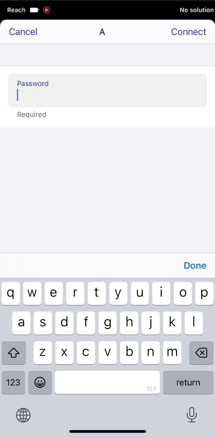

Fill in the password for the selected network.
noteDouble-check if you entered the password correctly.
Tap the Connect button. The Network LED will start blinking blue. It means that Reach is trying to connect to your network.

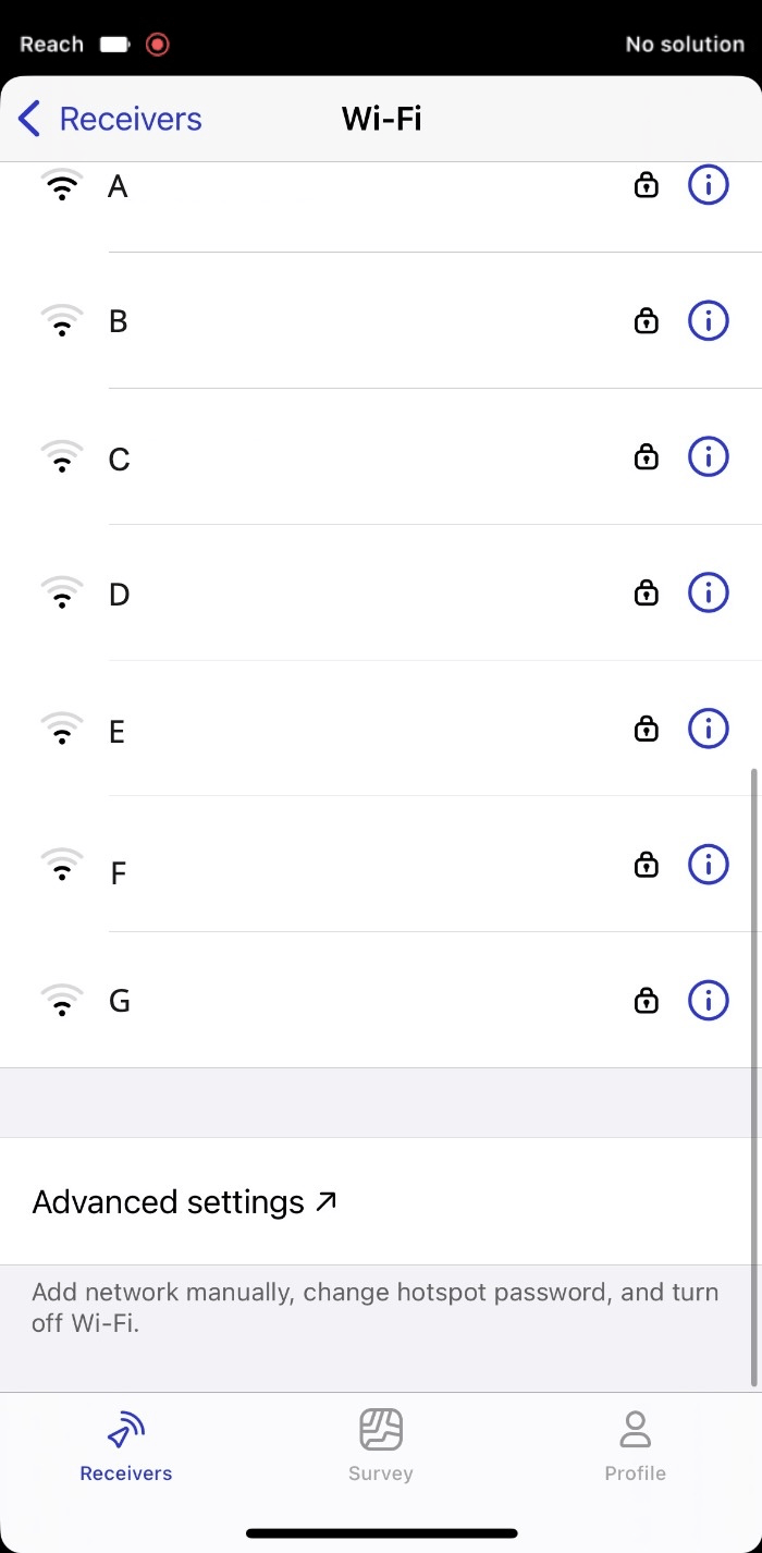

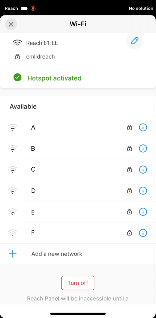

- On the Receivers screen, tap Wi-Fi, then Advanced settings.

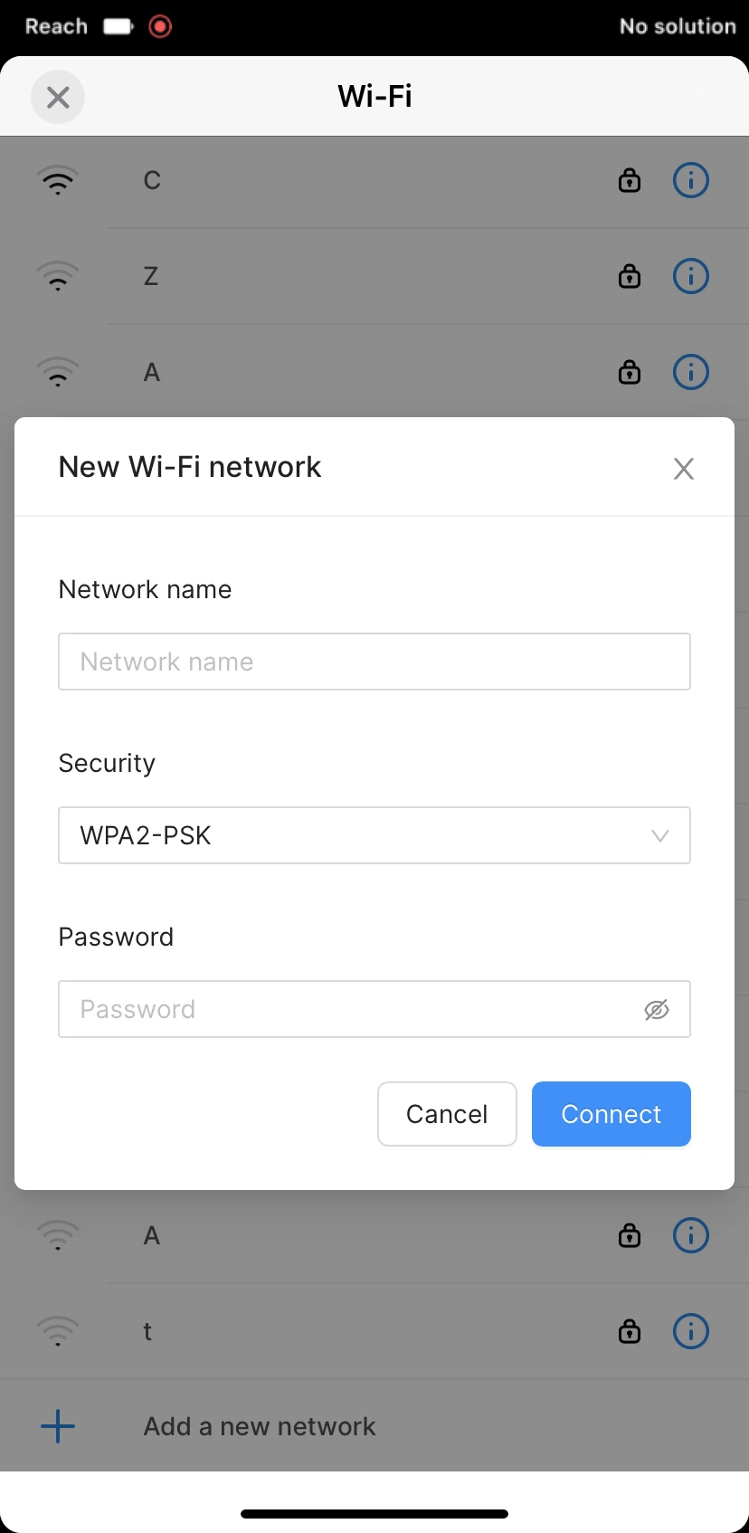

Tap Add a new network. As your device's mobile hotspot has been temporarily disabled, its network is not visible.
cautionMake sure that there are no available saved networks to ensure a successful connection.
Fill in the credentials of your device’s hotspot:
- Type the network name
- Choose a security type
- Add a password if you have it
noteDouble-check if you entered the correct password.
Tap the Connect button. The Network LED will start blinking—it means that Reach is trying to connect to your device's hotspot.
