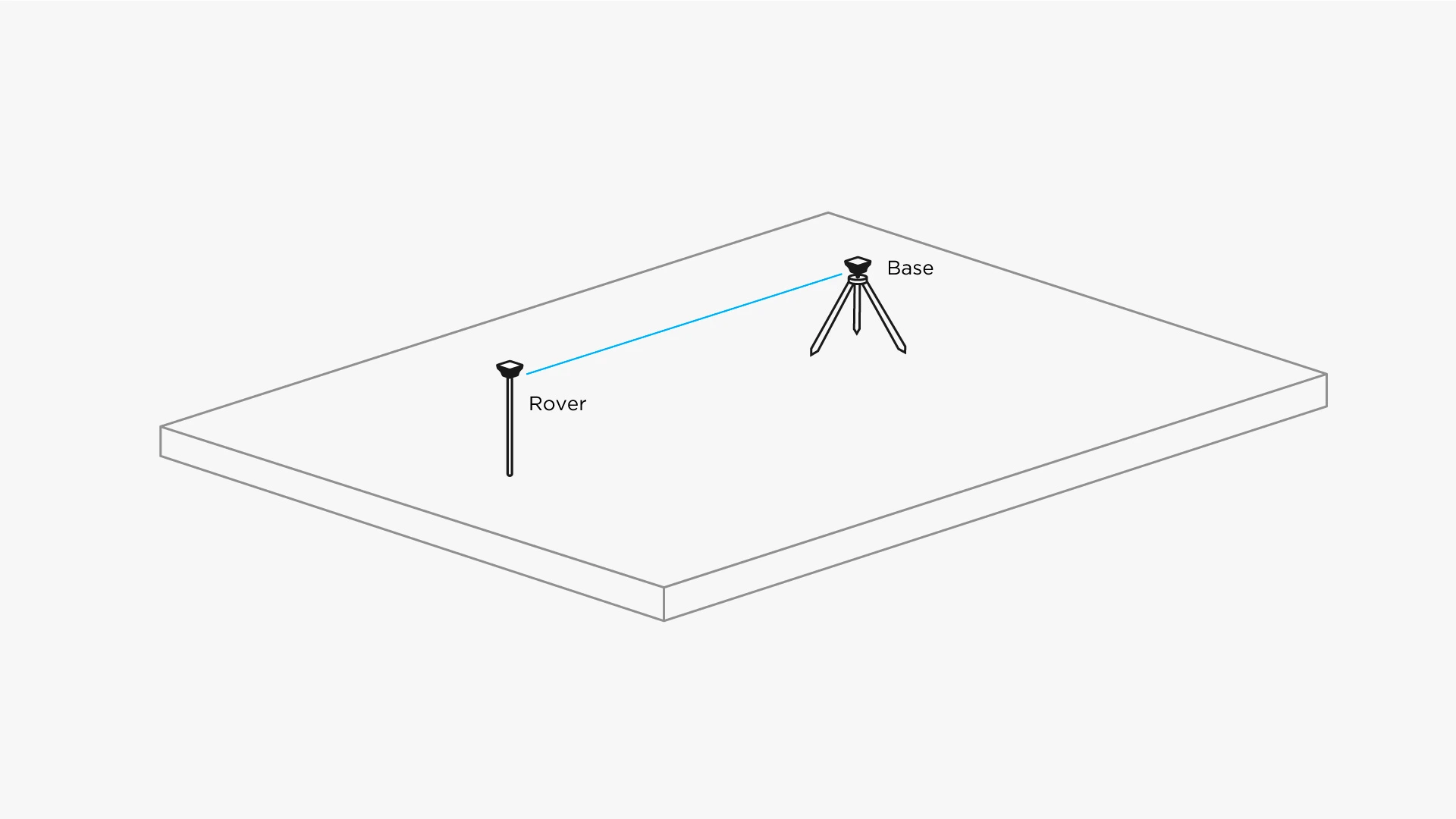

Two receivers are used in RTK. One of them is stationary, another moves freely. They are called base station and rover.

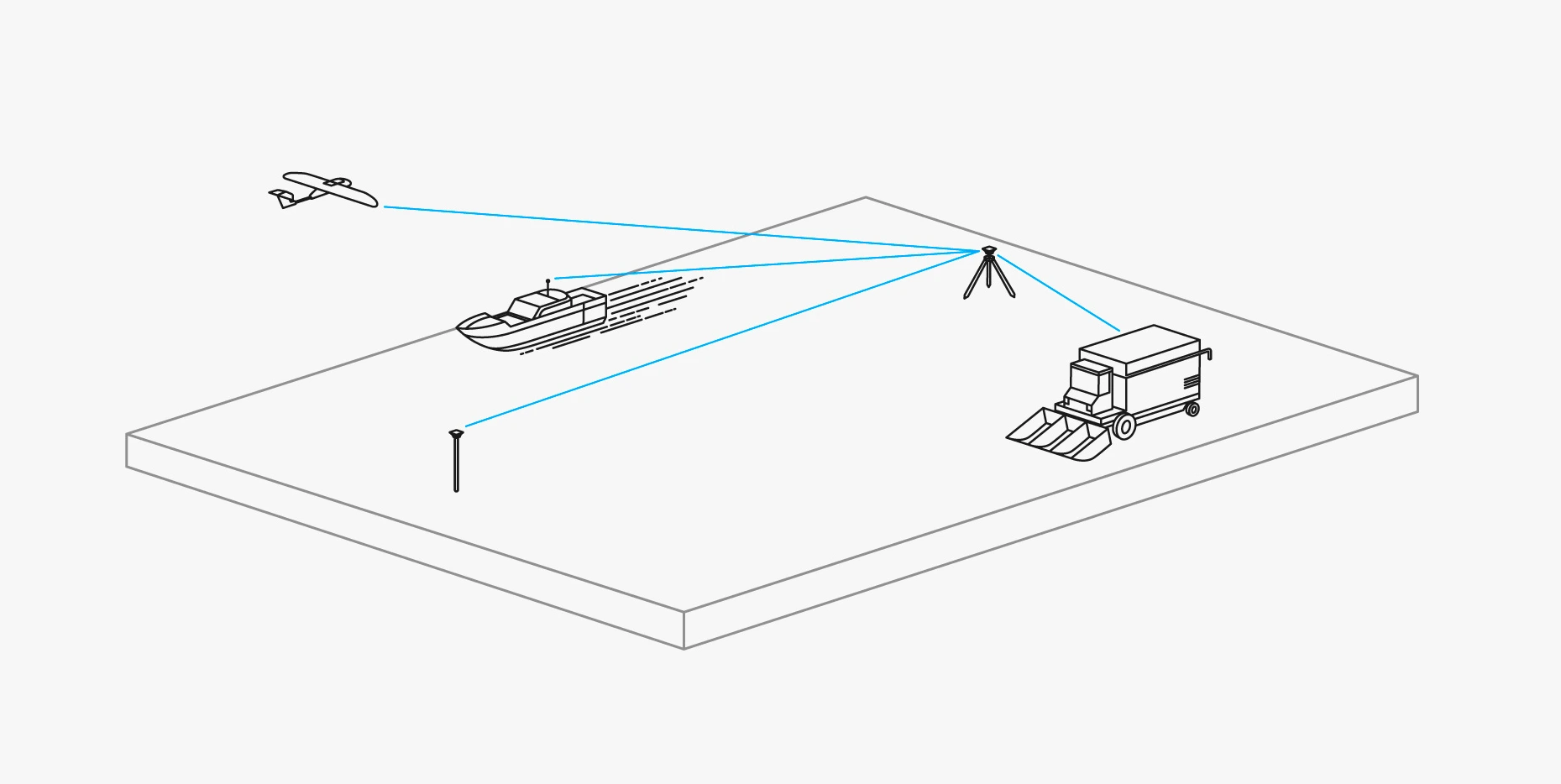

The base's mission is to stay in one place and send corrections to a moving receiver. The rover uses that data to achieve a centimeter precise position. Any number of rovers can connect to one base if their input settings match the base's output.

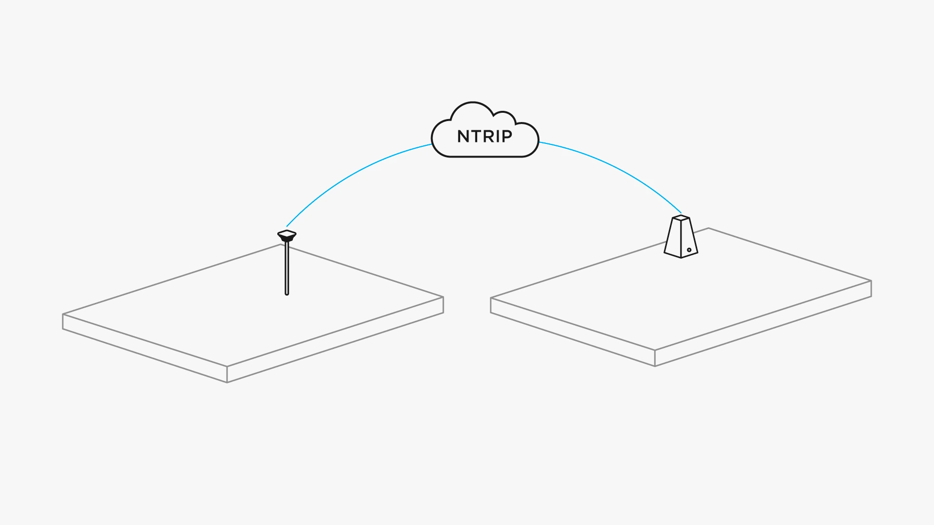

You do not necessarily need a second unit for RTK all the time. Usually, there are local services that share base corrections over the Internet. This technology is called NTRIP.
NTRIP is a good option for areas with strong 3G/LTE coverage and a vast network of NTRIP bases nearby. In other cases, using the second receiver as a local base station has two advantages:
  • autonomy in remote areas as there’s no need in the Internet connection
  • independency from local providers, no additional fees by NTRIP service
