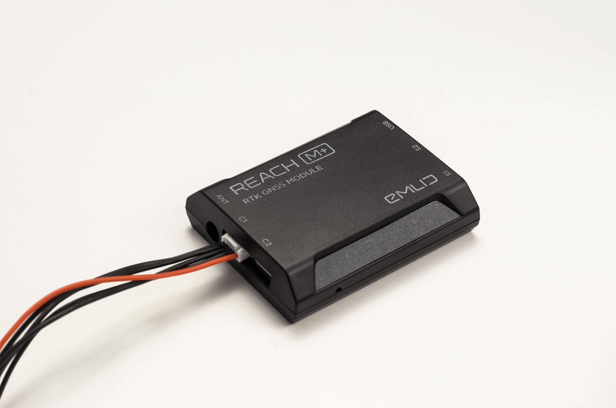

Reach M2/M+ hardware setup​
Connecting Reach M2/M+ to a camera using HSA​
HSA allows Reach M2/M+ to precisely record a time mark at every moment the camera takes a photo.

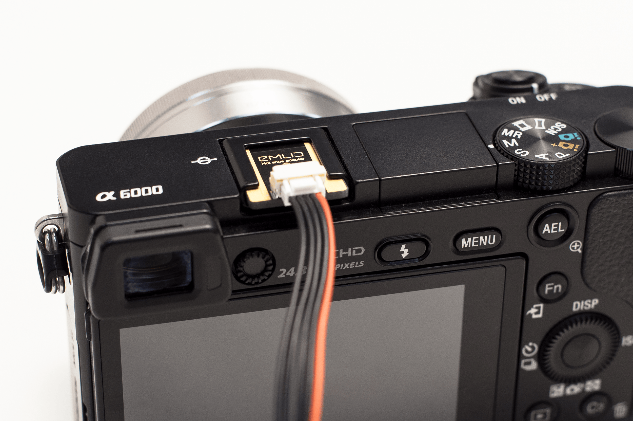

To connect Reach to a camera with a hot shoe adapter use the 5-pin JST-GH cable that comes with Reach M2/M+. Plug the hot shoe connector in a camera hot shoe and the JST-GH connector in the С1 port on Reach M2/M+.

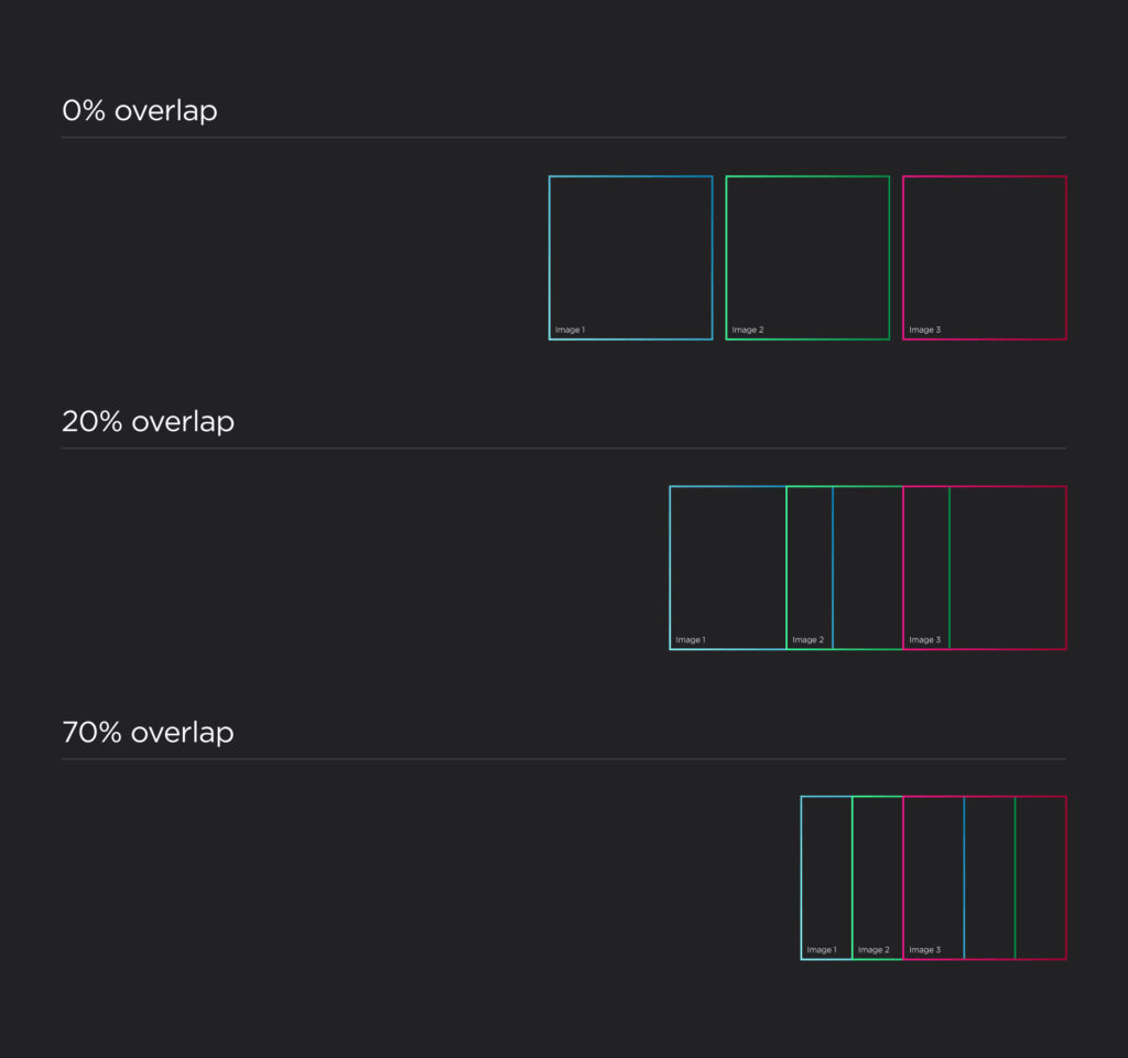

The majority of Ground Control Station software allows and even requires a mission plan preparation before the flight. You need to configure your camera and autopilot the way it obtains images with overlaps. This is necessary because common points in adjacent images are required to create an orthogonal mosaic. We recommend the front overlap to be at least about 60% and the side – about 30%.

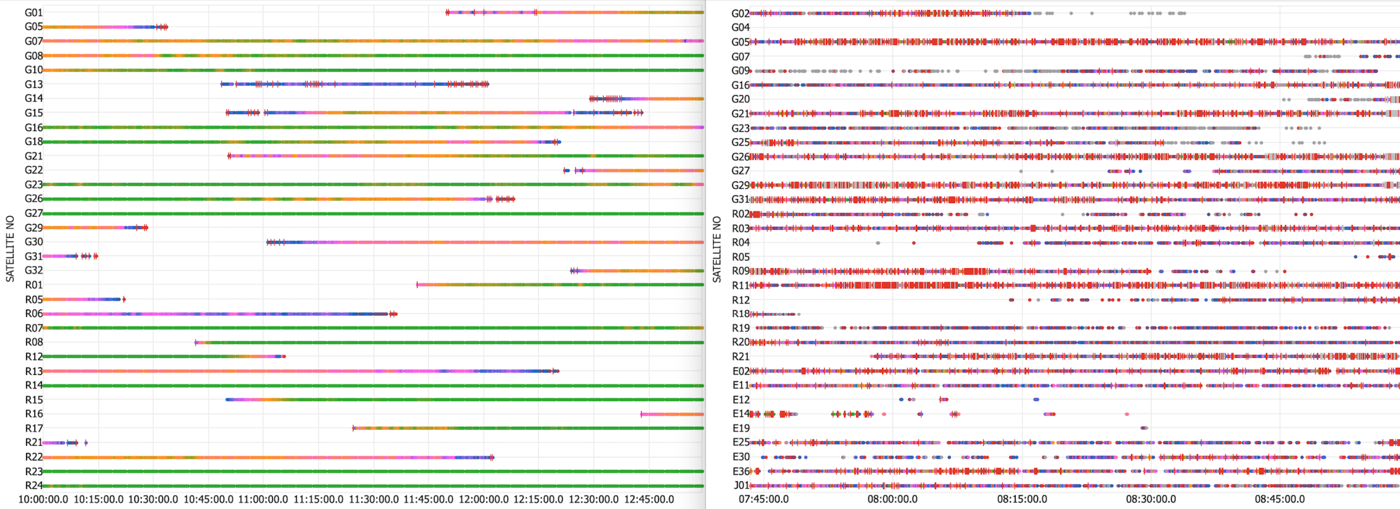

In some cases, you might need to isolate your Reach to ensure the best logging quality. The reason is that the transmitted power of GNSS signals is rather low relative to the possible noise from other hardware components installed on your UAV. It means that the antenna signal strength might be unstable and even sometimes interrupted. Interruption and temporary signal loss on an RTK receiver are called cycle slip.
To avoid cycle slips we recommend isolating the Reach M2/M+ unit and connect it to the ground to eliminate interference. Also, RC components, such as radio transmitters, might affect the signal as well. Reach should be located as far as possible from them.
The effects of a bad hardware setup are substantial. Poor signal quality with low SNR values, lots of cycle slips pose issues with getting fixed solutions and missing time marks. Take a look at the figures below that demonstrate examples of good (the left picture) and bad (the right one) satellite reception.
You can read more about the signal quality assessment in this section of our docs.

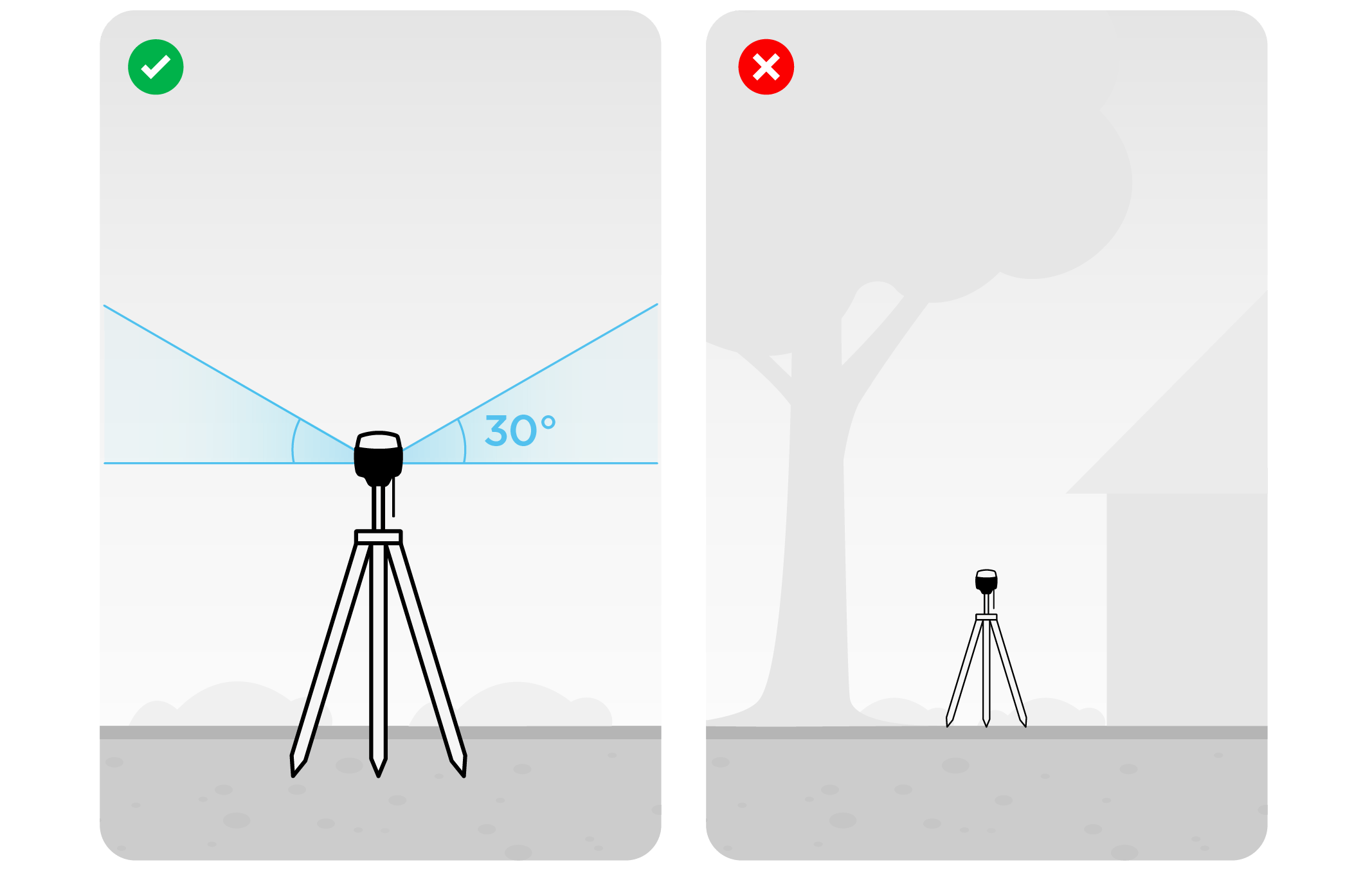

Reach RS4 / RS4 Pro/RS2/RS2+/RS+ base setup​
Check out the figure below and choose an appropriate location to place the Reach RS4 / RS4 Pro/RS2/RS2+ or Reach RS+ base station. The basic rules are:
  • Good sky angle over 30 degrees
  • Away from trees and buildings
  • No electricity nearby
Learn more about base placement and setup in the Placement and Choosing base setup method articles.

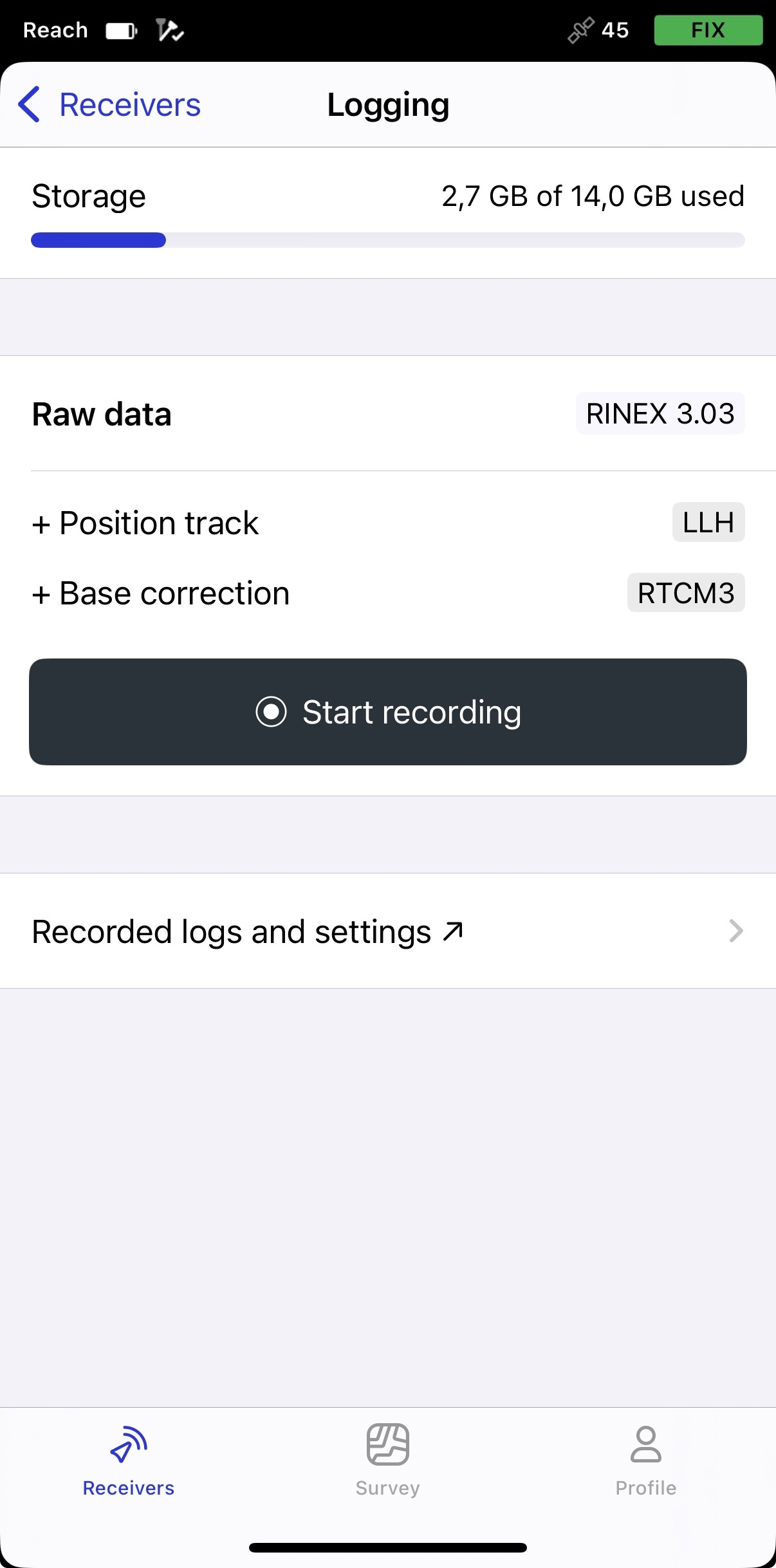

  4. Enable raw data recording on the Logging screen:

  5. Enable raw data recording on the Logging screen.

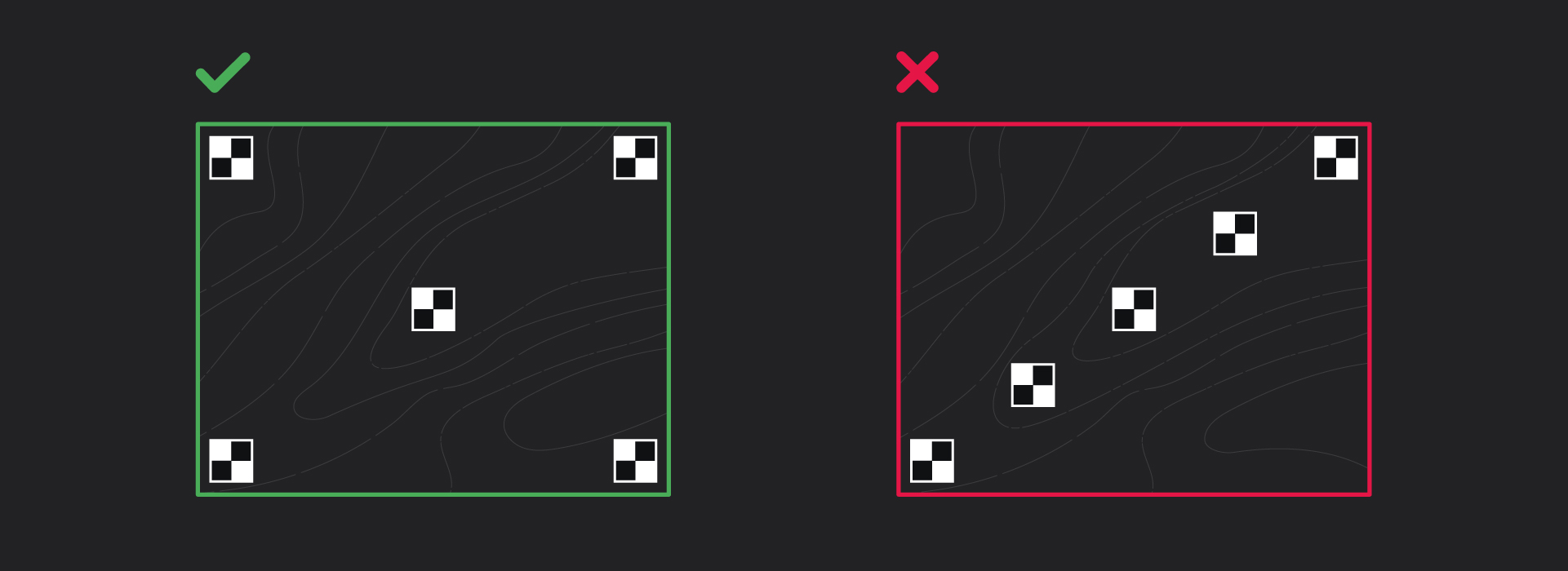

Enough quantity of GCPs depends on the site area. Usually, it is 5-10 points. There are some basic rules of checkpoints placing:
  • They should be allocated evenly in the area where you survey. For example, if you use 5 points, set per one for each corner and the last in the center of the area
  • They must not be on the same line
Also, it is great if you have the possibility to place GCPs at the highest and lowest points on site. It helps to perform the correct flat projection.
It’s important to meet these requirements if you want to get the same accuracy across the entire plot.
