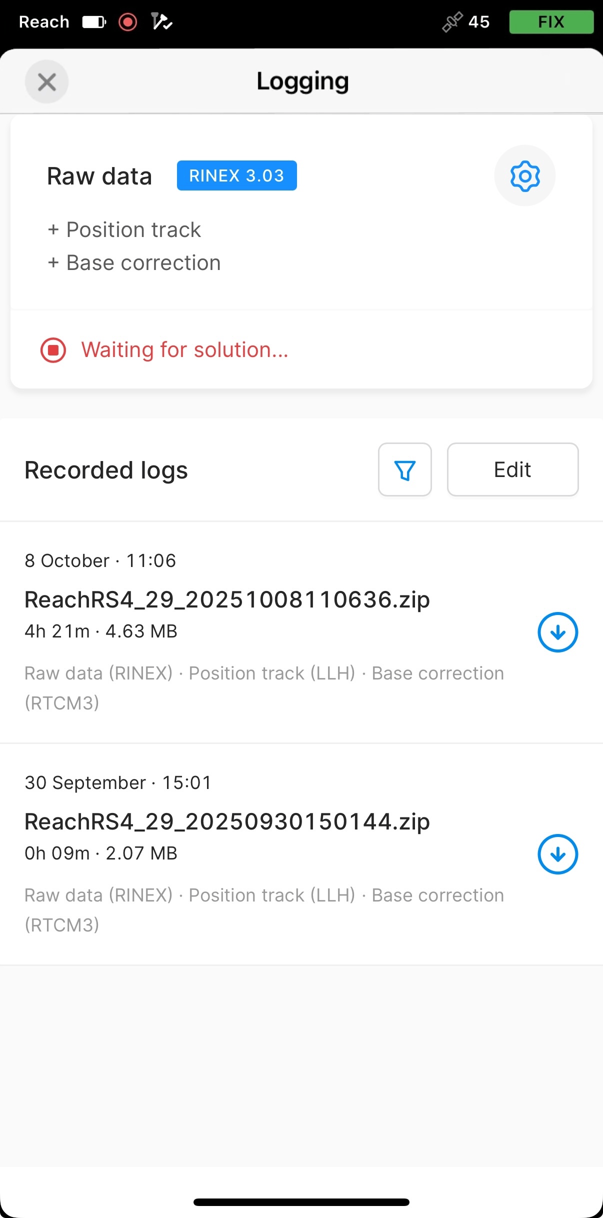

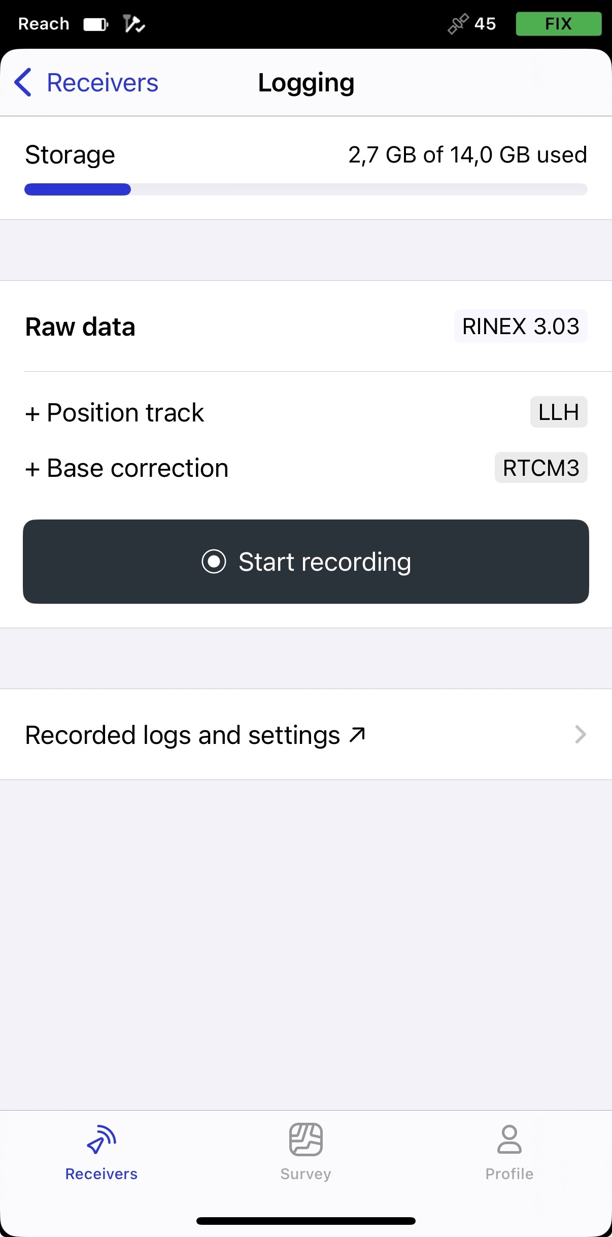

  4. Go back to the Receivers screen and tap Logging.
  5. Tap the Recorded logs and settings button.

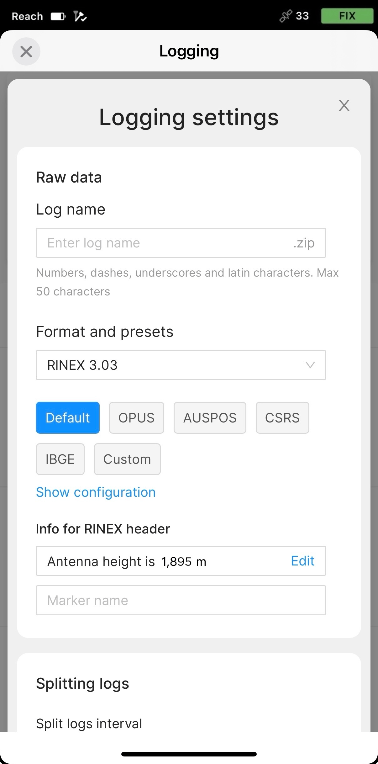

  6. To configure logging, tap the blue gear button.
  7. Enter the log name.
  8. Choose the required RINEX format in the Raw data section.

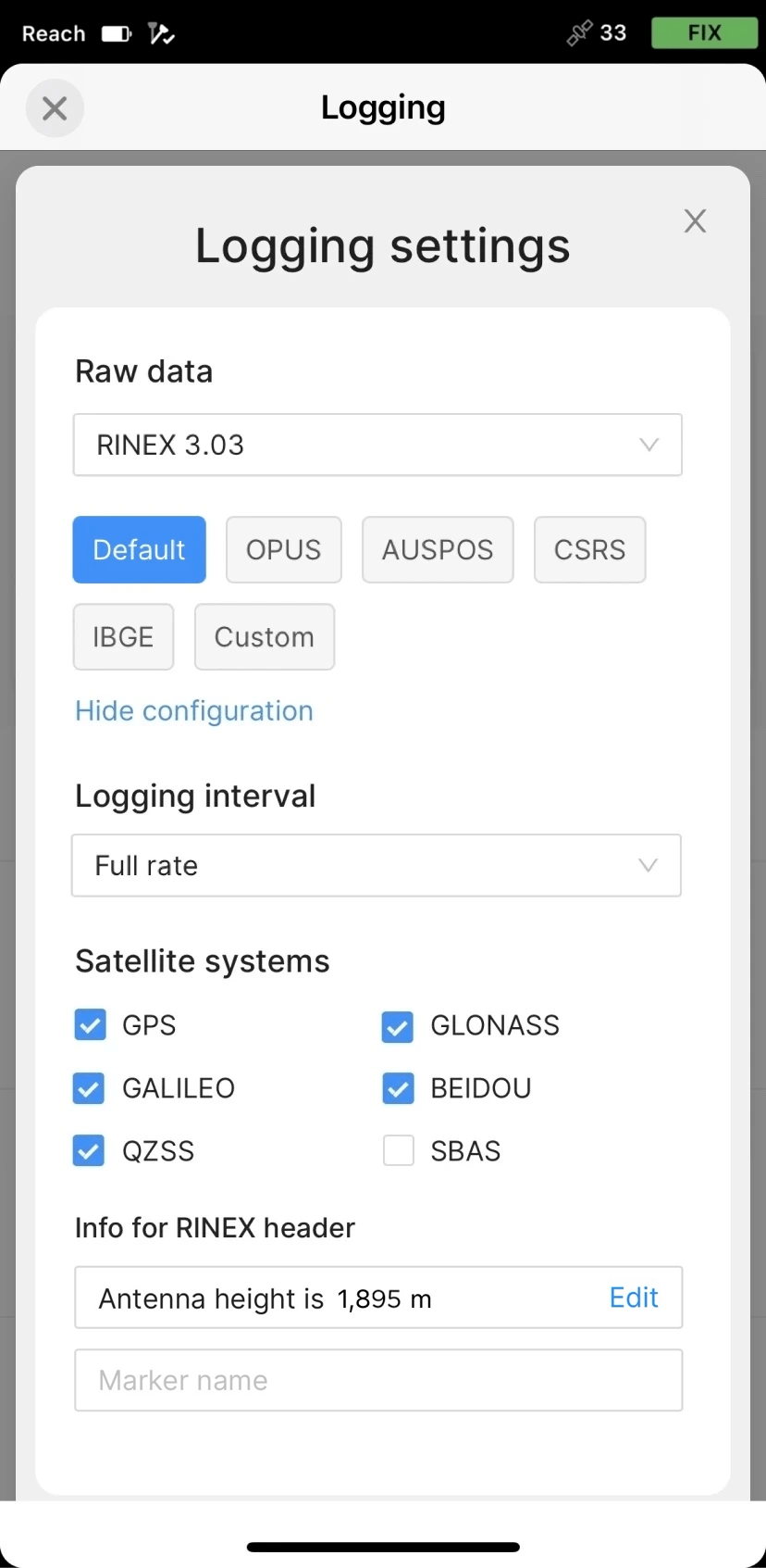

  9. Tap Show configuration and select the required satellite systems.
    Make sure that you have chosen the same set of satellite systems both on the rover and the base.
  10. Set the logging interval to Full rate.
  1. Enter the measured height to the bottom of the receiver in the corresponding field.
  2. Leave the Marker name field empty.
  3. Tap Apply.
  1. Enable log recording by tapping the Start recording button. The red recording icon will appear in the status bar.
  1. To finish recording logs, tap the End recording button.
Download logs​
When your logs are downloaded, you can start working with your data in Emlid Studio.
