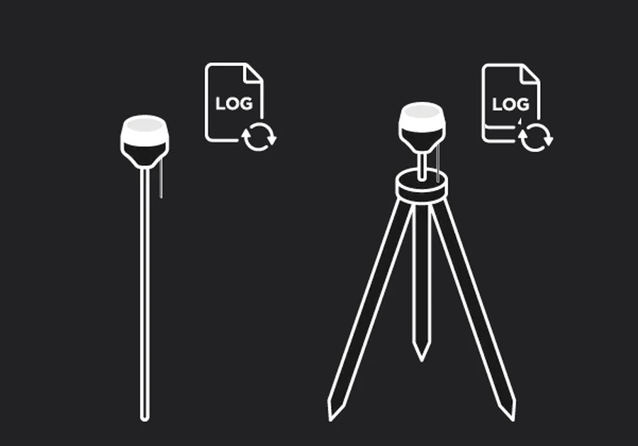

Kinematic processing​
With Kinematic processing, you record raw GNSS data on the base and rover and calculate a precise rover trajectory during post-processing in Emlid Studio. Because the workflow does not require a real-time correction link, it is useful when radio communication is unreliable or an NTRIP connection is unavailable due to limited internet access.
Kinematic processing can also serve as a backup for an RTK survey. By logging raw data on both the base and rover during fieldwork, you can post-process the data later if real-time corrections are interrupted or unavailable.
Learn how to record PPK logs, then process the data with the Kinematic processing workflow in Emlid Studio.

In this setup, one Reach receiver operates as a base, while another is used as a rover to collect individual points in Emlid Flow. The rover operator pauses briefly at each point while both receivers record raw GNSS data.
After the survey, Emlid Studio combines the base and rover logs with the CSV file exported from Emlid Flow to calculate precise coordinates for the collected points. This workflow is useful for control point surveys, asset mapping, and other ground surveys where real-time corrections are unavailable or not required.
Learn how to record Stop & Go logs, then process the data with the Stop & Go with Emlid Flow workflow in Emlid Studio.
