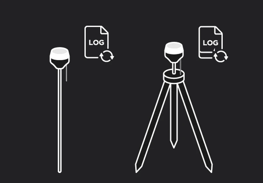

With Kinematic processing, you record raw GNSS data on the base and rover and calculate a precise rover trajectory during post-processing in Emlid Studio. Because the workflow does not require a real-time correction link, it is useful when radio communication is unreliable or an NTRIP connection is unavailable due to limited internet access.
Kinematic processing can also serve as a backup for an RTK survey. By logging raw data on both the base and rover during fieldwork, you can post-process the data later if real-time corrections are interrupted or unavailable.
Learn how to record PPK logs, then process the data with the Kinematic processing workflow in Emlid Studio.
