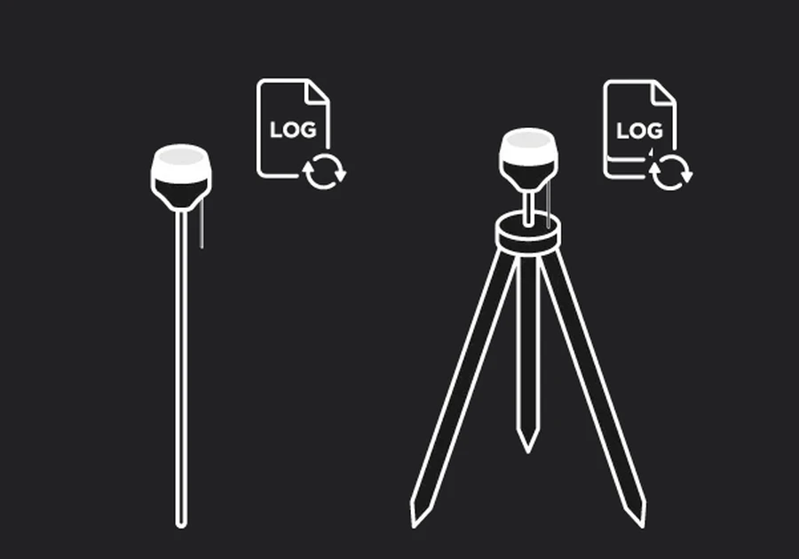

In this setup, one Reach receiver operates as a base, while another is used as a rover to collect individual points in Emlid Flow. The rover operator pauses briefly at each point while both receivers record raw GNSS data.
After the survey, Emlid Studio combines the base and rover logs with the CSV file exported from Emlid Flow to calculate precise coordinates for the collected points. This workflow is useful for control point surveys, asset mapping, and other ground surveys where real-time corrections are unavailable or not required.
