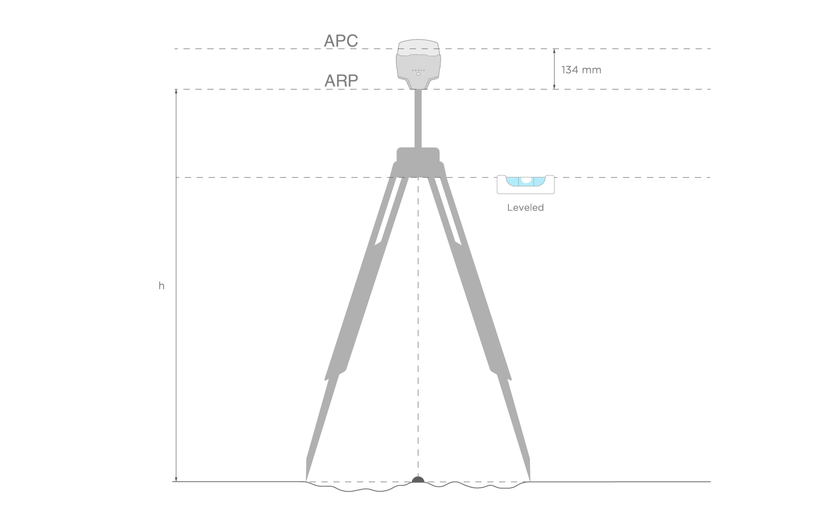

Reach receivers calculate positions at the antenna phase center (APC). The APC is the effective point where GNSS signals are received. However, for surveying tasks, you usually need the coordinates of the point on the ground. To get accurate ground-level coordinates, you need to enter the antenna height in Emlid Flow.
For GNSS receivers, the antenna height is the distance from the mark on the ground up to the antenna phase center (APC). This height consists of two elements:
  • the distance between the mark on the ground and the center point on the bottom of the Reach, the antenna reference point (ARP),
  • the antenna offset between the ARP and APC.
In Emlid Flow, you only need to enter the height to the ARP, which is the height to the bottom of the receiver. The app automatically adds the antenna offset, which depends on your Reach model. Also, when you set the antenna height in one app section, it's updated everywhere else. This keeps the values consistent across the workflow.
