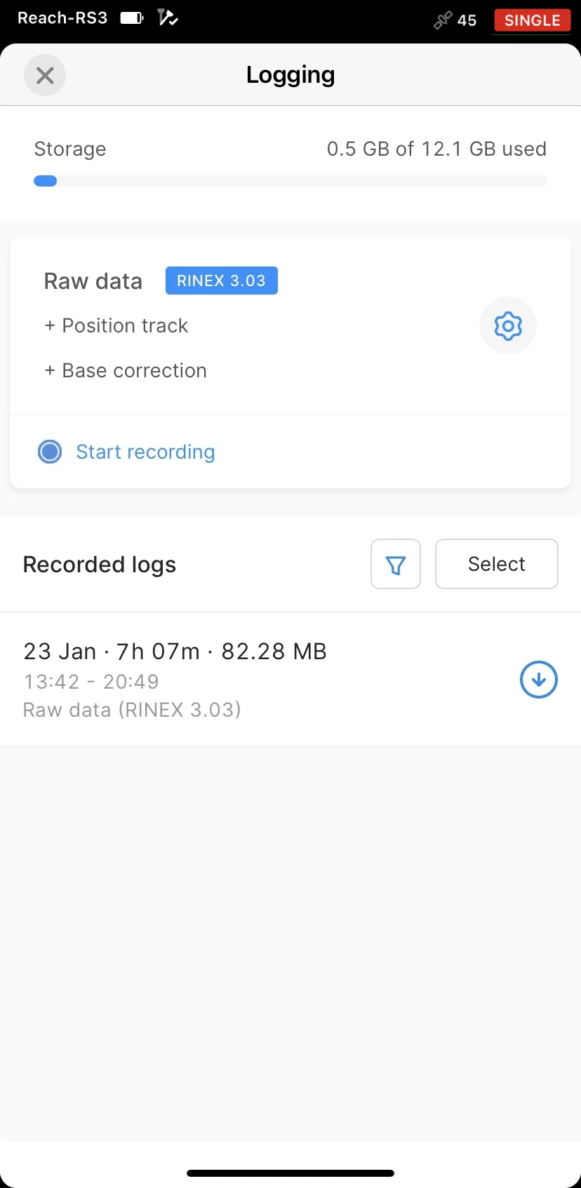

Go back to the Receivers screen and tap Logging.
Tap the Recorded logs and settings button.
To configure logging, tap the blue gear button.

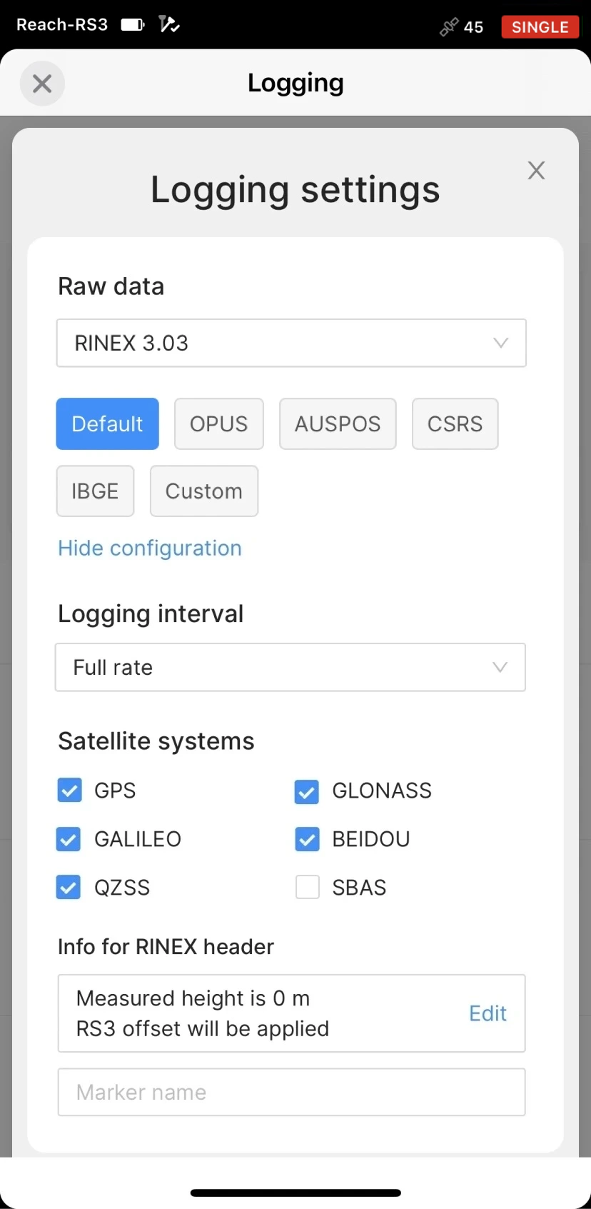

Enter the log name.
Choose the required RINEX format in the Raw data section.
noteIf you do not know which version of RINEX you need, we recommend using RINEX 3.03.

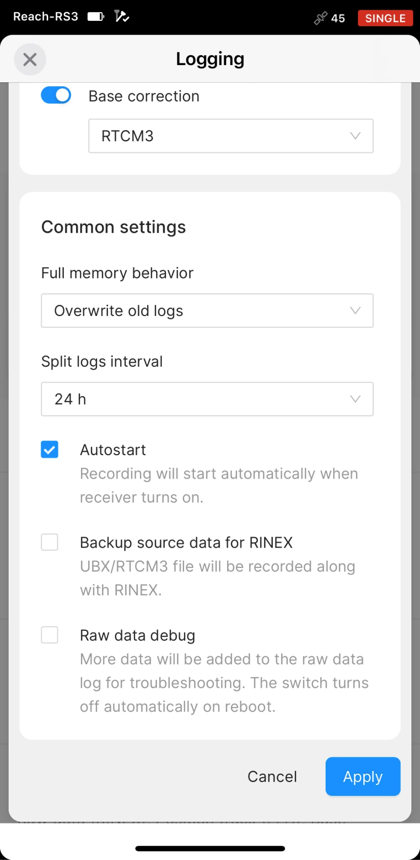

tipWhile recording in the RINEX format, you can log the UBX file as a backup. UBX file can be used to adjust RINEX file settings in the Converter tool in Emlid Studio. You can enable logging in the UBX format in the logging settings in Emlid Flow.
Tap Show configuration and select the required satellite systems.
noteMake sure that you have chosen the same set of satellite systems both on the rover and the base.
Set the logging interval at Full rate.
Enter the measured height to the bottom of the receiver in the corresponding field.
Leave the Marker name field empty.
Tap Apply.
- Enable log recording by tapping the Start recording button. The red recording icon will appear in the status bar.
- To finish recording logs, tap the End recording button.

Go to the Recorded logs section at the bottom of the Logging screen.
noteYou can also find information on the logs size and recording date and time here.
To export the file, tap the Download button.
