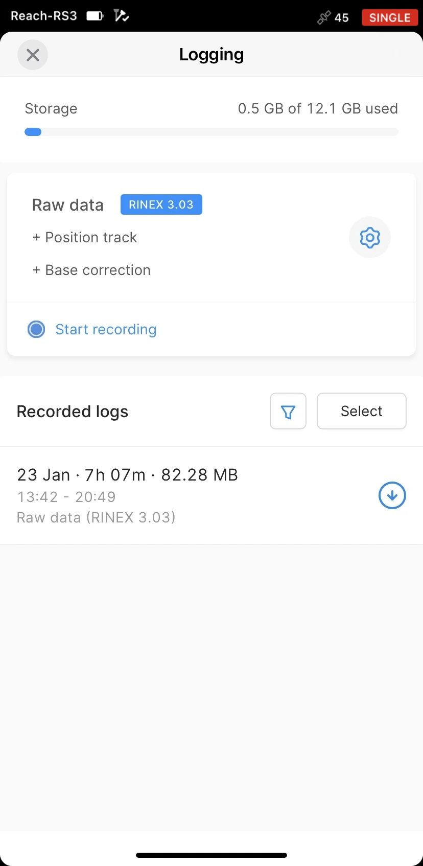

  4. Go back to the Receivers screen and tap Logging.
  5. Tap the Recorded logs and settings button.
  6. To configure logging, tap the blue gear button.

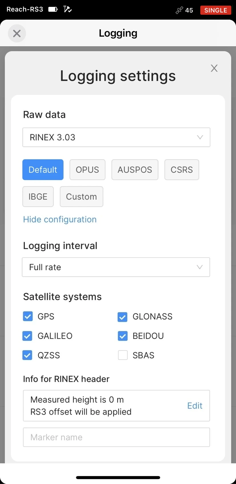

  7. Enter the log name.
  8. Choose the required RINEX format in the Raw data section.

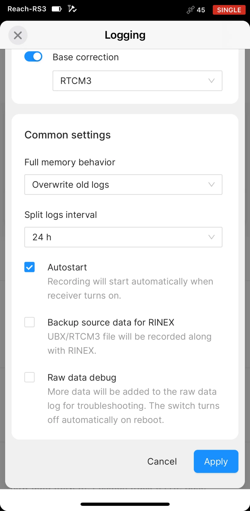

    While recording in the RINEX format, you can log the UBX file as a backup. UBX file can be used to adjust RINEX file settings in the Converter tool in Emlid Studio. You can enable logging in the UBX format in the logging settings in Emlid Flow.
  9. Tap Show configuration and select the required satellite systems.
    Make sure that you have chosen the same set of satellite systems both on the rover and the base.
  10. Set the logging interval at Full rate.
  11. Use antenna height and enter the measured height to the bottom of the receiver for the base. Don't use it for the rover.
  12. Leave the Marker name field empty.
  13. Tap Apply.
  1. Enable log recording by tapping the Start recording button. The red recording icon will appear in the status bar. Now you are ready to collect the points.

  2. To finish recording logs, tap the End recording button.
